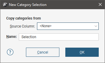

To start categorising points, right-click on the points object in the project tree and select New Category Selection.
The New Category Selection window will appear:
If you select an existing column as the Source Column, you can assign selected points to the existing categories or create new categories. If you select <None> for the Source Column, you will have to define each category manually.

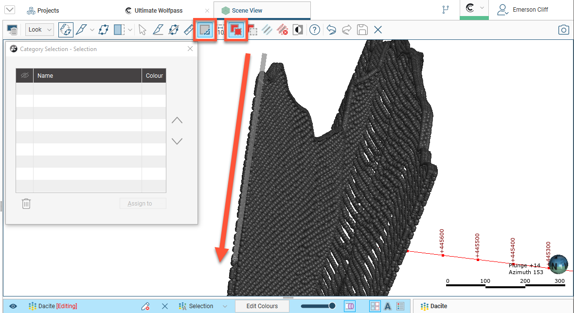

When you click OK, the points object will be added to the scene, along with a set of tools for selecting points. To select points, click on the Select Points button (
) and click the Add Points button (
). In the scene, draw a line across each point you wish to select:
Selected points are highlighted in the scene. If you accidentally select the wrong point, either:

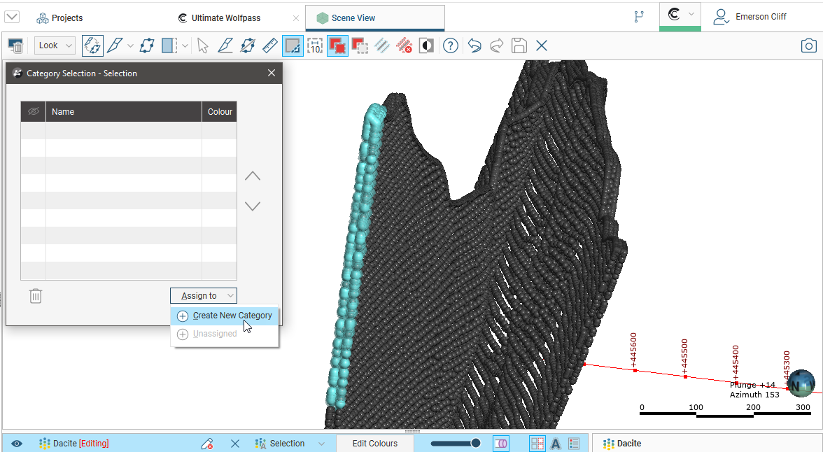

When you have selected at least one point, click on the Assign to button, then select Create New Lithology:
Dac
Enter a Name for the new category, then click OK.

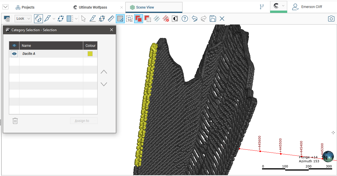

The new category will be created and the scene updated to reflect the changes:
Once you have created a new category, you can add to it by selecting further points, then selecting the category from the Assign to list.
