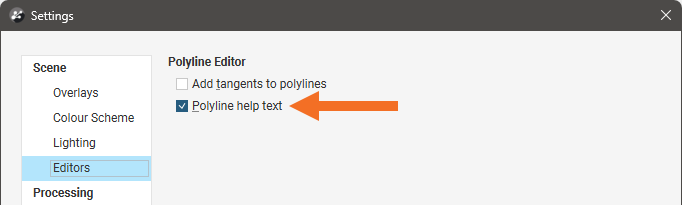

When you start drawing a polyline, drawing tools are added to the scene window. If you are drawing a GIS line or if the slicer was already in the scene, the drawing mode will be set to be on the slicer. Toggle between the two options using the toolbar buttons:

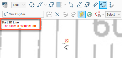

When drawing and otherwise working with the polyline, hints are displayed in the scene that show what actions are currently possible:
For example, if the mode is set to draw on the slicer (), you will be warned if the slicer is not in the scene:
You can disable these hints once you are more familiar with how the polyline editor works. Open the Settings window by clicking on the Leapfrog Works menu and selecting Settings. Click on Editors and disable the Polyline help text option:

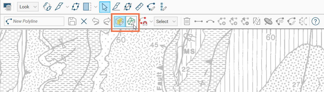

The tools in the second row are for controlling whether the polyline is drawn (on the slicer () or on surfaces (
)). The node snapping selector (
) allows you to specify the way a new node snaps to existing objects. The Select list lets you select different parts of the polyline.

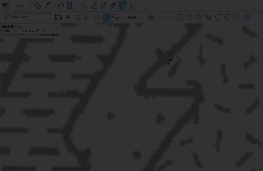

To start drawing a 3D polyline:
- Be sure drawing on surfaces (
) is enabled, then
- Click the Draw lines(
) button.

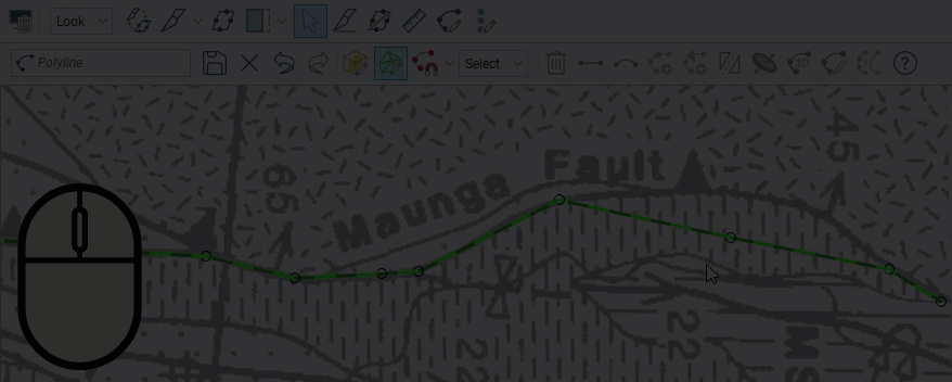

You can then start clicking on objects in the scene to draw. Each time you click, a node will be added, with a straight polyline segment drawn between subsequent nodes. Right-click anywhere in the scene to discard the newly started segment and finish the line at the last node. As this is a 3D polyline, it will appear in the scene as a dashed line. Polylines are made up of these nodes and line segments.

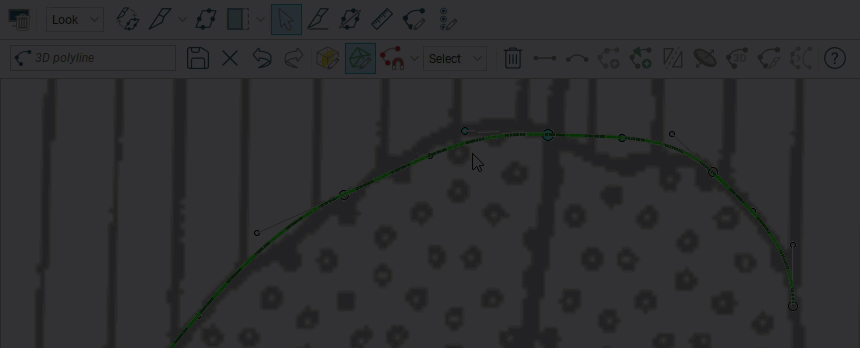

To approximate a curve using straight polyline segments, create nodes that are close together.
You can also create curved polylines using bezier curves to get at least the approximate shape of a curve. Later on you can adjust the position of nodes and the bezier handles to refine the shape.
To create a curved polyline using bezier curves:
- Click where the line segment should begin.
- Move to where the curved line segment should end, then click-and-drag. This will place the new node, and a curved line between the last two nodes will appear.
- Drag the cursor while holding the mouse button down until the curved line lies where you want it, then release the mouse button.
At this point, another curved line segment will appear as you move the cursor. You can now take one of these three actions:
- Right-click to discard the newly started segment and finish the line at the last node.
- Move the cursor to where the next node will go, noting that as you move the cursor, the emerging curve may not be exactly where it is needed. Click-and-drag to place the next node. As you drag, you will be able to bend and shape the previous curved line segment to position the line where it should lie.
- Move the cursor until the new curved line segment lies where you want it, then click to place a node and start drawing a new straight line segment.
Creating a curved line using this technique usually takes some practise to get the shape you want. You will likely need to adjust the positions of the nodes and bezier handles to improve the curve.
In the image below, the cursor is currently over a node.
Click to select a node and drag to move it in the scene parallel to the screen.
Repositioning the nodes may not be enough to get a curved polyline where you want it. You may also need to adjust the bezier control points to adjust how much the line segment curves.
If you can’t see the bezier control points, click on the polyline in the shape list and enable the Show bezier control points option:
Repositioning a node in the scene will normally move it parallel with the screen, and this may detach the node from the object. You may instead prefer to snap the node to the surface in the scene. To do this, hold down the Ctrl key while moving the node.

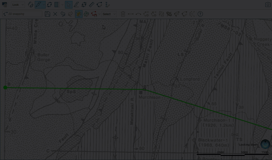

Drawing 2D Lines
To start drawing a 2D polyline:
- Be sure drawing on the slicer (
) is enabled, then
) button.
Then, drawing a 2D polyline is similar to Drawing 3D Lines, except that drawing is restricted to the 2D plane set by the slicer.
A 2D polyline is indicated in the scene by an unbroken line:
To convert a 2D polyline into a 3D polyline, double-click on the line to select the whole line, then click the 3D polyline button ().

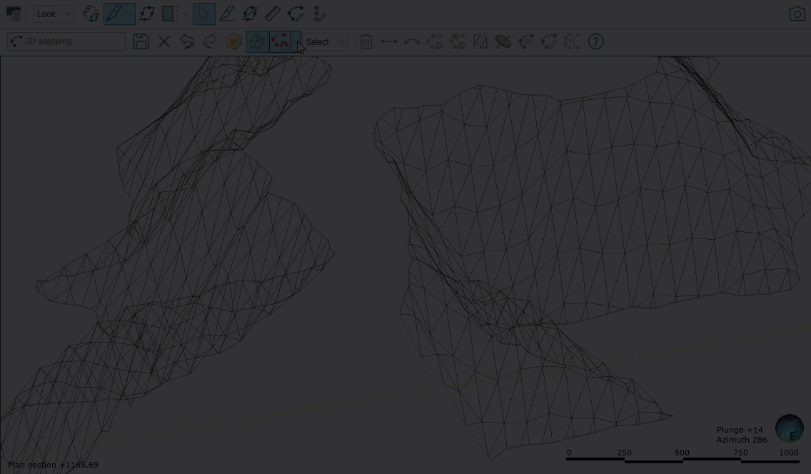

Node Snapping Options
With the node snapping selector (), you can choose how a new node snaps to existing objects. You have the following options:
- Snap to polyline nodes (for 2D and 3D polylines)
- Snap to mesh edges (for 3D polylines only)
- Snap to mesh vertices (for 3D polylines only)
It is not possible to snap to a mesh edge or vertex when drawing 2D polylines as it is almost impossible to locate such a position on the slicer.
With a node snapping mode selected, the new node will snap to the object when you click to locate the node. To see the effect of snapping, zoom in close.
As you get close to an object the new node is able to snap to, it will pull the new node to the object like a magnet. When Snap to mesh edges or Snap to mesh vertices options are selected for 3D lines, if an object is not close enough, the cursor and the hint text will indicate that no object is under the mouse cursor. As you approach an edge or a vertex, the cursor will pull to that edge or vertex to make clicking on the snap-to object easy.

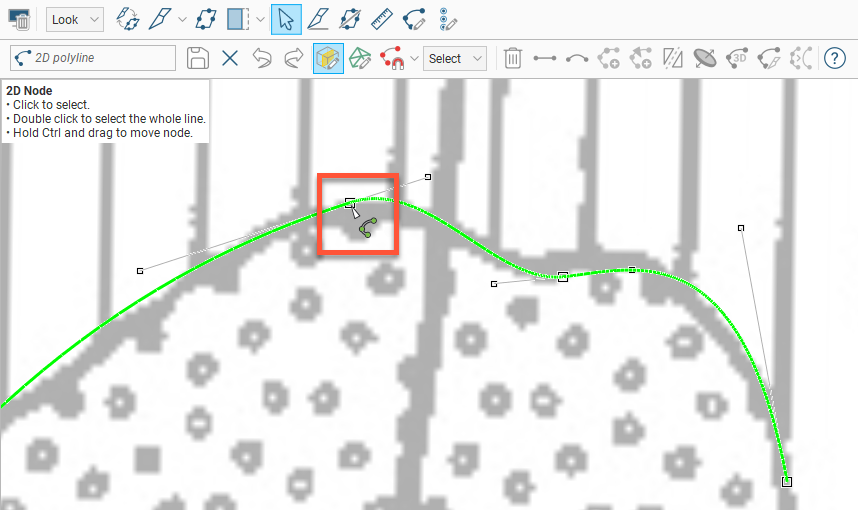

Editing a 2D or 3D Polyline
Select the polyline in the shape list and click the Edit polyline button ().
Click the Select tool () to make changes to the polyline.
- Click on a node to move it.
- Click on a segment away from a node and drag it to change its curvature.

Begin drawing again by selecting the Draw lines button (). To continue from an existing node at the start or end of a polyline, click on the node.

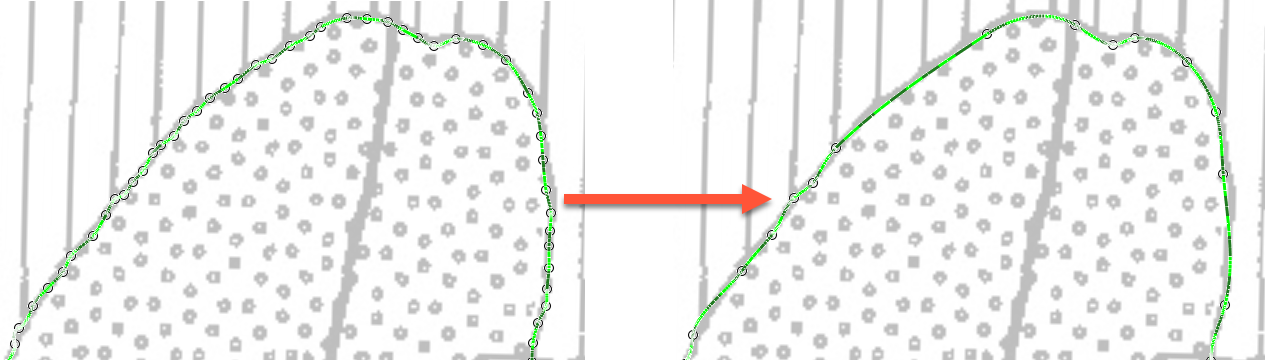

Use as many nodes as necessary to draw the polyline. You can later reduce the number of nodes using the Simplify polyline tool (). Each time this tool is used, Leapfrog Works attempts to halve the number of nodes on the select segments:
Although you can make the line curved while adding nodes, an easy way to draw a curved polyline is to simply click to add a series of points. Set the curvature of the whole line by selecting all segments and then clicking the Make selected segments curved button ():
You can then make any adjustments to the curves required by dragging the segments or using the bezier control points.

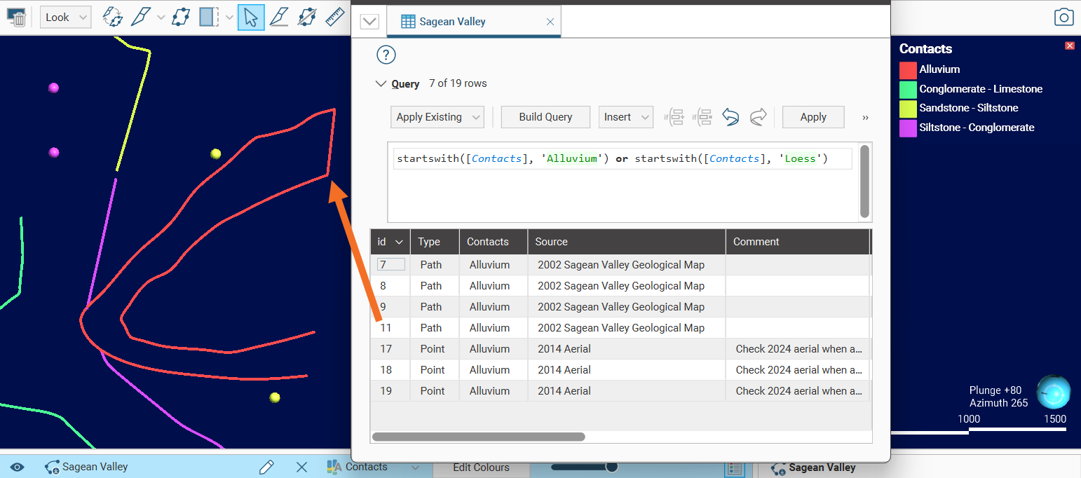

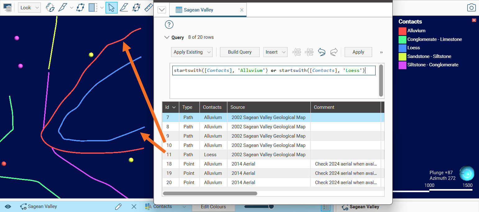

Editing Attributed Polylines

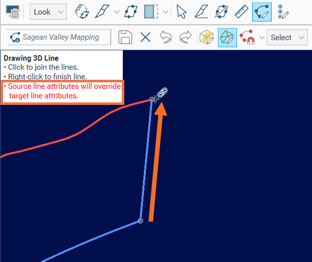

When editing polylines with attributes, you may wish to join two segments that have different attributes. If this is the case, the resulting single polyline can only have one of the original attributes. By convention, the line that you start drawing from when connecting one line to another is regarded as the source line, and its attributes will be preserved.
In the following example, the Draw lines tool has been selected and the last node of the red line with the Contact category Alluvium has been clicked on to start a drawing action. The line is being drawn towards the end of the blue line, with the intention to join the two lines. Note that the warning message in red describes what will happen when the action is completed:
This results in the two lines being joined together into a single line, and the Contact category Alluvium is assigned to this line.
If, however, the line was drawn from the blue line with the Contact category Loess towards the red line, the blue line would have been used as the source line for the attributes:
As a result, the two lines joined together into a single line receive the Contact category Loess:
Similarly, if you move a polyline node to link it to another line, the first polyline will be the source line for any attributes to be applied to the resulting polyline.

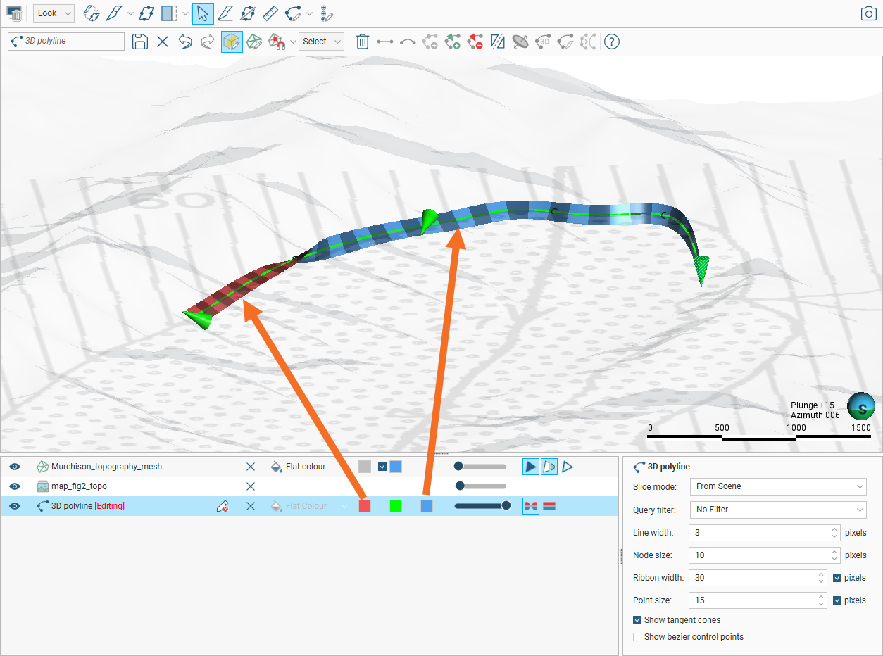

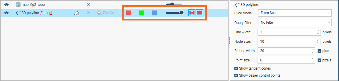

In the shape list, you can control the colour of the positive (red) and negative (blue) surfaces of the line and of the line itself (green):
For contact surfaces, the colour of the positive and negative sides of a ribbon will be determined by the lithologies or categories assigned to either side of the surface.
With the controls in the properties panel, you can change the size of different parts of the polyline to make working with the polyline easier.
For Ribbon width and Point size, the setting is, by default, in pixels, but both can be displayed in real-world size by unticking the pixels box, which may make editing the polyline easier in some circumstances.
You can also choose whether or not to show tangent cones and bezier control points.

When a polyline has a tangent, it can be visualised in the scene as a ribbon. The Surface ribbon() and Normal ribbon(
) options help you to determine the orientation of the polyline in the scene. The surface ribbon reflects the orientation of the polyline and the normal ribbon is perpendicular to the surface ribbon.
For example, click on the Surface ribbon button () to determine which side of the polyline is positive (red) and which side is negative (blue):
If you are having trouble seeing the ribbons, you can change their size using the Ribbon width control in the properties panel.

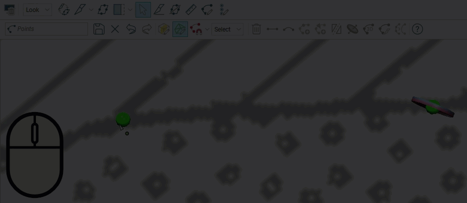

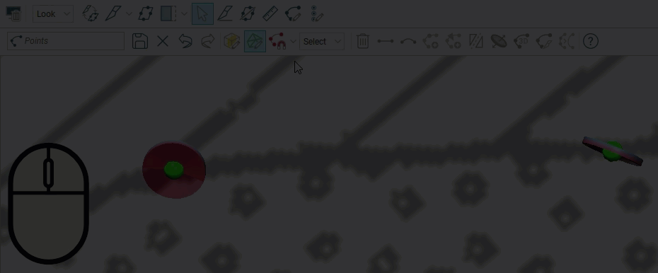

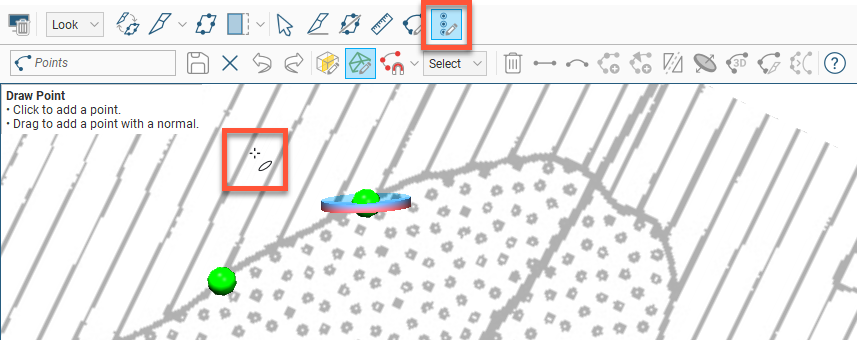

Drawing Points
Polylines can also include points, which are drawn using the Draw points tool (). Clicking adds a point, and clicking and dragging adds a point with a normal. Normals are shown in the scene as disks intersecting the points. The scene below shows one point with a normal and one without:
To move a point without a normal, switch to the Select tool (). Click on the point and drag it. To add a normal to the point, click on it in the scene and click the Add disk button (
To edit the orientation of a point with a normal, click on it in the scene. There are two rotation modes, and a click on the disk will change between modes.
- In one rotation mode, yellow and blue arrows show how dragging the disk will change the dip and azimuth of the disk. The yellow arrows indicate the direction of rotation when you click-and-drag the disk. Change the position of the pointer on the disk to switch the rotation selection to the other pair of arrows.
- In the other rotation mode, an extended translucent disk extends out from the point at right-angles to the point’s disk. Around the edge of the disk are four blue arrows indicating the rotational direction. Click-and-drag the point’s disk to adjust the disk angle. Change the position of the pointer on the disk to change the angle of the rotation plane on the point’s disk.
You can also change the orientation of a disk by drawing over it. To do this, make sure the Draw points tool () is selected. Hold the cursor over the point you want to edit. The cursor will turn green to indicate that you can adjust the disk’s angle. Drag to adjust the angle and release the mouse button when finished.
