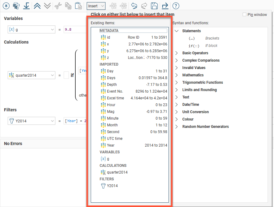

Existing Items
This section covers the items listed in the left-hand side of the pinnable Insert list:

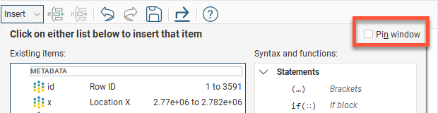

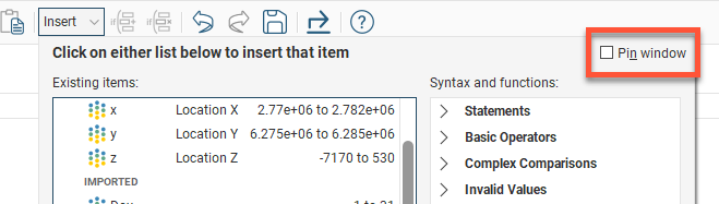

To pin these lists to the Calculations tab, enable the Pin Window option:

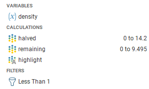

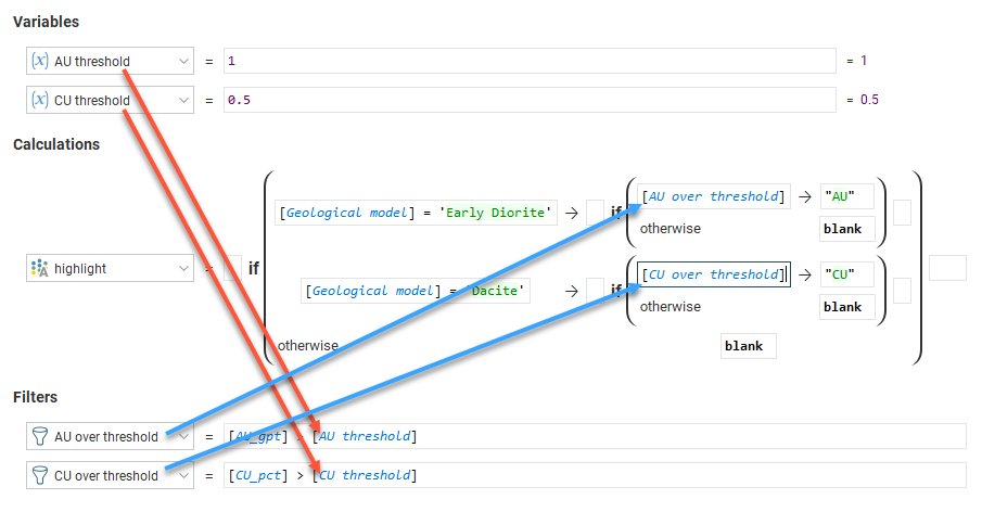

Variables, Calculations and Filters
Each time you create a new variable, numeric calculation, category calculation, or filter in Calculations, it will also be added to the Existing items list. You can select them from this list and they will be inserted into your new expression at the insertion point. Note that whenever one of these named items is added to an expression, it is wrapped in square brackets.
This example is only attempting to illustrate how variables, calculations and filters that have already been defined can be referenced by name in new calculations; the calculation highlight is not intended to be useful.
It is good practice to break your calculations down into parts, giving each part a relevant and readily identifiable, unambiguous and easily understood name. This will make your calculations more readable and clear. Using Variables to define a constant with a name makes it easy to understand the utility of that particular constant when you use it in a calculation. You may also be able to re-use certain parts such as filters or constant variables, so you do not need to define the same thing repeatedly.
Be careful not to inadvertently name something incorrectly, such as naming a volume as "area", as this could give rise to difficult-to-locate errors in your calculation.

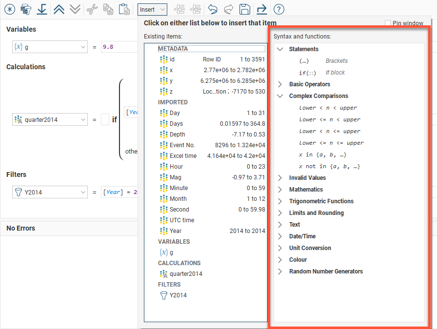

Syntax and Functions
This section covers the items listed in the right-hand side of the pinnable Insert list.

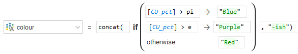

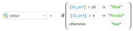

Cu_pct is the name of an evaluation applied to all the points in a points object. As the if(::) If block calculation is run for each point, the evaluation for each point replaces this variable name in the expression. If the value is greater than the value of the constant pi, the result for that point will be the text string "Blue". Otherwise, if the value is less than or equal to pi, the result will be the string "Red".
Additional rows may be added. Each row follows on from the left-over results of the line before, simplifying the logical expression that may be used.
Note the addition of the line [Cu_pct] > e → "Purple". This line can be interpreted to mean: if the value estimated for a point is less than or equal to pi, but greater than e the result shall be "Purple". The part about it being less than or equal to pi is implied because the line follows the previous line [Cu_pct] > pi → "Blue".
Note that expression elements before and after the if expression can be entered. This allows the if(::) If block to form part of a more complex or extensive expression.
The earlier conditional classification has now been embedded within a concatenation function, forming the first part of a two-part string concatenation. The concatenation function is adding the text string "-ish" to whatever is produced by the if(::) If block. Thus, if the value of the block being evaluated is 1.2, the result of the colour categorisation calculation will be "Red-ish".

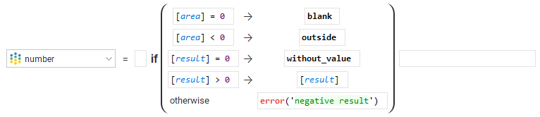

Invalid Values
Invalid values are different types of results for “numeric” categorisation calculations that need special non-numeric results for certain category results. These have special meanings of their own without having to resort to interpreting negative numbers and zero as having special meaning.
blank means having no value, the value in the imported file is blank or has non-numeric data
without_value is often used to mean the estimator cannot produce a value (specific to blocks)
outside is used to indicate the block is outside the boundary of the domain (specific to blocks)
error generates an error, and provides an ‘error’ status value for the affected block or point
error(‘message’) is similar to error but includes a custom message.
If the variable [area] is equal to 0, the point will be marked with the special value blank. If the variable [area] is less than 0, the point will be marked with the special value outside. If [area] is greater than 0 and the variable [result] is equal to 0, the point will be marked with the special value without_value. If [area] is greater than 0 and [result] is greater than 0, the point will be will be assigned the value of the variable [result]. If [area] is greater than 0 and [result] is less than 0, the point will be given the special value error and status with the message 'negative result'.

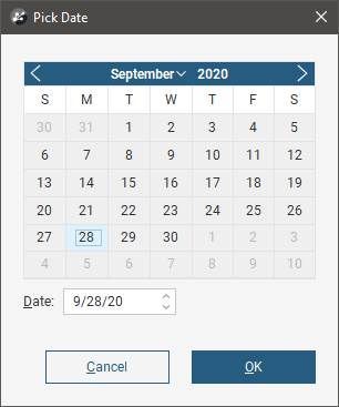

Pick date...
This selection opens a dialog box prompting you for a date that will be entered at the insertion point when you click OK.
Use the year picker, month picker and date selector to specify a date. If the above date is entered, it will be represented in the expression as @2020-01-22.

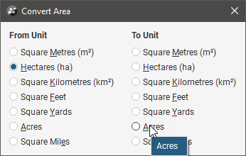

Area...
This selection opens a dialog box prompting for the From Unit and To Unit for the conversion.
When you have selected the two units, the dialog box disappears and the conversion function you require will have been inserted into the expression at the cursor, and the cursor repositioned so you can enter the source of the value to be converted.
The ha_to_acre function has been entered by the dialog box, and the variable [hectares] has been entered as the input. The numeric calculation acres will be given the output of the ha_to_acre function.

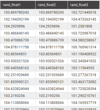

random_float(start, end, seed)
This function returns a pseudo-random real number between the start and end values (inclusive). When the random_float function is added to a calculation, by default the seed value is set to a number that relates to the exact time the function was added. This seed value can be changed. Because the function is a pseudo-random number generator, the use of the same seed will result in the same series of random numbers. Use a different seed number to get a different series of randomised values.
Each row will get three new columns identified as rand_float1, rand_float2 and rand_float3, and the values in each column will be populated using the pseudo-random number generator to have real values between 100 and 105 inclusive. Because rand_float1 and rand_float2 have been seeded with the same value, both columns will be identical, but the rand_float3 column will have different values because the default seed was used.

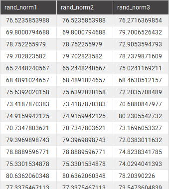

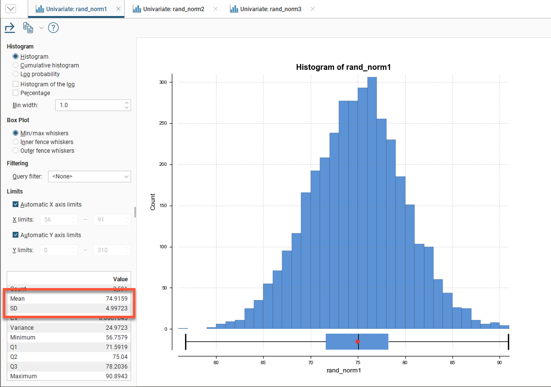

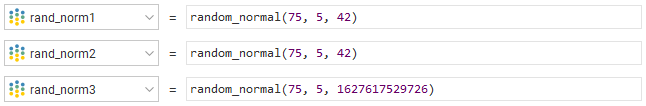

random_normal(mean, stddev, seed)
This function returns a pseudo-random real number conforming to a normal distribution centred around the mean with a standard deviation stddev. When the random_normal function is added to a calculation, by default the seed value is set to a number that relates to the exact time the function was added. This seed value can be changed. Because the function is a pseudo-random number generator, the use of the same seed will result in the same series of random numbers. Use a different seed number to get a different series of randomised values.
Each row will get three new columns identified as rand_norm1, rand_norm2 and rand_norm3, and the values in each column will be populated using the pseudo-random number generator to have real values in a normal distribution centred on 75 with a standard deviation of 5. Because rand_norm1 and rand_norm2 have been seeded with the same value, both columns will be identical, but the rand_norm3 column will have different values because the default seed was used.
Here univariate statistics histograms are shown demonstrating the resulting normal distributions produced (note the first two are identical because the same seed was used):
