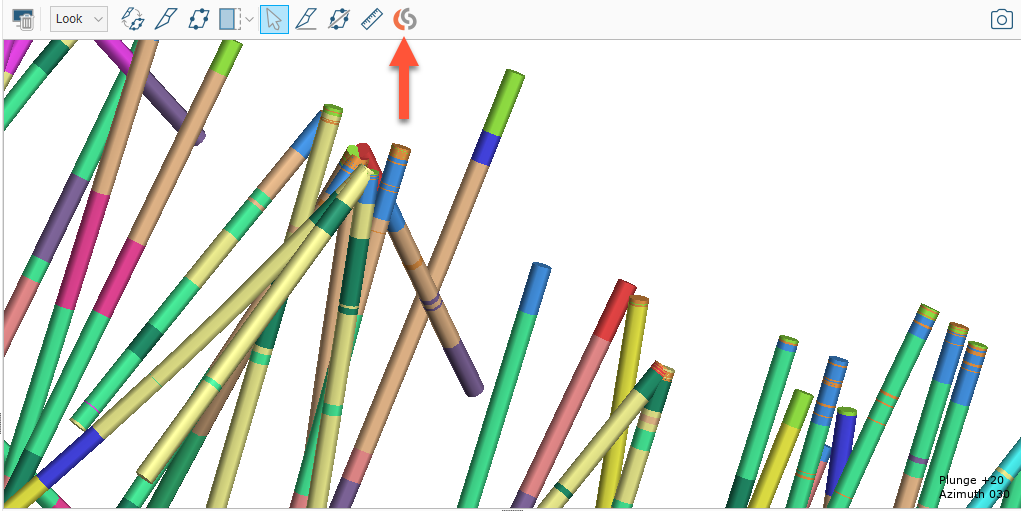

Before you can view core photos, you must first set up the Coreshed interface. To do this, right-click on the Borehole Data folder and select Add Core Photo Link. In the window that appears, select Coreshed and click OK. The Coreshed Photo Settings window will appear. Enter the information required and select whether each core photo will be opened in a separate browser Window or Tab.
Click OK to save the information. The Coreshed Photo Link button (
) will appear in the toolbar:

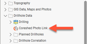

A link will also appear in the project tree as part of the Borehole Data folder:

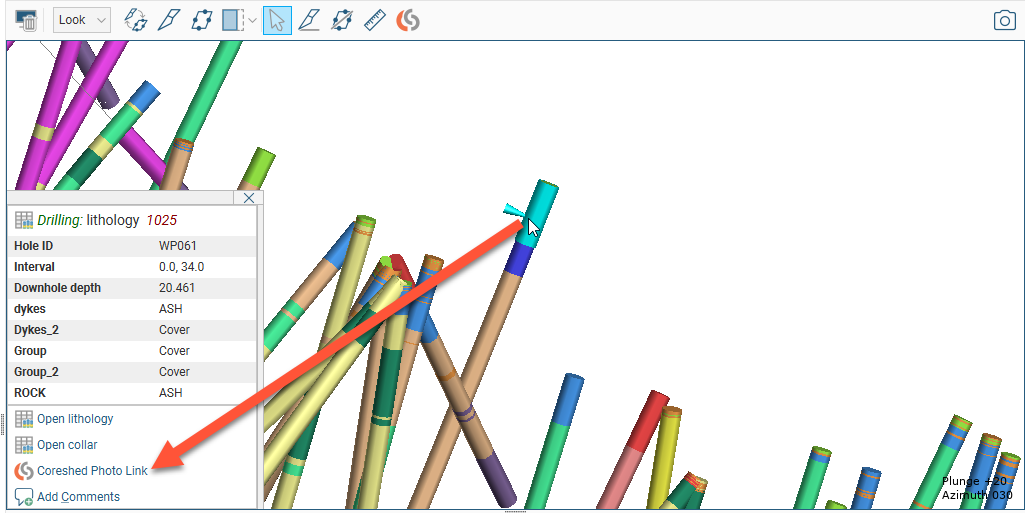

To view core photos, click on a borehole in the scene, then click on the Coreshed Photo Link button in the window that appears:
Your browser will be launched and you will be prompted to log in to the Coreshed database. Enter the Username and Password, which are case-sensitive. Remember to allow the browser to save the details so that you will not be prompted to log in each time you wish to view a photo.
Your browser settings may require that you install a plugin or make changes to settings in order to view core photos. If you are not able to access the Coreshed database from Leapfrog Works and have ensured your Username and Password have been entered correctly, contact Customer Support as described in Getting Support.

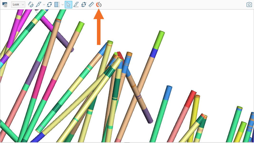

) in the toolbar allows you to view core photos in your browser in rapid succession. To do this, first make sure you are already logged into the database. Then click on the Coreshed Photo Link button (
) to enable the rapid viewing mode. Each time you click on an interval in the scene, the core photo link will open in your browser.
Position your browser window alongside the Leapfrog Works scene window to view drilling data in Leapfrog Works alongside the core photo data.
