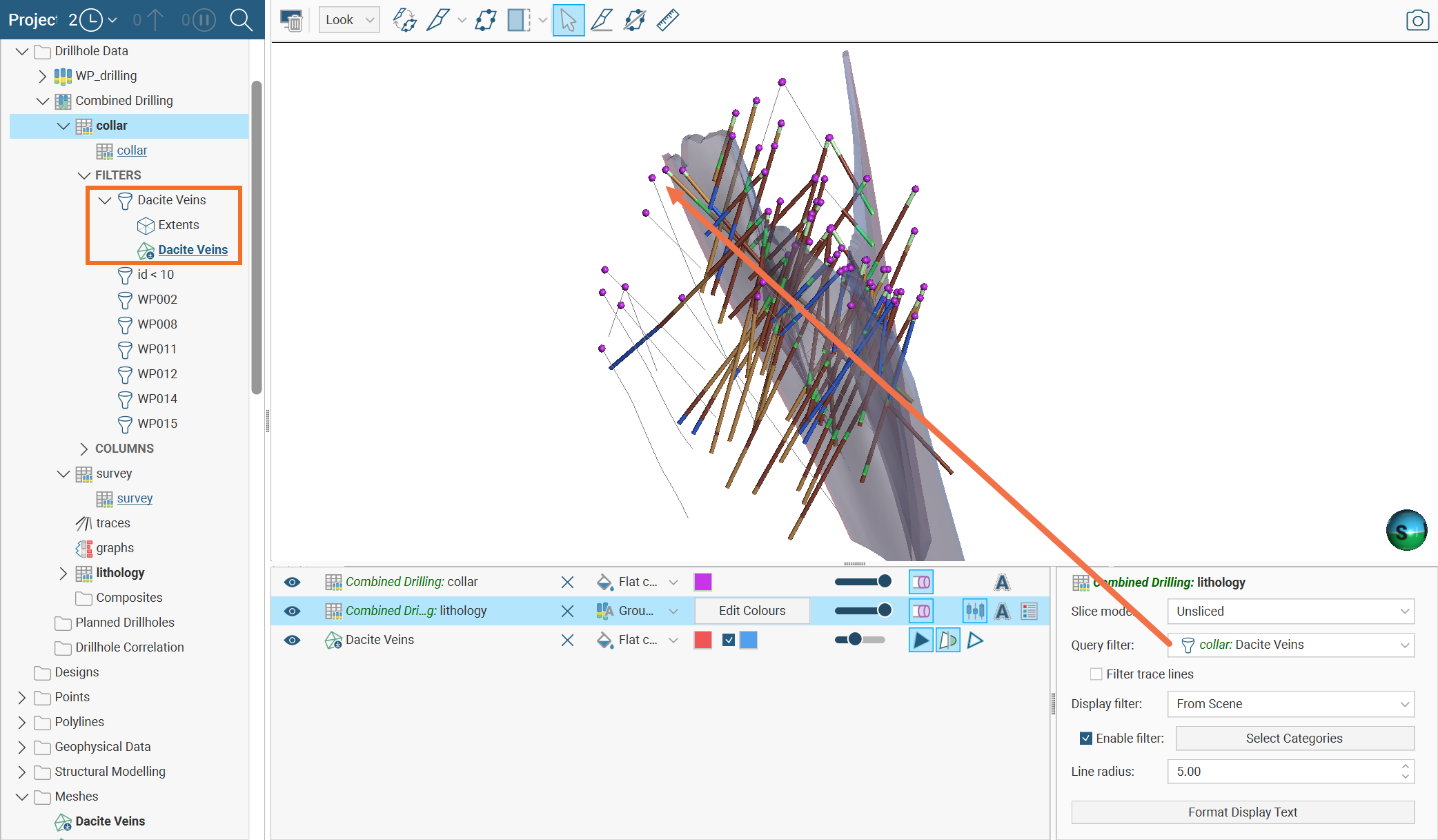

Here a volume representing a vein system has been used to filter the drilling data to show the data that intersects the volume:

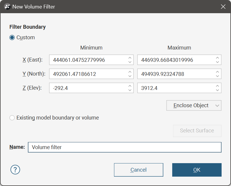

Creating a Volume Filter
Volume filters are available for drilling data. To create a volume filter, right-click on a collar table in the project tree and select New Volume Filter.
You can define the filter boundary in three ways:
- Enter the volume coordinates using the X, Y and Z Minimum and Maximum coordinates.
- Select Enclose Object and choose from the list of objects in the project.
- Select Existing model boundary or volume, then click on the Select Surface button and choose from the list of volumes in the project.
The Existing model boundary or volume option allows the selection of a closed volume that is not a cuboid.

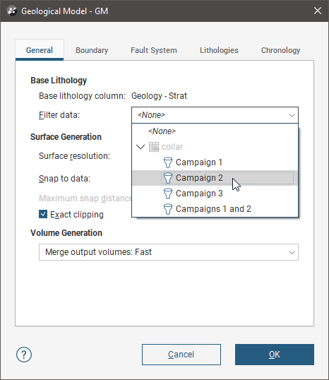

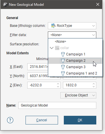

When creating or editing objects or models, you can use a query filter to filter the data used. For example, here you can use one of the query filters defined for the drilling data to create a new geological model from the drilling data for a specific drilling campaign:

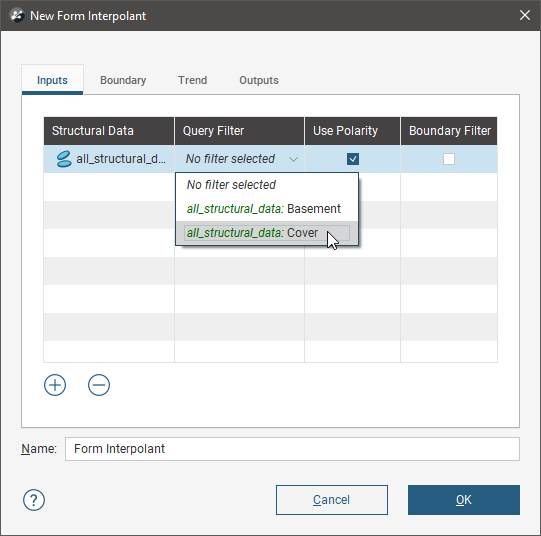

Here a structural data table is used to create a form interpolant. The query filters on the structural data table can be used to filter the data used in the interpolant:

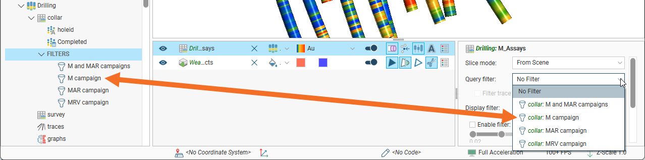

Using a Filter in Displaying Data

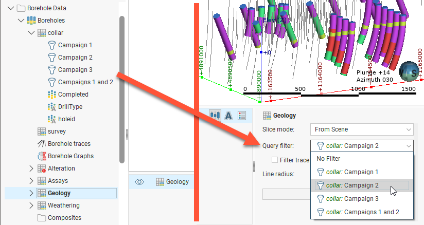

To apply a filter to the scene, select the object in the shape list, then select the filter from the Query filter list in the shape properties panel. For drilling data, any defined volume filters can will also be displayed in the Query filters list.

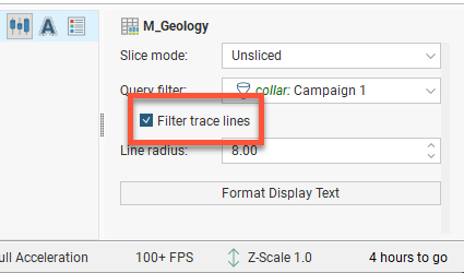

For a drilling data table, this displays only the data selected by the filter. The trace lines remain displayed in the scene. To filter out the trace lines so they are not displayed in the scene, tick the Filter trace lines box:
