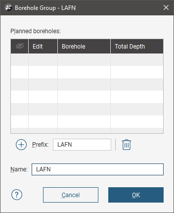

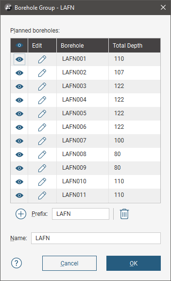

To plan a borehole, first add the data objects to the scene that you will use in helping to define the borehole, such as the topography and any existing boreholes. Next, right click on the Planned Boreholes folder and select New Borehole Group. In the window that appears, you can define basic information about the group, including the Prefix used for each borehole added to the group:

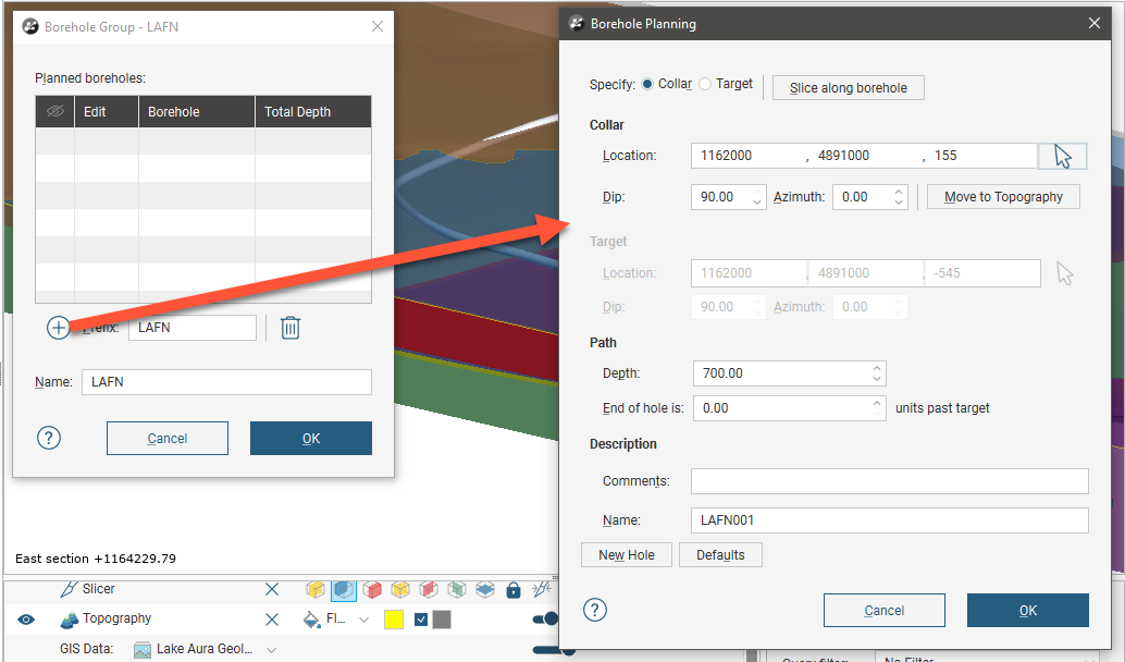

Start defining boreholes by clicking the Add button ():
You can change whether Collar or Target is selected when this window is opened by clicking on the Defaults button. See Planning Options below.
A name is automatically generated for the new planned borehole based on the Prefix defined for the group.
There are three ways to define the borehole collar or target:

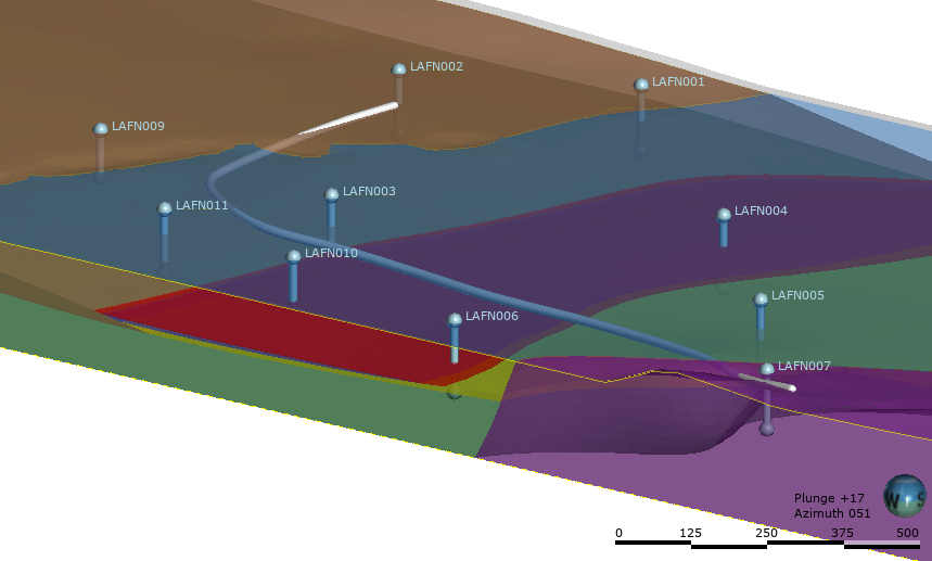

  • Click in the scene to set the collar or target location. First, click on the Select button () for the Collar or Target, then click in the scene to define the Collar or Target. The borehole will appear in the scene and you can adjust the coordinates using the controls in the Borehole Planning window. Click the Slice along borehole button to draw a slice in the scene. This is useful in adjusting the borehole path and in defining subsequent boreholes.
  • Draw the borehole in the scene. Click on the Select button () for the Collar or Target, then click and drag in the scene to define a basic path for the borehole. If you are defining the borehole from the collar down, click first on or near the topography. Likewise, if you are defining the borehole from the target up, click first at or near the target point.
  • Enter the coordinates for the Collar or the Target in the Borehole Planning window.
Clicking the Move To Topography button adjusts the elevation of the borehole so that it lies on the topography.
Click the Next Hole button to create another planned borehole. The new planned borehole will be created at a specific distance from the currently displayed planned borehole using the Path settings for the currently displayed borehole and the Offset To Next Hole settings in the Borehole Planning Options window. See Planning Options below.
Once you have specified the collar or target, adjust the borehole path:
  • Lift is how much the borehole deviates upward.
  • Drift is how much the borehole deviates laterally.
  • Leapfrog Works automatically calculates the Depth value when the borehole is defined by the Target location.
  • Adding an End of hole length extends the borehole past the Target location.
Once you have finished defining planned boreholes, click OK to return to the Borehole Group window.
You can change the automatically generated name by clicking on the borehole in the list and editing the text.
Search for planned boreholes in the list by pressing Ctrl-F. A Find window will appear that you can use to search the list.
Click the Edit button () to change the settings for a planned borehole, or click OK to save the group.

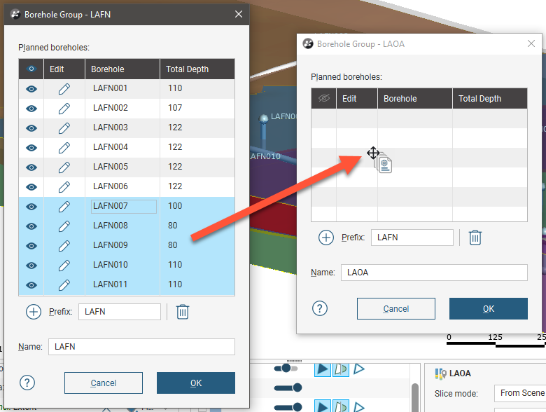

You can copy planned boreholes between groups by opening both groups, then dragging boreholes between the groups. For example, here the boreholes selected in the first group are being copied into the second group:
This copies boreholes from group to group, rather than moving them, so once copied, you will need to delete the planned borehole from the group it does not belong to.

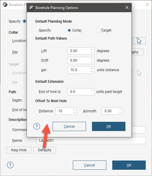

Planning Options
Borehole planning options are set on a per-project basis. To change borehole planning options, you can:
  • Right-click on the Planned Boreholes folder in the project tree and select Edit Planned Boreholes Defaults.
  • Right-click or on a borehole group in the project tree and select Edit Planned Boreholes Defaults.
  • Click the Default button in the Borehole Planning window.
  • In each case, the Borehole Planning Options window will appear:
  • Select whether new planned boreholes are specified by the Collar or by the Target.
    The Offset To Next Hole values apply when defining multiple boreholes in the Borehole Planning window.
    Enter the information required and click OK. The new settings will be applied to the next new planned borehole added to the project.

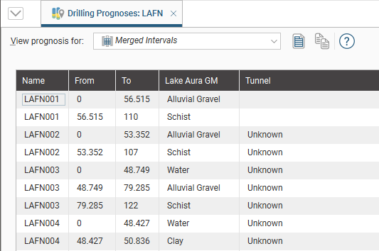

    Planned boreholes can be evaluated against any model in the project. To view drilling prognoses for a borehole, right-click on a borehole group in the project tree and select Drilling Prognoses. The Drilling Prognoses tab will appear:
    The dropdown list contains all evaluations on the borehole group, along with a Merged Intervals option that combines the information from all evaluations. You can copy the information displayed to your computer’s clipboard by selecting rows, then clicking the Copy button (). The information in the selected rows will be copied as tab delimited text, which can be copied into a spreadsheet application such as Excel.

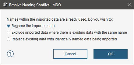

    When importing planned boreholes, you can import them into a new group or into an existing group. To import planned boreholes, right-click on the Planned Boreholes folder or on a group and select Import Planned Boreholes. If the IDs in the file are already in the project, you will be prompted to resolve the conflict:
    You can:
    • Rename the imported boreholes. Leapfrog Works will automatically assign new names and import the planned boreholes.
    • Exclude planned boreholes that already exist in the project. Planned boreholes will only be imported if they have an identifier that does not already exist in the project.
    • Replace existing planned boreholes with the imported boreholes. Use this option if you are importing information previously exported from the project and subsequently updated in an external application.
    Click OK to process the file.
