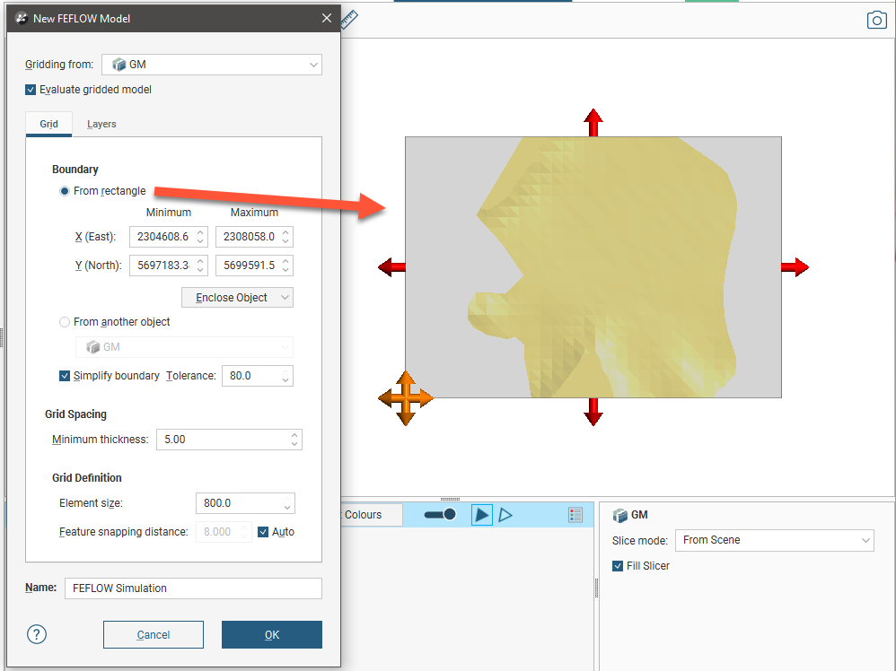

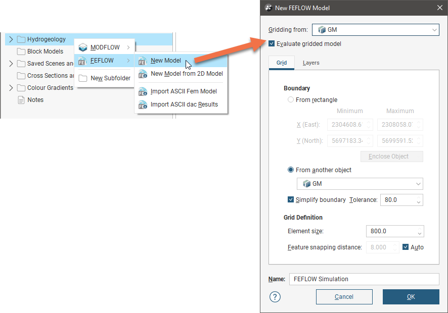

To create a new FEFLOW model without using an existing 2D grid, right-click on the Flow Models folder and select FEFLOW > New Model:
The New FEFLOW Model window will appear. In this example, a geological model has been added to the scene to aid in defining the FEFLOW model:

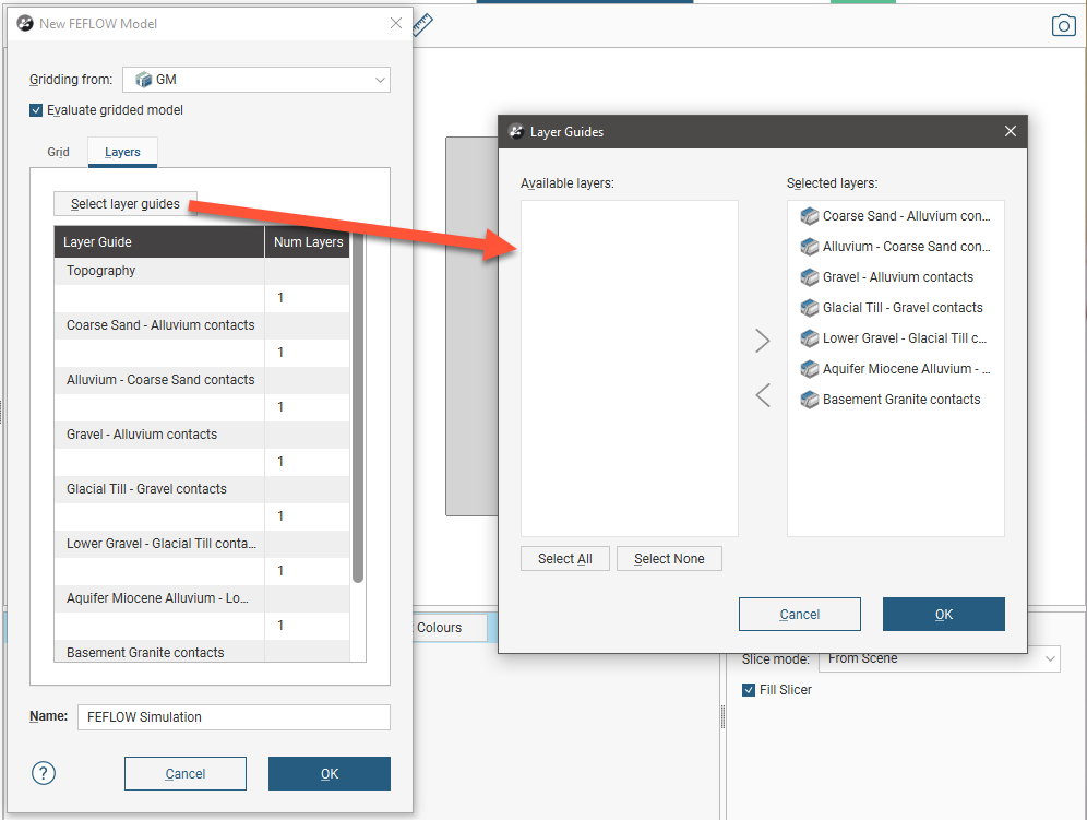

The Gridding from setting determines the geological model used for layer guides. Ticking the Evaluate gridded model box will evaluate the new 3D model against the selected geological model and set it as the evaluation for export. See FEFLOW Evaluations below for more information. If you do not wish to evaluate the geological model on the grid, untick the box. You will still be able to use the layers in the geological model to control the grid layers.

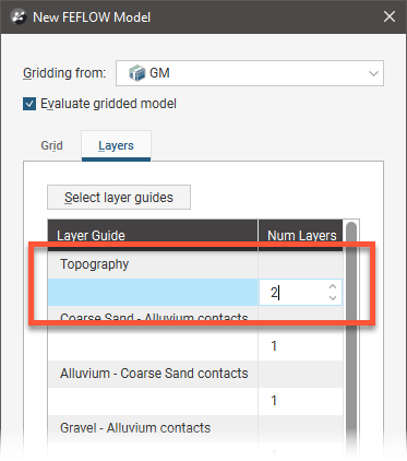

Click on the Layers tab to see the layers that will be used in the new 3D model. By default, the layers from the Gridding from model are selected as layer guides, but you can change this by clicking the Select layer guides button and changing which layers are used:
Once you have determined which layers you will use as layer guides, you can change how many layers there will be in the 3D model. To do this, click on a layer in the Layers tab and edit the Num Layers value:
The minimum thickness of each layer is determined by the Minimum thickness setting in the Grid tab. If there is a conflict between the Minimum thickness setting and the number of layers defined in the Layers tab, Leapfrog Works will display an error message when you click the OK button to create the model.

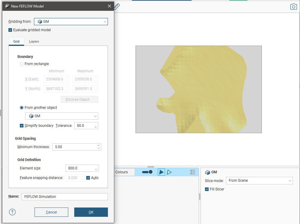

In the Grid tab, the model’s boundary can be defined as a rectangle or from another object in the project. In the example above, the geological model GM is used to define the FEFLOW model’s boundary. When the boundary is set to From rectangle, controls will appear in the scene that will help in setting the boundary:
The boundaries of the Gridding from model must be larger than the boundary of the new FEFLOW model.

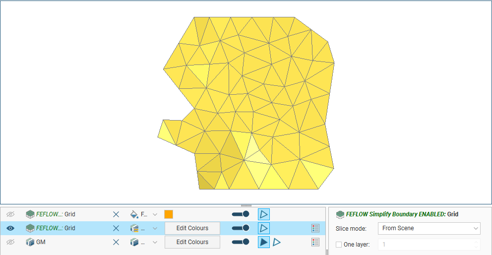

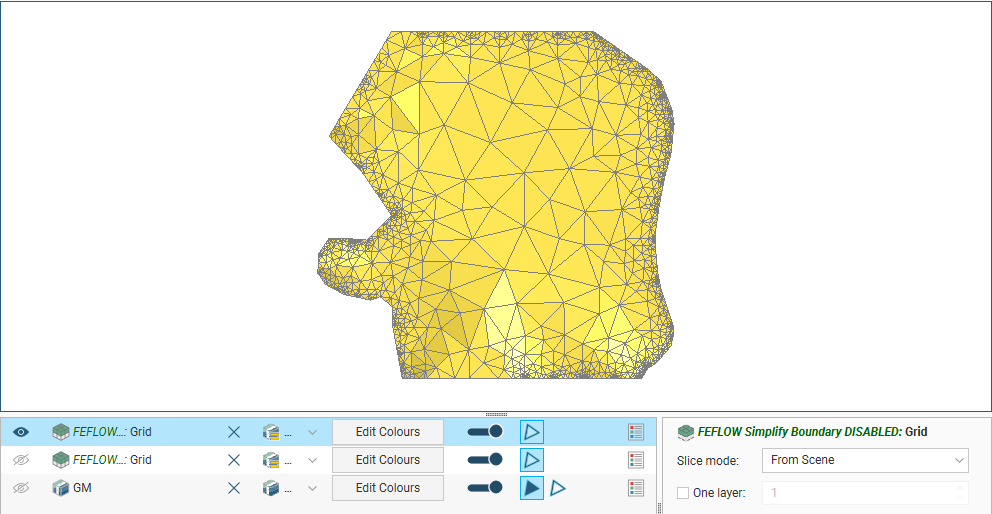

When the boundary is set from another object in the project, the Simplify boundary option can be used to reduce the number of points along the boundary. A lower Tolerance value increases the number of points along the boundary. The two settings together let you define a basic boundary with elements that are roughly uniform in size, set by the value of Element size. Here, a grid has been created from a geological model with the Simplify boundary option enabled:
The Element size setting determines the basic size of the triangles that make up the grid, although the size will vary according to features applied to the grid and the Feature snapping distance. The size will also vary if the Simplify boundary option is unticked, in which case the Element size setting is the maximum size of the triangles.
The Feature snapping distance is automatically set to 1 percent of the Element size. To use a smaller snapping distance, untick the Auto box and set the value required.
The effects of the Feature snapping distance do not become apparent until features have been added to the grid, after it has been created, which is described in Adding Features to the Grid below.
Click OK to generate the new FEFLOW model, which will appear in the project tree under the Flow Models folder.

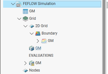

In the project tree, the FEFLOW model is organised into a 3D grid object () that contains a 2D grid (
To edit model settings such as the boundary, layer guides, Minimum thickness, Element size and the Feature snapping distance, double-click on the 3D grid object (). The geological model used for gridding cannot be changed.
Adding features to the grid involves working with the 2D grid, which is described in Adding Features to the Grid below.

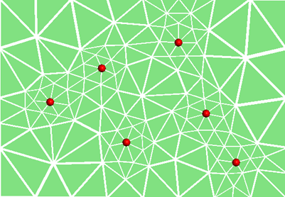

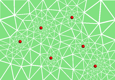

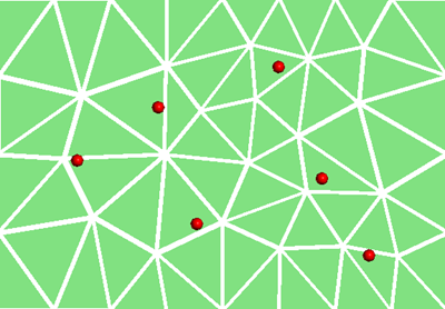

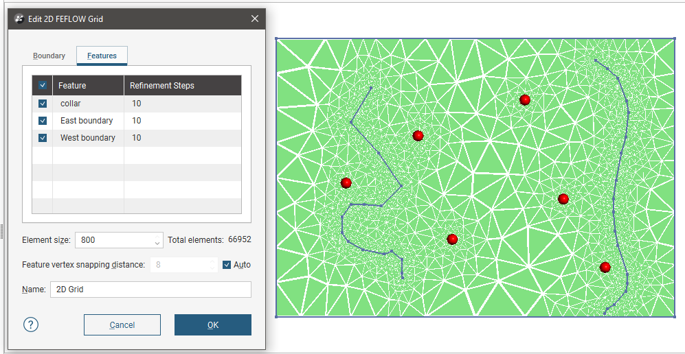

You can refine the resolution of the FEFLOW model by adding features to it around objects about which you have more information, such as drilling data.

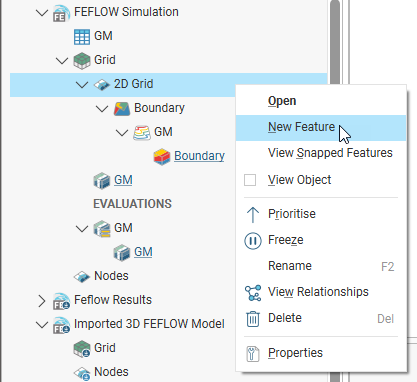

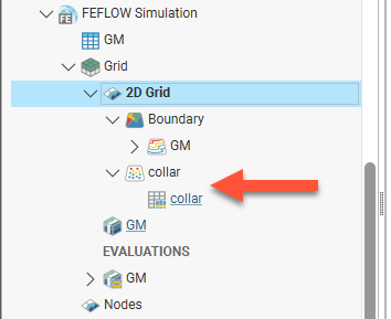

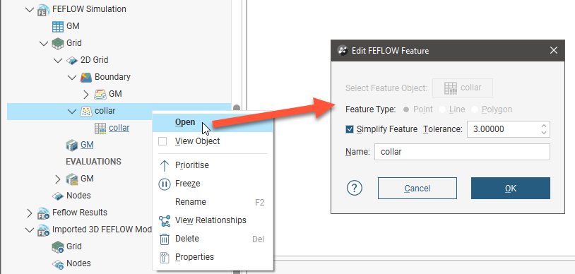

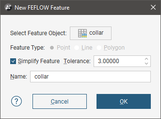

To add features to the FEFLOW model, expand it in the project tree, then right-click on the 2D grid object () and select New Feature.
Select the object you wish to use, then click OK to return to the New FEFLOW Feature window.
You can edit the feature by double-clicking on it or by right-clicking on it and selecting Open. In the Edit FEFLOW Feature window, you can enable or disable the Simplify Feature setting and change the Tolerance.

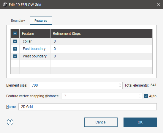

To view all features that have been applied to a FEFLOW model, double-click on the 2D grid object (). This opens the Edit 2D FEFLOW Grid window with the Features tab open, showing all features that have been added to the grid:
No features | Collars with 2 refinement steps | Collars with 10 refinement steps |

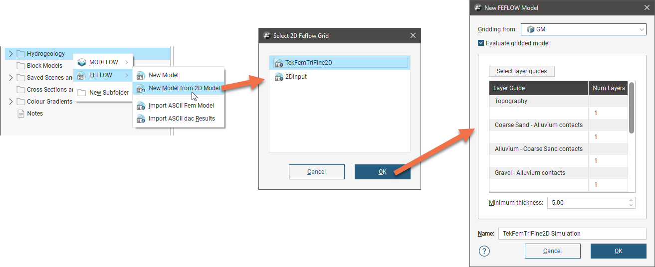

To create a new FEFLOW model from an imported 2D grid, right-click on the Flow Models folder and select FEFLOW > New Model from 2D Model:
The process is similar to that for Creating a 3D FEFLOW Model described above, except that you do not need to set the parameters in the Grid tab.
Once the model is created, you can evaluate models, set material types, set an evaluation for export and export the model to FEFLOW, just as you would with a model from a 2D grid created in Leapfrog Works. You cannot, however, add features to the grid.

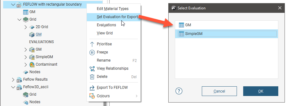

To evaluate models on a FEFLOW model, right-click on the model in the project tree and select Evaluations. You can evaluate more than one model on a FEFLOW model, but only one evaluation can be used as the evaluation for export. Interpolants and distance functions can be evaluated on the model but they cannot be exported and are simply used for displaying the grid in Leapfrog Works.
If only one geological model has been evaluated on a FEFLOW model, it will automatically be used as the model for export. If you have evaluated more than one geological model, you can choose which one to export by right-clicking on the FEFLOW model in the project tree and selecting Set Evaluation for Export
Select the model you wish to use, then click OK.

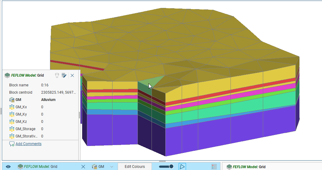

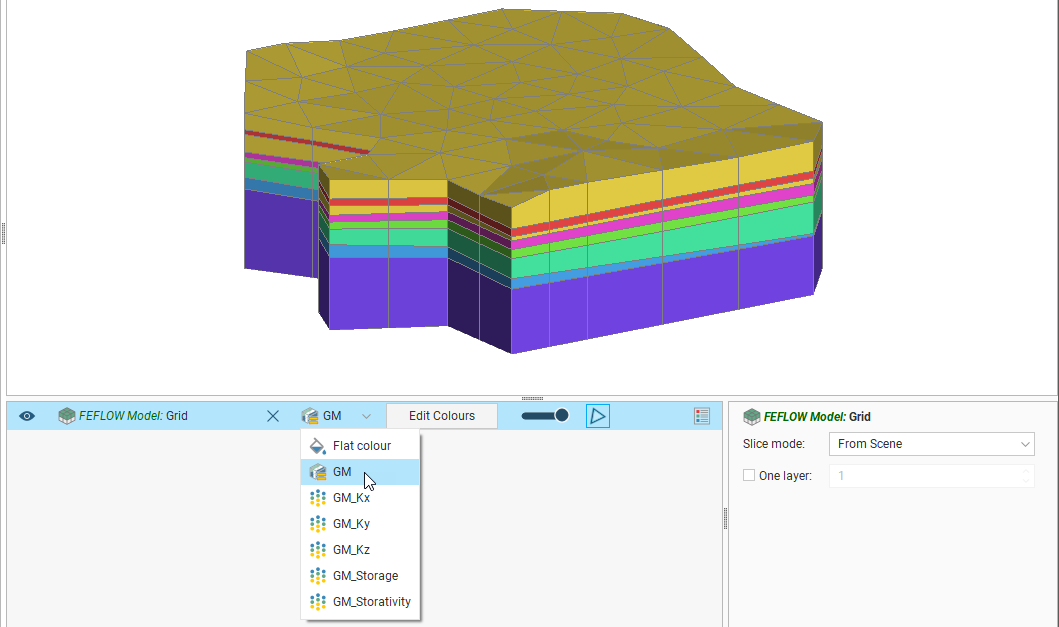

Dragging a 3D FEFLOW model into the scene displays its grid object, which represents the finite elements. Here, a 3D model created in Leapfrog Works() has been added to the scene:
For 3D models imported into Leapfrog Works, you can display the model using other information available for the grid, such as conductivity data. This is available from the view list.
When Show edges() is enabled, the edges of the blocks will be displayed.

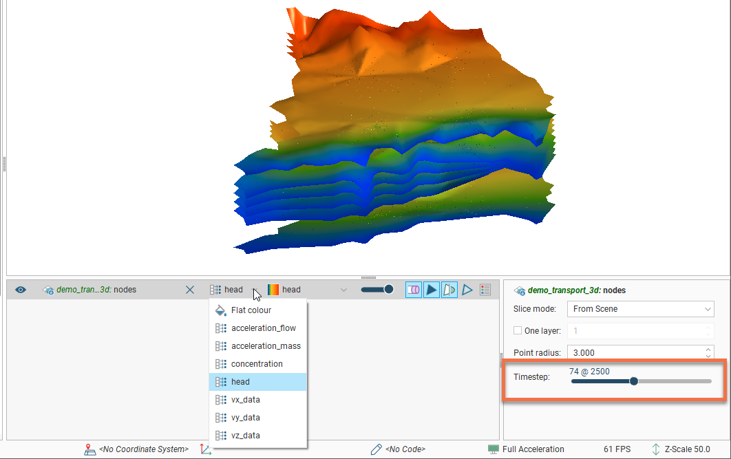

You can display the nodes by adding the nodes () object to the scene. When a model with results is displayed, the simulation outputs can be displayed when the nodes are viewed in the scene. Here, the nodes for an imported results file have been added to the scene. The heads are displayed for a single layer:

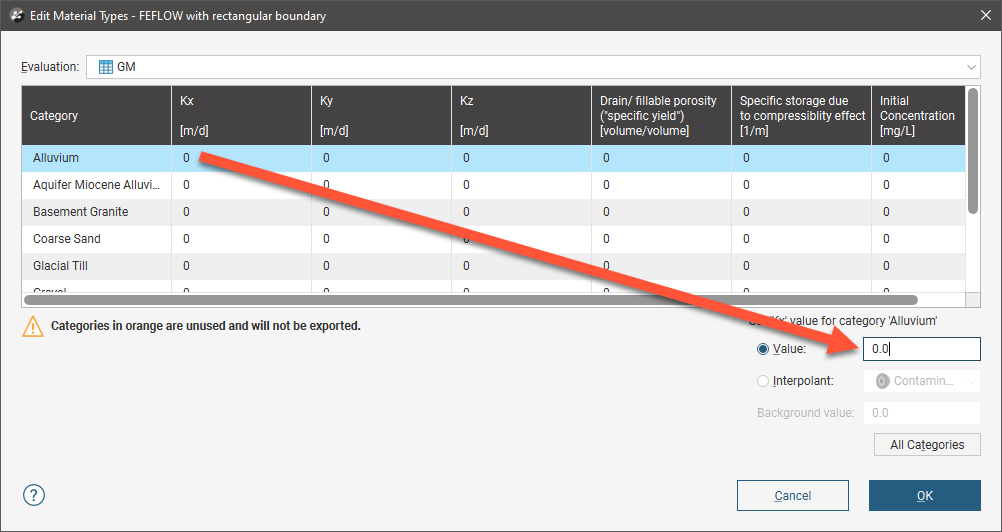

Editing FEFLOW Material Types

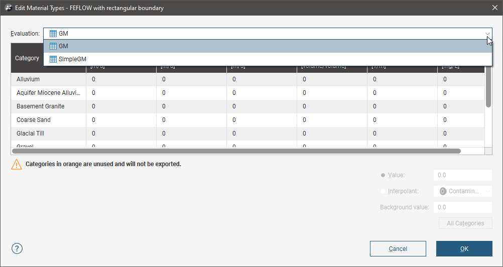

To edit a FEFLOW model material types table, you will first need to evaluate a geological model against the model, which is described in FEFLOW Evaluations above.

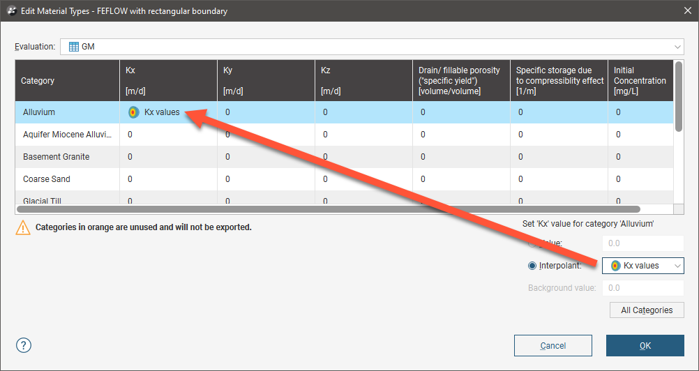

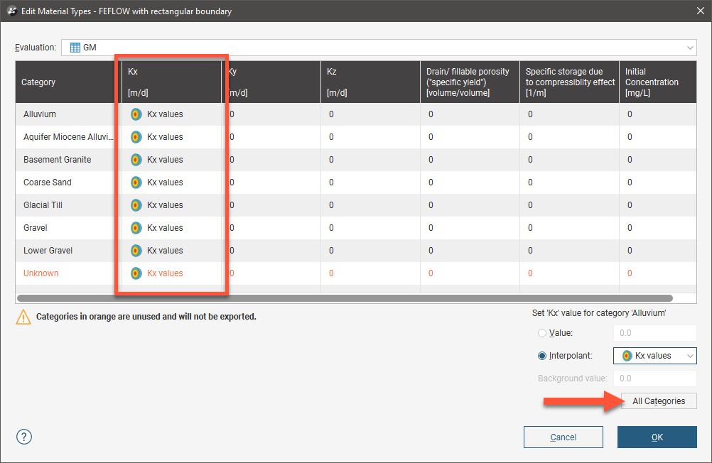

Once a geological model has been evaluated, edit the material types table by right-clicking on the model in the project tree and selecting Edit Material Types. The Edit Material Types window will appear. If more than one object has been evaluated on the grid, you can edit material types separately for each evaluation. Select the required evaluation from the Evaluation list:
Note that whether or not you set values for the initial concentration column will affect what format will be used when the FEFLOW model is exported. See Exporting FEFLOW Models below for more information.
You can enter the values for material types manually or you can use the values from an interpolant.
Click OK to update the grid.
