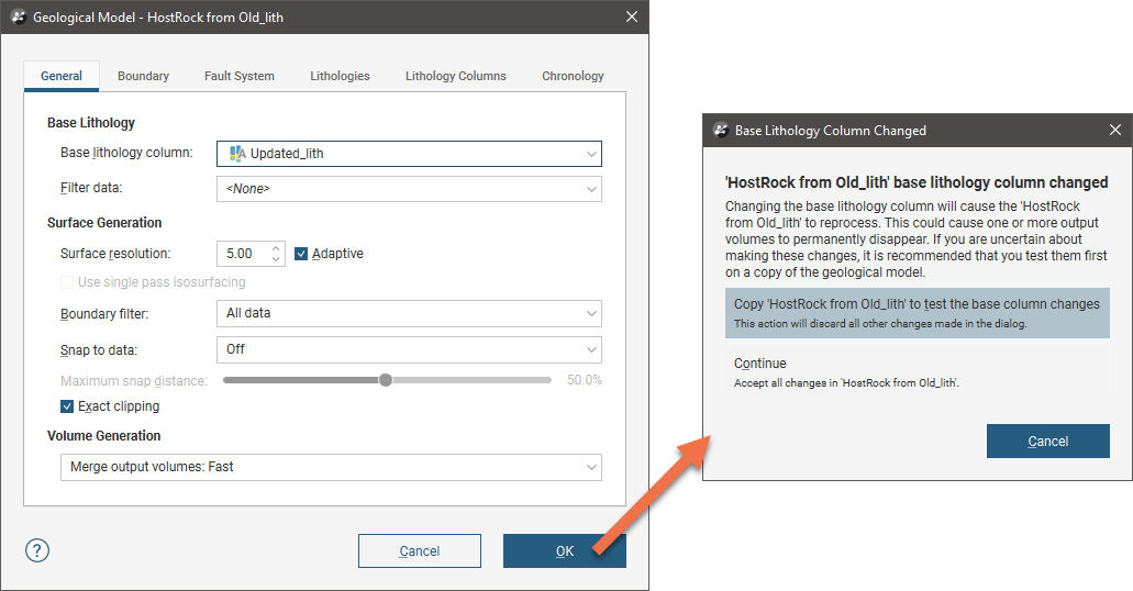

Clicking Copy to test the base column changes will discard the changes you have made in the Geological Model window, including those not related to changing the base lithology column. A copy of the model will be added to the project tree. You can then experiment in the copy before going back and making the change in the original model.
Clicking Continue will result in the geological model being reprocessed to use the base lithology column, with no copy being made.

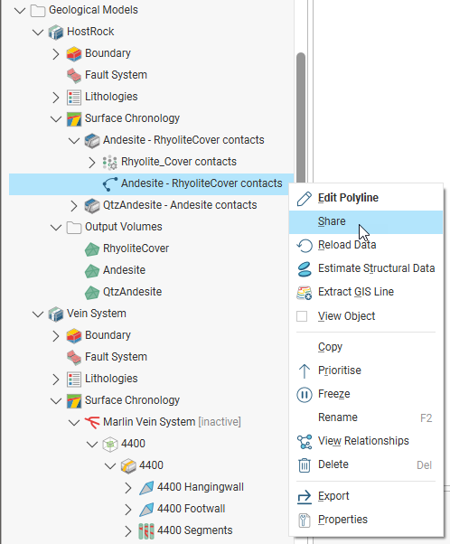

For all contact surfaces, if you have edited the surfaces with polylines or structural data, make sure the polyline or structural data table is shared rather than local. See Sharing Objects in Managing Data Objects in a Project.

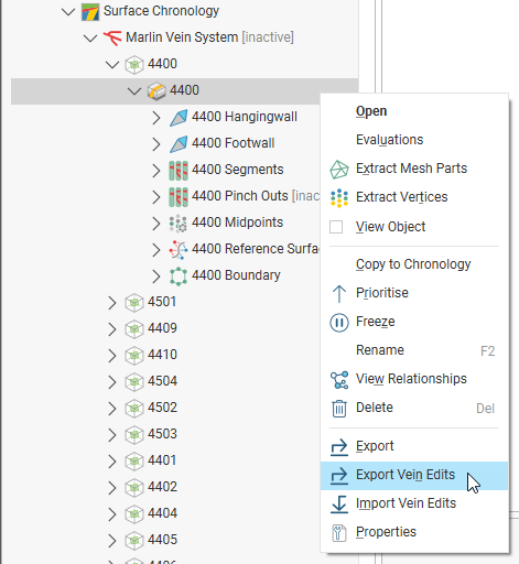

For veins, export any edits you have made to vein surfaces as described in Exporting and Importing Pinch Out, Segment and Midpoint Edits in the Veins topic.

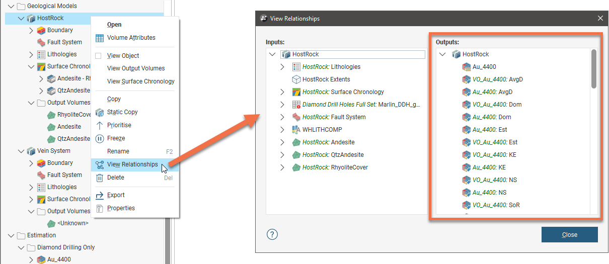

Checking for Downstream Effects
A geological model’s surfaces and volumes can be used as inputs to other models in Leapfrog Works. Changing the geological model’s base lithology column will update all surfaces and volumes that are built from the base lithology column, and so other dependent models will be affected by changing the base lithology column.
Use the View Relationships tool to check relationships between the geological model and other objects in the project. For example, here we can see that changing the base lithology column for the HostRock model has the potential to impact all the objects in the Outputs list:
Note that when you make a test copy of the geological model to experiment with the effects of changing the base lithology column, this will only tell you what the effects are in the model itself. Only the original geological model is linked to dependent objects in the project; copies are not linked.

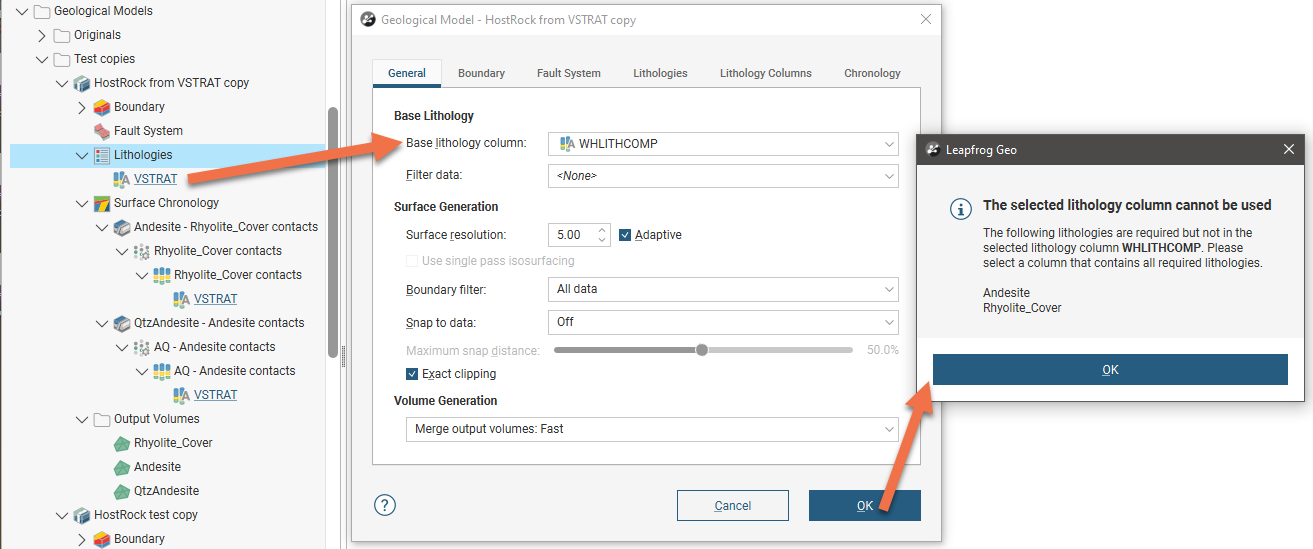

If the new column does not contain the required codes, Leapfrog Works will not let you change the base lithology column. For example, here the model is using the column VSTRAT and we want to change it to WHLITHCOMP. The error message tells us what lithology codes are missing from the WHLITHCOMP column:
Click OK to dismiss the message, then Cancel to close the Geological Model window without making changes.

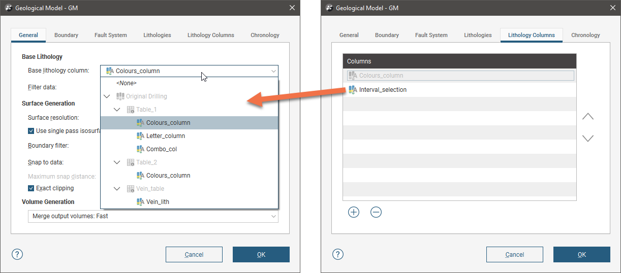

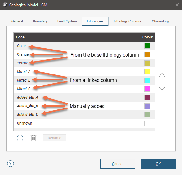

When you open the Geological Model window, how the lithology codes are displayed in the Lithologies tab tells you from what sources they were derived:

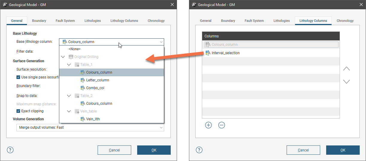

You cannot switch to using a column that is already linked to the model, i.e. one listed in the Lithology Columns tab whose codes are used in the Lithologies list. It simply will not appear in the list of Base lithology column options:
You can remove the linked column; once the model is reprocessed, surfaces that use that code will instead use the code set as the Background lithology (in the Surface Chronology tab). By default, the Background lithology for a geological model is the code Unknown.

Leapfrog Works prioritises a geological model’s lithologies as follows, from high to low:
- Base column codes
- Manually defined codes
- Codes from linked columns
Because linked columns have lowest priority, if codes from linked columns exist in the newly-selected base lithology column, having duplicate code names in linked columns and the base column is not an issue; the codes in the base lithology column will have priority and the duplicated in the linked columns will be ignored.

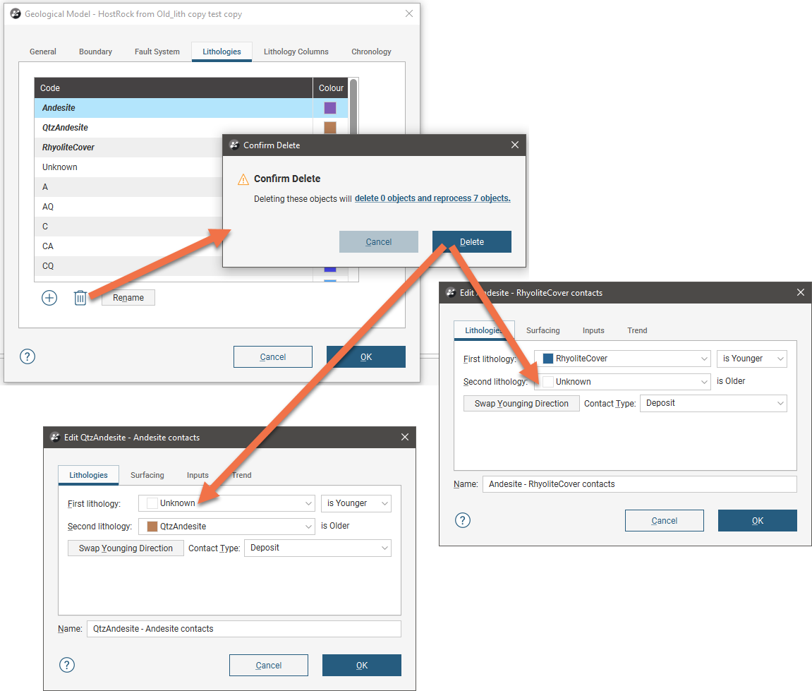

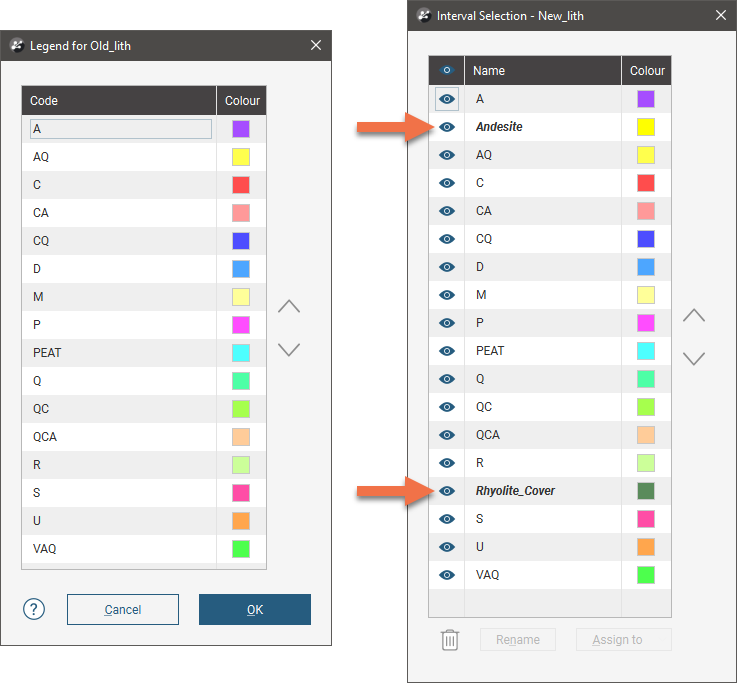

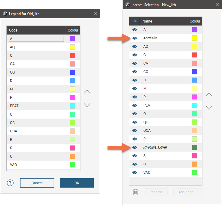

In this example, we want to change from the original lithology column, Old_lith, to an interval selection that contains Andesite and Rhyolite_Cover codes:

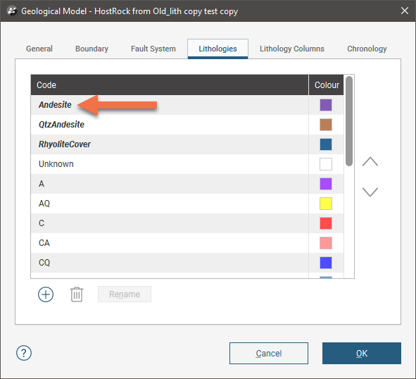

Looking at the geological model’s lithologies, we can see that it contains the manually defined code Andesite, which will conflict with the Andesite code in the New_lith column:
Note that the Andesite code in the New_lith column uses the colour yellow, whereas the manually defined code uses purple.

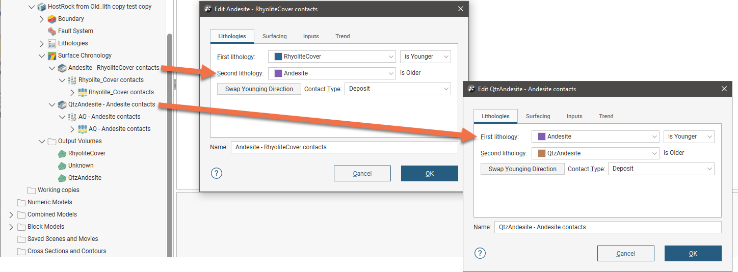

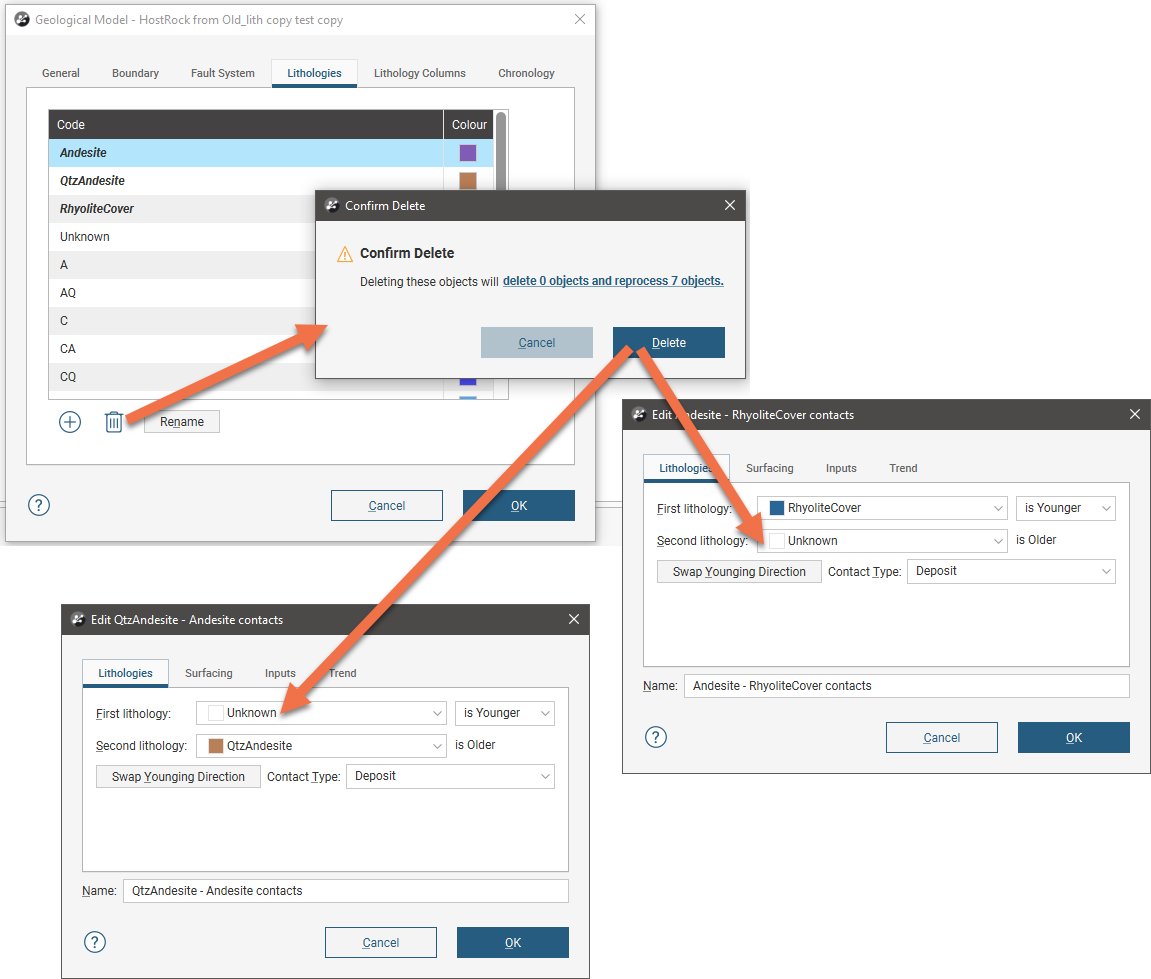

If you have only one or two codes that conflict, deleting the manually defined codes may be the best approach.

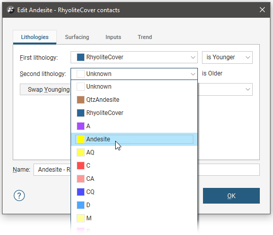

In our example model, the manually defined Andesite code is used in two contact surfaces:
Deleting the Andesite code will result in these surfaces being reprocessed with the code Unknown being assigned in place of the Andesite code:
Once we have changed the base lithology column, we can then remap the codes assigned to the surfaces:

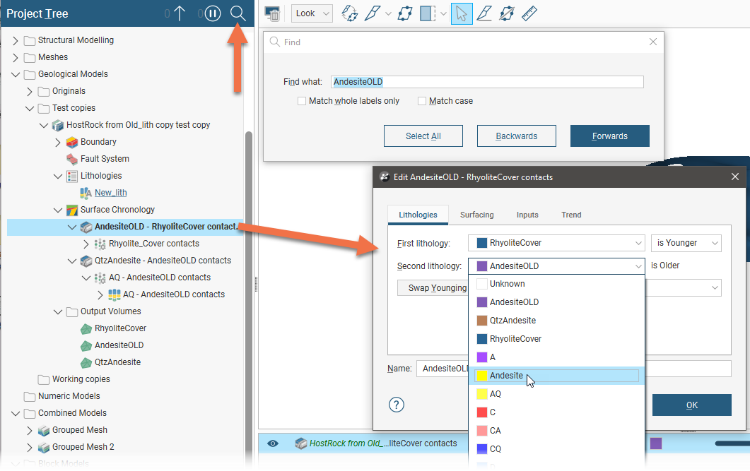

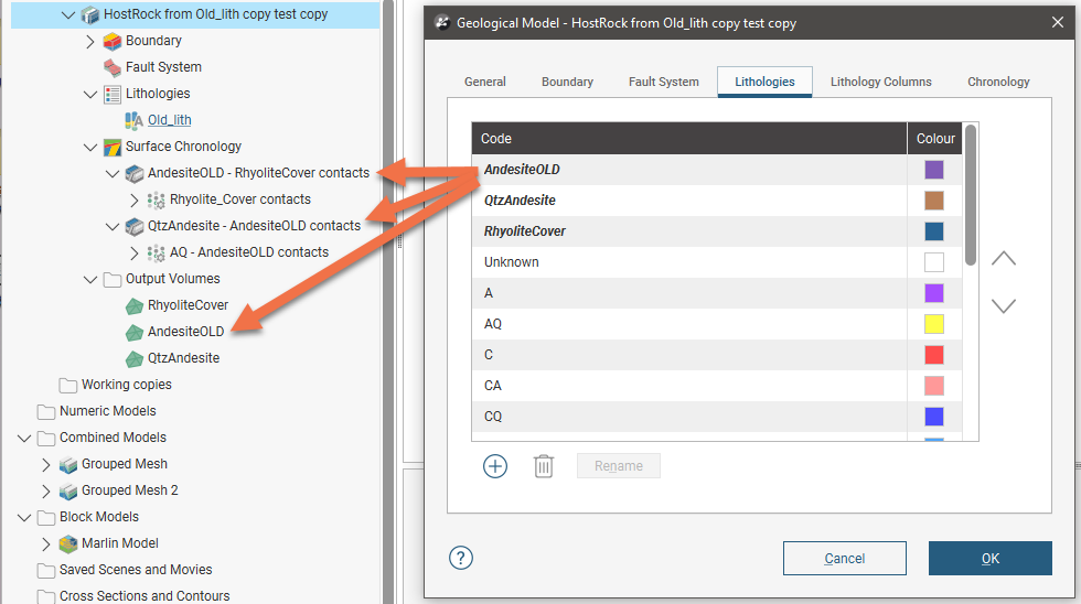

In a model with a lot of contact surfaces and multiple manually defined codes, another approach would be to rename the manually defined codes so they will not conflict with the code in the New_lith column. Objects using renamed coded will also be renamed, as shown here when the manually defined Andesite code is renamed:
Once the base lithology column has been changed, we can then search for the renamed code in the project tree and switch the lithology used by contact surfaces to the code in the new base lithology column:
