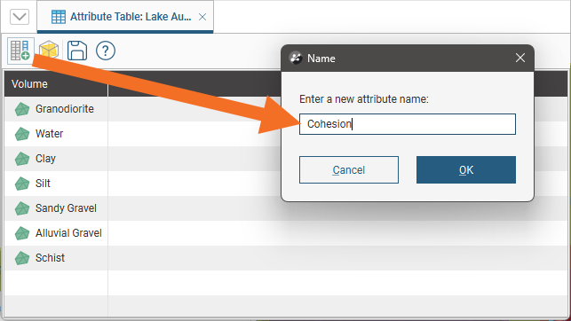

For geological models, numeric models and combined models, you can assign attributes to the model volumes. To do this, right-click on the model in the project tree and select Volume Attributes. In the window that appears, click the Add Attribute button () to add a new column.

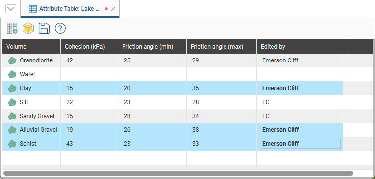

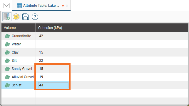

You can then add values for each cell in the new column; click in a cell to edit its content. Recently edited cells are highlighted in bold until you save the changes to the table. For example, here the last three values have been added since the attribute table was last saved:

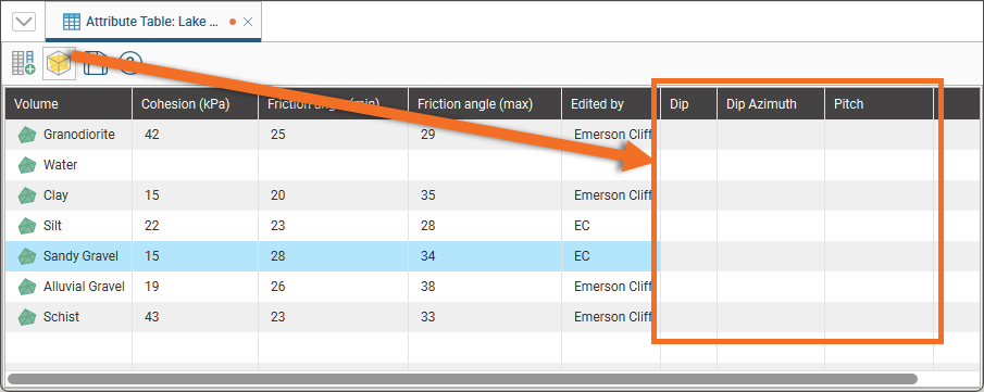

Click the Add Directions button () to add Dip, Dip Azimuth and Pitch columns:

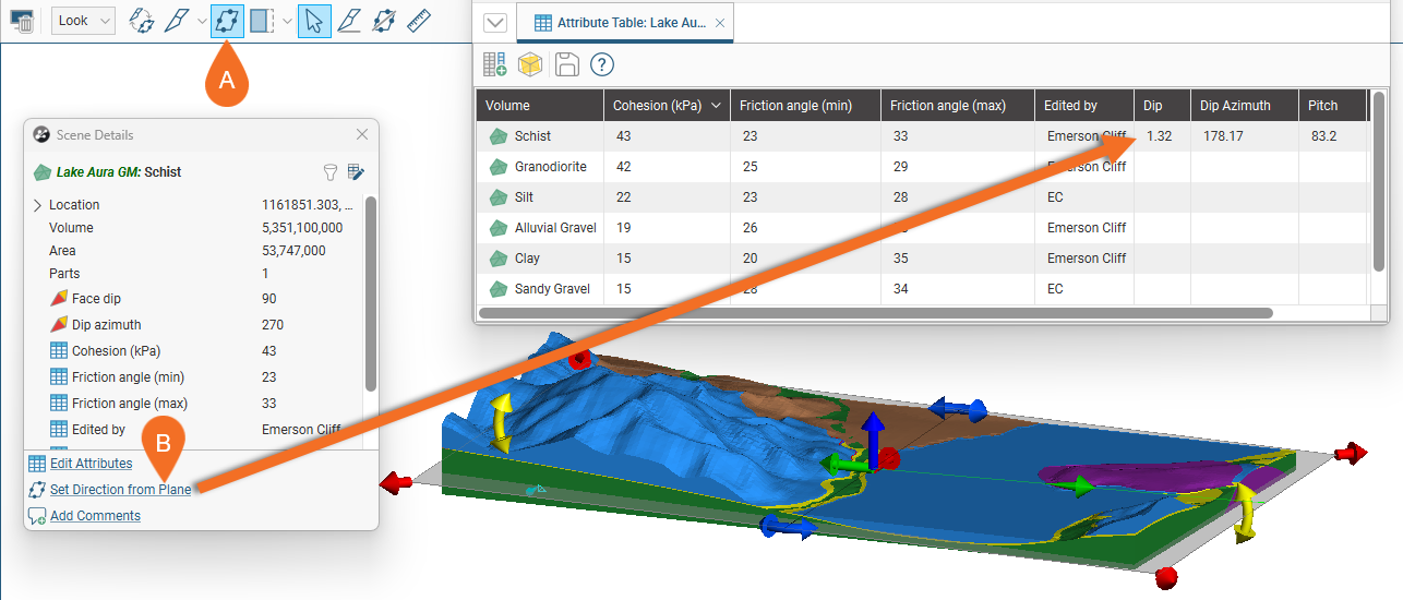

You can use the moving plane to set direction attributes to populate these columns. Add the model to the scene, then add the moving plane (A) to the scene. Adjust the moving plane to reflect the directions you wish to use. Next, click on the part you wish to set directions for, then in the Scene Details window, click Set Direction from Plane (B):
The volume attributes will be updated to use the directions from the plane.

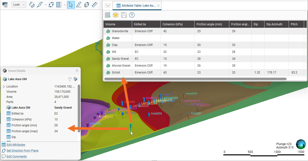

When you click in the scene, the values will be included in the information displayed about the selected volume:
