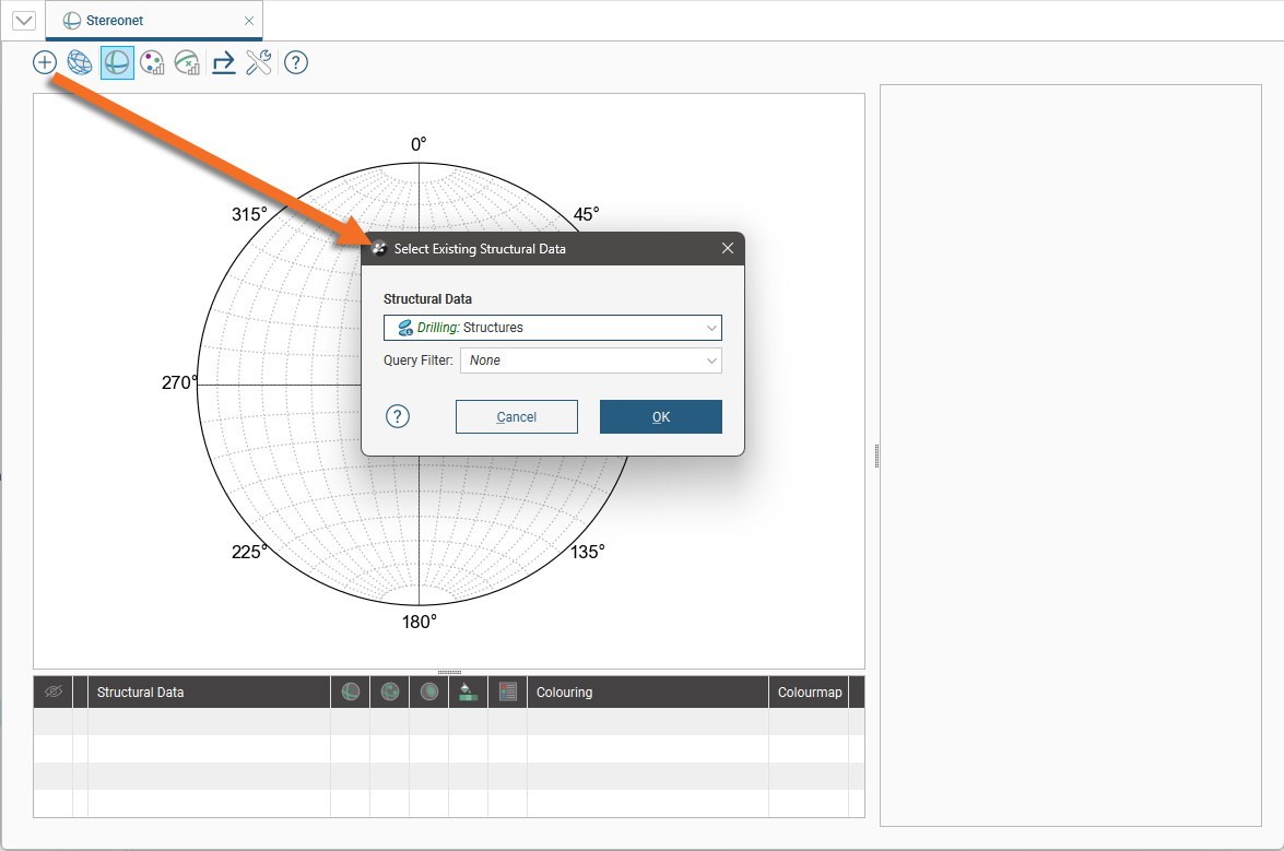

Create a stereonet by right-clicking on the Stereonets folder (in the Structural Modelling folder) and selecting New Stereonet. The stereonet is created and opened in a new tab. Click the Add button () to add any structural data table in the project to the stereonet:
You can also drag and drop structural data objects from the project tree into the stereonet.

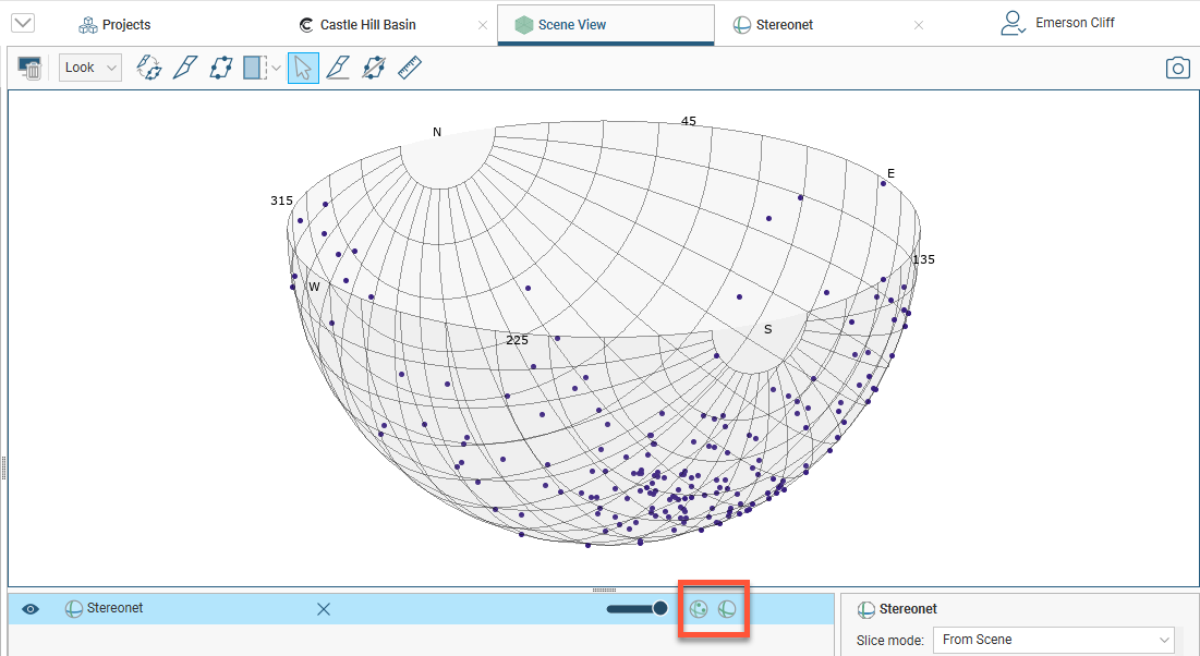

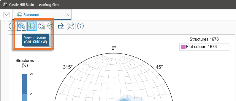

You can display the stereonet in the 3D scene by dragging the stereonet from the project tree into the scene or by clicking on the View button () in the stereonet window:
You can display planes and poles in the 3D scene, but not contours. In the shape list, you can control whether planes or poles are displayed in the scene:
Otherwise, the appearance of the stereonet in the 3D scene is controlled from the stereonet window.

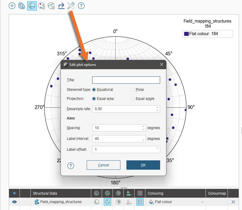

Click the Options button () to change plot options:
There are two types of stereonets available, Equatorial and Polar. You can also choose between Equal area (Schmidt) and Equal angle (Wulff) projections.
The Desample rate affects how quickly data is displayed by combining points with duplicate orientations, as determined by the Desample rate value. A low value will filter fewer data points, whereas a higher value will filter out more data. Setting the Desample rate to 0 plots all points, which may be slow for very large datasets that have not been declustered. The Desample rate applies only to how data is displayed; it does not affect the data in the table.

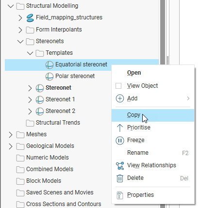

Note that the settings in Edit plot options window only apply to the current stereonet. If you want to create a stereonet “template” for your project, you can create a new stereonet with different plot options and make copies of it in the project tree:

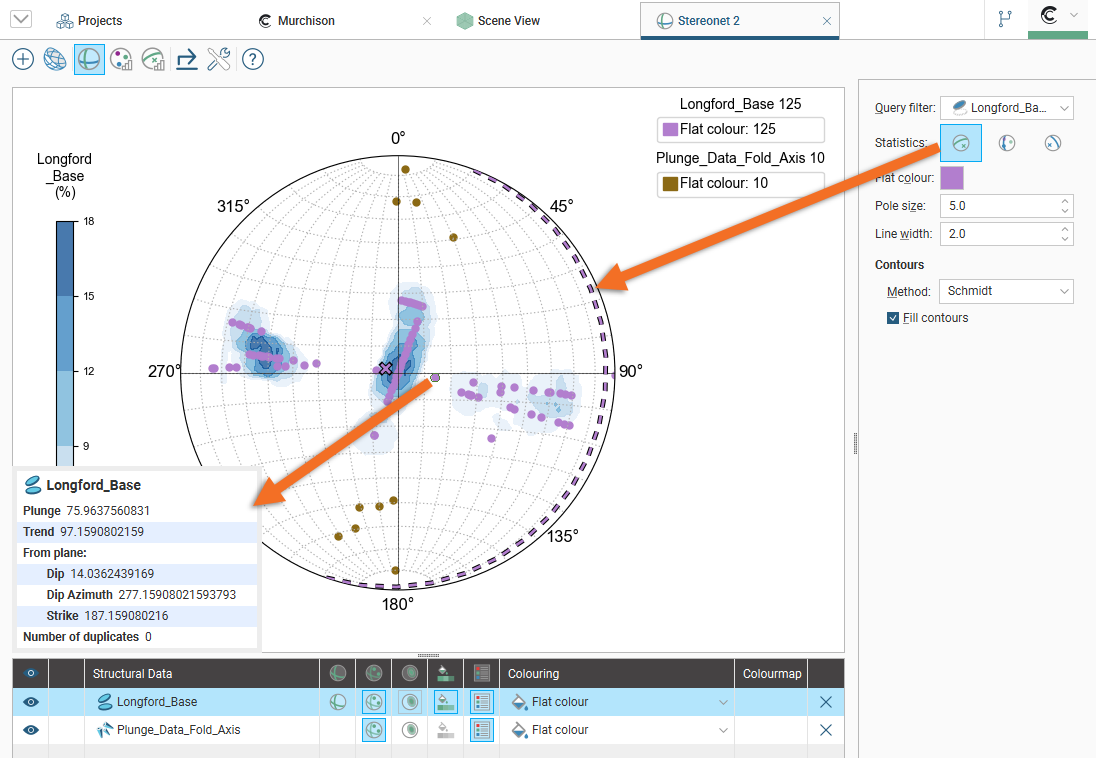

Click on a line or pole to view information about the data point and click the mean button () to view the Fisher mean on the stereonet, which is displayed as a line for planar structural data and ellipsoids and as an X for lineations:
The information displayed includes whether or not there are duplicates of the selected data point in the dataset.

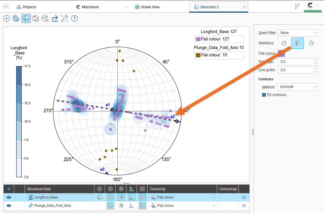

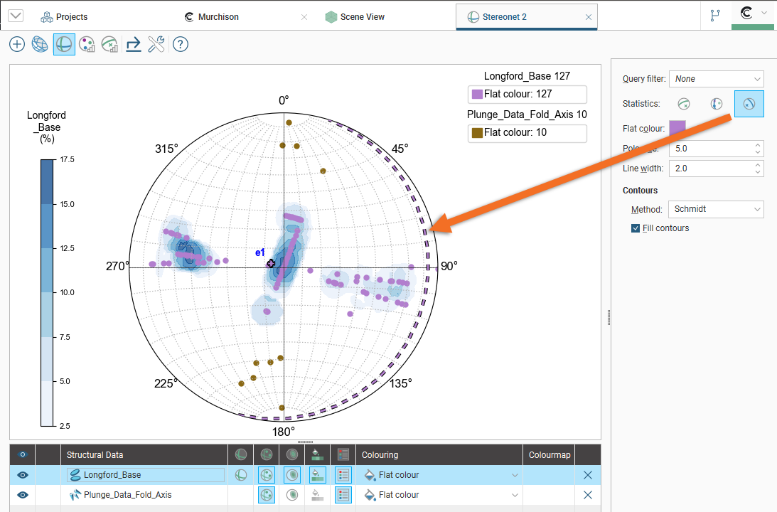

When the data is displayed using the flat colour option, you can display the Bingham best-fit plane () and eigenvectors e1, e2 and e3:
For planar structural data and ellipsoids, you can also display the Bingham mean plane ():

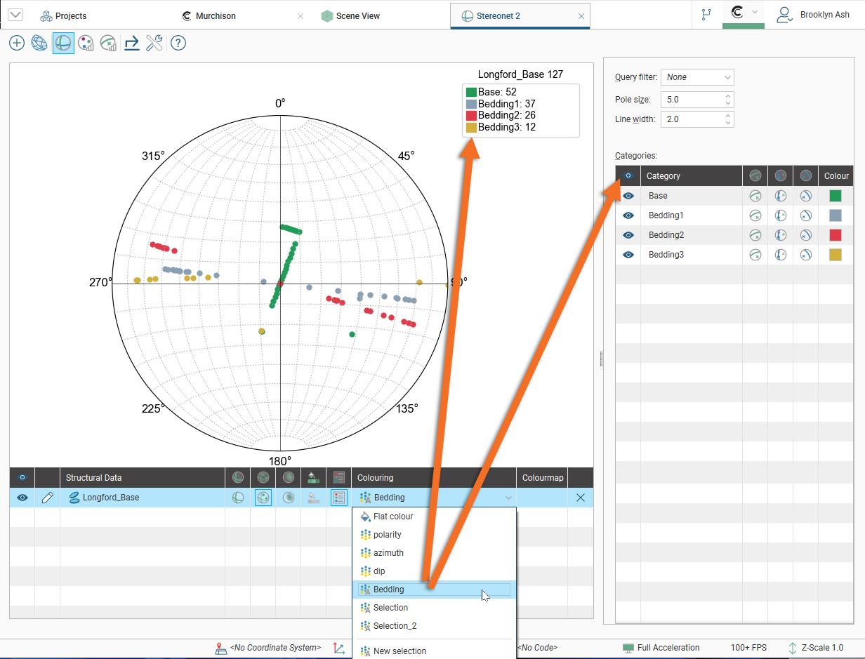

A legend can be displayed for the stereonet as a whole () and for the contours (
). The stereonet’s legend is generated from the categories that are visible in the list of colourings. Here, the categories displayed are from the Bedding column:

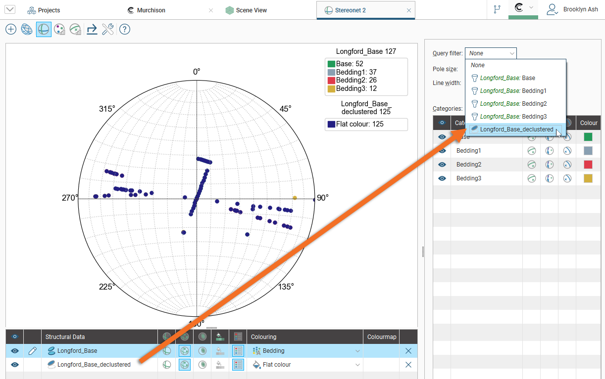

Declustered data can be viewed on stereonets in two ways:
- Declustered data can be viewed directly on the stereonet. Simply drag the declustered table into the stereonet.
- If the declustered data’s parent data table is displayed on the stereonet, the declustered data is available as a filter.
For example, here a structural data table () is displayed on a stereonet along with a declustered table (
). The declustered table is available as a query filter for its parent object:

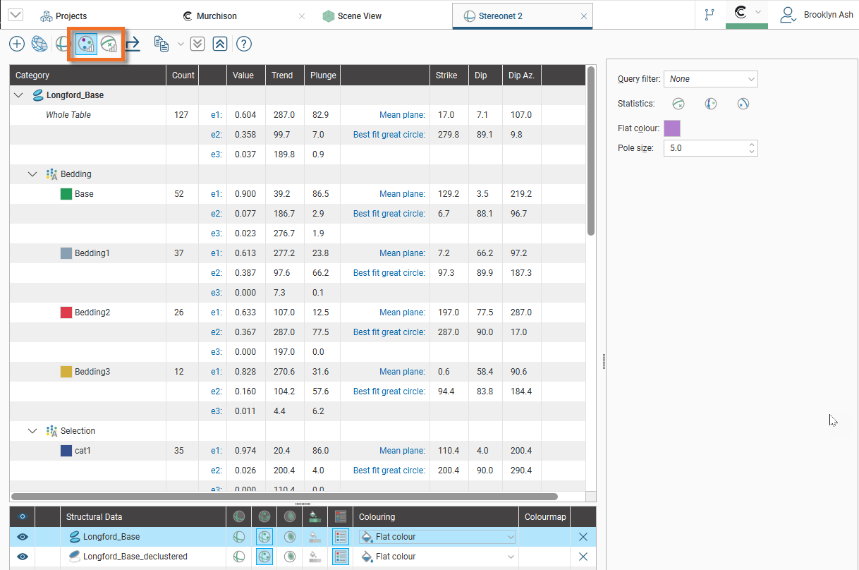

Viewing Stereonet Statistics
To view statistics on the data displayed on the stereonet, click either the Bingham button () or the Fisher button (
You can select specific rows and copy them to the clipboard or copy all data to the clipboard.

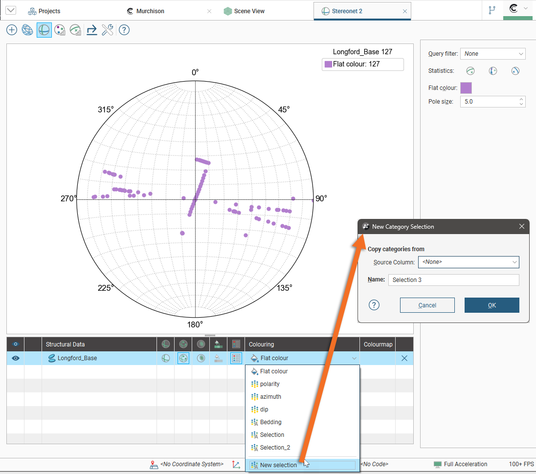

You can select data in the stereonet and assign it to new categories or existing ones. To do this, click on the data table in the stereonet window and select New selection from the colouring list:
The New Category Selection window will appear. The poles will be displayed in the stereonet, if they are not already visible, and the data table will also be added to the scene window.
Organising the stereonet tab and the Scene View tab so they are displayed side-by-side can be useful in working with the data as you can select data in the stereonet or in the scene window. This is described further in Using the Scene Window With the Stereonet below.
If you select an existing column as the Source Column, you can assign selected points to the existing categories or create new categories. If you select <None> for the Source Column, you will have to define each category manually.

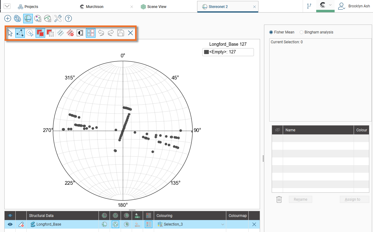

Enter a name for the new column and click OK. Tools for selecting points will appear in the stereonet tab.

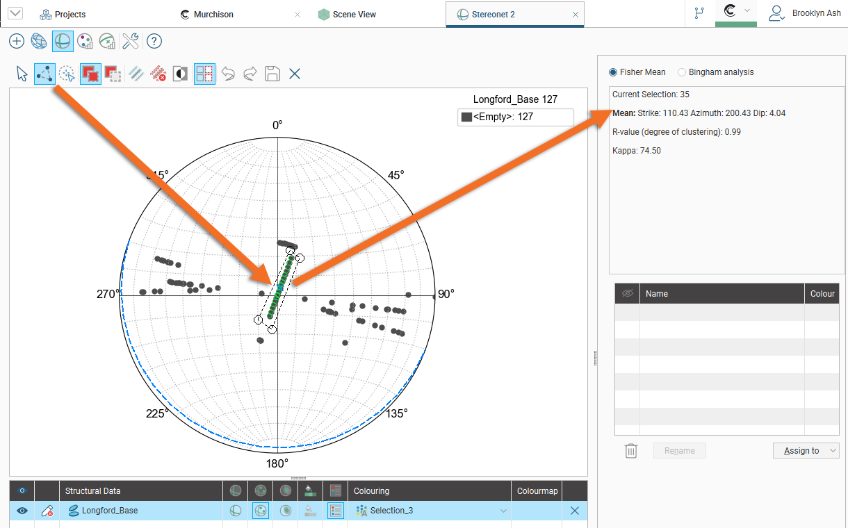

There are two tools for selecting data in the stereonet, the polygon tool () and the bullseye (
) tool.
- Use the polygon tool (
) to draw around the points you wish to select. Closing the polygon will select the points, and you can click on the vertices to refine the shape of the selection. Click outside of the selection to clear the polygon.

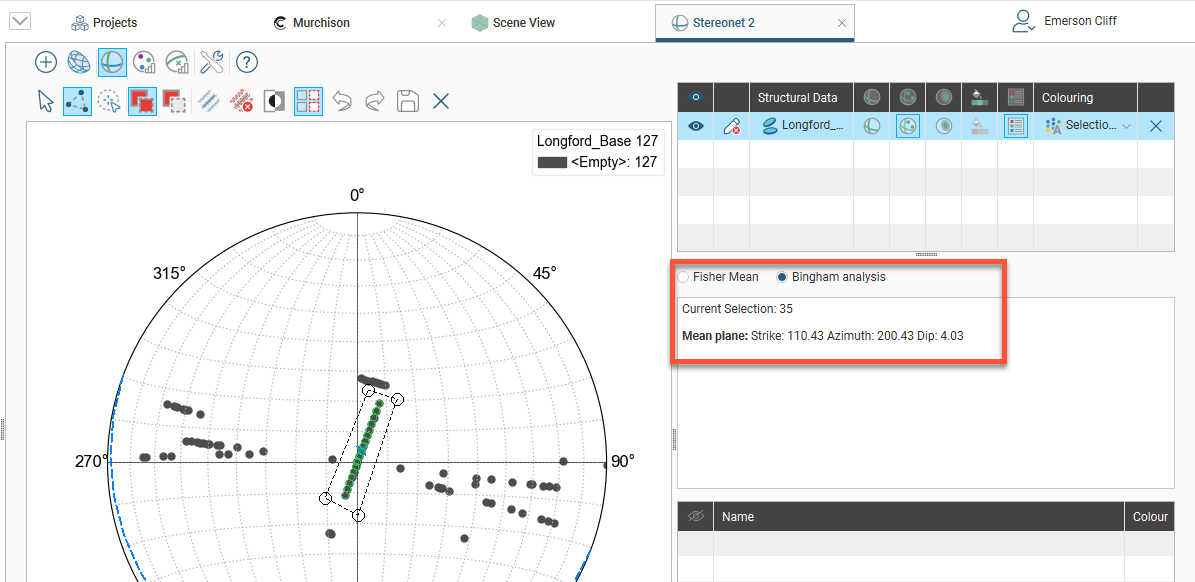

Statistics are shown for the currently selected set of points:
You can choose what type of statistics to display for selected points:

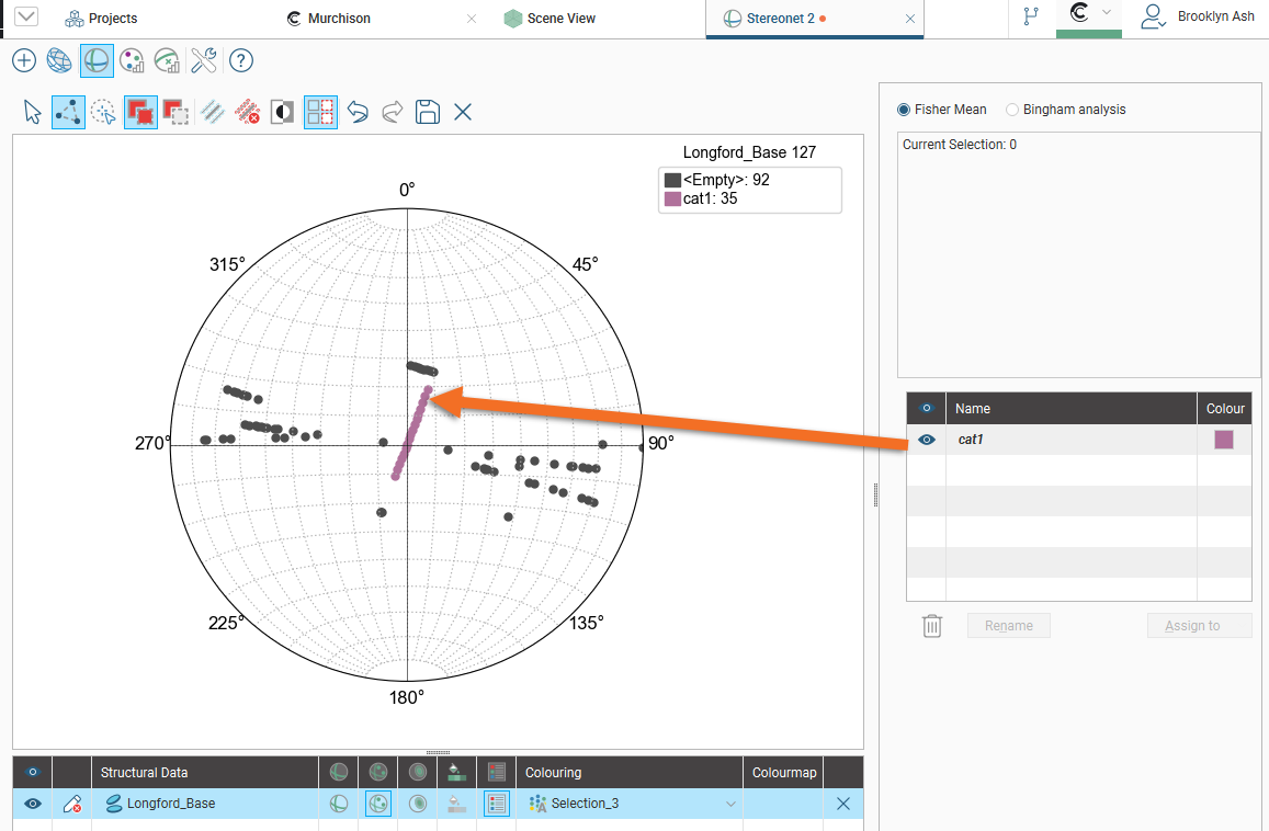

Once you have selected a set of points, click the Assign to button in the stereonet window, then select Create New Category. In the window that appears, enter a name for the category and assign a colour:
Click OK. The new category will be created and the stereonet will be updated to reflect the changes:

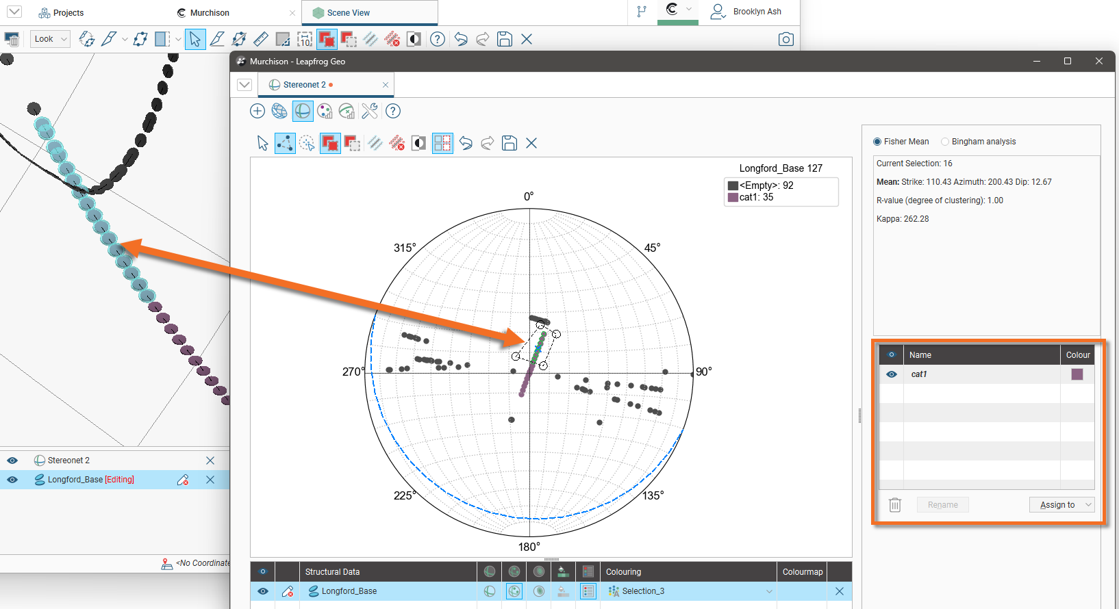

You can also select points in the scene window by clicking on the Select points tool (), then drawing over those points in the scene:
Controls for assigning points to categories will remain in the stereonet window, and both the stereonet window and the scene window will be updated to reflect the selected and assigned points.
