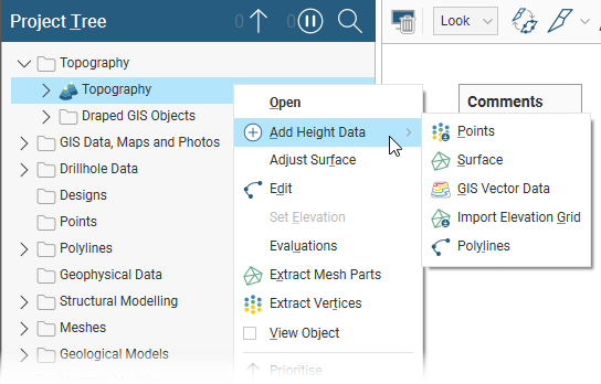

When creating the topography, it is not necessary to decide on a single source of information, as information can be combined. Once the topography has been defined, additional height data can be added by right-clicking on the topography and selecting from the options available:
It is not possible to add structural data or polylines with orientation information to the topography. If you edit the topography with a polyline, your options for editing the polyline will be limited.
For points, surfaces and GIS vector data, you will be prompted to select from the data sources available in the project. For an elevation grid, see Importing an Elevation Grid.

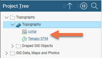

All data objects used to define the topography will appear under the topography, hyperlinked to their parent objects:
When you have added data to the topography, you may need to enlarge the topography extents. See Changing Topography Settings below.

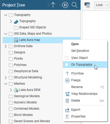

To drape a data object onto the topography, right-click on the object in the project tree and enable the On Topography option:
The On Topography option will not appear in the right-click menu if there is no topography defined.

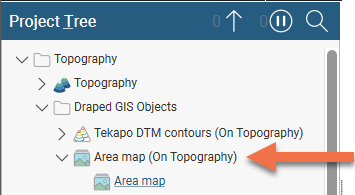

All draped objects will be listed in the Draped GIS Objects folder, under the topography:

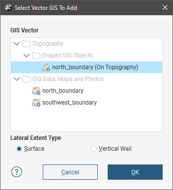

When you have draped objects on the topography and are using those objects in building models, you can sometimes choose whether to use the draped object or the object itself. For example, here in creating a lateral extent for a geological model using the north_boundary GIS object, you can choose whether to use the draped object or the undraped object:
Note that only the southwest_boundary GIS line can be used as it has not been draped on the topography.

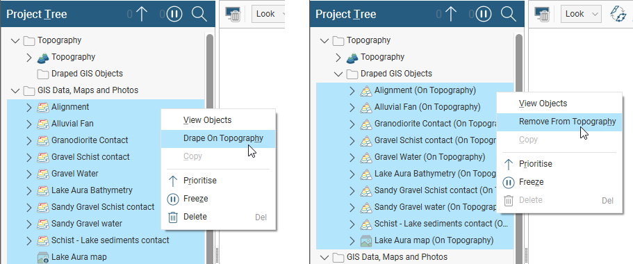

To remove an object from the topography, right-click on either the draped object or the object itself and disable the On Topography option:
The object will be removed from the Draped GIS Objects folder and from objects that use the draped object.
You can select multiple objects and drape/remove them all at once:

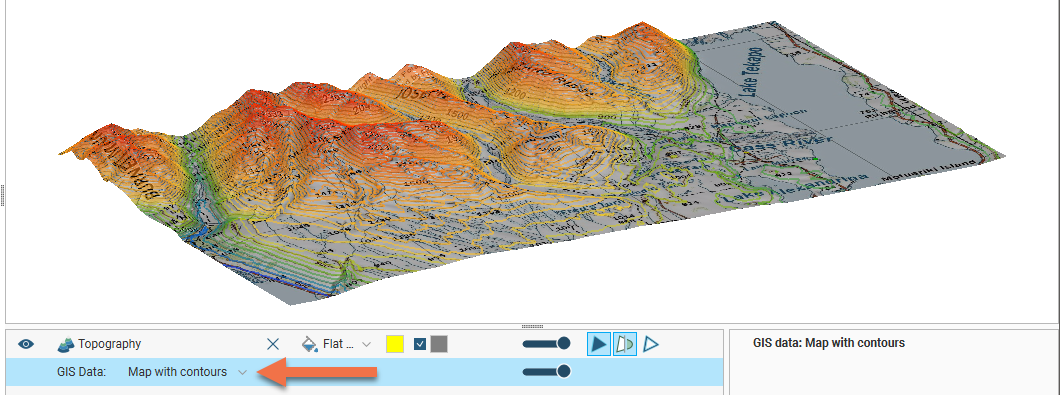

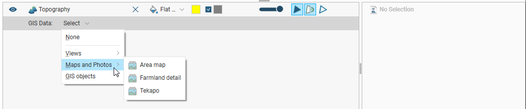

The topography will be displayed in the scene window and in the shape list:
The topography object in the shape list provides additional controls that can be used to change the way the topography is displayed and highlight features of interest. For example, selecting an imported map from the list results in it being displayed draped onto the topography:
Note that only objects that have been draped on the topography are available from the GIS Data list. See Draping Data Objects on the Topography above for more information.
The list is organised into:
- Views. This contains options for creating and editing custom topography views and also lists any views already defined. With custom topography views, you can view multiple GIS objects, maps and contours. See Custom Topography Views below for more information.
- Maps and Photos. This lists all images stored in the GIS Data, Maps and Photos folder that have been draped on the topography.
- GIS objects. This lists all GIS data objects stored in the GIS Data, Maps and Photos folder that have been draped on the topography.

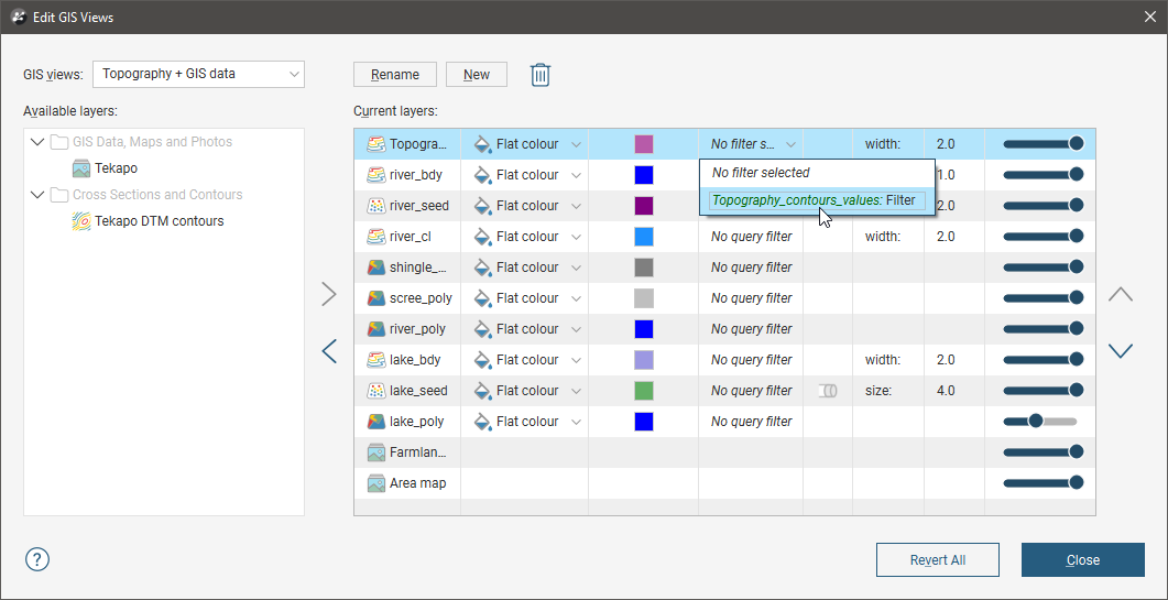

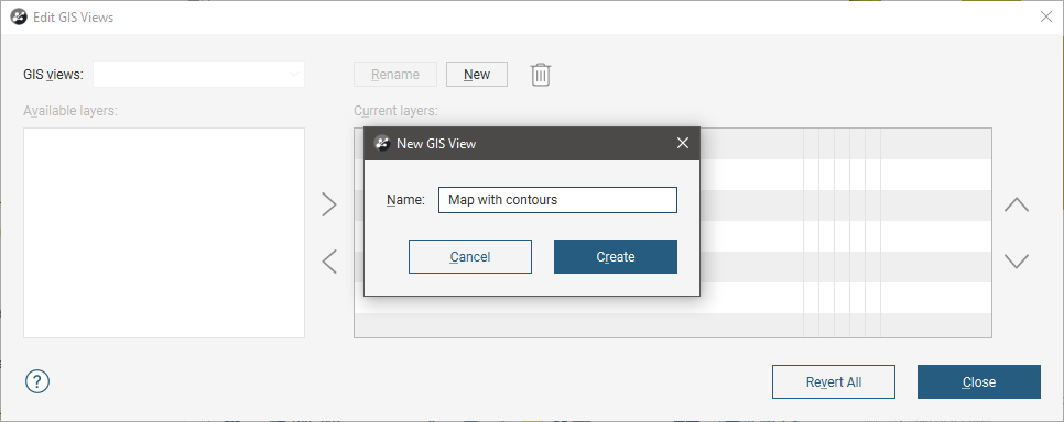

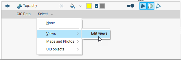

To create a custom view, add the topography object to the scene. Select Views > Edit views from the GIS data list:
The Edit GIS Views window will appear. Click New to create a new view. Enter a name for the new view and click Create:

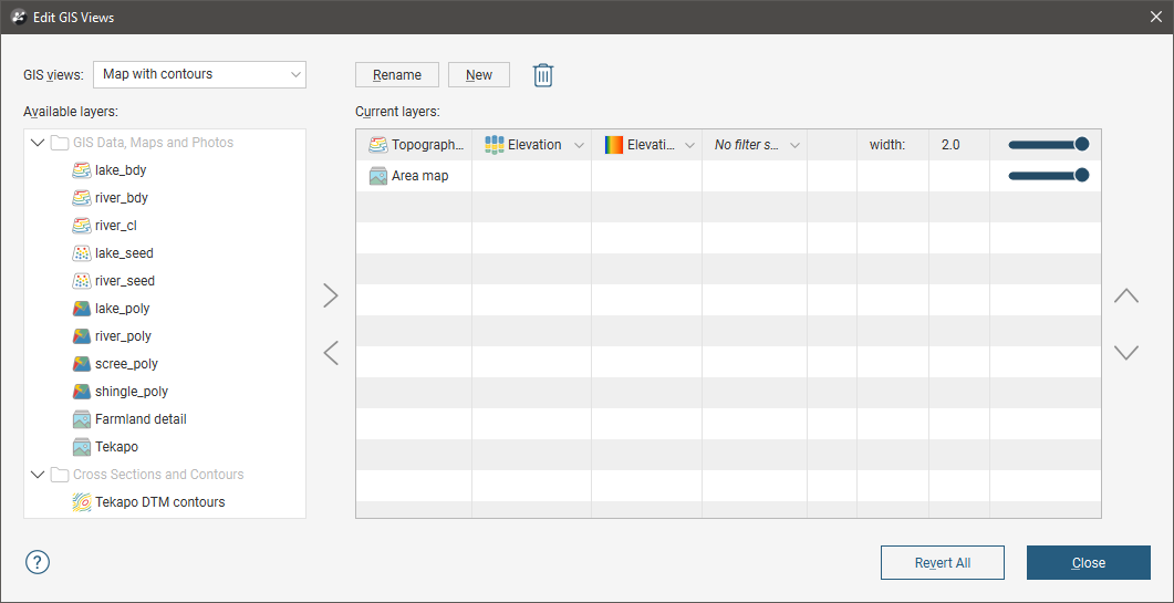

The new view will be created in the Edit GIS Views window, together with a list of Available layers. Use the arrows to move layers into the Current layers list and organise them:
If you have defined a query filter for an object, you can use that filter in the custom view:
Use the transparency and point and line size controls to emphasise data.
Click Close. The topography will be displayed in the scene with the new view applied:
