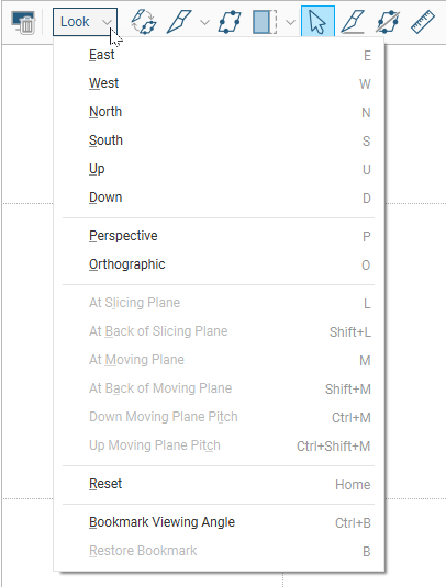

Use the Look menu above the scene window to switch to different viewing angles:
If you prefer to navigate using the keyboard, use the following keyboard shortcuts:
| Key(s) | Action |
| Arrow keys | Rotate the scene in 10 degree steps |
| Shift+Arrow keys | Rotate the scene in 2 degree steps |
| Home | Reset the view, showing all visible objects in scene |
| U, D, E, W, N, S | Look Up, Down, East, West, North and South |
| L | Look at the slicing plane |
| Shift+L | Look at the back of the slicing plane |
| M | Look at the moving plane |
| Shift+M | Look at the back of the moving plane |
| Ctrl+M | Look down the moving plane pitch |
| Shift+Ctrl+M | Look up the moving plane pitch |
| P | Select Perspective view |
| O | Select Orthographic view |
| Ctrl+Delete | Clear the scene |
| Ctrl+B | Bookmark the viewing angle and zoom |
| B | Display the bookmarked viewing angle and zoom |
| Ctrl+’ | Save the scene |
| Ctrl+C | Copies the scene to the clipboard. The image can then be pasted into another application, such as an image editor. |
| Ctrl+/ | Add the slicer to the scene. Press Ctrl+/ to remove the slicer from the scene. |
| Ctrl+; | Add the moving plane to the scene. Press Ctrl+; to remove the moving plane from the scene. |

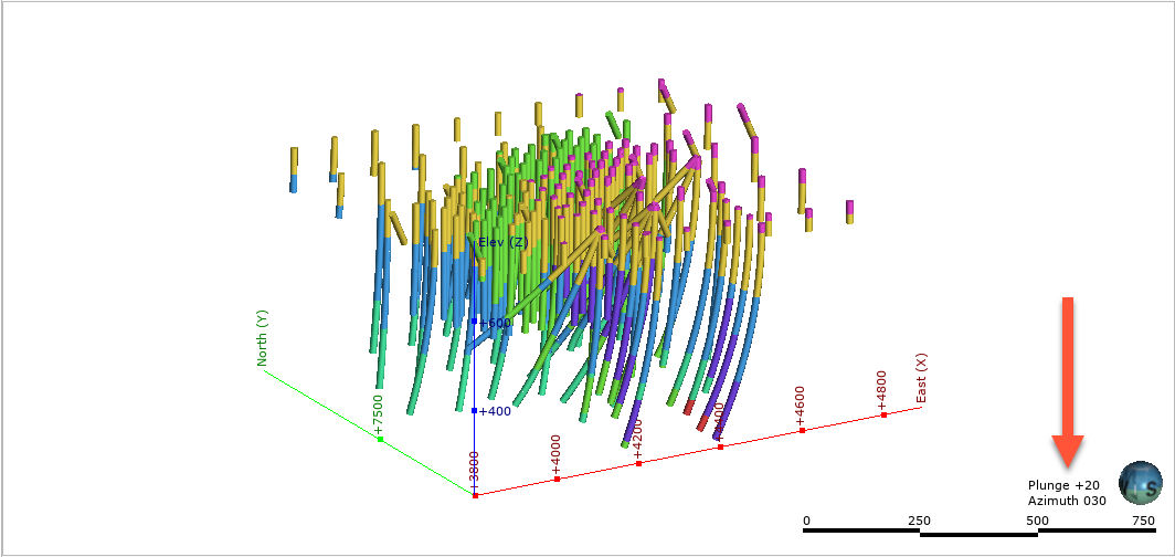

The current viewing angle and scale are displayed in the lower right-hand corner of the scene window:
You can change how the viewing angle and scale are displayed in the Overlays tab of the Settings window.

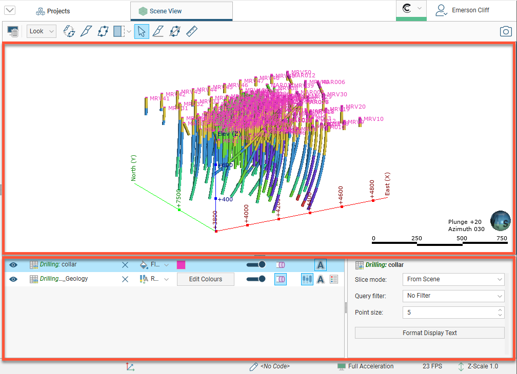

The scene window displays a 3D representation of selected data from the project tree. You can add objects from the project tree to the scene in two ways:
- Click on the object and drag it into the scene. Hold down the Shift key or the Ctrl key while clicking to select multiple items, then add them to the scene.
- Right-click on the object and tick the View Object box.
Dragging objects into the scene window may be blocked by other applications on your computer. For example, if you are sharing a screen using Skype, you will not be able to drag objects into the scene.
Once you have added objects to the scene window, you can change the appearance of those objects using the controls in the shape list and the shape properties panel.
This is described further in Visualising Data.

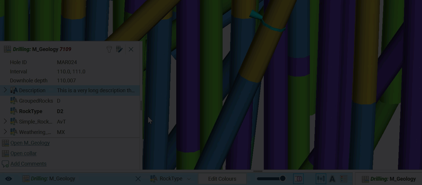

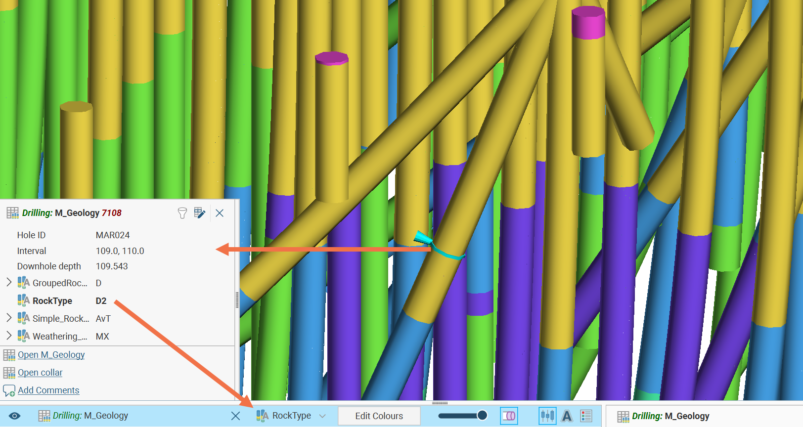

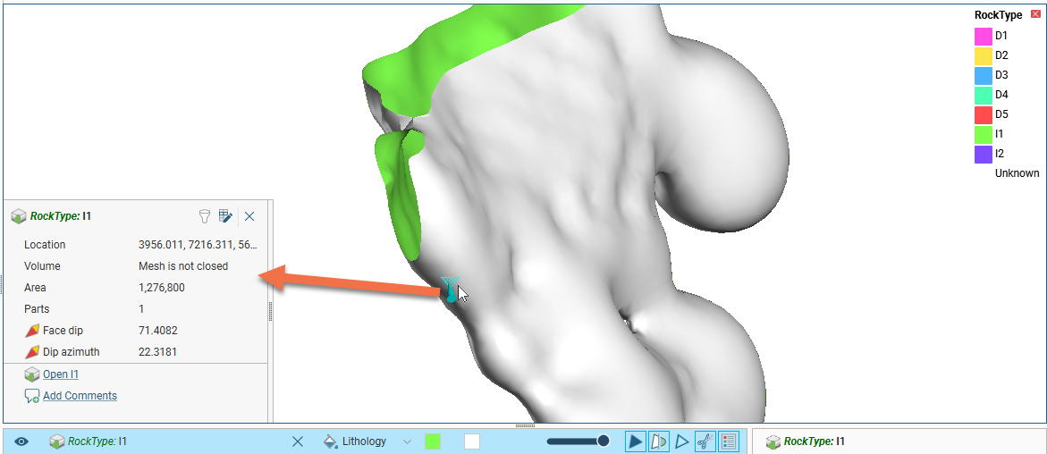

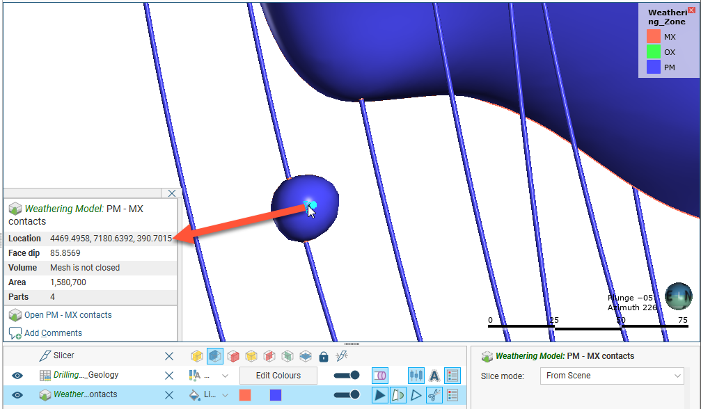

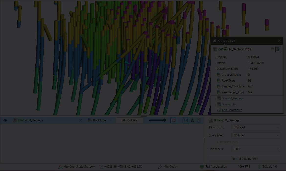

Viewing Object Details

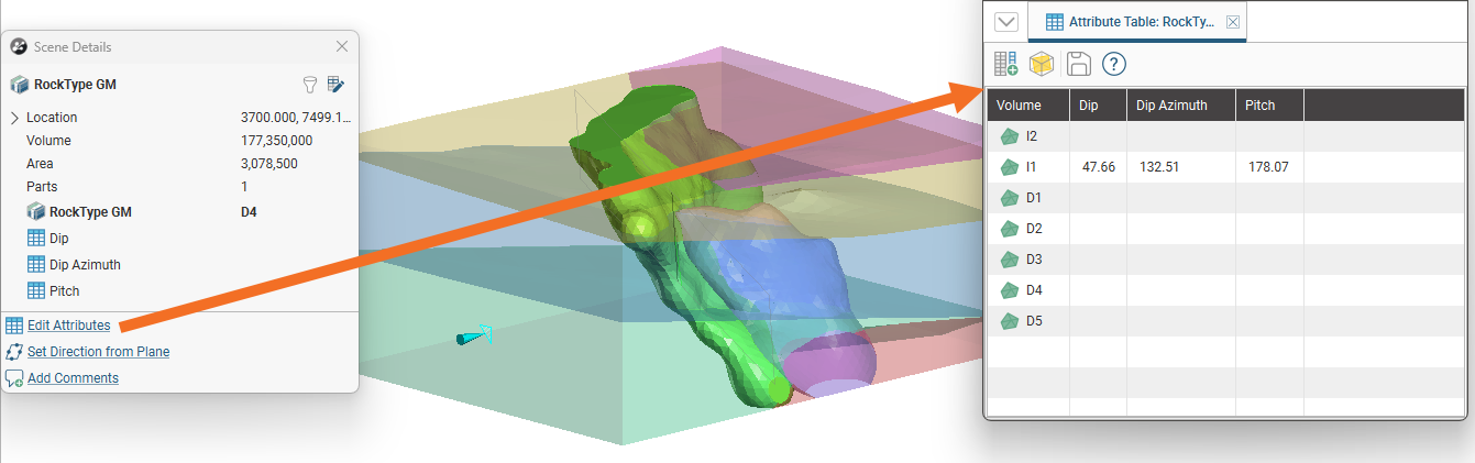

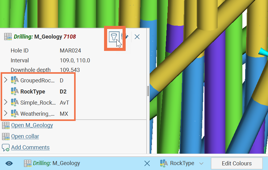

Clicking on an object in the scene displays a Scene Details panel that contains a summary of the data. For example, here drilling data is displayed in the scene and clicking on a segment displays information about the selected segment. For drilling data, this information includes the hole ID for the selected segment, location information for the interval, the downhole depth and the values for the different data columns in the table:
The column used to display the data is shown in the list in bold text, as is the case for the RockType column above.

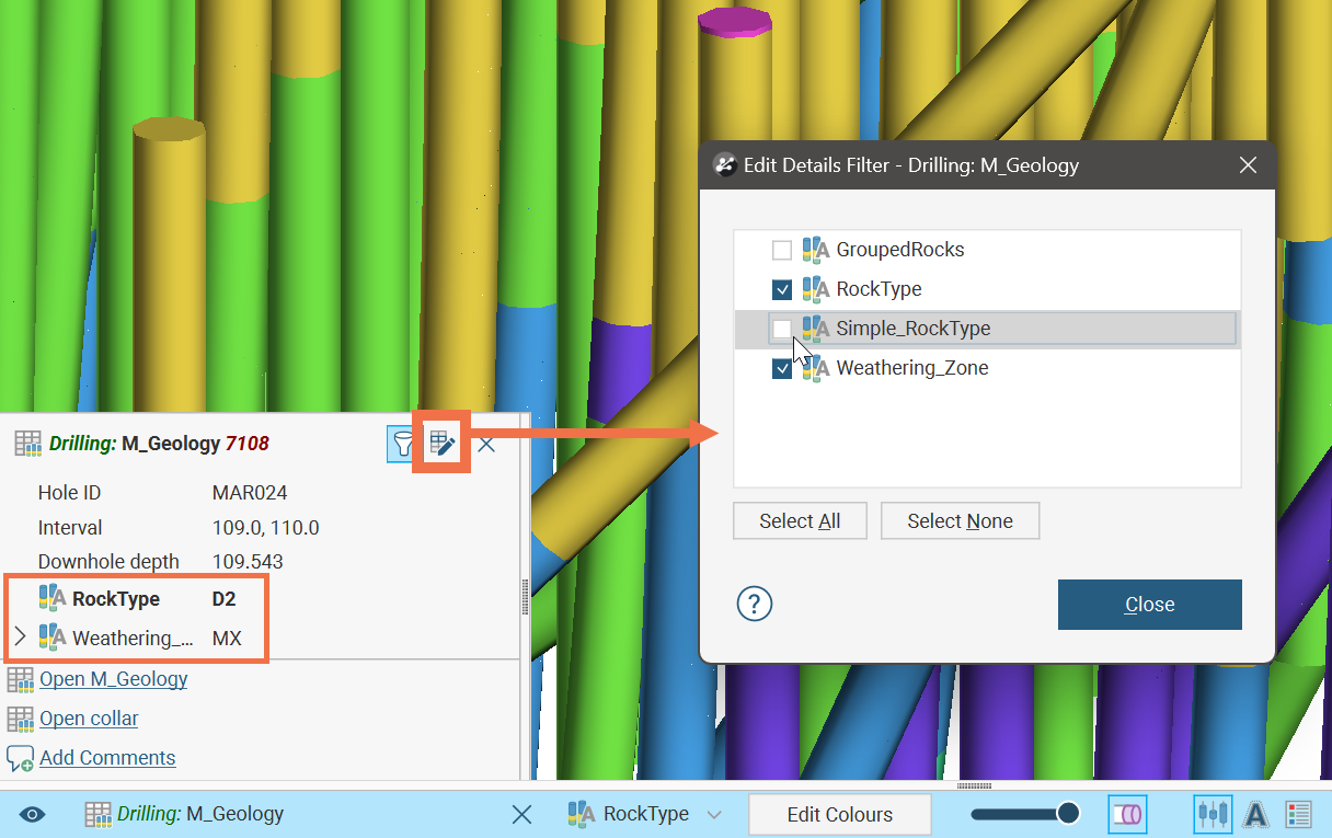

You can change which columns and evaluations are displayed in the list by clicking on the Edit Details button (
) and selecting which items you want displayed:
You can keep the Edit Details Filter window open while adding and removing items.
Once you have selected a subset of details, toggle between them using the filter button (
The width of the scene details panel can be resized, revealing long labels or values.
- By default, the relative column size ratio is preserved when adjusting the scene details panel width.
- You can adjust the label column width independently, and once you have selected a label column width, that preference is preserved.
- To return to the default column width ratio that adjusts both columns when the scene details panel is adjusted, right-click on the panel and select Reset Column Widths.
- When column width adjustments are insufficient to reveal an entire label or value, click on the expand/collapse chevron to reveal the entire label or value, wrapped to multiple lines within the current column width. If the row is for an object with child rows, these will also expand.
If all rows are collapsed, you can double-click on the column separator to get a minimum-width label column.
You can copy information from the scene details panel by right-clicking on a row and selecting Copy. The scene details header, containing the name of the object selected in the scene, along with the row label and value, will be copied to the clipboard ready for pasting elsewhere. Alternatively, you can select Copy Header from the menu, and only the selected object name will be copied to the clipboard. If you wish to only copy the row label or value, double-click on the information you want to copy to the clipboard, then right-click on the selection and select Copy.
From the panel, you can also add comments to the object.
Different objects will display different information in the scene details panel. Here information about a surface is displayed, including the volume, area, number of parts and whether or not the mesh is open or closed:

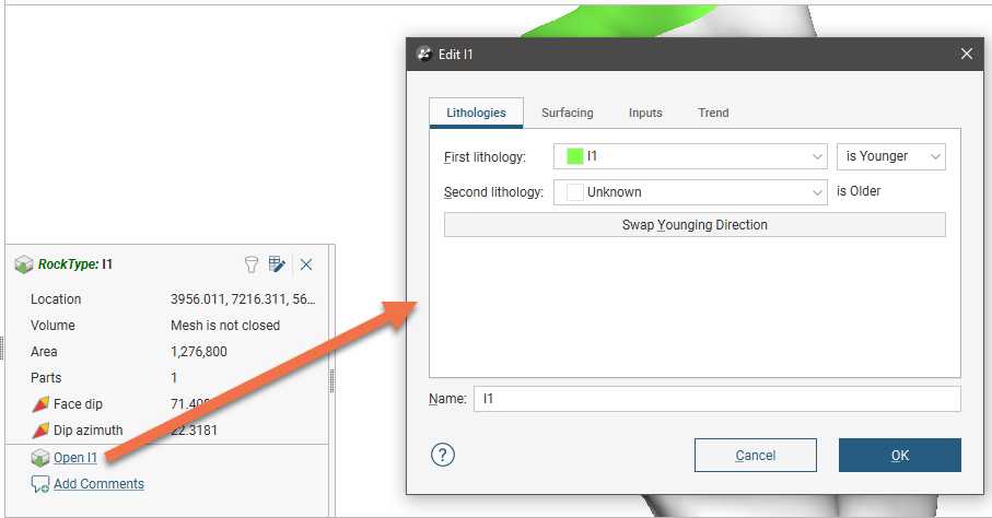

Many objects have an Open option you can click on to do further work on the object. For drilling data tables, for example, doing this will open the table. For contact surfaces, as shown here, doing this will open the surface’s Edit dialog:
Some objects will also include options for working with the object by, for example, editing the object’s attributes or using the moving plane to set direction attributes. For example, here information is displayed for a geological model and there is a link to editing the model’s attributes:

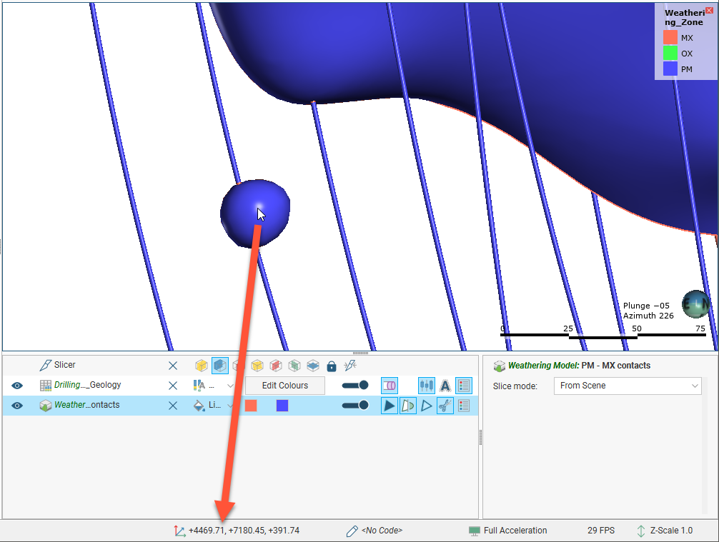

Determining a Location
The simplest way of measuring an approximate location in the scene is to first display an object in the scene window, then position the cursor over the location. The position of the cursor is displayed at the bottom of the Leapfrog Works window:
The position of the cursor in the scene is calculated using the depth buffer on the graphics card and so is not an exact method of measuring in the scene.
If you require an exact position, click on the object. Leapfrog Works will compute the exact position of the point highlighted in the scene and display it in a pop-up window:

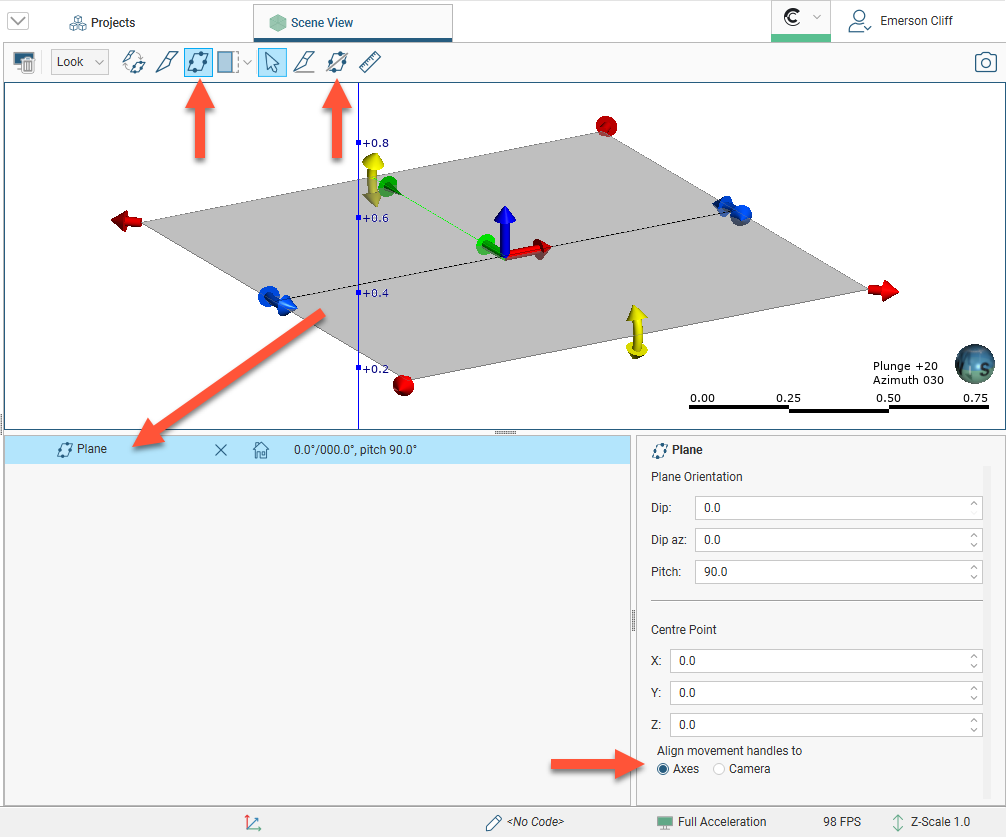

In Leapfrog Works, the moving plane is used for measuring planar structures and defining coordinate system orientations. There are two tools in the toolbar that relate to the moving plane:
To use the moving plane, click the Show plane button (
) and position the plane in the scene. The main axis of the moving plane is defined by the green line. The second axis is defined to be in the plane at right angles (orthogonal) to the main axis. Third axis is perpendicular to the plane.
There are three ways to position the plane. You can:
- Use the handles in the scene window to move the plane. If you cannot see the handles, click on the moving plane.
- Use the Plane controls in the shape properties panel to change the Dip, Dip Azimuth, Pitch and Centre Point.
- Orient the scene to look parallel to the required plane position, then click on the Draw plane line button (
). Draw the required line in the scene.
Plane movement can be aligned to the Axes or to the Camera:
- With the Axes option, the handles move in cartesian coordinates. .
- With the Camera option, the handles move relative to the camera angle.
Drawing the plane line is usually the most convenient method of defining a planar structure.

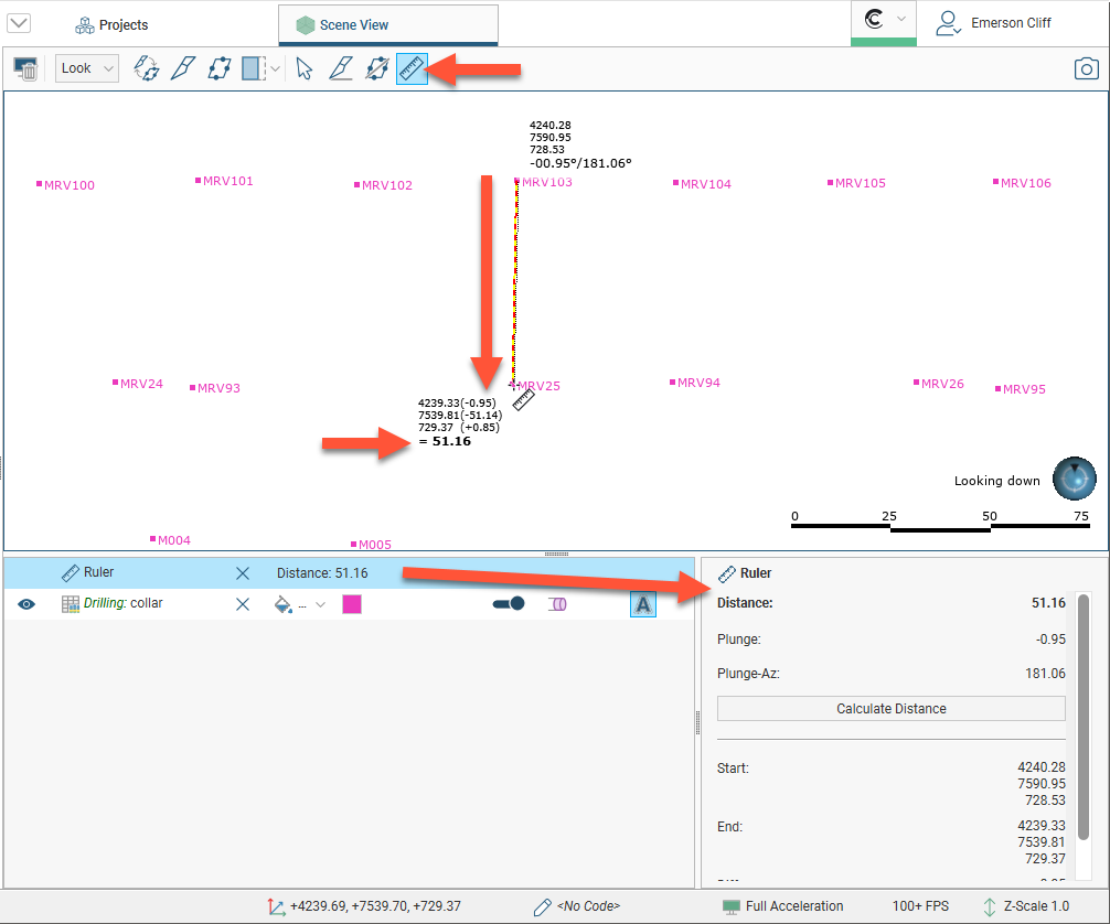

The Ruler
You can use the ruler to measure distances in three dimensional space and between boreholes and planned boreholes.
The easiest way to use the ruler is to click on the Ruler button (
) and click and drag between points in the scene to start making measurements. A ruler line will appear in the scene to indicate the measurement. Information about the distance measured will appear in the scene and in the shape properties panel:
The ruler tool stays active in the scene so you can make as many measurements as required.
There are two ways to remove the ruler from the scene:
- Click the Select button (
). - Click the delete button (
) for the ruler object in the shape list.

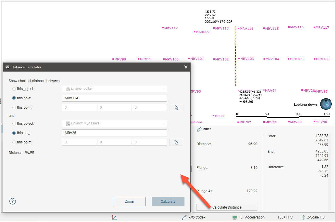

The Distance Calculator
You can also calculate the measurement of the shortest distance between objects, boreholes, points or a combination or any of the three. For example, use the distance calculator when you have a planned borehole and would like to know how close it is to an existing underground mine development.
To do this, add the ruler to the scene, then click on the Calculate Distance button in the shape properties panel. The Distance Calculator window will appear:
Select which two items to measure between. Options are:
- An object, which will measure from the closest object in the selected table.
- A hole. Start typing a hole number to display a list of options to choose from.
- A point, which can be selected in the scene by clicking the Select button (
) in the Distance Calculator window, then clicking in the scene.
Click Calculate. The Distance will appear in the Distance Calculator window. The Start, End and Difference of your selections will appear in the shape properties panel.
Click Zoom to zoom to the ruler in the scene.
After measuring a distance, it is a good idea to change the viewing angle to confirm that the measurement has been made between the correct points in three dimensions.

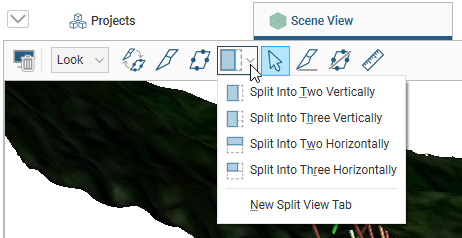

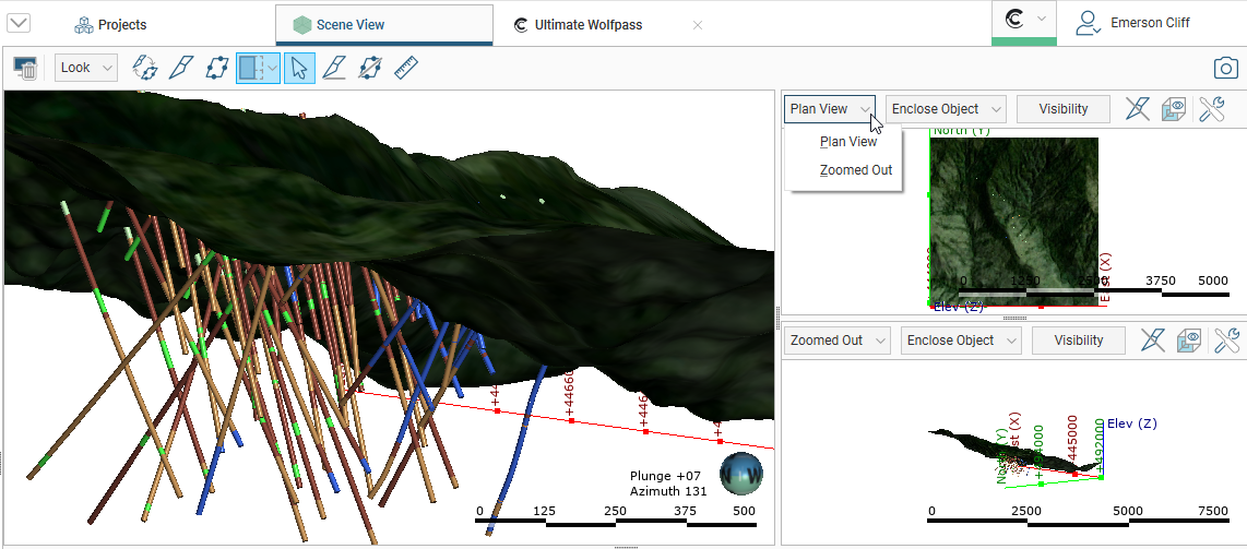

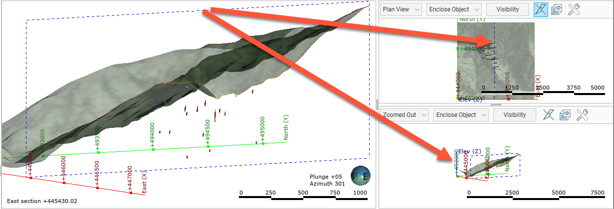

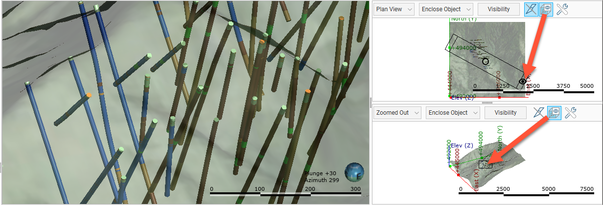

Working With Split Views

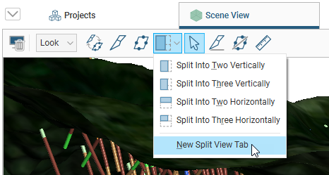

The Split View button (
) in the toolbar allows you to view up to two alternative views of the objects displayed in the scene:
The alternative views available are a Plan View or a Zoomed Out view:
You can also open an alternative view in a new tab by choosing the New Split View Tab option:
You can resize the scene and the alternative views and Leapfrog Works will remember the position of each view when you switch to that split view again.
To return to displaying only the scene view, click the Split View button (

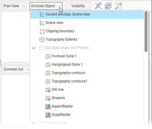

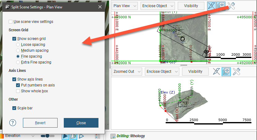

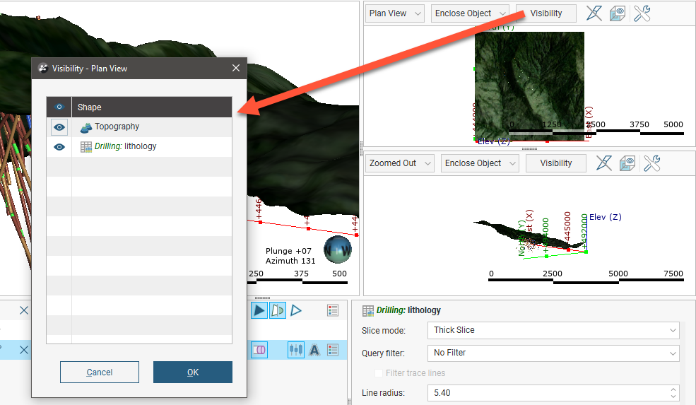

Each alternative view has a toolbar that gives you different options for displaying the view. Use the Enclose Object list to zoom into or out of the alternative view:
The list displayed includes all objects available in the project, plus the clipping boundary and the current scene view.
Click the Visibility button to change what objects from the scene view are visible in the alternative view:
An object must be visible in the scene view’s shape list for its visibility to be controllable from the alternative view’s Edit Visibility list. What this means is that objects hidden in the scene view cannot be made visible in an alternative view.
When the slicer is in the main scene view, you can display the contents of the alternative view sliced or unsliced. Click the View Unsliced button (
). The slicer, shown in blue in this image, remains displayed in the alternative views, but the view’s contents are displayed unsliced:
In alternative views, you can display a view window that shows what part of the alternative view is displayed in the scene view. Click the Enable View Window button (
Each alternative view has a Settings button (
