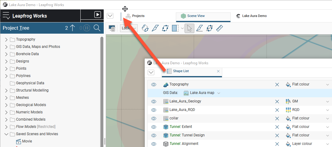

To dock a detached tab, click on it and drag it to where you want to dock it:
When the move handle (
) appears, release the mouse and the tab will dock.
Tabs can be docked to the main window or to other tabs. Drag tabs to reorder them.

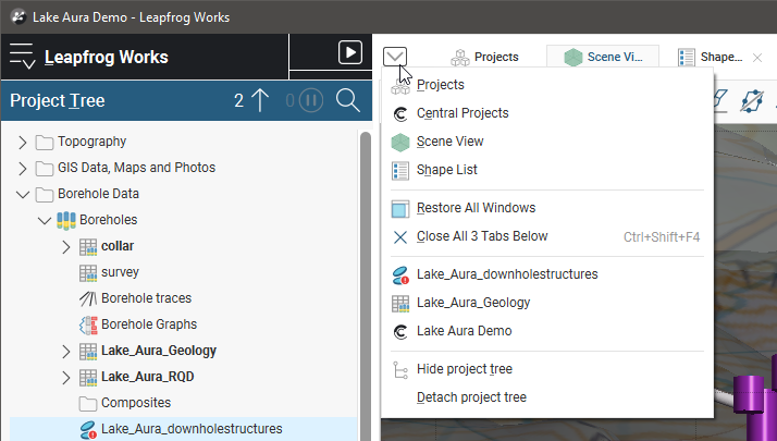

You can view a list of all open tabs by clicking the List open tabs button, which is the down arrow to the right of the processing queue button:

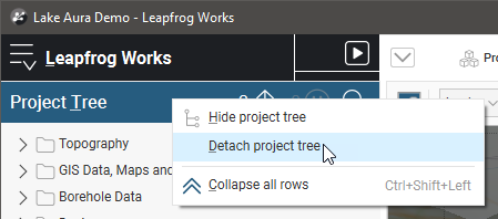

The project tree can also be detached from the main window. To do this, either:
- Right-click at the top of the project tree and select Detach:
- Click on the List open tabs button and select Detach project tree:

- Clicking on the List open tabs button and selecting Show project tree or Restore All Windows or
- Pressing the F8 key once again
If your project opens and the project tree is not displayed, click on the List open tabs button and select Restore All Windows.

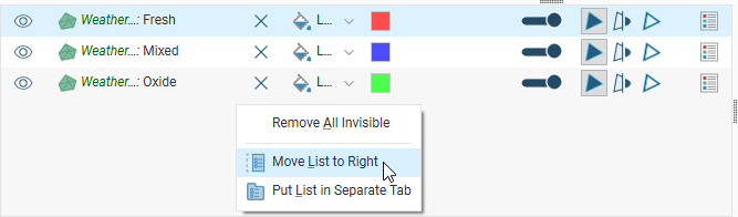

The Scene View tab is made up of the scene window, the shape list and the shape properties panel. The shape list and shape properties panel can be displayed on the right-hand side of the scene rather than below the scene. To do this, right-click in the shape list and select Move List to Right:

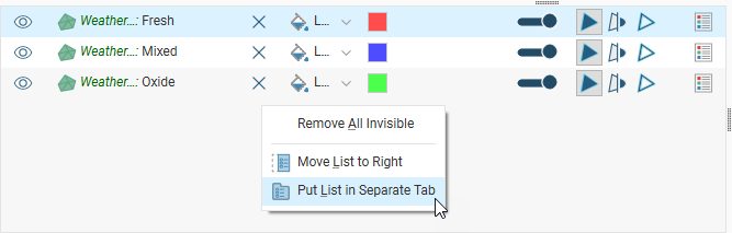

You can also detach the shape list and display it as a tab, which can then be detached from the main window. To do this, right-click in the shape list and select Put List in Separate Tab:

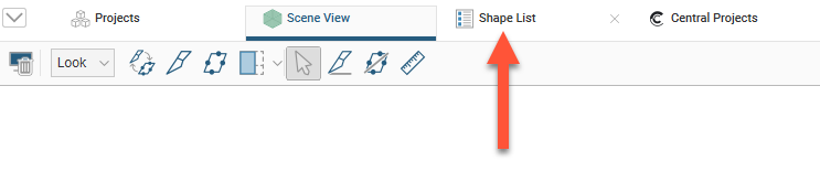

You can then detach the tab from the main window:

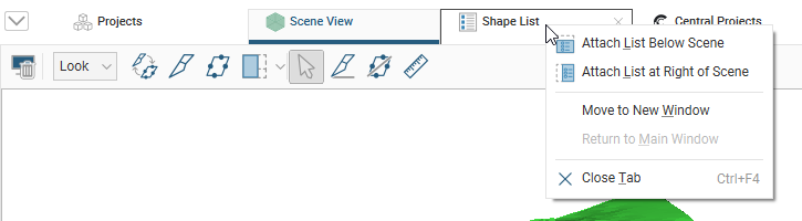

To dock the shape list to the Scene View tab, right-click in the Shape List tab and choose where you wish to dock the list:
