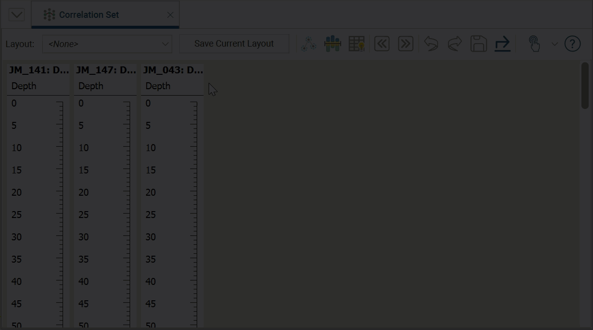

Selecting Collars

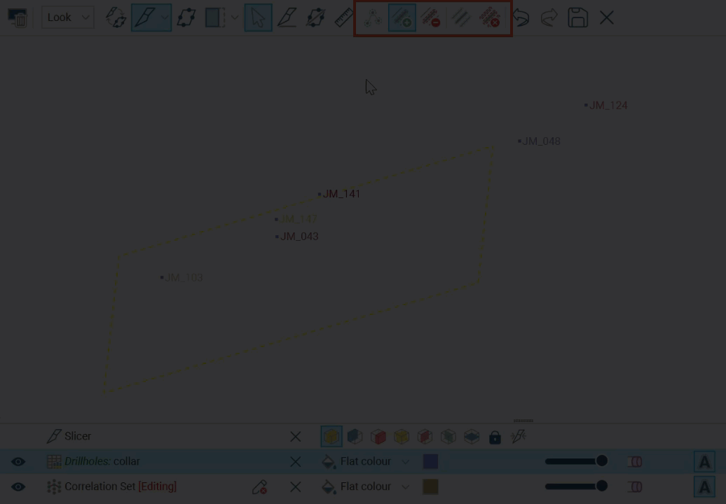

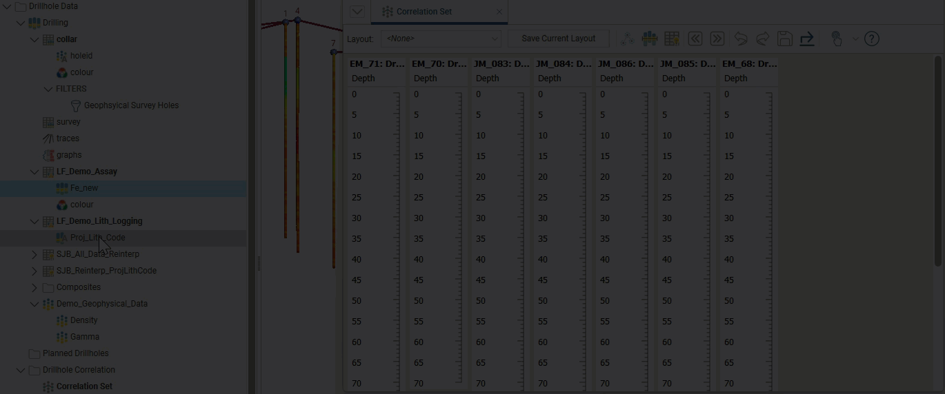

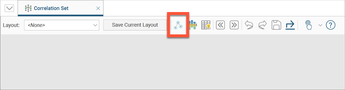

To select collars, you need to create a borehole correlation set, which you can do from the scene. First, add the collars you wish to work with to the scene. Next, right-click on the Borehole Correlation folder and select New Correlation. The new set will be created and opened, but is empty until you select collars. Click on the Select Collars button (
) in the correlation set toolbar.
This will switch you to the scene view where you can begin selecting collars. You will first need to click on the Select Collars button (
), this time in the scene view toolbar, making sure the Add collar button (
) is also selected. Then you will be able to click each collar you want to include in the correlation set.
A useful way of limiting the number of collars displayed is to draw a slice in the scene, set it to a thick slice (
) and set the slice width to hide collars on either side of the slice.
The numbered line in the scene indicates the sequence in which collars will appear in the correlation set. If you accidentally select the wrong collar, either:
- Click on the Remove collar button (
), then click on the collar you wish to remove from the set. - Hold down the Ctrl key while clicking on the collar you wish to remove from the set.
You can also:
- Temporarily switch to the Select button (
) by holding down the Shift key while clicking. - Select all collars visible in the scene by clicking on the Select all collars button (
). This will select collars using the best fit line. - Clear the selection by clicking on the Clear collar selection button (
If you want to change the order, it is not necessary to de-select and re-select collars; you can easily reorder them later in the correlation set tab by dragging column headers.

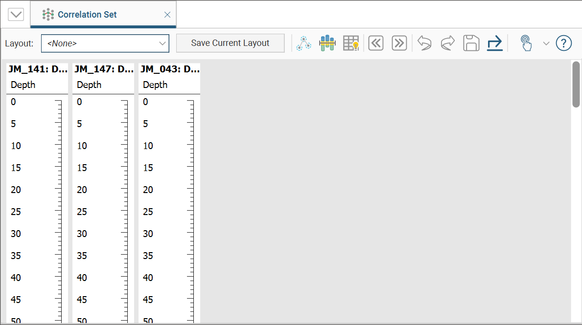

Once you have selected the required collars, click the Save button (
). The selected collars will be added to the correlation set window:

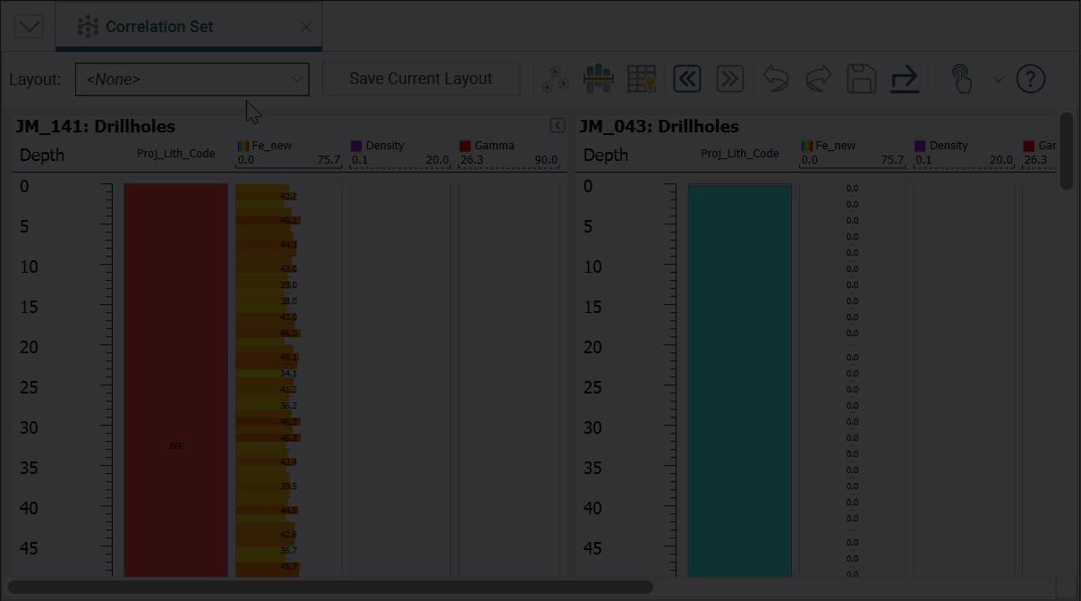

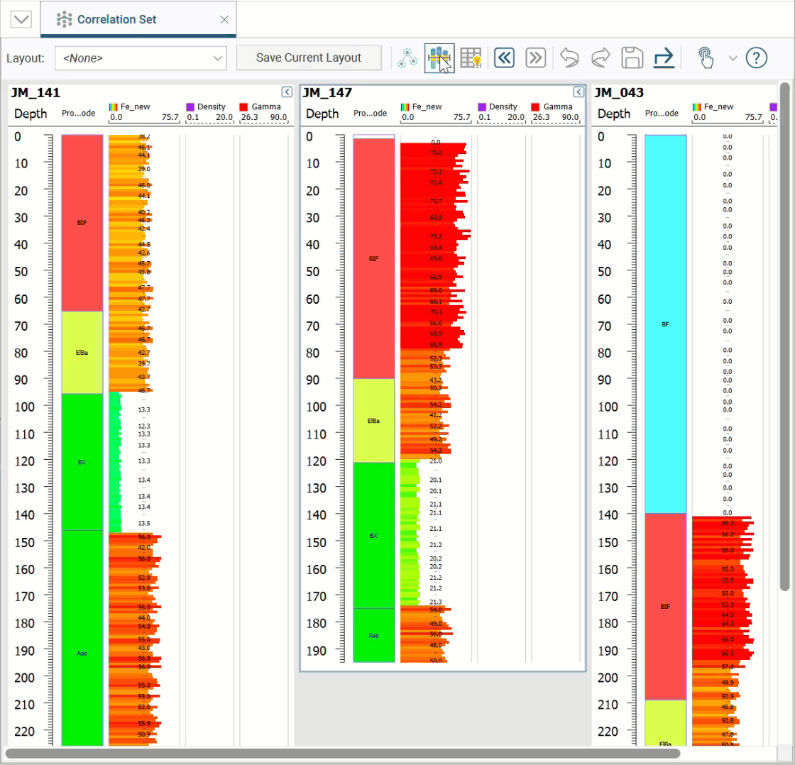

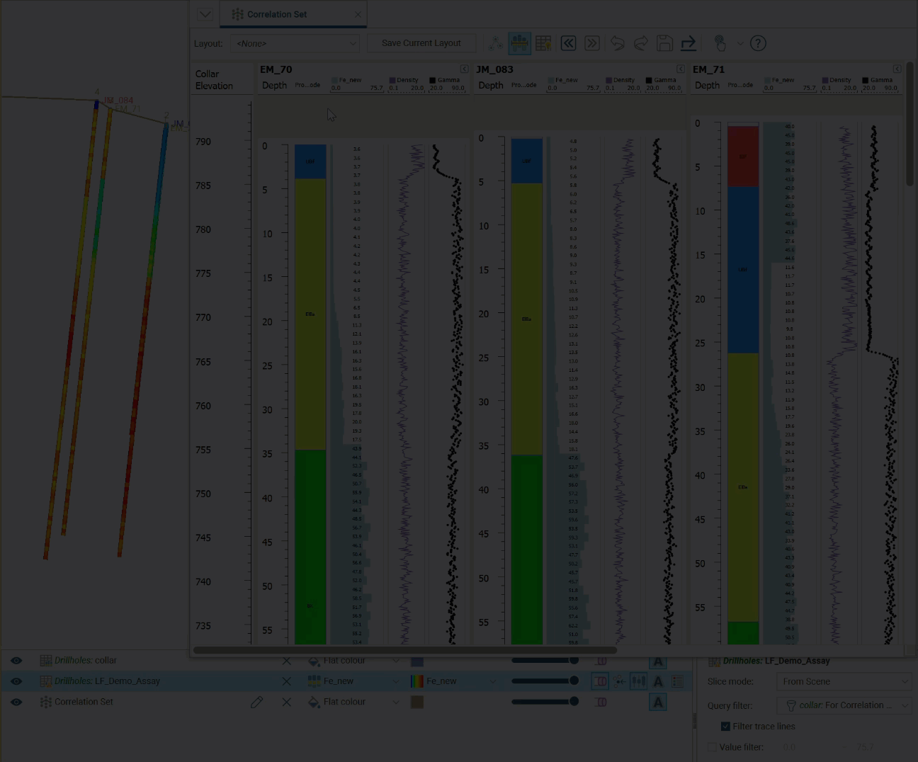

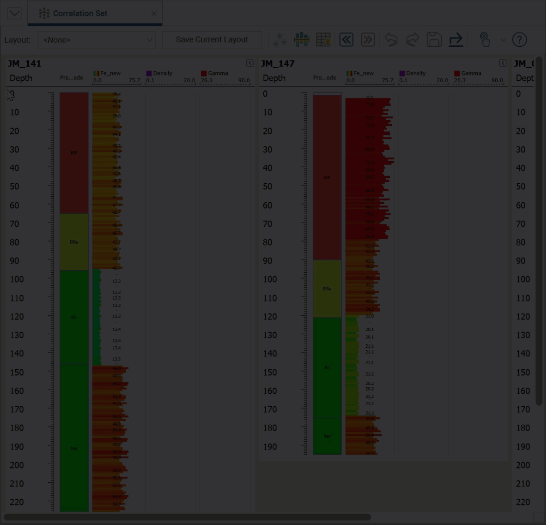

The Correlation Set Window
Each borehole is represented by a vertical panel that can display several columns of information. You can change the sequence the boreholes appear in by clicking-and-dragging the collar to a new position. A vertical line will appear where the borehole will be repositioned.

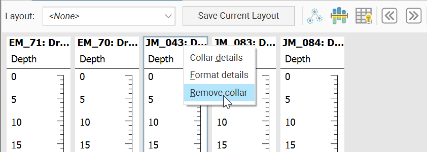

Remove collars from the correlation set by either editing the set in the scene, as described in Selecting Collars above, or right-click on a collar header and select Remove collar from the pop-up menu:

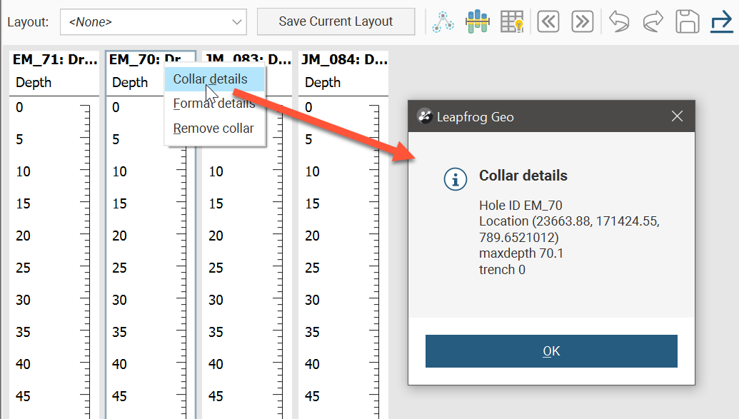

Collar metadata is available by right-clicking on a collar header and selecting Collar details.
Add data columns you want displayed for each drillhole by dragging-and-dropping data columns from the project tree somewhere onto a borehole panel. Depending on whether the data is category or numeric, hex colour, interval or points data, the default appearance of the data column will be set appropriately. This visual formatting can be adjusted to suit your preference or internal standards.
The sequence of data columns can be changed by clicking-and-dragging the column. A vertical line will appear where the column will be repositioned.

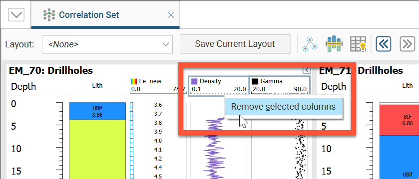

You can remove data columns from the boreholes by right-clicking on a column header, then selecting Remove. Multiple columns can be removed in a single action by holding Ctrl while clicking on the column headers, then clicking on Remove selected columns.

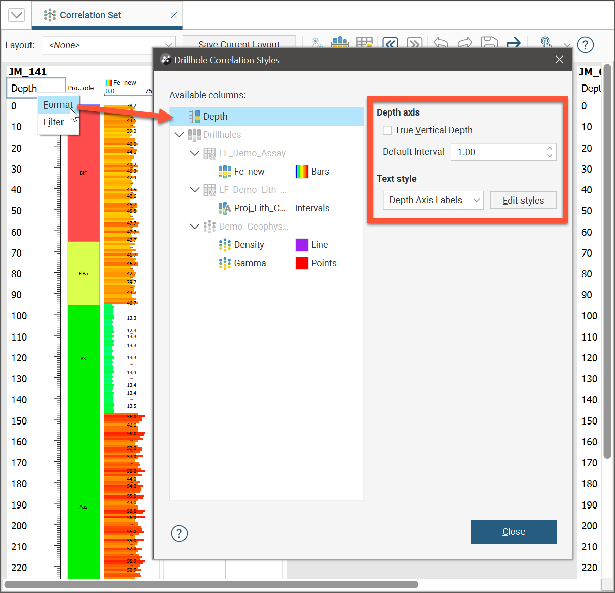

Customise the depth scale by right-clicking on Depth or TVD and selecting Format. The tick interval can be adjusted by changing Default Interval, and the Text style can be changed by selecting one of the named text styles and/or clicking the Edit styles button where the font, point size and colour can be specified, along with whether or not the text should be bold or italic.
It is also possible to tick the True Vertical Depth box to change the depth scale from downhole distance to true vertical depth. When selected, the Depth label is changed to TVD, and the borehole data is referenced to the z-height. In conjunction with the Elevate Collars feature, this may be especially useful with boreholes with significantly different dip angles.

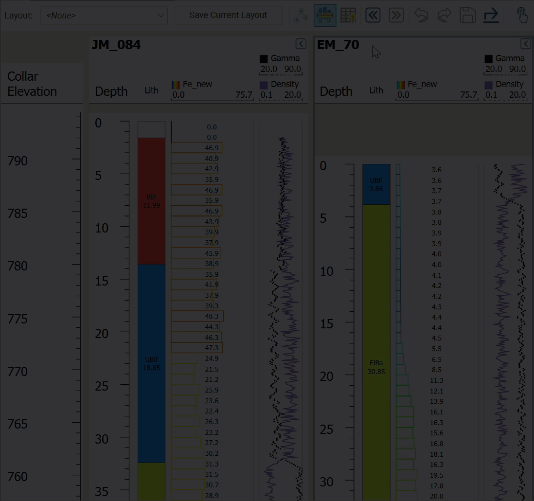

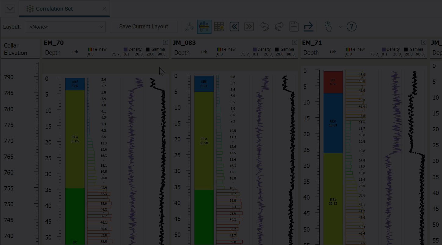

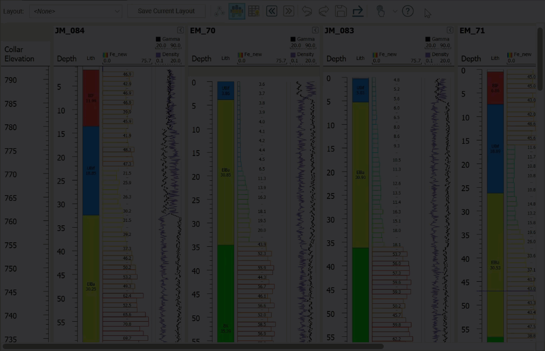

Correlating data is harder when the topography is not flat and the borehole collars are at different elevations, unless the starting points for each borehole are adjusted to be relative. Click the Elevate Collars button (
) and a Collar Elevation scale is added to the left side of the correlation set and the borehole collars are set to their z-height. Click the Elevate Collars button again to reset the depth scales so they are not relative.

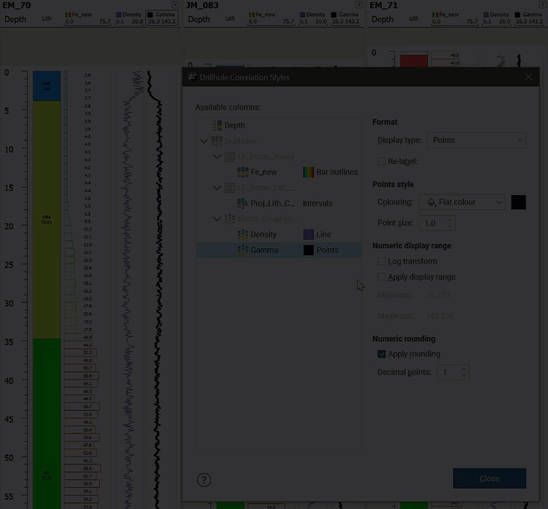

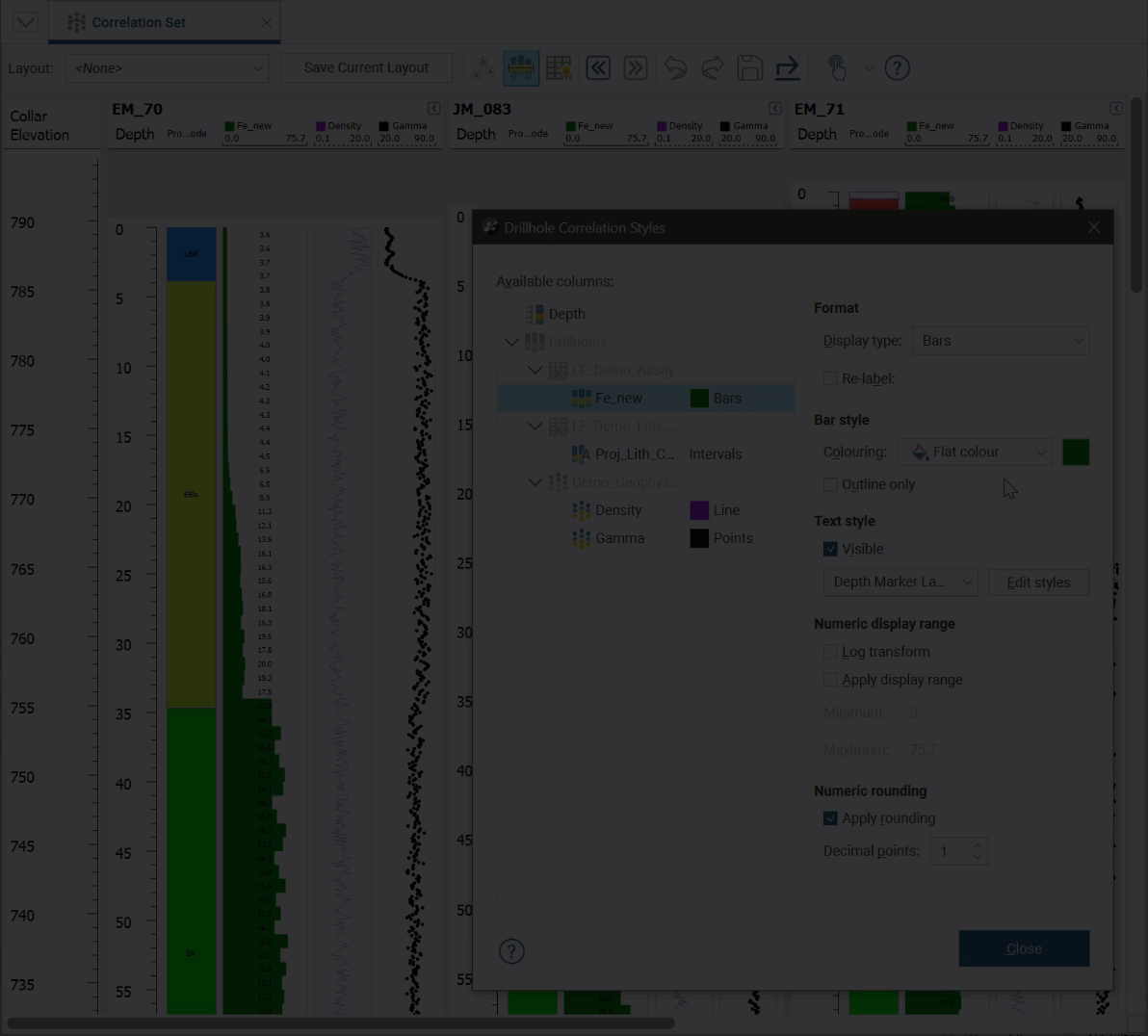

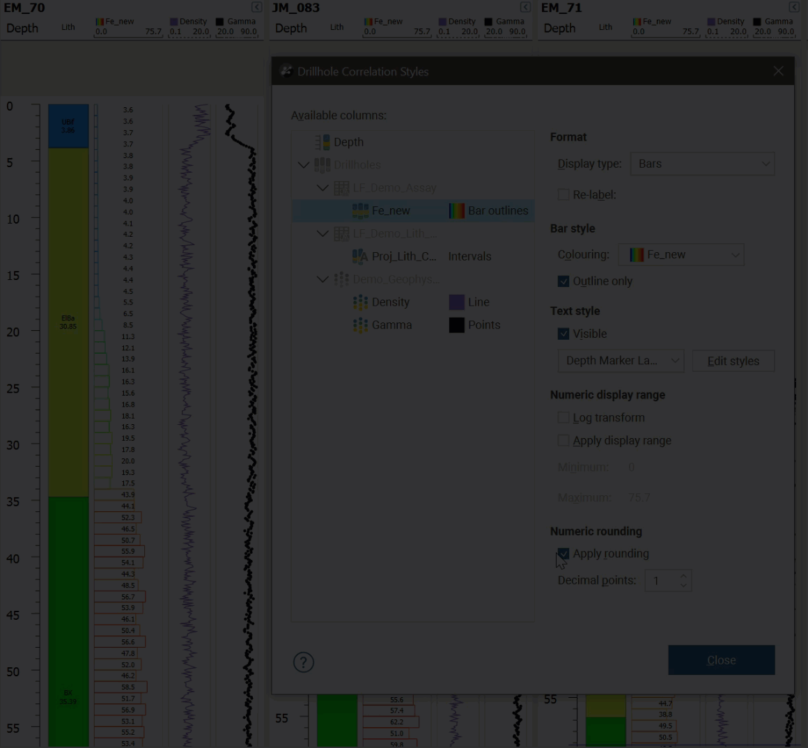

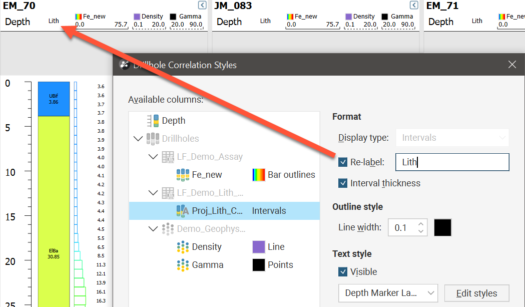

The columns in the correlation set can be formatted and styled to present the data in a manner that suits your analysis and presentation needs. Right-clicking any column header and selecting Format will open the Borehole Correlation Styles window. Position this window so you can see the correlation set, as style changes made in this window are updated immediately in the correlation set.

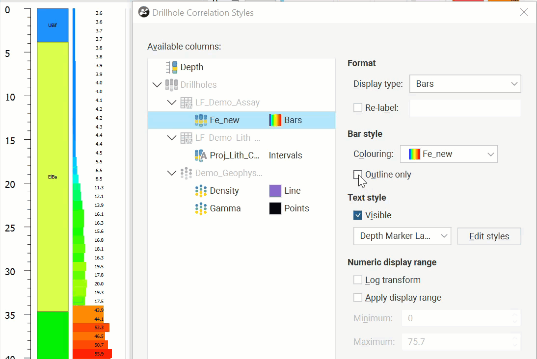

Each of the displayed columns is shown in the Available columns list and when a column is selected, formatting and styling options appear on the right side of the window, specific to the type of column data selected.
Under the Format heading, the Display type provides options for displaying data as Bars, a Line, Points or Midpoints or Intervals. Available options will be limited by the selected data type.
When Bars are selected for the Display type, the Bar Style section provides styling options for the bar chart. The Colouring can be specified as a Flat colour and a specific colour selected by clicking on the colour chip, or an available colourmap can be selected from the dropdown list. Colourmaps are not defined or managed within the Borehole Correlation Styles window; the available colourmaps match those defined for the data column when added to the scene. If necessary, add a new colourmap from the shape list.
Tick Outline only to change the bar style from bars filled with colour to bars with a coloured outline and a white fill. Note that when Outline only is enabled, where the edges of two bars are adjacent the colour of the bar with the higher value is used.
Change the default data column header label by ticking Re-label and providing a new header label.

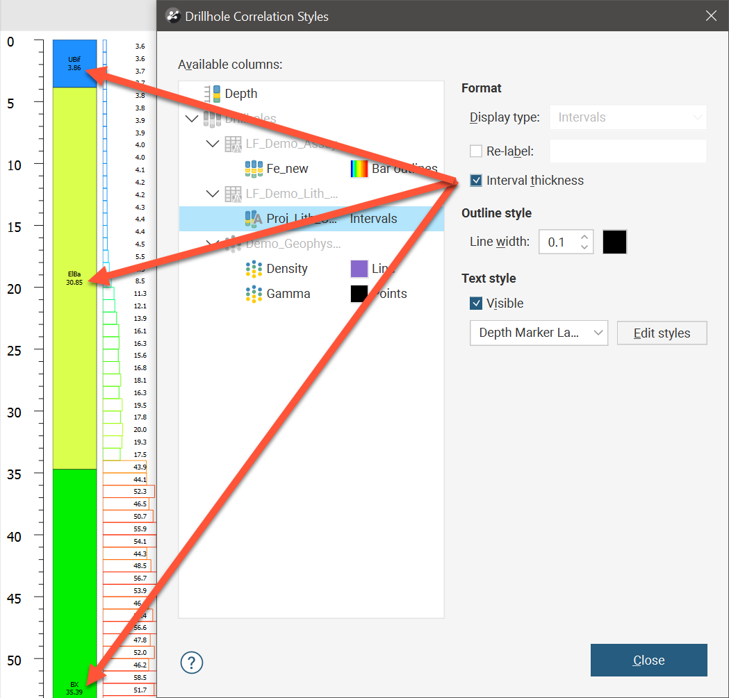

When the Display type is Intervals, there is an option to show Interval thickness. This will add the thickness dimension to the interval label for each interval.

You may choose to round data values shown in the correlation set for numeric data columns. Tick Apply rounding and specify how many Decimal points to show.

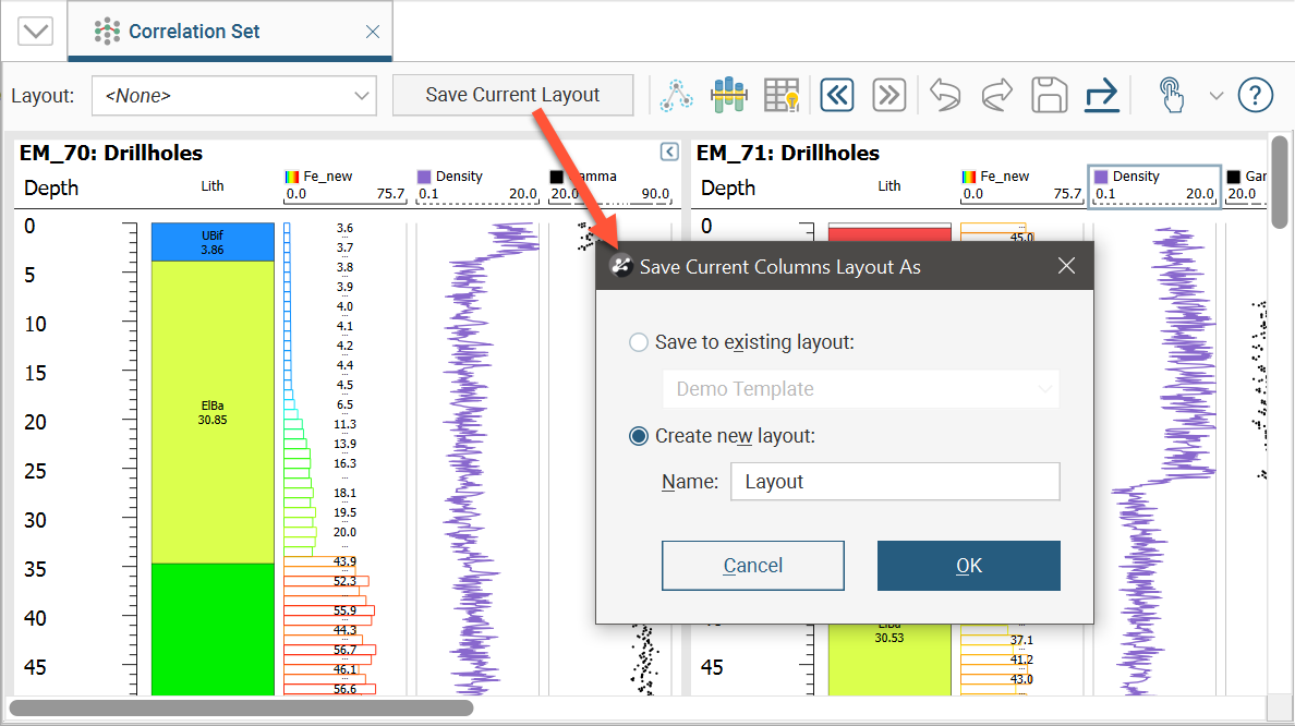

Once you have formatted and styled a correlation set, you can save this styling as a layout that can be applied to other correlation sets. Click on the Save Current Layout button in the toolbar, then either select Save to existing layout and select an existing layout to overwrite, or select Create new layout and provide a Name for the layout.
Layouts can be applied to a correlation set by selecting one of the existing options from the Layout dropdown list.

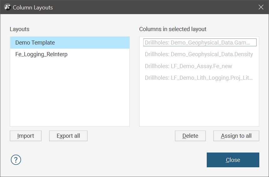

Managing Layouts and Styles

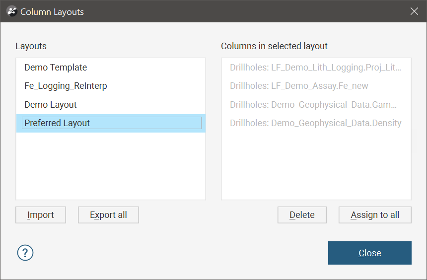

To manage correlation set layouts, right-click on Drillhole Correlation in the project tree and select Layout Manager. Here a layout can be selected and re-used for all correlation sets in the project by clicking the Assign to all button. The Column Layouts window also provides the option to Delete a selected layout.

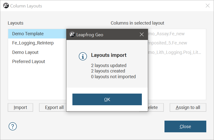

To re-use the correlation set layouts in other projects, click the Export All button and provide a filename.
In another project where the correlation set layouts are to be re-used, right-click on Drillhole Correlation in the project tree. Select Layout Manager and click the Import button.
The Column Layouts window will be updated and a informational dialog will let you know how many layouts were imported from the file.
You can then select an imported layout to Assign to all correlation sets or open individual correlation sets and change the Layout to suit from the available options.

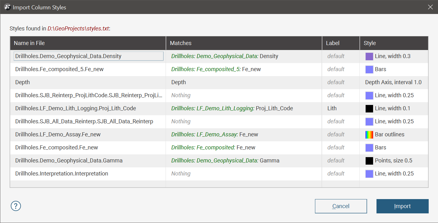

It is also possible to export and import the column styles being used within correlation set layouts. Right-click on Drillhole Correlation in the project tree and click Export Column Styles. You will be prompted to provide a filename for the exported file.
In a project where you wish to re-use column styles from another project, right-click on Drillhole Correlation in the project tree and click Import Column Styles. The Import Column Styles window will open.
This window will indicate which of the styles in the imported file Leapfrog can automatically match with columns in the currently open project. There is no option to make assignments of column styles to unmatched columns in the project. Click Import to assign the column styles to the matched columns.

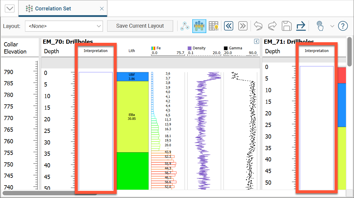

Interpretation Tables

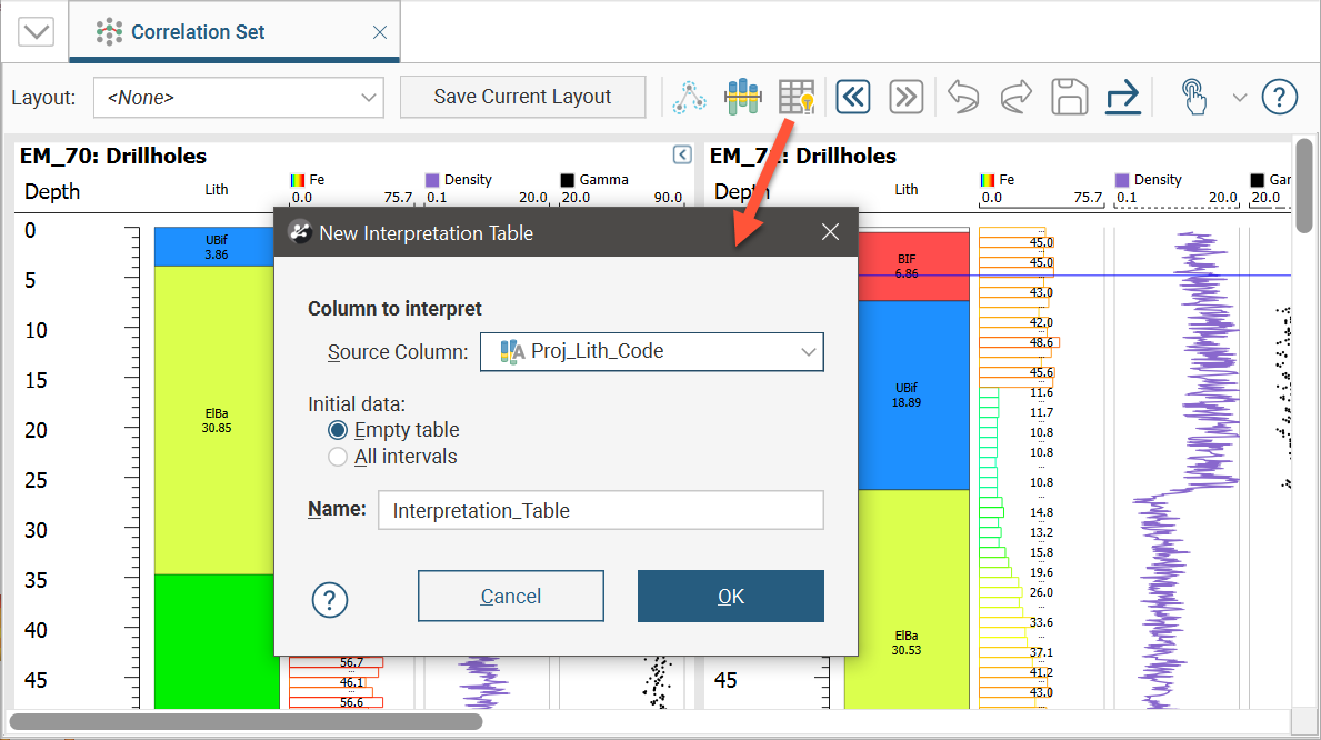

- Create the table without using a base table. Each borehole will have an empty legend and a single empty interval from 0 to its maximum depth. Select <None> for the Source Column.
Click OK to create the table. A new interpretation table will be added to the project tree in the selected drilling dataset and the column will be added to the correlation set window:

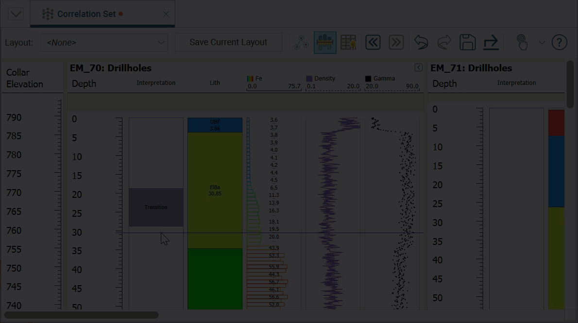

Assigning Lithologies

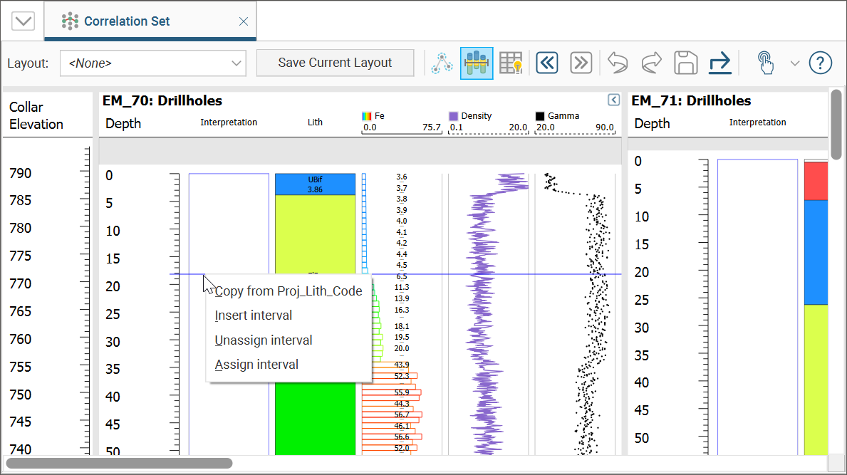

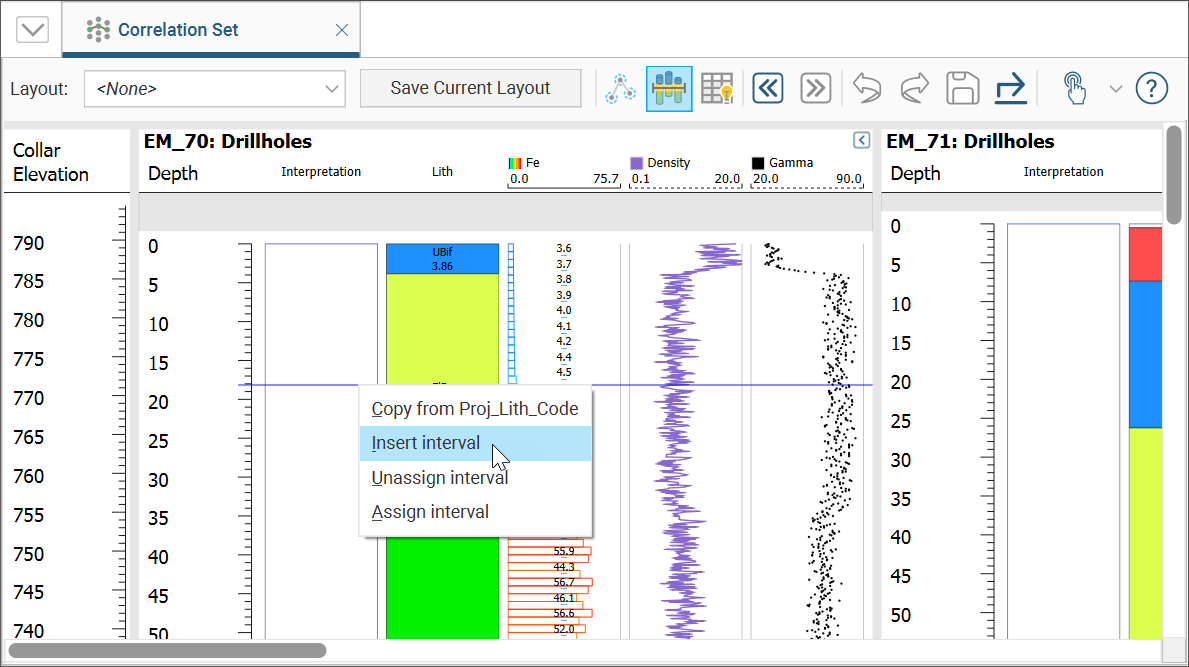

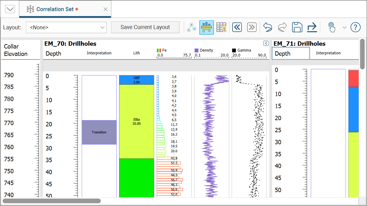

In the correlation set window, the blue line that appears as you mouse over the columns is used to create intervals. Position the blue line then right-click on it and select one of the options:

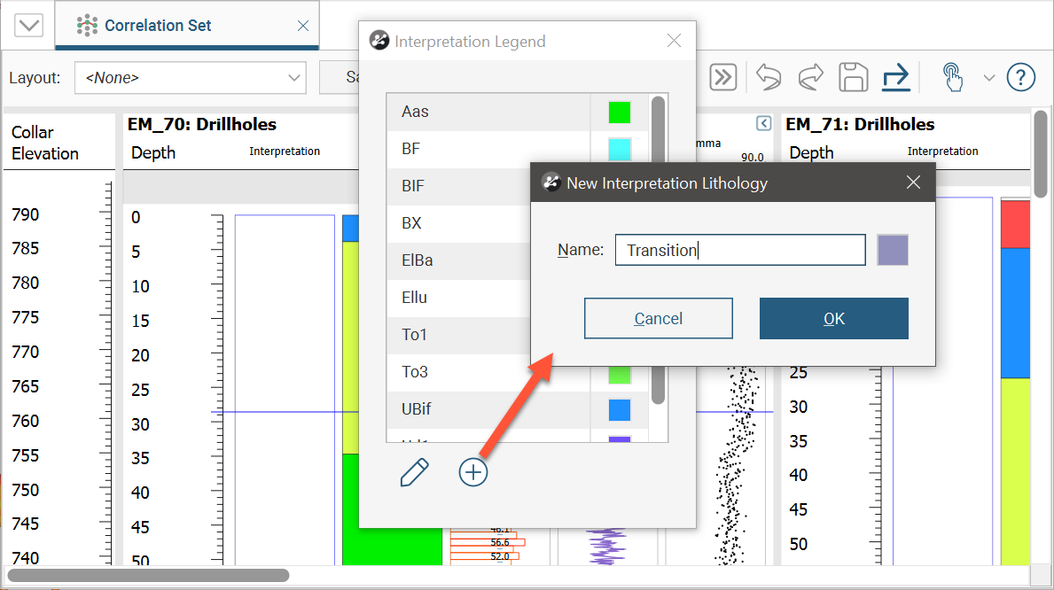

For example, to break up the “ElBa” interval below and create an interval called “Transition” where the “Fe” values are raised, move the blue line near to where you wish to create the interval. You do not need to be precise as you can adjust the interval once you have added it. Right-click and select Insert interval:
In the legend window, click the Add button and add a lithology called “Transition”:
Click OK to select the new lithology and close the legend window. The new lithology has been assigned to the interval:
To resize the interval, click and drag the interval end points.
Click on the interval end point and drag it into position without releasing the mouse button.
Move the mouse across to the data point you wish to snap to.
Release the mouse.

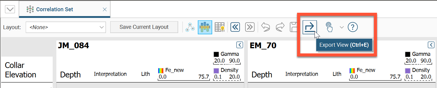

The current correlation set view can be exported as a PDF for use outside Leapfrog Works. Click the Export View button (
) in the correlation set toolbar and provide a filename when prompted. You will also be given the option to open the file in the application associated with the *.pdf file extension.
