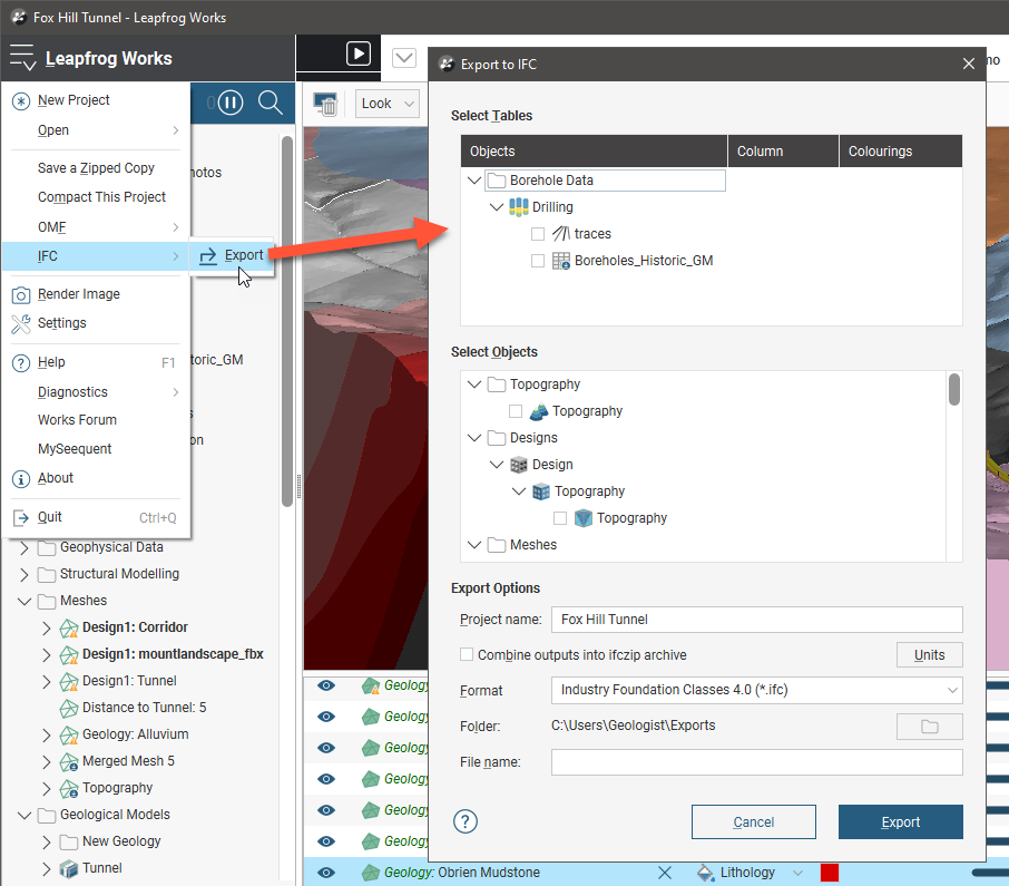

Drilling data, model surfaces and sections can be exported in some IFC formats on an object-by-object basis. There is also the option to bulk export drilling data, meshes, design meshes, model surfaces and sections from a project. This bulk export option is available from the main menu:
When using the main menu exporter, you can:
- Combine outputs into an archive, in ifczip format
- Change the units used to export the data:
- Length can be in metres or feet
- Plane angle can be in radians or decimal degrees

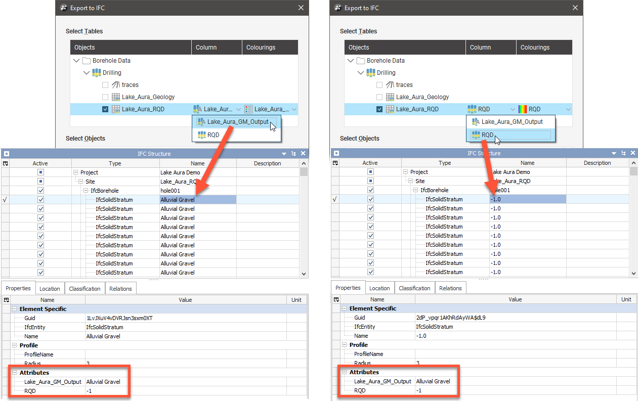

When an object has more than one colouring option available, you must choose which one you wish to use. If there is more than one colouring option, the other options will be exported as attributes. In this example, different columns are selected when drilling data is exported and the IFC structure is shown in BIMvision. Note that the selected column is exported as a SolidStratum type (in IFC 4X3 RC4) and both columns are included as attributes:

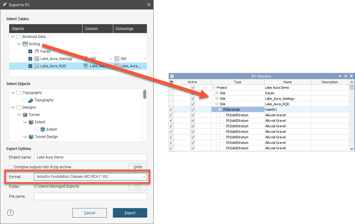

The structure used in exporting drilling data in IFC 4X3 RC4 differs from that used for IFC 4.0 and IFC 2x3. When exported in IFC 4X3 RC4, each drilling data table is exported as a Site with individual boreholes in Borehole format. Here the structure of three drilling data tables are shown in Leapfrog Works and BIMvision:

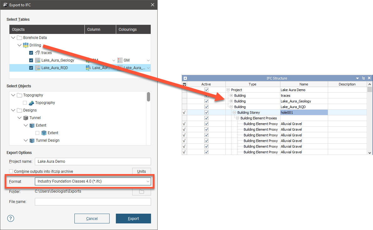

When exported in IFC 4.0 or IFC 2x3, each drilling data table is exported as a Building with individual boreholes as Building Storeys made up of Building Elements:

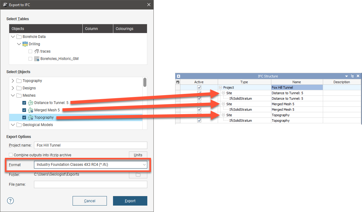

Meshes in the Meshes folder can be exported in IFC format via the main menu exporter and via the Meshes folder batch exporter. Only manifold meshes can be exported. If a mesh you wish to export to IFC is not listed, check its properties by right-clicking on the mesh in the project tree and selecting Properties. You can find out more about troubleshooting issues with meshes in the Visualising Issues With Imported Meshes topic.
The structure used in exporting meshes in IFC 4X3 RC4 differs from that used for IFC 4.0 and IFC 2x3. When exported in IFC 4X3 RC4, meshes are exported as Sites with SolidStratum layers. Here the structure of three meshes are shown in Leapfrog Works and BIMvision:

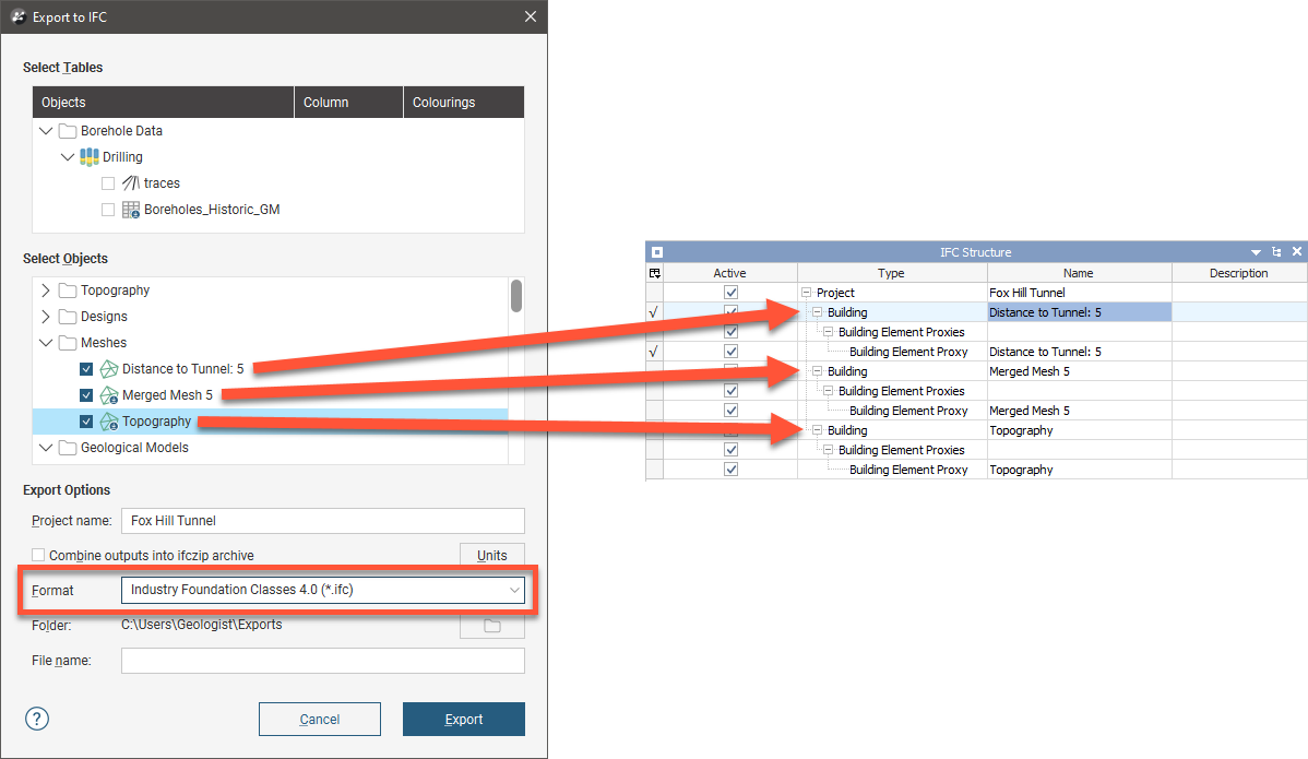

When exported in IFC 4.0 or IFC 2x3, meshes are exported as Buildings with Building Element layers:
Files in IFC 2x3 format are often considerably larger than the equivalent IFC 4.0 and IFC 4X3 RC4 files.

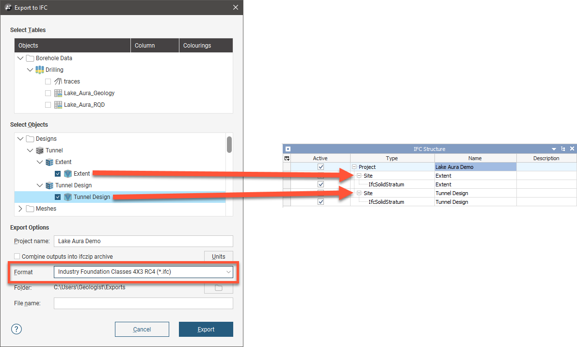

The structure used in exporting design meshes in IFC 4X3 RC4 differs from that used for IFC 4.0 and IFC 2x3. When exported in IFC 4X3 RC4, design meshes are exported as Sites with SolidStratum layers. Here the structure of two design meshes are shown in Leapfrog Works and BIMvision:

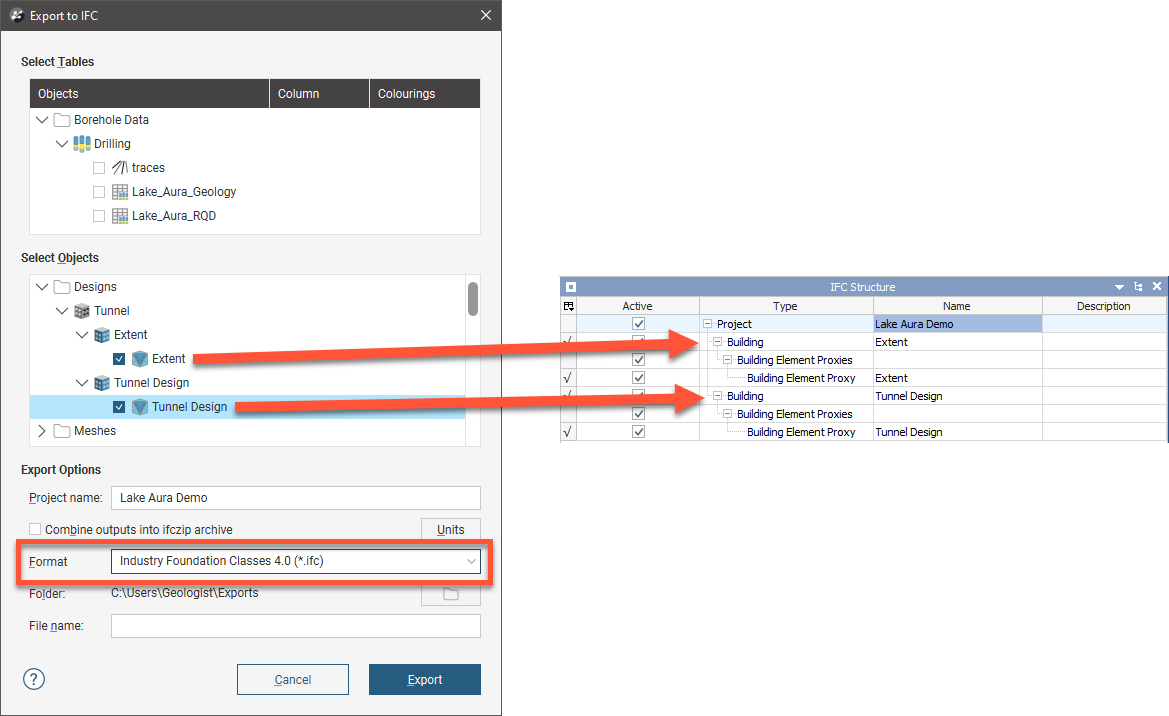

When exported in IFC 4.0 or IFC 2x3, design meshes are exported as Buildings with Building Element layers:

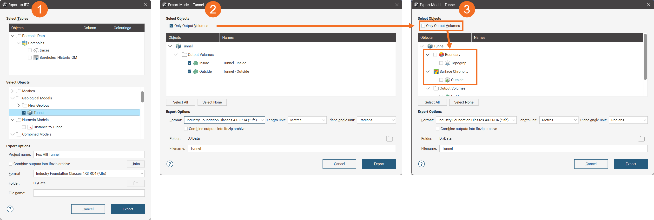

Model surfaces can be exported via the main menu exporter or on a model-by-model basis. There are important differences, however, between the main menu exporter and the model surfaces exporter and between the IFC version selected.
One difference is that when you use the main menu exporter, you can only export the model itself (
), which exports the output volumes. When exporting an individual model, however, you can also choose which output volumes you include (
) and from the other model surfaces (
The second main difference is that exported models are organised in different ways, depending on whether you are using the main menu exporter or the model exporter. How a model is organised is also dependent on the IFC format chosen.

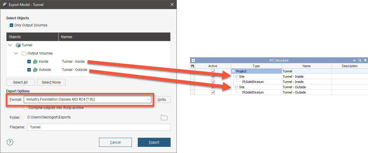

When using IFC 4X3 RC4 with the model exporter, a model is a Project with individual volumes as Sites:

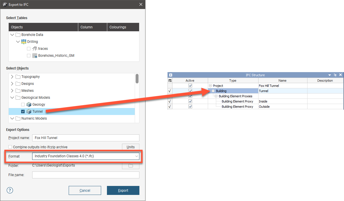

When using IFC 4.0 or IFC 2x3 with the main menu exporter, models are organised as Buildings with the model surfaces as Building Elements:

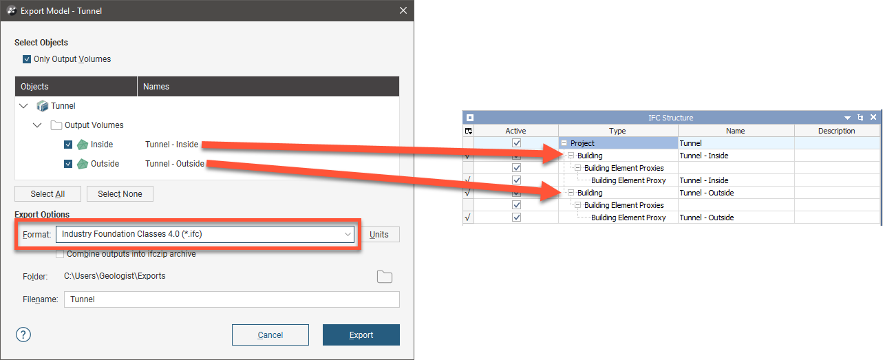

When using IFC 4.0 or IFC 2x3 with the model exporter, a model is a Project and output volumes are Buildings:

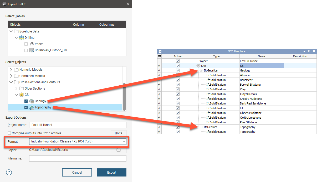

The structure used in exporting section evaluations in IFC 4X3 RC4 differs from that used for IFC 4.0 and IFC 2x3. When exported in IFC 4X3 RC4, section evaluations are exported as Sites, with Geoslice and SolidStratum layers. Here the structure of the CS section and two evaluations are shown in Leapfrog Works and BIMvision:

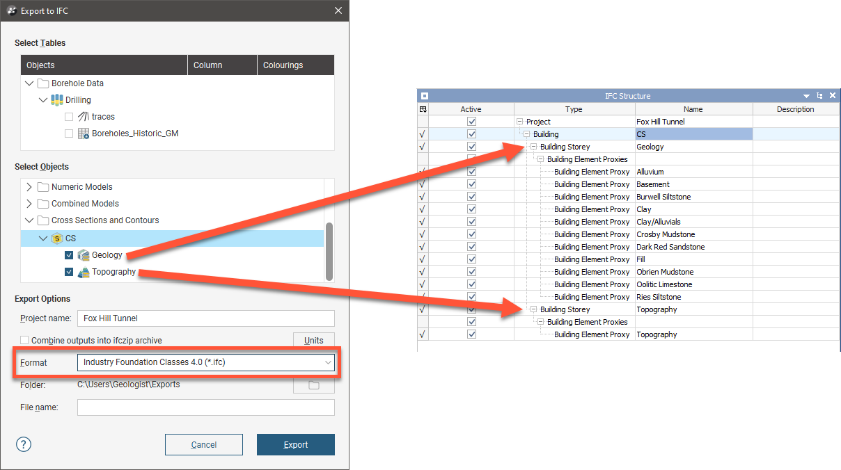

When exported in IFC 4.0 or IFC 2x3, sections are exported as Buildings with the evaluations as Building Storey and Building Element layers. Here the structure of the CS section and two evaluations are shown in Leapfrog Works and BIMvision:

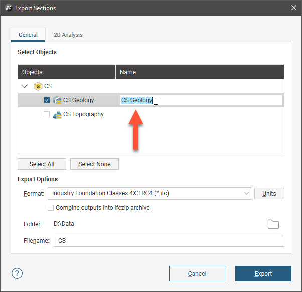

When exporting section evaluations with the section exporter, you can rename the evaluations, which you cannot do with the main menu exporter:
Note that the 2D Analysis tab is not available when exporting section evaluations in IFC format.
