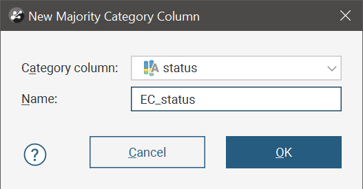

To back-flag the category data onto an interval table, right-click on the interval table in the project tree, select New Column, then select Majority Category From Other Table. The New Majority Category Column window will appear.
In the Category column dropdown will be a list of all the available category columns in the data cache that can be added to the interval table as a new column. Select one, then provide a suitable Name for the new column.

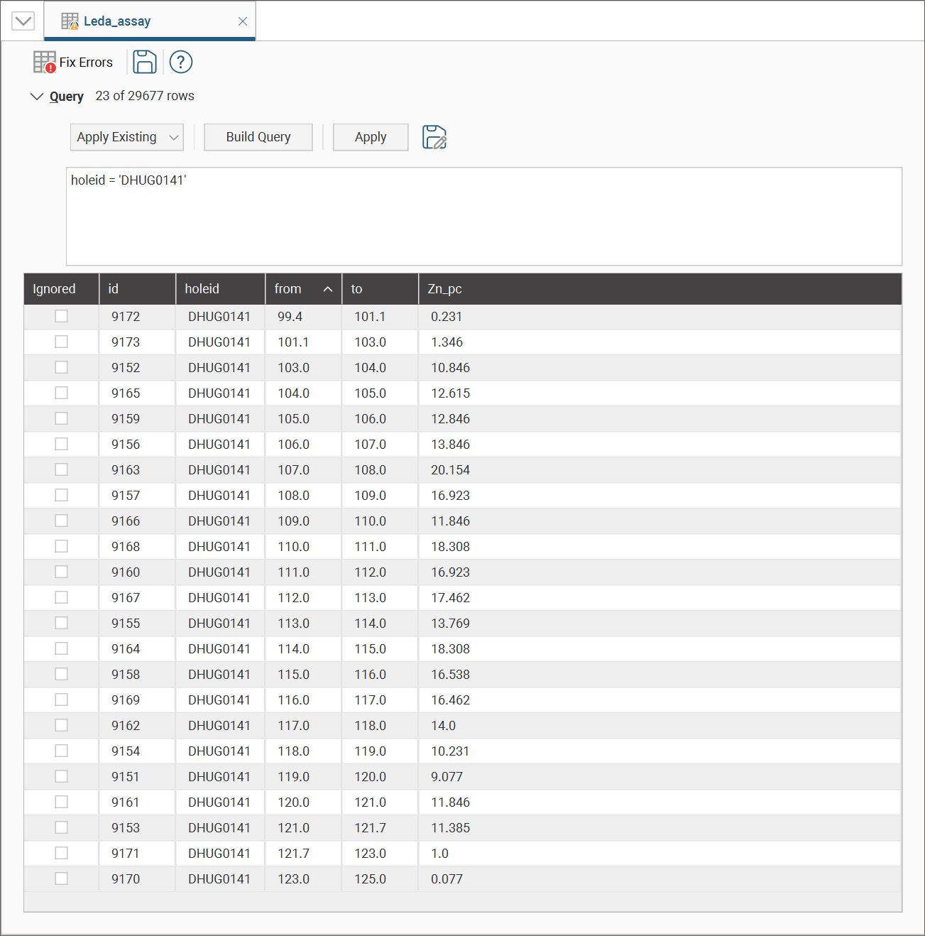

Here the intervals for a single borehole from an assay interval table are shown.

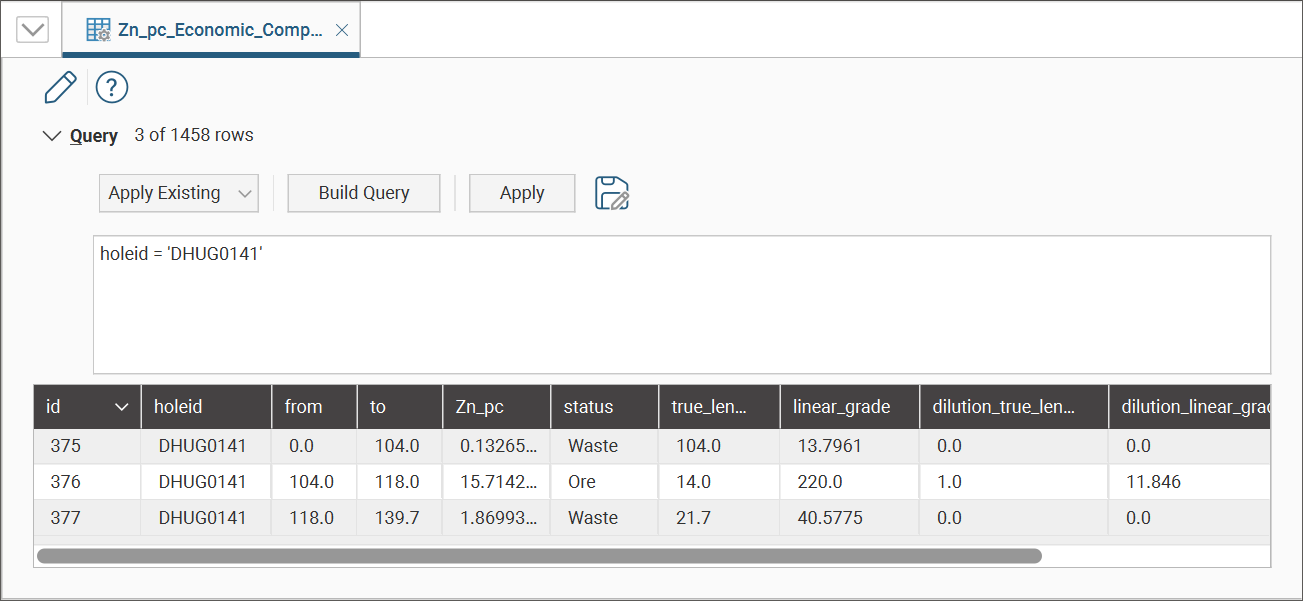

An economic compositing calculation has been applied to this assay data. Here is the composited data table filtered to show the same borehole.

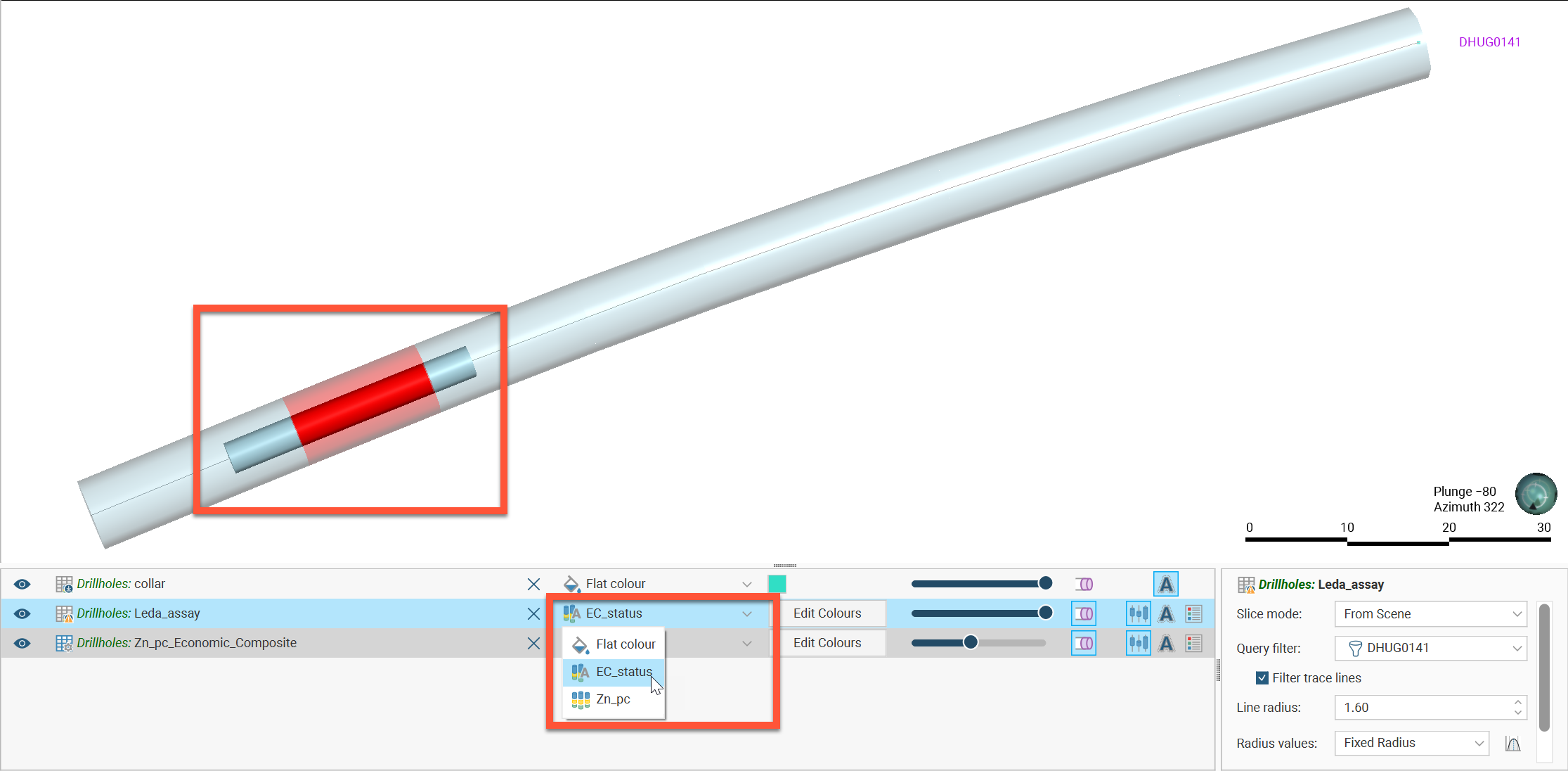

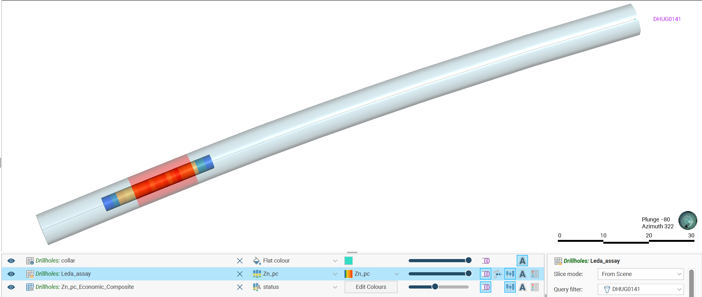

Both the interval table showing the assay values and the economic composite table showing the status category can be added to the scene. To view both simultaneously, the economic composite has been made slightly thicker and translucent.

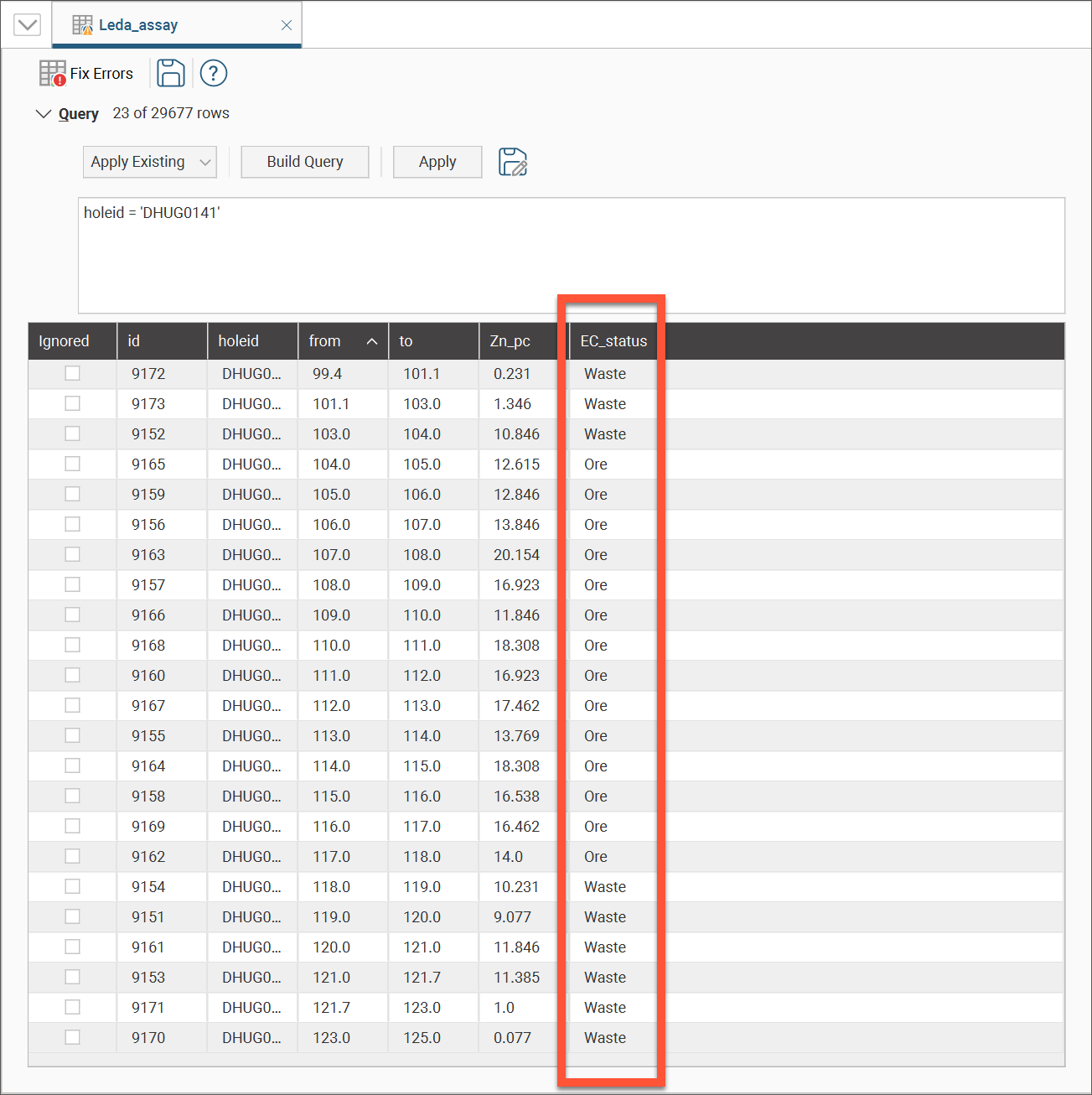

Once the majority category has been added to the interval table as a new column, each interval is assigned a value in the new column that corresponds to the category that was dominant for that interval range in the borehole. Note that no new intervals are created; although the economic compositing table had row ranges that extended from the start to the end of the borehole, the interval table does not have intervals describing the entire length of the borehole, and the original interval ranges are maintained.
Once the majority category has been added to the interval table, that column can be selected to be displayed for that table in the scene. Here the assay table has been changed to show the newly added category column, and it can be seen to match up with the original economic compositing information. Note that the assay borehole does not extend to the ends of the borehole trace because the assay table only contains interval data between 99.4 and 125.
