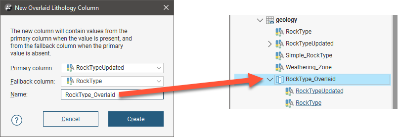

To create an overlaid lithology column, right-click on the interval table in the project tree and select New Column > Overlaid Lithology Column. For a merged table, right-click on it and select Overlaid Lithology Column.
The New Overlaid Lithology Column window will appear. For the Primary column, select the column that you wish to have precedence. Data in the Fallback column will be used when no data is available from the Primary column. Here, the RockTypeUpdated columns will be used as the Primary column and intervals in that column that don’t have data will use the RockType column:
Click Create to create the new column. The new column will appear in the project tree with links to the parent columns.

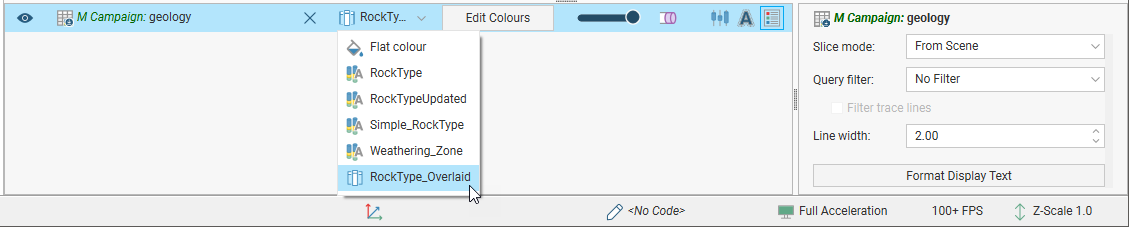

You can display drilling data with the new column by selecting it from the shape list:
