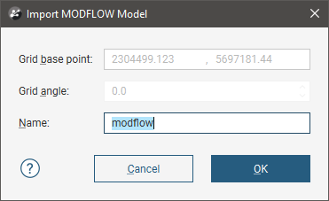

Importing a MODFLOW Model
Leapfrog Works imports the following types of MODFLOW models:
- MODFLOW Name files (*.nam, *.mfi, *.mfn, *.modflow.in)
- MODFLOW Grid Specification files (*.gsf)
To import a MODFLOW model, right-click on the Flow Models folder and select MODFLOW > Import Model. Leapfrog Works will ask you to specify the file location, and then will display the data in the file in the Import MODFLOW Model window:
If the world origin is available, the Grid Position will be displayed but cannot be edited.
Click OK to import the grid. The new MODFLOW model will appear in the project tree in the Flow Models folder:
If the world origin was not available when the model was imported, you can change the Grid Position. To do this, double-click on its grid object (

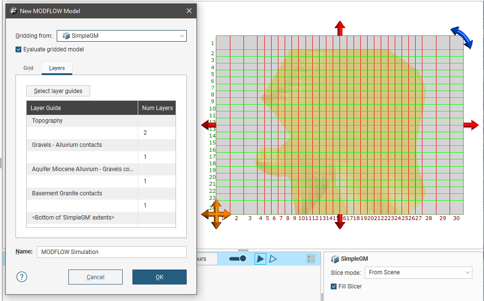

To create a structured MODFLOW model, you must first have at least one geological model defined in the project. Once this has been defined, add the geological model to the scene. Right-click on the Flow Models folder and select MODFLOW > New Structured Model.

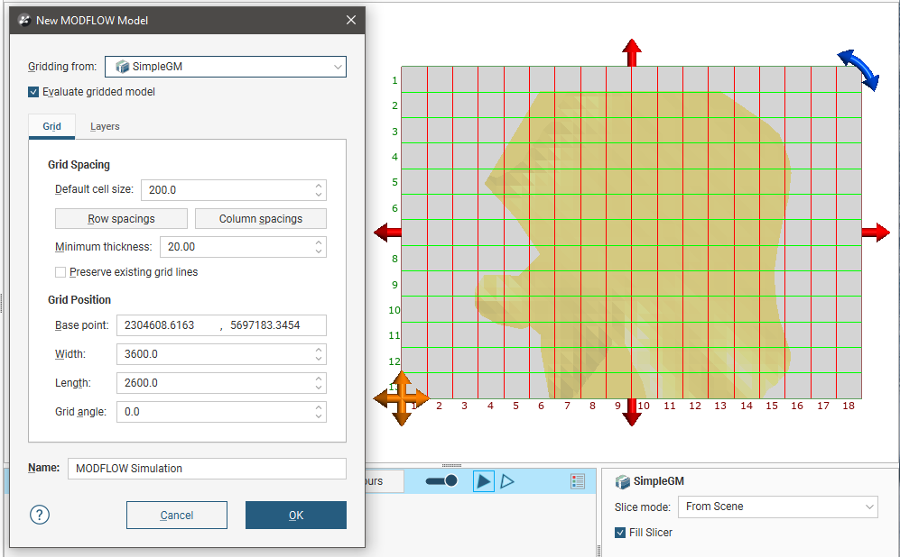

The New MODFLOW Model window will be displayed, together with controls in the scene that will help you to set the grid extents:
The new MODFLOW model will be based on the geological model in the Gridding from setting. If you wish to use a geological model other than the one selected when the window is opened, select it from the list. The grid dimensions will be updated in the scene.
The Preserve Existing Grid Lines option is used when setting a non-uniform grid in the scene window. If you are going to define a non-uniform grid in this way, create the model with the Default Cell Size set to the smallest cell size you wish to use, then edit it as described in Applying Varying Cell Sizes below.
Horizontal Grid Spacing
Click OK.
Vertical Grid Layering
Initially, there are two layers equally spaced between the topography and the geological model. Change the layers by clicking on Select layer guides button. The Layer Guides window will appear, showing the layers available in the selected geological model:
Click OK to create the new MODFLOW grid, which will appear in the Flow Models folder. You can edit the model by expanding it in the project tree and double-clicking on the grid object (
). The Edit MODFLOW Grid window will appear. You can edit the grid spacings, using the information in the scene window as a guide.

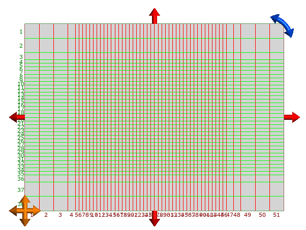

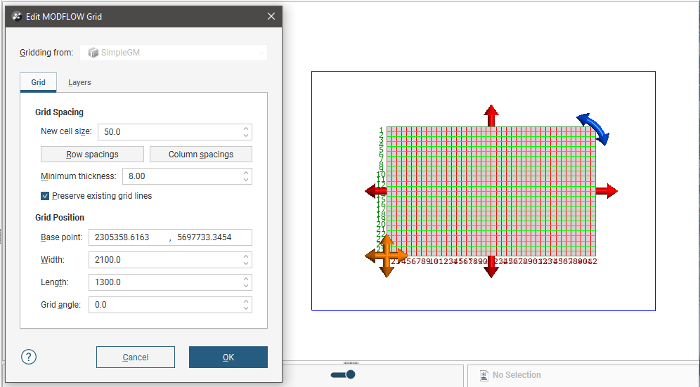

Another way to edit the grid is to use the controls in the scene to apply different cell size settings in different parts of the grid. For example, you may want to define a grid that has smaller cells in the centre than at the outer edges:
To set cell sizes in this way, it is best to start with a MODFLOW model where the New cell size is set to the smallest cell size you will use in the model.
For this example, we will start with a new grid with a New cell size of 50. We will set the adjacent cell size to 100 and the cell size at the outer boundary to 200.
First, we need to reduce the area that uses the cell size of 50 by using the red handles in the scene:
The blue box in the scene is the geological model extents for the model used to define the MODFLOW model and represents the unedited boundary of the MODFLOW model.
Next, enter the cell size to use for the area adjacent to the 50.0 cells in the New Cell Size field. Then, drag the red handles to enlarge the grid. The centre part of the grid is still set to 50, while the new area is set to 100:
If the Preserve Existing Grid Lines option is enabled, grid lines for cells already defined will not be moved to account for new cells.
Enter the next cell size in the New cell size field and then use the handles to enlarge the grid again:
Click OK to update the grid.

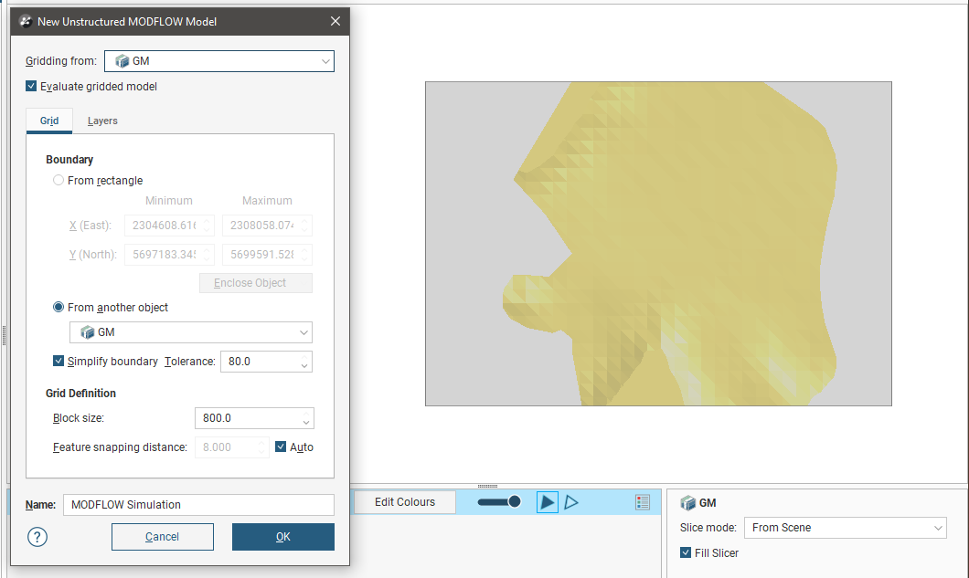

To create an unstructured MODFLOW model, you must first have at least one geological model defined in the project. Once this has been defined, add the geological model to the scene. Right-click on the Flow Models folder and select MODFLOW > New Unstructured Model.
The New Unstructured MODFLOW Model window will appear. In this example, a geological model has been added to the scene to aid in defining the MODFLOW model:
The Gridding from setting determines the geological model used for layer guides. Ticking the Evaluate gridded model box will evaluate the new MODFLOW model against the selected geological model and set it as the evaluation for export. See MODFLOW Evaluations below for more information. If you do not wish to evaluate the geological model on the grid, untick the box. You will still be able to use the layers in the geological model to control the grid layers.

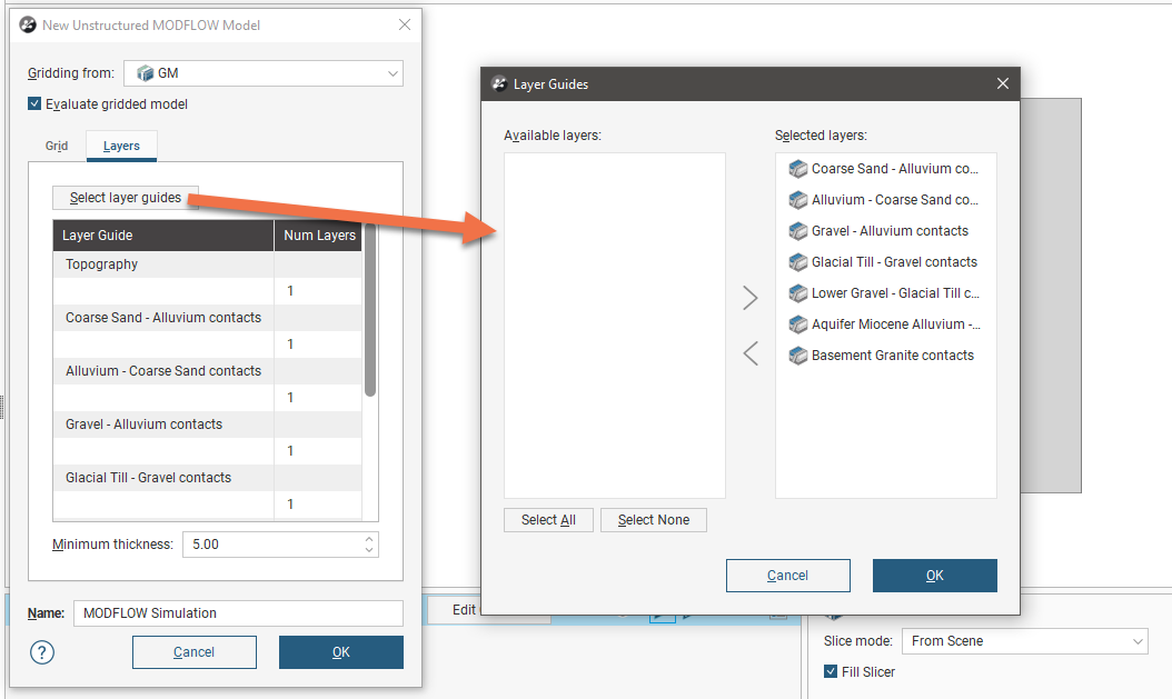

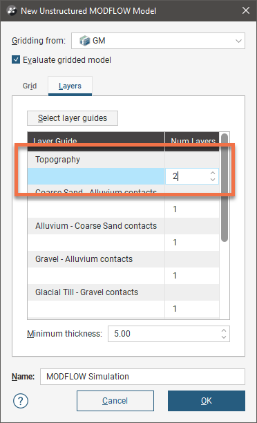

Click on the Layers tab to see the layers that will be used in the new model. By default, the layers from the Gridding from model are selected as layer guides, but you can change this by clicking the Select layer guides button and changing which layers are used:
Once you have determined which layers you will use as layer guides, you can change how many layers there will be in the model. To do this, click on a layer in the Layers tab and edit the Num Layers value:
The minimum thickness of each layer is determined by the Minimum thickness setting in the Grid tab. If there is a conflict between the Minimum thickness setting and the number of layers defined in the Layers tab, Leapfrog Works will display an error message when you click the OK button to create the model.

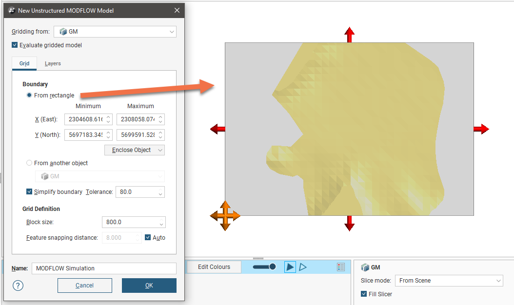

In the Grid tab, the model’s boundary can be defined as a rectangle or from another object in the project. In the example above, the geological model GM is used to define the MODFLOW model’s boundary. When the boundary is set to From rectangle, controls will appear in the scene that will help in setting the boundary:
The boundaries of the Gridding from model must be larger than the boundary of the new MODFLOW model.
When the boundary is set from another object in the project, the Simplify boundary option can be used to reduce the number of points along the boundary. A lower Tolerance value increases the number of points along the boundary. The two settings together let you define a basic boundary with blocks that are roughly uniform in size, set by the value of Block size. Here, a grid has been created from a geological model with the Simplify boundary option enabled:
The Block size setting determines the basic size of the triangles that make up the grid, although the size will vary according to features applied to the grid and the Feature snapping distance. The size will also vary if the Simplify boundary option is unticked, in which case the Block size setting is the maximum size of the triangles.
The Feature snapping distance is automatically set to 1 percent of the Block size. To use a smaller snapping distance, untick the Auto box and set the value required.
Click OK to generate the new MODFLOW model, which will appear in the project tree under the Flow Models folder.

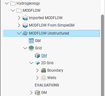

In the project tree, the MODFLOW model is organised into a 3D grid object (
) that contains a 2D grid (
To edit model settings such as the boundary, layer guides, Minimum thickness, Block size and the Feature snapping distance, double-click on the 3D grid object (

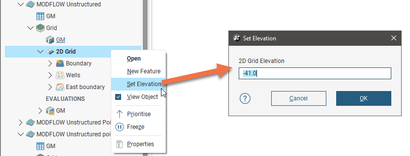

You can change the elevation of the 2D grid, if required. To do this, right-click on the grid and select Set Elevation:

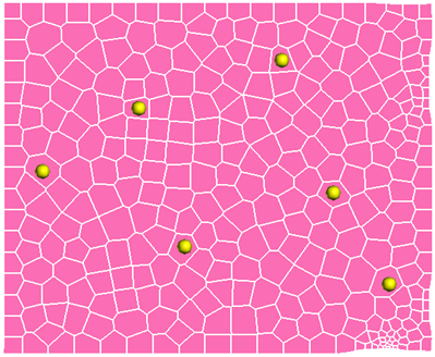

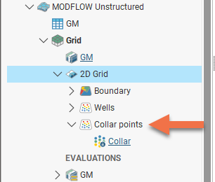

You can refine the resolution of the model by adding features to it around objects about which you have more information, such as drilling data.

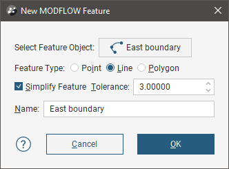

To add features to the model, expand it in the project tree, then right-click on the 2D grid object (
) and select New Feature.
Select the object you wish to use, then click OK to return to the New MODFLOW Feature window.
You can edit the feature by double-clicking on it or by right-clicking on it and selecting Open. In the Edit MODFLOW Feature window, you can enable or disable the Simplify Feature setting and change the Tolerance.

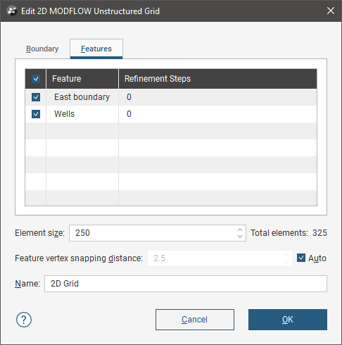

To view all features that have been applied to a MODFLOW model, double-click on the 2D grid object (
). This opens the Edit 2D MODFLOW Unstructured Grid window with the Features tab open, showing all features that have been added to the grid:

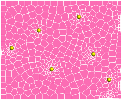

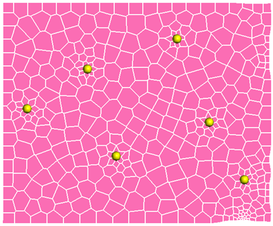

The images below show a grid displayed with collar points (in yellow) to demonstrate the effects of no features and collars applied with different refinement steps:
| No features | Collar points with 2 refinement steps | Collar points with 10 refinement steps |

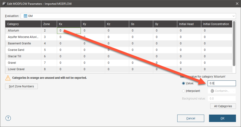

Setting Hydrological Properties

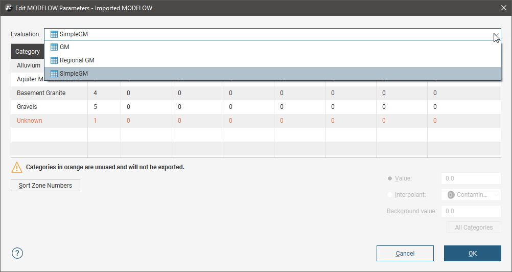

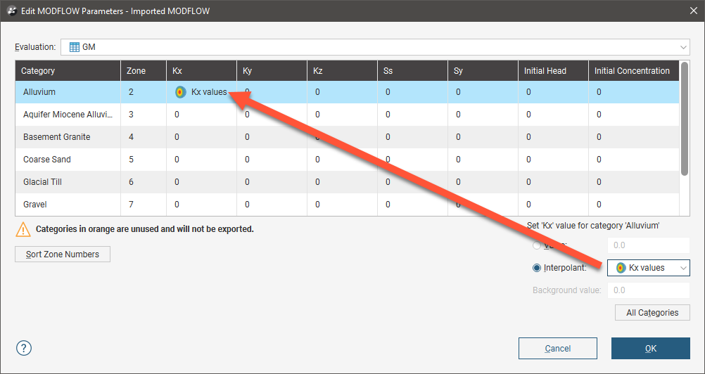

In the Edit MODFLOW Parameters window, you can enter the values for hydrological properties manually or you can use the values from an interpolant.

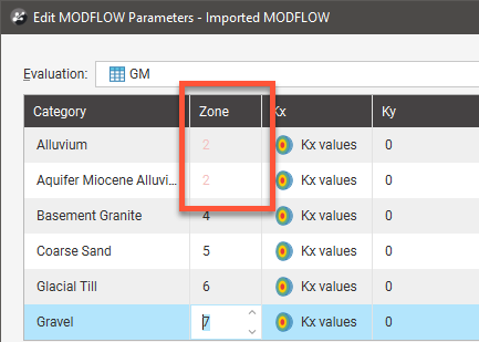

Zone Numbers
When the model is exported, the zone numbers are used to indicate the assignment of lithologies to blocks and are written to the MODFLOW zoned layer properties flow (*.lpf) file. In the Edit MODFLOW Parameters window, you can change the zone number for a lithology by clicking in a cell and entering a different zone number. If you reorder the zones in this way, zone number conflicts will be highlighted in red:
Zone numbers must be unique and you will not be able to close the window and save data if there are conflicts.
If you click on the Sort Zone Numbers button, the zone numbers will be ordered from top to bottom.
Zone numbers should not be sorted once a model has been exported as the new numbers will not be reflected in the exported model.

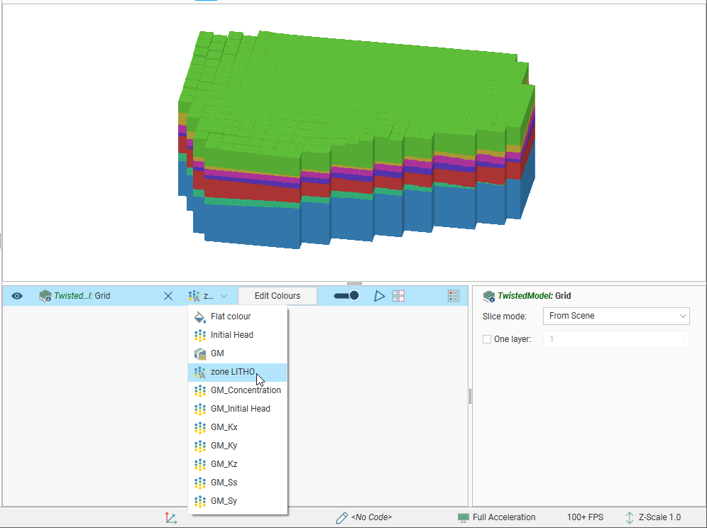

Dragging a MODFLOW model into the scene displays its grid object. Here, an imported model has been evaluated against a geological model and added to the scene:
The viewing options available are the flat colour option, the evaluated geological model and zone data imported with the model. Other inputs imported with a model will also be available from this list, and once the model has been evaluated against a geological model or interpolant, you can also display the model using the grid’s hydrological properties.
Grids are displayed as cells. When a geological model evaluation or lithological zone information is displayed, you can also display a legend for the grid.

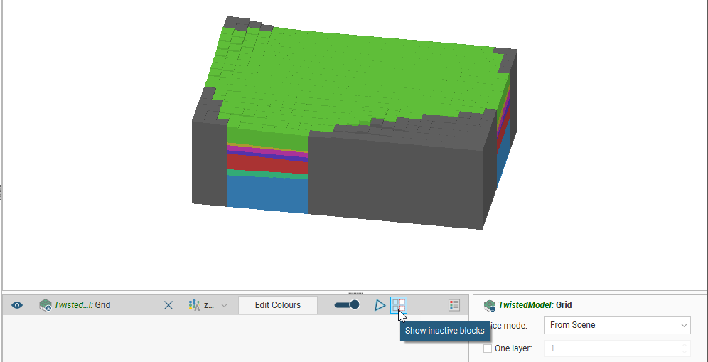

The Show inactive blocks(
) option displays inactive cells in grey:

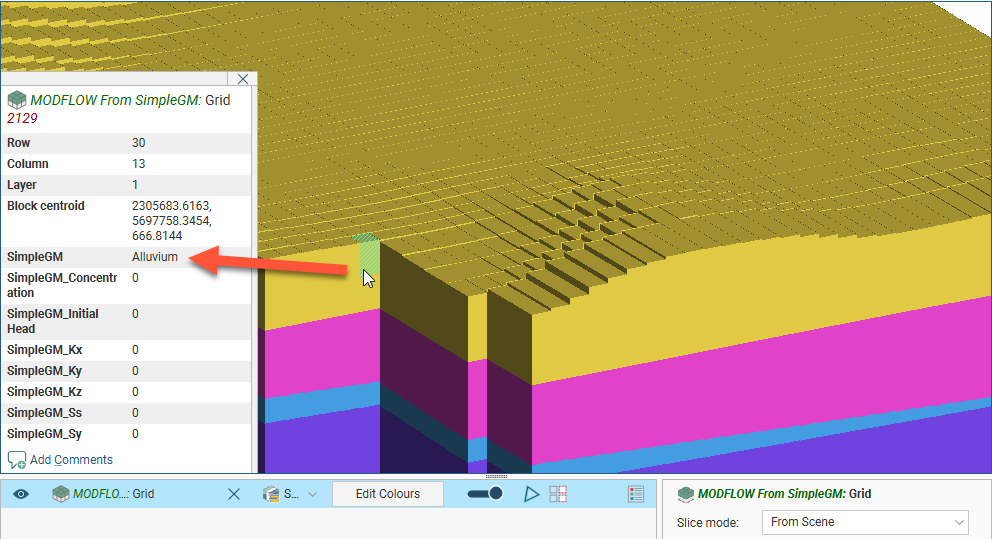

When a MODFLOW model is displayed in the scene, you can view information about the individual cells in the model by clicking on a block. The window that appears shows information about the selected block, including its centroid and the lithology assigned to the block from the evaluated geological model. Information from all geological models and interpolants the grid has been evaluated against will be displayed:
