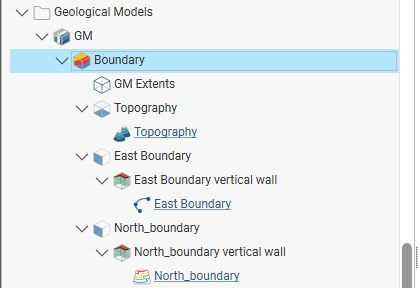

To create an extent, expand the geological model in the project tree. Right-click on the Boundary object and select from the New Lateral Extent or New Base options. Follow the prompts to create the extent, which will then appear in the project tree under the model’s Boundary object. For example, this geological model has two lateral extents, one from a polyline and the other from GIS data:
New extents are automatically applied to the boundary being modified. Leapfrog Works usually orients a new extent correctly, with red presenting the inside face of the extent and blue representing the outside face. If this is not the case, you can change the orientation by right-clicking on the extent in the project tree and selecting Swap Inside.

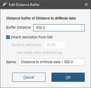

To change the extent’s settings, expand the model’s Boundary object in the project tree and double-click on the extent. The Edit Distance Buffer window will appear.
The resolution of extents is automatically inherited from the geological model. You can change the resolution for an extent if you want more or less detail than for the geological model as a whole. To do so, untick the box for Inherit resolution from GM and change the setting.

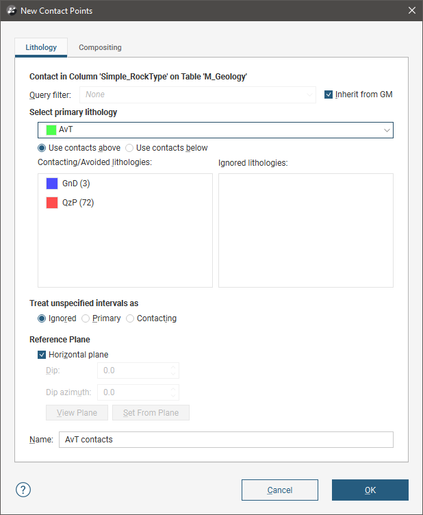

Base From Lithology Contacts
To create a base from lithlogy contacts, right-click on the Boundary object and select either New Base > From Base Lithology or New Base > From Other Contacts.
The only difference in the two methods is that when creating a base from other contacts, you must first select the lithology column from those available in the project.
When defining the base, select the primary lithology and the contacts to use:
For complex geologies, the up and down directions for the base may not be clear. If this is the case, untick the Horizontal Plane box. A reference plane will appear in the scene, with the up-facing surface labelled A and the downward-facing surface labelled B. Controlling the position of the reference plane is similar to controlling the position of the moving plane:
Click OK to create the base, which will appear under the Boundary object. The new base will automatically be added to the model.
Each geological model can have only one base defined, so if you wish to define a new base, you must first delete the existing base from the model. Do this by right-clicking on the Base object and selecting Delete. You can also choose not to use the base you have defined. See Removing an Extent From a Geological Model for more information.

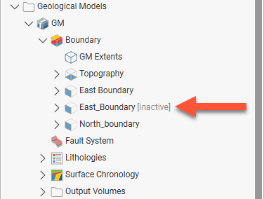

If you have defined an extent and want to remove it from the model, there are two options. The first is to right-click on the extent in the project tree and click Delete. This deletes the extent from the model, but does not delete parent objects from the project unless they were created as part of the model, e.g. a polyline used as a lateral extent but not shared within the project. Use this option only if you are sure you do not want to use the extent.

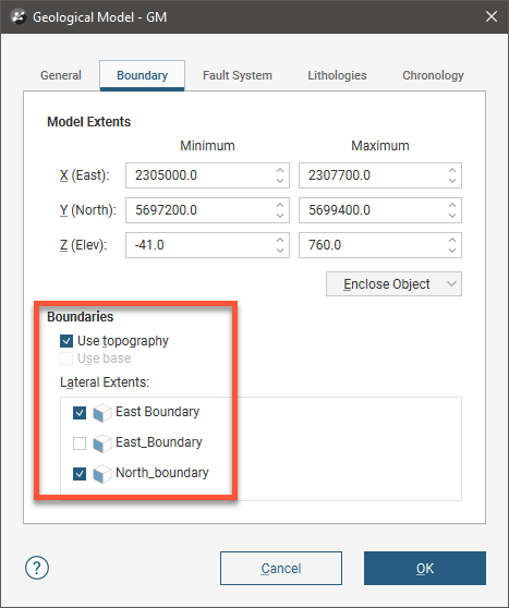

The second method is useful if you are making changes to the extent and do not want to recompute the model with each change. Double-click on the model’s Boundary object or double-click on the model and click on the Boundary tab. The Boundaries part of the window lists all objects used as extents for a geological model:
Untick the box for extents to temporarily disable them in the model. The model will be reprocessed, but you can then work on the extent without reprocessing the model. Disabled extents will be marked as inactive in the project tree:
