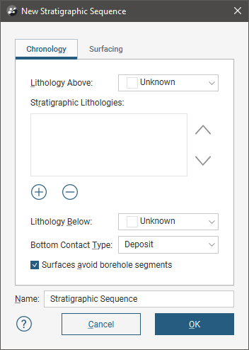

To create a stratigraphic sequence, right-click on the Surface Chronology object and select New Stratigraphy. The New Stratigraphic Sequence window will appear:

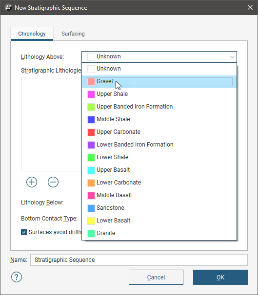

Select the lithologies at the top and bottom of the stratigraphic sequence. To do this, select the Lithology Above and Lithology Below from the lithologies available in the geological model:
You can add lithologies to the Stratigraphic Lithologies list first, but if you set the Lithology Above and Lithology Below first, those lithologies will be filtered out when you select the Stratigraphic Lithologies.

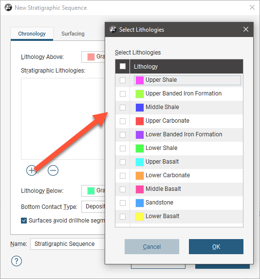

Next, click the Add button (
) to view available lithologies:

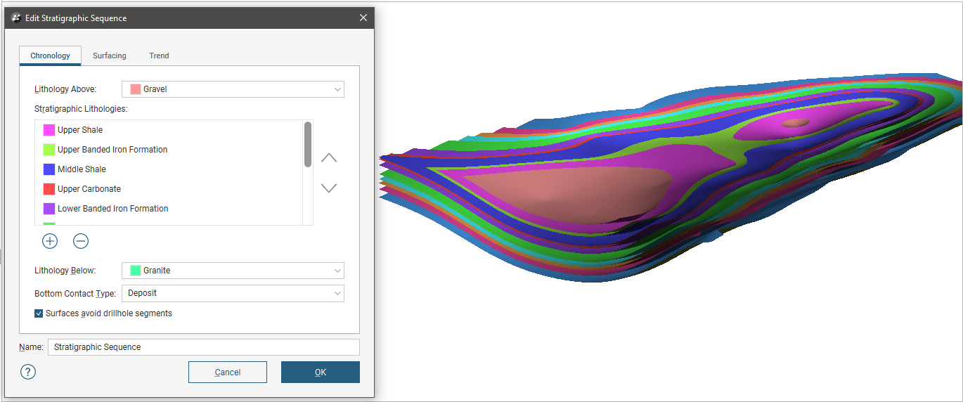

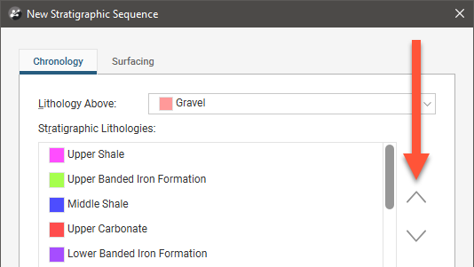

Select the lithologies that you want to use in the stratigraphic sequence, then click OK to add the layers to the Stratigraphic Lithologies list. Make sure they arranged in the correct order, using the arrows alongside the window to rearrange them, if necessary:
In the New Stratigraphic Sequence window, select whether the Bottom Contact Type is an erosion or a deposit.
When the Surfaces avoid borehole segments option is enabled, the surfaces in the stratigraphic sequence will not cut through intervals of lithologies that are selected for the stratigraphic sequence.

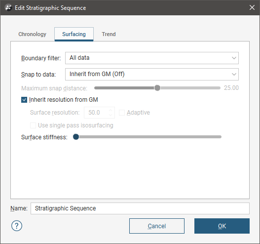

Next, click on the Surfacing tab to set the surfacing settings for each surface created for the sequence:
For the Boundary filter and Snap to data options, it is possible to override these settings for the individual contact surfaces that are part of the stratigraphic sequence. To do this, select Custom. Once the stratigraphic sequence has been created, expand it in the project tree and double-click on each surface to change its surfacing options, as described in Contact Honouring and Boundary Filtering for Individual Surfaces below.
Boundary Filtering
- Off. Data is not filtered.
All contact surfaces that make up a stratigraphic sequence will inherit the Boundary filter setting from the stratigraphy unless Boundary filter is set to Custom.
Snapping to Data
For a stratigraphic sequence, the options are:
All contact surfaces that make up a stratigraphic sequence will inherit the Snap to data setting from the stratigraphy unless Snap to data is set to Custom.
Surface Stiffness
The Surface Stiffness controls the smallest bend a surface will make, where a higher value will result in a smoother surface that bends less. The default value is 0, which is no stiffening.
Click OK to create the stratigraphy, which will be added to the project tree as part of the Surface Chronology object.

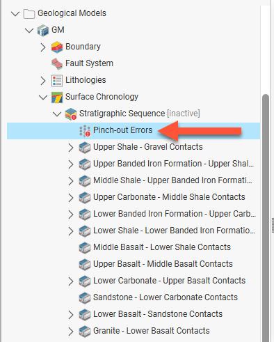

The objects that make up the stratigraphic sequence include the generated contact surfaces and any points that result in pinch-out errors:
Correcting Pinch-Out Errors
Add the pinch-out errors object (
) to the scene to view the points that are causing errors. To find out more about the errors, either:
- Right-click on the stratigraphic sequence and select List Errors
- Double-click on the pinch-out errors object (

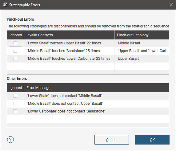

In the Stratigraphic Errors window, information is provided about the different errors that occur in the stratigraphic sequence, with pinch-out errors and other errors listed separately:
Use this information, together with the pinch-out error points, to either remove lithologies from the sequence or adjust surfaces using any of the tools available for individual surfaces, as described in Editing Individual Surfaces below.
Remove lithologies from the sequence by double-clicking on the sequence in the project tree, then reorganising the lithologies in the Chronology tab.
You can also ignore an error by ticking the Ignored box in the Stratigraphic Errors window.

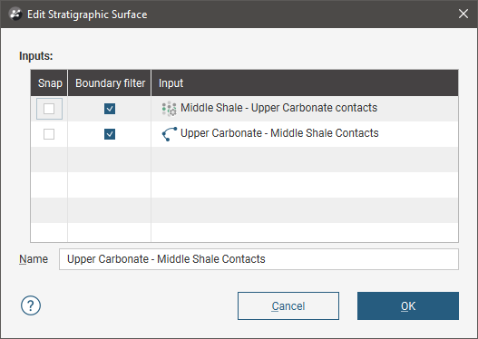

Next, double-click on an individual surface in the project tree. The window that appears shows all the data objects used to create the surface:
See Boundary Filtering and Snapping to Data for more information.
