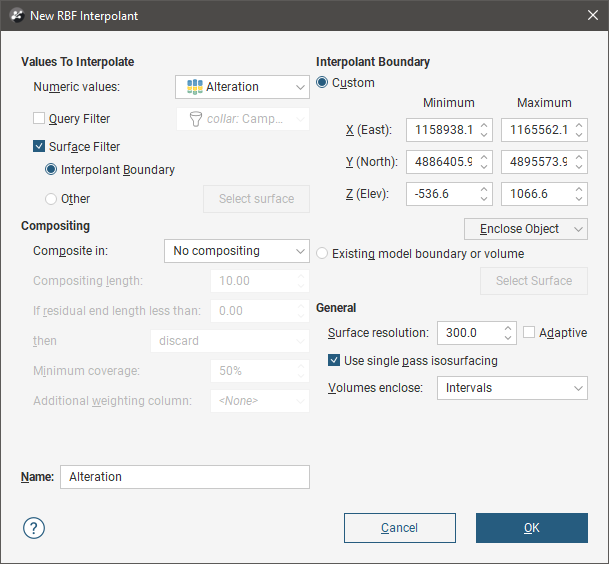

Creating an RBF Interpolant
To create an RBF interpolant, right-click on the Numeric Models folder and select New RBF Interpolant. The New RBF Interpolant window will be displayed:
This window is divided into four parts that determine the values used to create the interpolant, the interpolant boundary, any compositing options and general interpolant properties.
If you are unsure of some settings, they can be changed later.
Values Used
In the Values To Interpolate part of the New RBF Interpolant window, you can select the values that will be used and choose whether or not to filter the data and use a subset of those values in the interpolant.
You can build an interpolant from either:
- Numeric data contained in imported drilling data.
Applying a Query Filter
If you have defined a query filter and wish to use it to create the interpolant, select the filter from the Query filter list. Once the interpolant has been created, you can remove the filter or select a different filter.
Applying a Surface Filter
The Interpolant Boundary
Once the interpolant has been created, you can further modify its boundary. See Modifying an RBF Interpolant’s Boundary With Lateral Extents and Adjusting the Interpolant Boundary below.
Compositing Options
When numeric values from drilling data are used to create an interpolant, there are two approaches to compositing that data:
- Composite the drilling data, then use the composited values to create an interpolant. If you select composited values to create an interpolant, compositing options will be disabled when you first create the interpolant and there will be no Compositing tab when you edit the interpolant.
- Use drilling data that hasn’t been composited to create an interpolant, then apply compositing settings to the interpolated values. If you are interpolating values that have not been composited and do not have specific Compositing values in mind, you may wish to leave this option blank as it can be changed once the model has been created. You can also change whether or not you use compositing once the interpolant has been created in the interpolant’s Compositing tab.
Set the Surface resolution for the interpolant and whether or not the resolution is adaptive. See Surface Resolution in Leapfrog Works for more information on the effects of these settings. The resolution can be changed once the interpolant has been created, so setting a value in the New RBF Interpolant window is not vital. A lower value will produce more detail, but calculations will take longer.
The Volumes enclose option determines whether the interpolant volumes enclose Higher Values, Lower Values or Intervals. Again, this option can be changed once the interpolant has been created.
Once you have created an RBF interpolant, you can adjust its properties by double-clicking on it. You can also double-click on the individual objects that make up the interpolant.

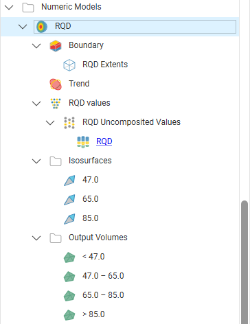

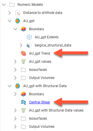

The RBF Interpolant in the Project Tree
The new interpolant will be created and added to the Numeric Models folder. The new interpolant contains objects that represent different parts of the interpolant:
- The Trend object describes the trend applied in the interpolant. See Changing the Trend for an RBF Interpolant.
- The points data values object contains all the data used in generating the interpolant. See Changing and Adjusting the Values Used.
- The Isosurfaces folder contains all the meshes generated in building the interpolant.
- The Output Volumes folder contains all the volumes generated in building the interpolant.
Other objects may appear in the project tree under the interpolant as you make changes to it.

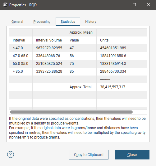

RBF Interpolant Statistics
You can view the approximated mean for each output volume by right-clicking on the interpolant and selecting Properties. Click on the Statistics tab:

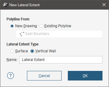

Extent From a Polyline
To create a new extent from a polyline, right-click on the interpolant’s Boundary object and select New Lateral Extent > From Polyline. In the window that appears, select whether you will create a new polyline or use an existing one:
You can create the extent as a vertical wall or surface. If you create the lateral extent as a surface, you will be able to modify it using additional data, as described below. A lateral extent created as a vertical wall, however, cannot be modified.
Click OK to generate the new extent. If you have chosen to create a New Drawing, the drawing controls will appear in the scene and you can begin drawing, as described in Drawing in the Scene.
If the surface generated does not fit the polyline adequately, you can increase the quality of the fit by adding more points to the polyline. See Drawing in the Scene for information on adding points to polylines.

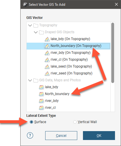

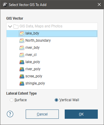

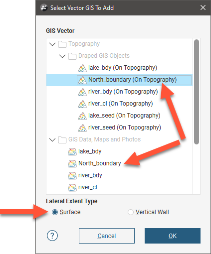

Extent From GIS Vector Data
GIS data in the project can be used to create a lateral extent for an RBF interpolant. Once the data you wish to use has been imported into the project, right-click on the interpolant’s Boundary object and select New Lateral Extent > From GIS Vector Data.

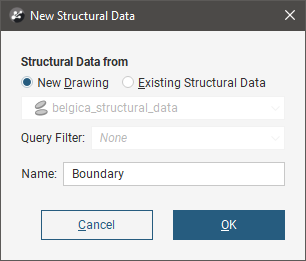

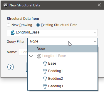

Extent From Structural Data
Planar structural data can be used to create a lateral extent for an RBF interpolant. You can create a new structural data table or use a table that already exists in the project. If you want to use categories of structural data in creating the extent, use an existing table and create filters for those categories before creating the lateral extent.
To start, right-click on the interpolant’s Boundary object and select New Lateral Extent > From Structural Data. The New Structural Data window will be displayed, showing structural data available in the project:
Click OK to generate the new extent. If you have chosen to create a New Drawing, the drawing controls will appear in the scene and you can begin drawing, as described in Creating New Planar Structural Data Tables. To share the new structural data table, right-click on it and select Share. The table will be saved to the Structural Modelling folder.

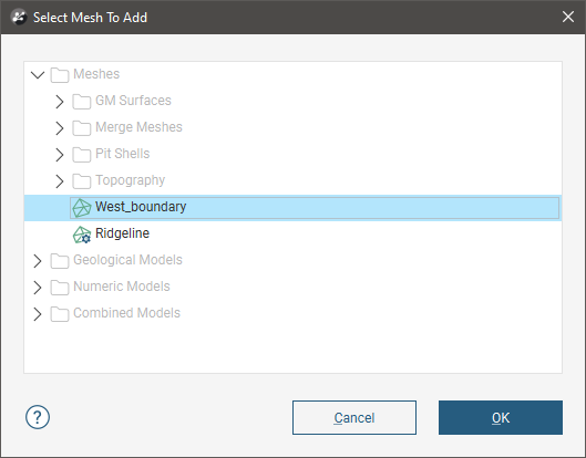

Extent From a Surface
To use a surface as lateral extent for an RBF interpolant, right-click on the interpolant’s Boundary object and select New Lateral Extent > From Surface. The Select Boundary window will appear, showing all the meshes that can be used as an extent:
Select the required mesh and click OK. The extent will be added to the interpolant’s Boundary object.

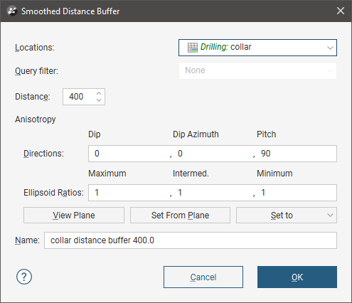

Leapfrog Works can calculate the distance to set of points and use the resulting distance buffer as a lateral extent for an RBF interpolant. To create a new lateral extent from a distance buffer, right-click on the interpolant’s Boundary object and select New Lateral Extent > From Distance To Points. The Smoothed Distance Buffer window will appear:
You can also use the Set to list to choose different options Leapfrog Works has generated based on the data used to build the interpolant. Isotropic is the default option used when the interpolant is created.
To change the extent’s settings, expand the interpolant’s Boundary object in the project tree and double-click on the extent. Adjust the Distance and Anisotropy, if required.

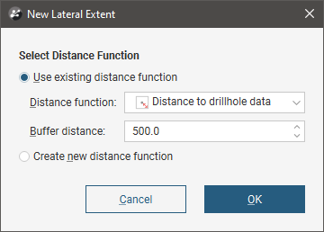

A distance function calculates the distance to a set of points and can be used to bound an RBF interpolant. You can use an existing distance function as a lateral extent or create a new one.
To use a distance function as a lateral extent, right-click on the interpolant’s Boundary and select New Lateral Extent > From Distance Function. If there are no distance functions in the project, you will be prompted to create a new one. See Distance Functions for information on defining and editing the distance function.
When you create a new distance function, it will be part of the interpolant’s Boundary object and will not be available elsewhere in the project. To share it within the project, expand the lateral extent in the project tree and right-click on the distance function. Select Share. The distance function will be saved to the Numeric Models folder.

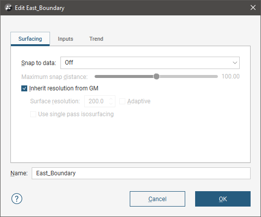

Changing a Lateral Extent’s Settings
For lateral extents created from polylines, GIS data, points and structural data, you can change the extent’s settings by double-clicking on it in the project tree.
Surface Resolution
For RBF interpolants, the resolution of lateral extents is inherited from the settings in the interpolant’s Outputs tab, but the adaptive isosurfacer is automatically disabled. Enter a different Surface resolution value, if required, and tick Adaptive to enable the adaptive isosurfacer.

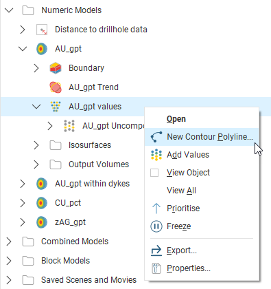

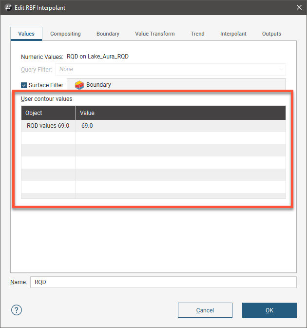

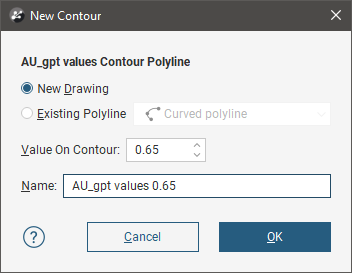

Adding a Contour Polyline
Adding a contour polyline is a useful tool for manually adjusting a surface to make it more geologically reasonable. To start adding a contour polyline, draw a slice where you wish to adjust the surface and decide what value you will assign to the contour line. Next, right-click on the values object and select New Contour Polyline. The next step is to choose whether you will draw a new polyline or use one already in the project:
Only GIS lines, polylines imported into Leapfrog Works or polylines created using the straight line drawing tool can be used to create contour lines.
Enter the value to be used for the contour and a name for it. Click OK. If you have chosen the New Drawing option, the new object will be created in the project tree and drawing tools will appear in the scene. Start drawing in the scene as described in Drawing in the Scene. When you have finished drawing, click the Save button (
). The new contour will automatically be added to the interpolant and will appear in the project tree as part of the interpolant’s values object.
To change the value assigned to a contour polyline, double-click on the interpolant in the project tree. In the Values tab, contour polylines and their assigned values are shown in the User contour values table:
To change the value on a contour, click in the Value column and edit the entry.
To edit the polyline, right-click on it in the project tree and select Edit Polyline or add it to the scene and click the Edit button (
) in the shape list. If you wish to remove a contour polyline from the interpolant, right-click on it in the project tree and select Delete or Remove.

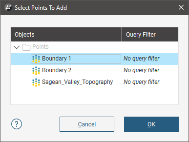

Adding Points
To add points to an RBF interpolant, right-click on the values object in the project tree and select Add Values. Leapfrog Works will display a list of all suitable points objects in the project. Select an object and click OK.

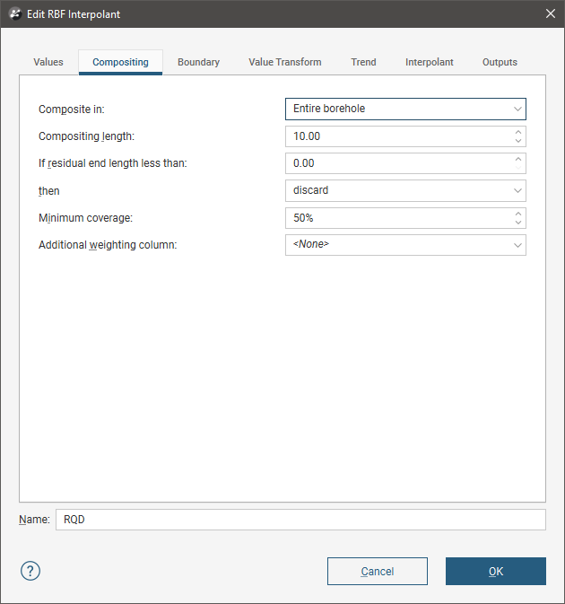

Compositing Parameters for an RBF Interpolant
When an RBF interpolant has been created from data that has not been composited, compositing parameters can be changed by double-clicking on the interpolant in the project tree, then clicking on the Compositing tab.
The Compositing tab will only appear for interpolants created from drilling data that has not been composited.
You can composite in the entire borehole or only where the data falls inside the interpolant boundary. See Numeric Composites for more information on the effects of the Compositing length, For end lengths less than and Minimum coverage settings.

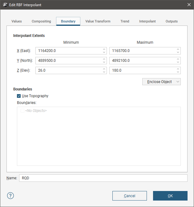

See Modifying an RBF Interpolant’s Boundary With Lateral Extents above for information on creating and working with lateral extents.
To change an RBF interpolant’s boundary, double-click on the interpolant in the project tree, then click on the Boundary tab:
Lateral extents can be used to restrict modelling to a particular area of interest; for example, modelling can be restricted to a known distance from boreholes by applying a distance function as a lateral extent.

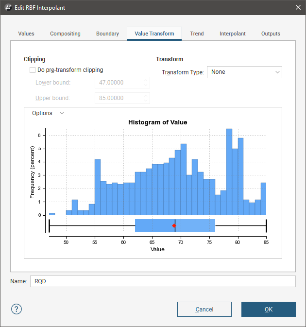

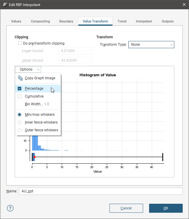

Clipping and Transforming Values for an RBF Interpolant
To clip data and apply a transformation to an RBF interpolant, double-click on the interpolant in the project tree, then click on the Value Transform tab:
The options for Transform Type are None and Log. Log uses a natural logarithm to compress the data values to a smaller range. This may be useful if the data range spans orders of magnitude. The function used is:
ln(x+s)+c
where s is the Pre-log shift and c is a constant. In order to avoid issues with taking the logarithm of zero or a negative number, Pre-log shift is a constant added to make the minimum value positive. The value of the pre-log shift will automatically be chosen to add to the minimum value in the dataset to raise it to 0.001. This constant is then added to all the data samples. You can modify the value of the Pre-log shift, as increasing this value further away from zero can be used to reduce the effect of the natural logarithm transformation on the resultant isosurfaces.
Note that a further constant, c, is added to the natural logarithm of the data with the pre-log shift added to it. If there are any negative numbers that result from taking the natural log of the data, the absolute value of the most negative number is taken and added to all the transformed data results. This will raise the value of all the data so the minimum data value is zero. The value of c is chosen automatically and cannot be modified.
If you tick the Do pre-transform clipping option, you can set the Lower bound and the Upper bound to cap values that are too low or too high. For example, if you set the Upper bound from 14.00 to 10.00, grade values above 10.00 will be regarded as 10.00.

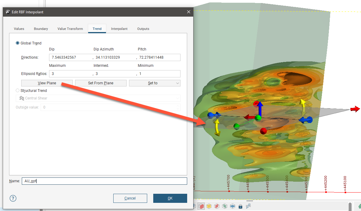

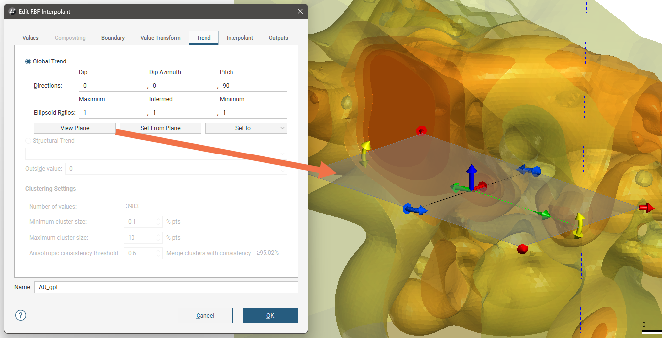

Using a Global Trend
The easiest way to change the trend applied to an interpolant is using a global trend set from the moving plane.
Click View Plane to add the moving plane to the scene, then click on the plane to view its controls. You may need to hide part of the interpolant to click on the moving plane:
Click OK to regenerate the interpolant and view changes.

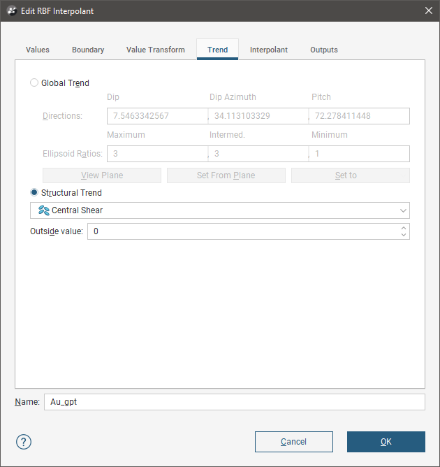

Using a Structural Trend

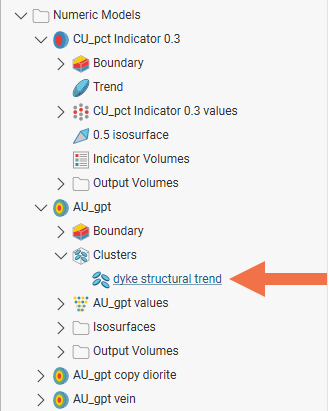

You can also set the trend for an RBF interpolant from a structural trend. First, you must create or import the required mesh and create a structural trend. See Building a Structural Trend for more information.
Once the structural trend has been created, add it to the interpolant by double-clicking on the interpolant in the project tree, then clicking on the Trend tab. Select the Structural Trend option, then select the required trend from the list:
Outside value represents a baseline value, the expected ambient value of the surrounding region. The Outside value is factored into the interpolation algorithm and lowers the interpolated value in the areas away from the known data points. The blending with outside value is very steep. To increase the projection area outside of the area with data the Outside value can be increased to a value just below the cut-off value.
Click OK. The trend will be added to the interpolant and will appear as part of the interpolant, as shown:
When you apply a structural trend, you cannot use the Linear interpolant. See Interpolant Functions for more information.
Once a structural trend has been defined for the interpolant, you can edit it by clicking on the trend hyperlink in the project tree, then opening the structural trend applied to the interpolant. The Structural Trend window will appear. See Building a Structural Trend for more information on the settings in this screen.
The structural trend information included as part of the interpolant is a link to the original structural trend. When you change the structural trend that is part of the interpolant, the changes are also made for the original structural trend.
When a structural trend is used of either Strongest along meshes or Blending types, the interpolant will regress to the global mean trend away from the meshes. The global trend that will be used is set in the Global Trend tab for the structural trend.

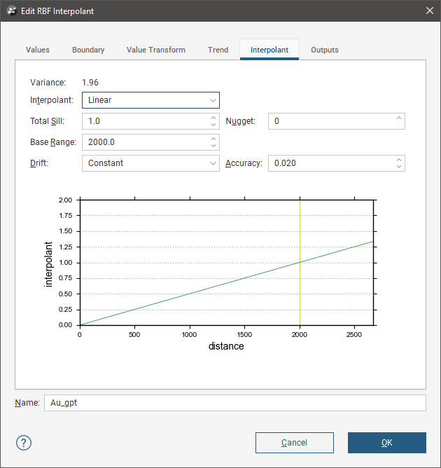

To adjust interpolation parameters for an RBF interpolant, double-click on the interpolant in the project tree, then click on the Interpolant tab:

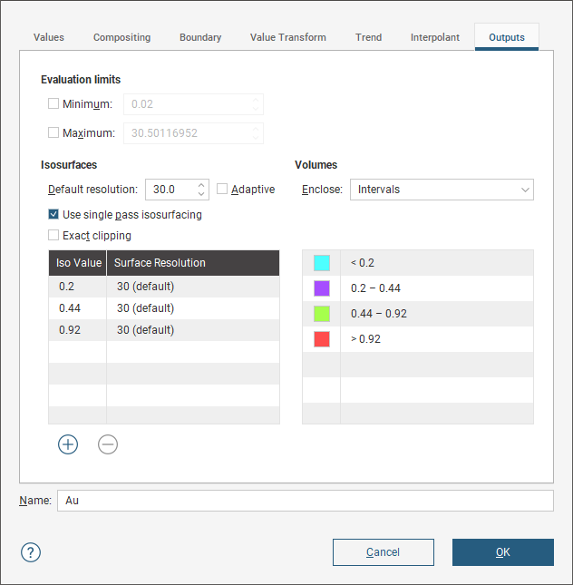

Output Settings for an RBF Interpolant
You can change the parameters used to generate RBF interpolant outputs by double-clicking on the interpolant, then clicking on the Outputs tab.
The Evaluation limits apply when interpolants are evaluated against other objects in the project. When the limits are enabled, all values outside the limits will be set to the Minimum and Maximum.
To add a new isosurface, click the Add button and enter the required value. To delete an isosurface, click on it in the list, then click the Remove button. You can also change the colours used to display the isosurfaces by clicking on the colour chips.
If you find that grade shells are overlapping, the resolution may be too coarse. Set Default resolution to a lower value or enable adaptive resolution in the Outputs tab. See Surface Resolution in Leapfrog Works.
