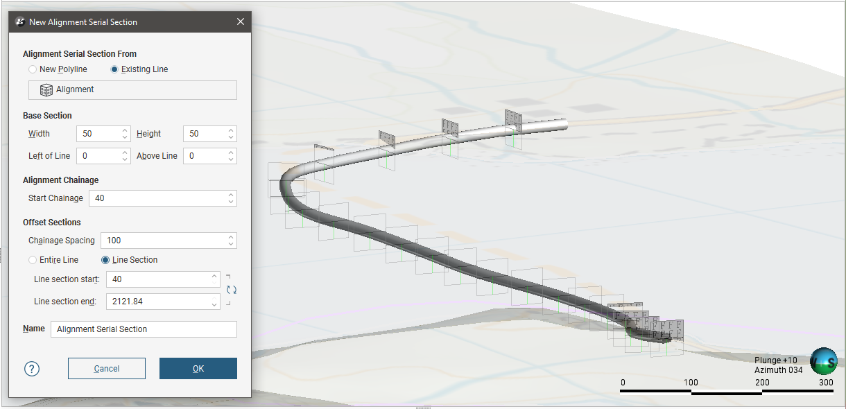

If you select an existing line, planes representing the base section and the offset sections will be added to the scene:

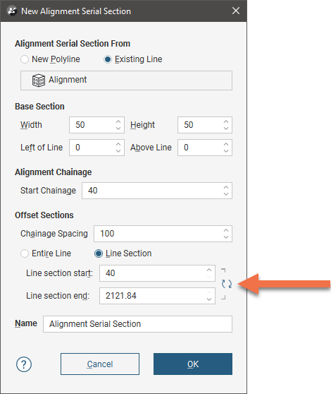

The Base Section parameters determine the size of the sections using the Width and Height values, and the Left of Line and Above Line settings offset the centre of the section from the line.
Start Chainage defines the measurement for the start of the reference line. If that is considered the zero point, use 0. If another point is the origin for the line, you might wish to set the Start Chainage value for the section as being the offset distance to that origin point. The Line Section Start and Line Section End points make use of this Start Chainage value.
The Offset Sections parameters determine how the sections are distributed along the selected line. Generate sections along only part of the line by selecting Line Section, then changing the Line Section Start and Line Section End.
Swap the start and end points of the selected line by clicking the button (
) alongside the start and end settings:

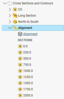

Click OK to create the section. In the project tree, the alignment serial section includes the individual offset sections and the line used to create it:

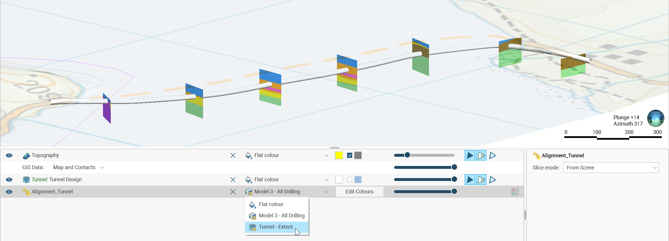

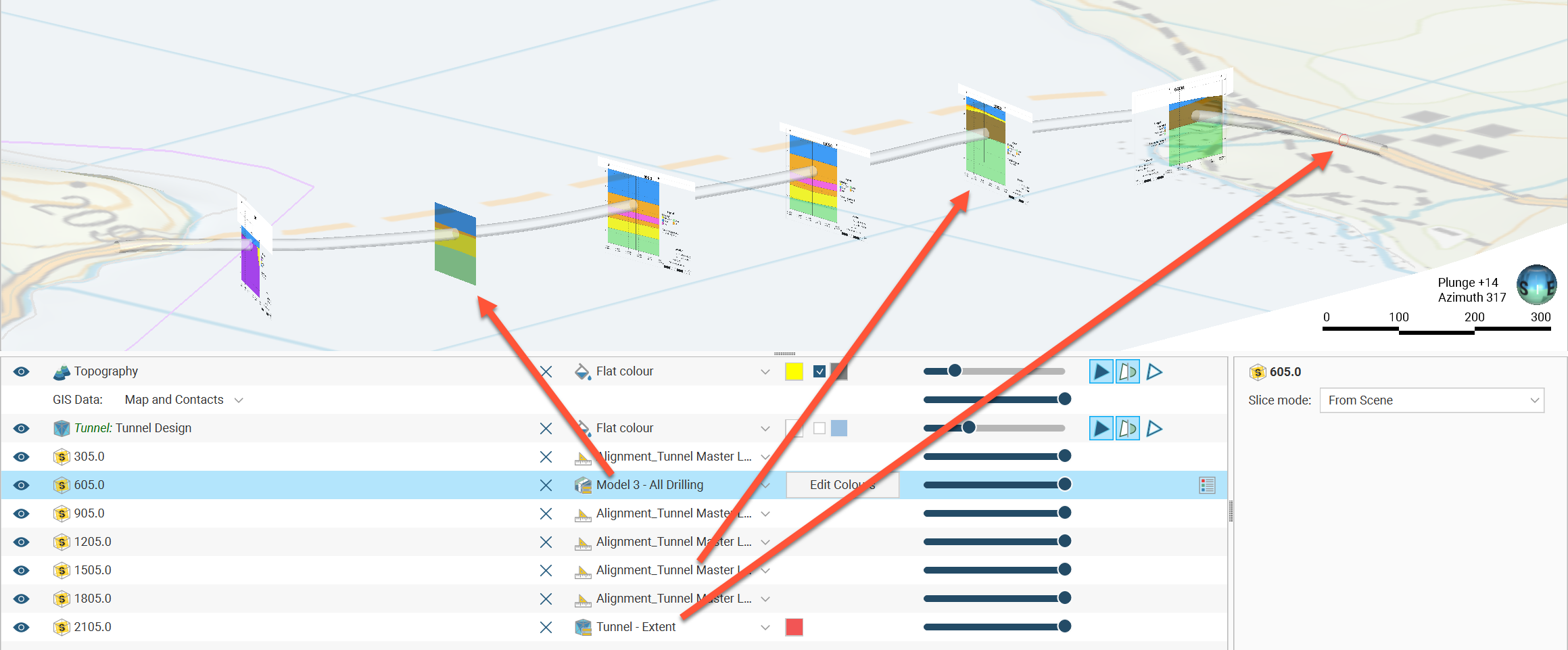

Adding the top-level alignment serial section to the scene will display the section evaluation areas, with the specific evaluations being selectable from the view list. This object cannot be displayed in the scene using the section layouts.
You can, however, add individual offset sections to the scene from the project tree. By default the section layout will be displayed in the scene, but you can also select specific evaluations from the view list.
