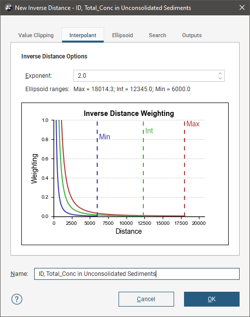

Inverse Distance Estimators
Leapfrog Works extends the basic inverse distance function with the option for anisotropic distance.
In the Interpolant tab:
  • Exponent adjusts the strength of the weighting as distance increases. A higher exponent will result in a weaker weight for the same distance.
  • Ellipsoid Ranges identify the Max, Int and Min ranges set in the Ellipsoid tab.
  • A chart depicts the resultant weights that will be applied by distance.

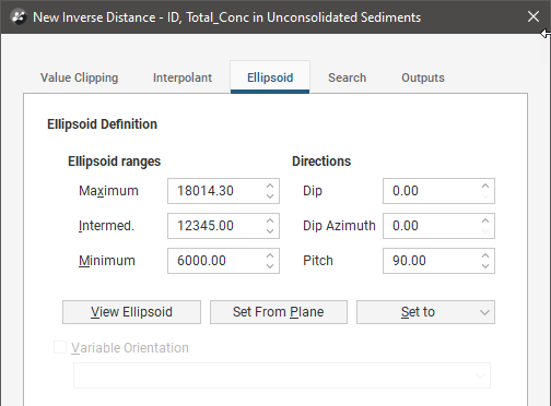

In the Ellipsoid tab:
  • The Ellipsoid Definition sets the anisotropic distance and direction, scaling distances in three orthogonal directions proportionally to the range for each of the directions of the ellipsoid axes. This effectively makes the points in the direction of greater anisotropy appear closer and increases their weighting. Adjust the Ellipsoid Ranges and Directions to describe the anisotropic trend.
  • Click View Ellipsoid to see an ellipsoid widget in the scene that helps to visualise the anisotropic trend.

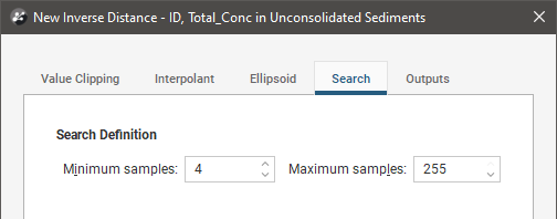

In the Search tab The Minimum Samples and Maximum Samples parameters determine the number of samples required or used within the search neighbourhood.

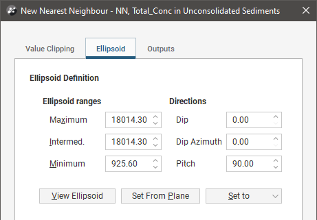

Nearest Neighbour uses an astral search algorithm to determine what point is considered the nearest. Leapfrog Works includes support for anisotropy when determining what is considered the ‘nearest’ value. Adjust the Ellipsoid Ranges and Directions to describe the anisotropic trend.

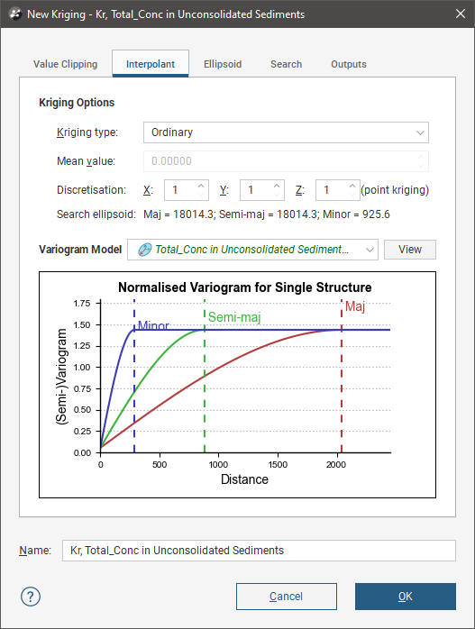

  • Both Ordinary and Simple Kriging are supported.
  • For Simple Kriging, specify a Mean value for the local mean to use in the Kriging function.
  • Discretisation sets the number of discretisation points in the X, Y and Z directions for block Kriging. Block Kriging provides a means of estimating the best value for a block instead of only at the centre of the block. Each block is broken down (discretised) into a number of sub-units without actually sub-blocking the blocks. A geologist will consider a variety of factors including spatial continuity when deciding on the discretisation to use. Set the X, Y and Z parameters to 1 for point Kriging. To use additional discretisations, copy the estimator and change the Discretisation parameters.
  • Search Ellipsoid identifies the Max, Int and Min ranges set in the Ellipsoid tab.
  • Select from the Variogram Model list of models defined in the Spatial Models folder.
  • The View button will show an ellipsoid widget in the scene to assist in visualising the variogram model ranges and direction.
  • A chart depicts colour-coded semi-variograms for the variogram model.

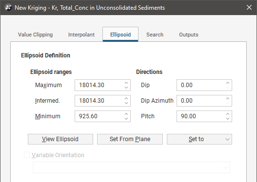

  • The Ellipsoid Definition sets the Ellipsoid Ranges and Direction.
  • Click the View Ellipsoid definition to show an ellipsoid widget in the scene to assist in visualising the search ellipsoid. Note that this is not the same as the variogram model ellipsoid, unless the Set to option is used to select the variogram model to copy the details.

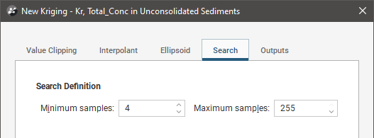

In the Search tab the Minimum Samples and Maximum Samples parameters determine the number of samples required or used within the search neighbourhood.

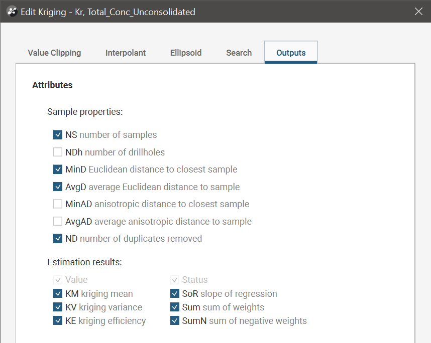

Kriging Attributes
  • The number of samples (NS) is the number of samples in the search space neighbourhood.
  • The number of boreholes (NDh) is the number of boreholes used to inform the estimation, which together with number of samples can be utilised to determine if blocks are well informed or poorly informed.
  • The Euclidean distance to the closest sample (MinD) is a cartesian (isotropic) distance rather than the ellipsoid distance.
  • The average Euclidean distance to sample (AvgD) is the average distance using cartesian (isotropic) distances rather than ellipsoid distances.
  • The anisotropic distance to the closest sample (MinAD) is the anisotropic distance used when making sample selection.
  • The average anisotropic distance to sample (AvgAD) is the average anisotropic distance used when making sample selection.
  • The number of duplicates deleted (ND) indicates how many duplicate sample values were detected and deleted by the estimator.
For more information on the difference between anisotropic and Euclidean distances, see Understanding Anisotropic/Ellipsoidal Distance in the Trends and Anisotropy topic.

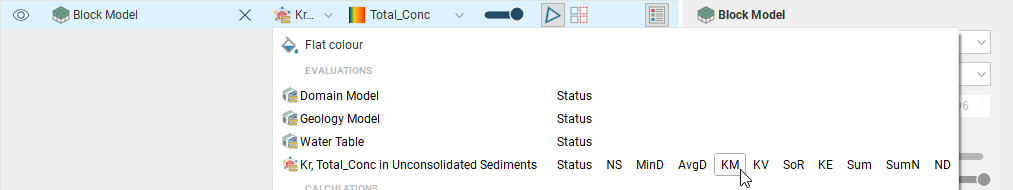

  • Value will always be included as it is the actual estimate result.
  • Status will always be included as it classifies the estimation result as a Normal result, or non-normal Blank, Without-value, Outside or Error result.
  • The Kriging mean (KM) is the local mean used for the estimate based around the selected sample data. For simple Kriging, this is the specified global mean. For ordinary Kriging, it is the unknown locally constant mean that is assumed when forming the Kriging equations. This value is only dependent on the covariance function and the sample locations and values for the chosen neighbourhood. It does not depend on the evaluation volume and therefore will be the same for block Kriging and point Kriging. It can give some indication of suitability of the assumptions when doing ordinary Kriging.
  • The Kriging variance (KV) is important in assessing the quality of an estimate. It grows when the covariance between the samples and the point to estimate decreases. This means that when the samples are further away from the evaluation point, the quality of the estimation decreases. For simple Kriging, the value is capped by the value of the covariance between the target volume and itself. For ordinary Kriging, higher values indicate a poor value. The Kriging variance calculation depends on whether the Variogram Model has Sill or Norm. Sill selected. Having KV based on the normalised data when Norm. Sill is selected means that KV is comparable between domains using normalised variogram models.
Prior to version 2021.1, KV was always calculated based on the raw data variogram sills.
  • The Kriging efficiency (KE) is calculated based on the block variance and Kriging variance (KV). It should be 1 when the Kriging variance is at is minimum and 0 when the Kriging variance equals the block variance.
  • The slope of regression (SoR) is the slope of a linear regression of the actual value, knowing the estimated value. For simple Kriging it is 1 and for ordinary Kriging a value of 1 is desired as it indicates that the resulting estimate is conditionally unbiased. Conditional bias is to be avoided as it increases the chance that blocks will be misclassified when considering a cutoff value.
  • The sum of weights (Sum) is the sum of the Kriging weights. For ordinary Kriging, the sum is constrained to being equal to 1.
  • The sum of negative weights (SumN) can be used to assess the quality of an estimation. Negative weights are to be avoided or at least minimised. If there are negative weights, it is possible that the estimated value may be outside the range of the sample values. If the sum of negative weights is significantly large (when compared to the total sum), then it could result in a poorly estimated value, depending on the sample values.

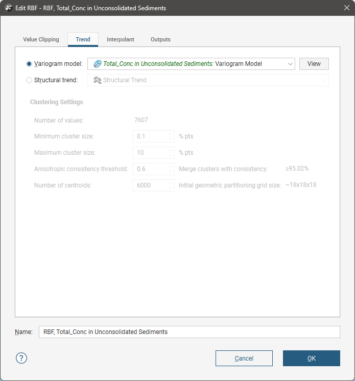

RBF Estimators

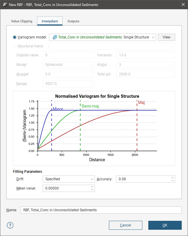

The RBF estimator brings the Radial Basis Function used elsewhere in Leapfrog into estimation. Like Kriging, RBF does not use an overly-simplified method for estimating unknown points, but produces a function that models the known data and can provide an estimate for any unknown point. Where Kriging is limited to a local search neighbourhood, RBF utilises a global neighbourhood. An RBF estimator is good for grade control where there is a large amount of data.
To create an RBF estimator, right-click on the Estimators folder and select New RBF Estimator. The New RBF window will open on the Trend tab:
Alternatively, in a feature unique to RBF estimators, a Structural trend can be used, if one is available in the project. See Using a Structural Trend in the RBF Interpolants topic.
In the Interpolant tab, the Outside value provides a place to specify what value to use outside the estimation domain. What value you choose to use here will depend on the specifics of your model’s context. You may choose to set the Outside value at the long-range mean value of the data, such as using the mean from the statistics view; right-click on the numeric data object and select Statistics to find this value. Alternatively, the modelling context may call for Outside value to be set at the expected background value.

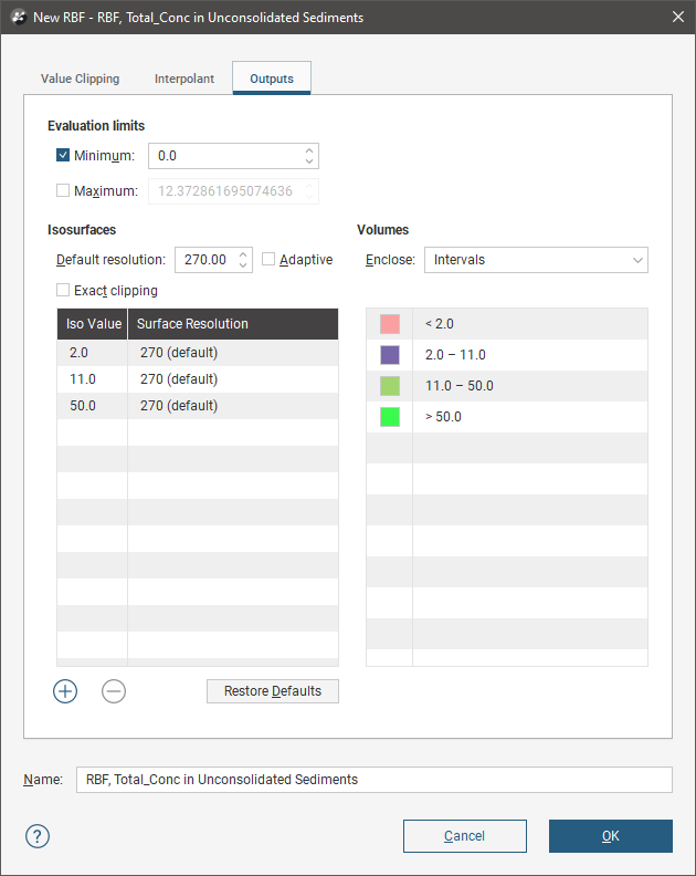

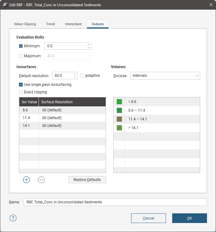

In the Outputs tab, the Minimum and MaximumEvaluation Limits constrain the values. Values outside the limits are set to either the minimum or maximum limit, as appropriate. To enable a limit, tick the checkbox and set a limit value.
  • The Default resolution will be used for all isosurfaces, unless you change the Surface Resolution setting for an individual isosurface. See Surface Resolution in Leapfrog Works for more information on the Adaptive setting. The resolution can be changed once the estimator has been created, so setting a value in the New RBF window is not vital. A lower value will produce more detail, but calculations will take longer.
  • The Volumes enclose option determines whether the volumes enclose Higher Values, Lower Values or Intervals. Again, this option can be changed once the estimator has been created.
  • Click the Restore Defaults button to add a set of isosurfaces based on the estimator’s input data.
  • Use the Add () to add a new isosurface, then set its Iso Value.
  • Click on a surface and then on the Remove () button to delete any surface you do not wish to generate.
