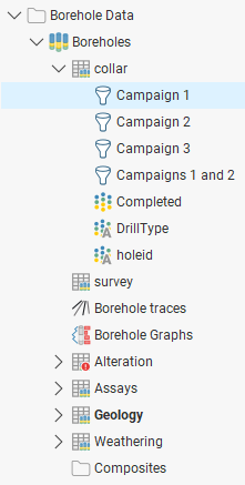

To create a query filter for a data table, right-click on the table in the project tree and select New Query Filter. The New Query Filter window will appear and you can choose which way you prefer to build your query. Assign the filter a name and click OK to save it. It will appear in the project tree under the table to which it applies:
Query filters defined for collar tables are available to all other drilling data tables.

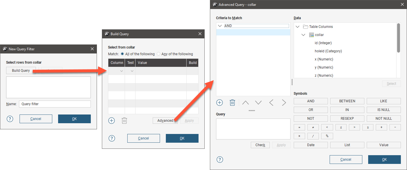

There are three windows that make up the standard query builder:
In the first window, the New Query Filter window, you can type in a query using the query syntax described in Leapfrog Works Query Syntax. Press Ctrl-Enter for a new line in longer queries.
The second window, the Build Query window helps you build some common queries by selecting from the data columns in the table and defining different tests. Open this window by clicking the Build Query button in the New Query Filter window. See The Build Query Window for more information on building queries in this way.
The third window, the Advanced Query window, shows all the data columns and possible operations. See The Advanced Query Builder for more information.

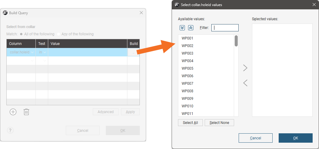

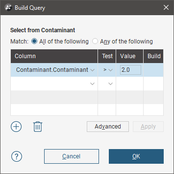

To add a criteria, click Column to view a list of columns available in the table. Select a Test and enter a Value. What can be entered for the Value depends on the type of column and test selected.
Quotes are not required around text values entered in the value column as they are in SQL. Leapfrog Works will add quotes and brackets to the value "MX, PM" to make a valid SQL list of strings "('MX', 'PM')" when the query is saved.
Once Column and Test have been entered, if the Column is an enumerated list of values, a button is enabled in the Build column to assist in selecting the Value. When clicked, the Select column values window opens, allowing the desired values to be selected from the list of available options.

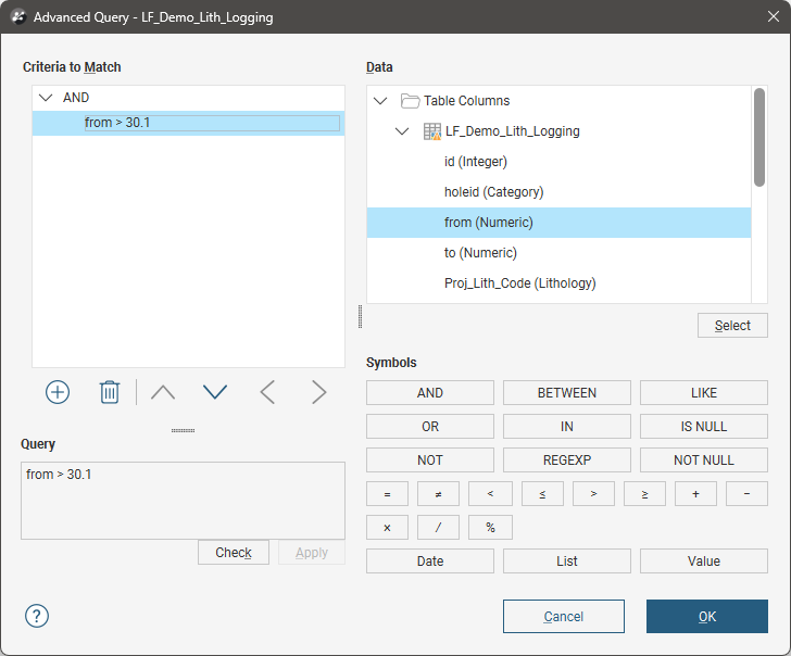

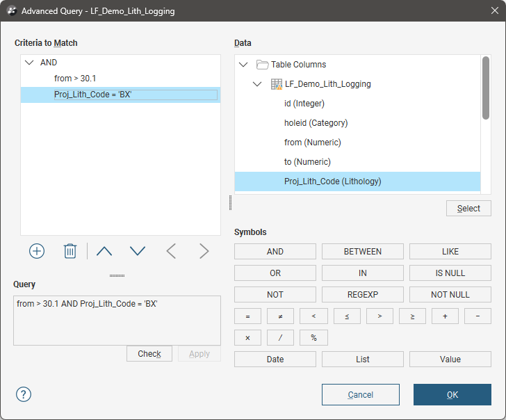

Numeric values you enter into the query do not need to be enclosed in quotes, but text being used as a query token needs to be wrapped in single quotes. In this example, a test that the lith code column matches BX has been included, so ‘BX’ is used in the query. Because the top level branch node is an AND, the whole query is checking for a from depth exceeding 30.1 AND a lith code of BX:

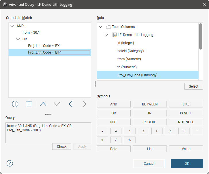

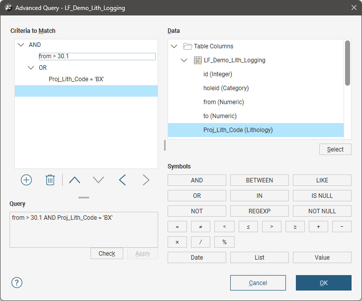

If you want to add another logical layer to the tree, say for instance you want to check for both BX and BIF lith entries in the table, you can select a row and push it down a level, then click the AND or OR operator button. In the illustrated example, the Proj_Lith_Code = ‘BX’ line was selected, then OR clicked. A newly created leaf is selected in the criteria tree, ready for construction of the next test:
Here the test for the BIF code has been added:

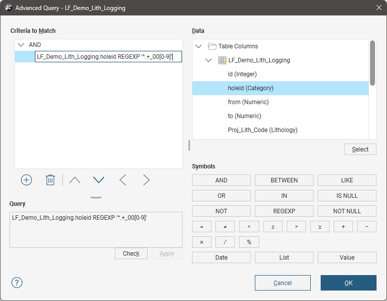

The REGEXP button allows regular expression pattern-matching. To use regular expressions:
  1. In an empty row, click a column name in the Data tree.
  2. Click the REGEXP button.
  3. Click at the end of the criterion row being edited to de-select the current content and to position the cursor at the end of the entry.
  4. Enter a regular expression wrapped in single quotes.
Here the regular expression ^.+_00[0-9] has been used to look for any holeid that includes _00 within the string and ends in another number:
Standard regex syntax is used. You may find regex construction tools such as regex101.com of assistance in creating suitable regular expressions for your queries.
