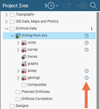

When an object imported from Evo is updated in Evo, a status indicator will appear in the Leapfrog Works project tree alongside the object that has changed. For example, here a drilling dataset is out-of date:

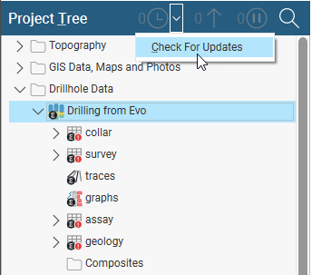

You can also check for updates by clicking the button at the top of the project tree and selecting Check For Updates:

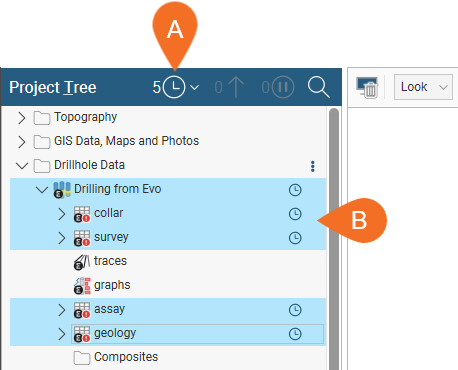

Once the check is complete, the number of objects that are available for update is indicated in the project tree title bar (A). Click on the button to select all of the out-of-date objects in the project tree (B):

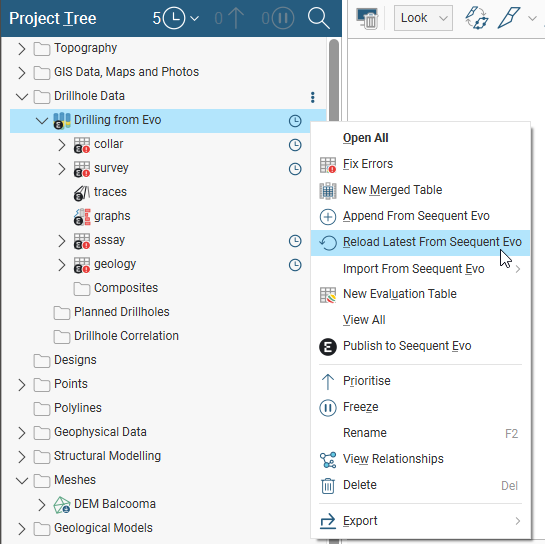

To refresh a single out-of-date object, right-click on it in the project tree and choose Reload Latest From Seequent Evo:

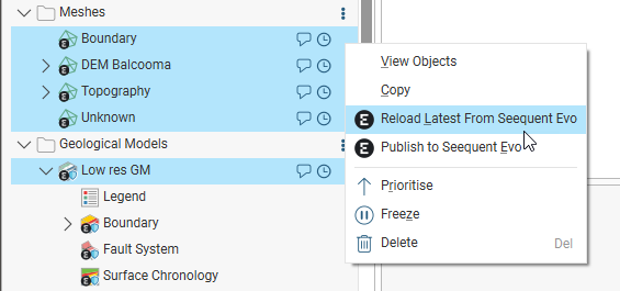

To refresh multiple objects at once, select them in the project tree. Then, right-click on them and choose the Reload Latest From Seequent Evo option:
