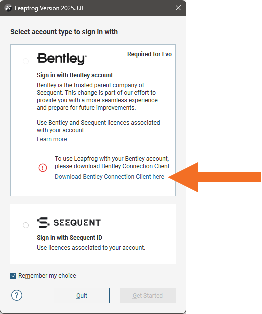

If you have installed Leapfrog Works on a computer that has not run Leapfrog Works before, you may be prompted to enter your email address and then choose the type of licence you will be signing in with. If you are prompted to do this:
  • Enter the email address to which your Leapfrog Works licence has been assigned, then click Get Started.
  • Choose the type of licence you will be signing in with, a Bentley account licence or a Seequent ID licence. If you will always be signing in with that licence type, enable Remember my choice.

Signing in to Leapfrog Works with a Bentley account uses the Bentley Connection Client. If you do not already have this installed when you launch Leapfrog Works, a message will be displayed that includes a link for downloading the Connection Client:
Once the Connection Client is installed, you will be able to sign in to Leapfrog Works using your Bentley account.

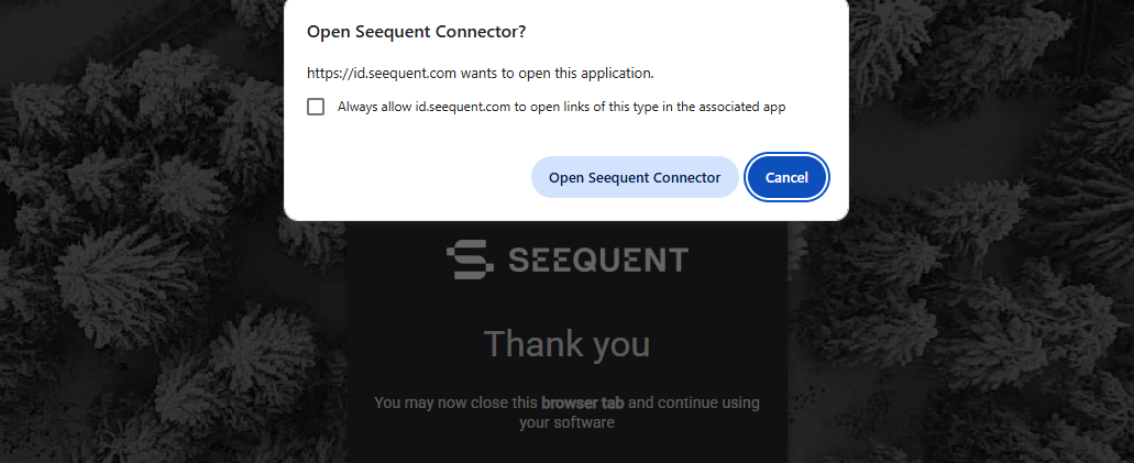

When you sign in to Leapfrog Works using a Bentley account, Seequent Connector will still be used to manage your connection to some Seequent services. Seequent Connector will use your Bentley account credentials, but your browser may prompt you to allow Seequent Connector to run.
We recommend ticking the box to always allow id.seequent.com to open links.

When you launch Leapfrog Works and sign in using a Seequent ID, a window will launch in your computer’s default browser prompting you to enter your Leapfrog Works credentials. Follow the prompts and once you have signed in, you will be prompted to launch Seequent Connector.
