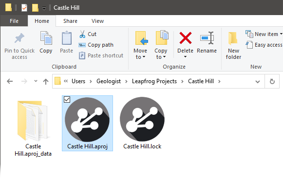

In both cases, the project files use the extension .aproj:
A project also has a project folder that contains information used by the project. This is named using the project name and the suffix .aproj_data.
Do not change the name of your .aproj_data folder or alter its contents. Doing so could render your project file unusable.
A .lock file is created when a project is opened. The .lock file protects the project from being moved while the project is open and from being opened by another instance of Leapfrog Works, which can happen when projects are saved on shared network drives.

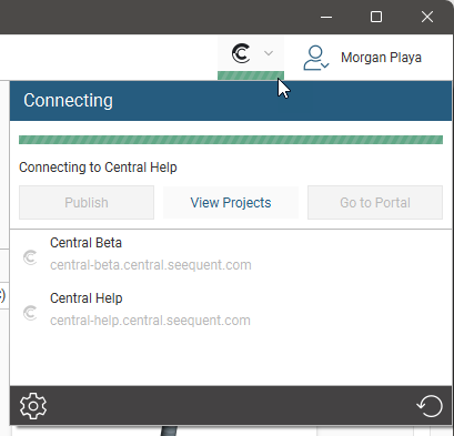

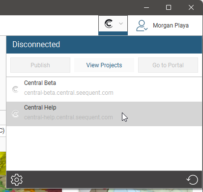

The Central servers you have access to via your Seequent ID are shown in the Central dropdown menu:
If a server you expect to see does not appear in the list, click the refresh button (

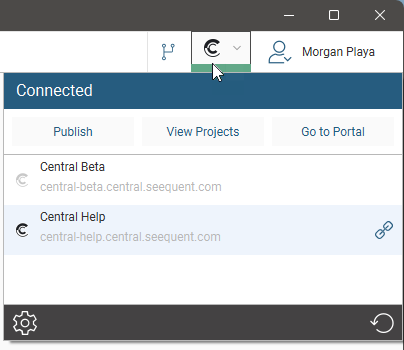

The stripe under the Central menu shows your connection status. For example, the blue stripe above indicates Leapfrog Works is not connected to a Central server. Here the stripe is green, indicating that Leapfrog Works is connected to a Central server. Clicking on the menu displays more information, including an option to disconnect from the server (
The stripe will be red when there is a connection error. Click on the menu to view more information.
The stripe will be orange if you are connected to a Central server as part of a trial programme.
More information is shown in the Central dropdown when Leapfrog Works is connecting to a server or publishing an update to the server. In this example, Leapfrog Works is in the process of connecting to a server:

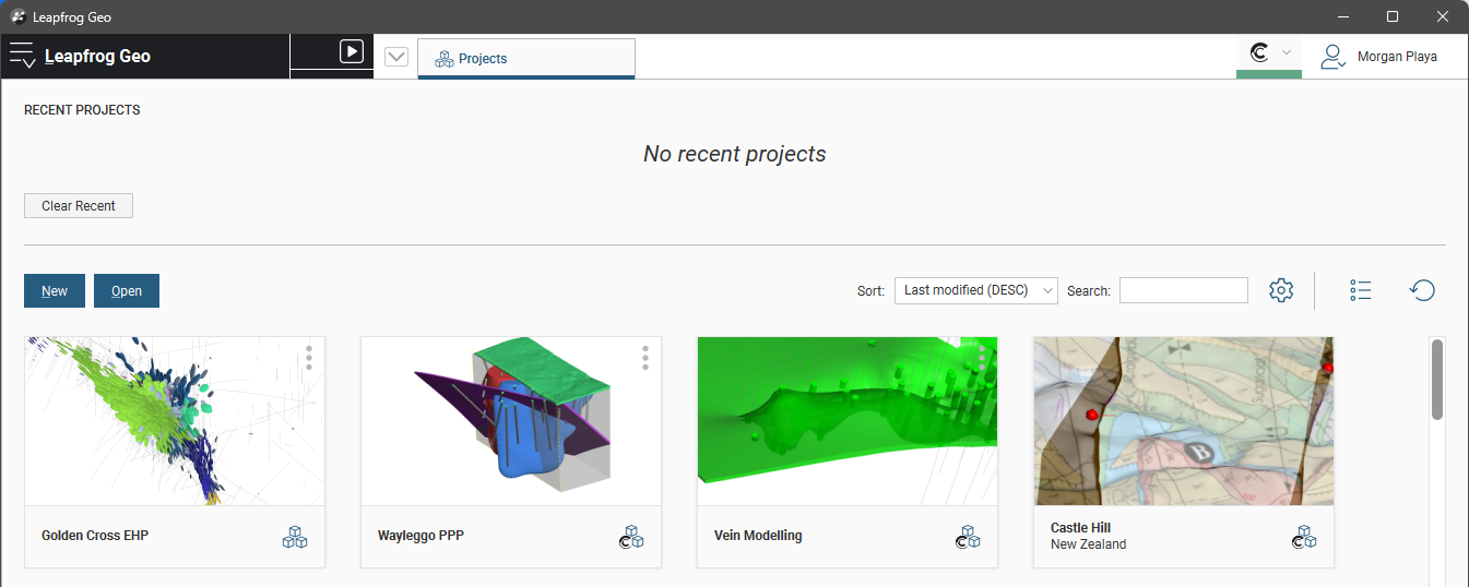

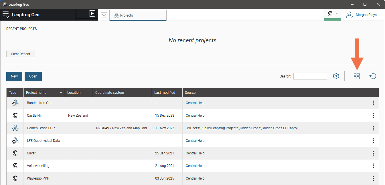

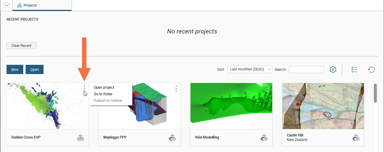

When you first start Leapfrog Works, the Projects tab lists all projects you have access to without connecting to a Central server. Here Morgan Playa has access to a local project (
) and local copies of three Central projects (
You can view the list of projects as thumbnails, as shown above, or as a list. The list view shows more information about each project, such as the coordinate system the project uses, if one has been assigned, the date the project was last modified, the file location for local projects and the Central server for local copies of Central projects.

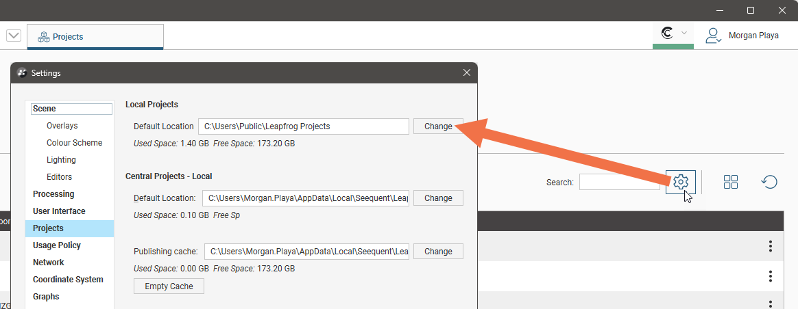

The folder the Projects tab searches for local projects can be changed by clicking on the Settings button:
In both the thumbnail and the list views, click on the overflow menu (
) for more project-related options:

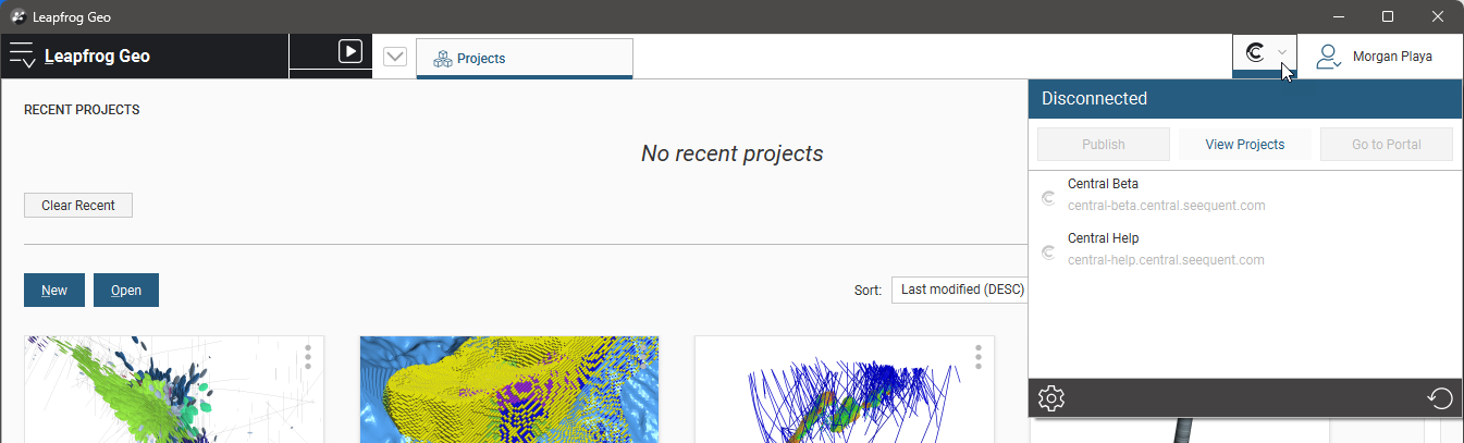

Connect to a Central server by clicking on the server button and selecting from those in the list:
Once connected, the list will be updated to show the Central projects available on that server, along with local projects. Use the Search box to filter the list of projects.

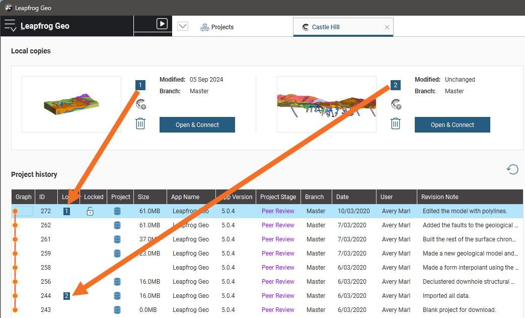

As with the local copies of the Central projects, clicking on the Central project will open its history.
A Central project is the history of a Leapfrog Works project tracked through time, organised into revisions. In Leapfrog Works, you can view the history of a Central project, and you can download local copies of these revisions and work on them in Leapfrog Works. Here, the history of a Central project called “Castle Hill” is shown, and there are two local copies of that project, one that was modified on the 5th of September 2024 and one that has not been modified since it was downloaded (Unchanged):
Click on a thumbnail to open a project, which will automatically connect you to the project’s Central server.

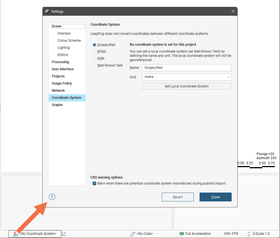

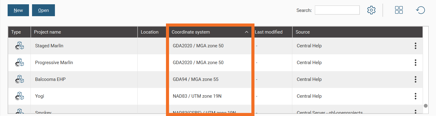

Recording a Coordinate System
Leapfrog Works is unit-less and adopts the units used in the data you import. For example, if your imported data is in metres, the units displayed will be metres, and figures such as resolution, measured distances and slicer thickness will be in metres. It is important, therefore, to be consistent in the units used in the data you import. If you are importing data that uses different coordinate systems, you will need to pre-process the data so that it is using the same coordinate system.

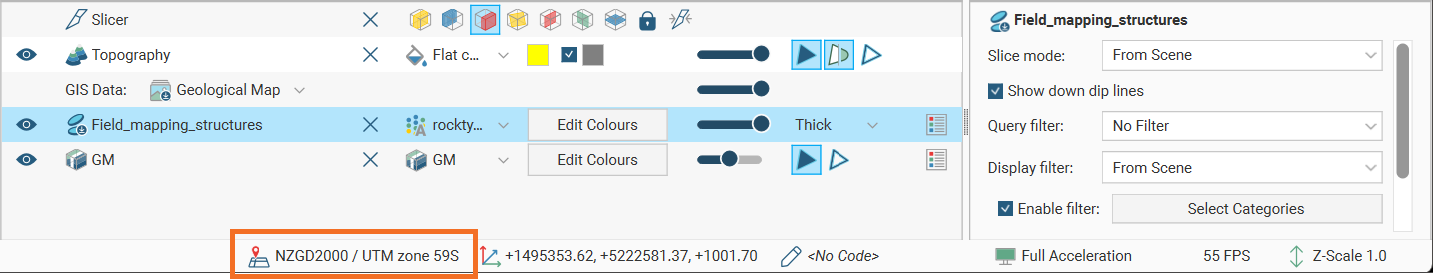

In order to communicate to the wider team, you can record in each Leapfrog Works project the coordinate system that should be used, which will then be displayed at the bottom of the Leapfrog Works window:
The Coordinate System setting is primarily an informational field. The project coordinate system should be set when the project is created and all the data imported into Leapfrog Works should use the coordinate system that has been decided on for the project. Leapfrog Works will not convert any data that is imported with references using a different coordinate system into the project coordinate system, nor does changing the project coordinate system perform a conversion of the data within Leapfrog Works from the previous coordinate system to the new coordinate system.
The Projects tab will show the project coordinate system metadata setting in the Coordinate system column when the projects are displayed in the List view:
To record and display the coordinate system team members should be using in a project, click on the button at the bottom of the Leapfrog Works window:
The Settings window will open with the Coordinate System tab displayed.
See Coordinate System Settings for information about the settings in this tab.

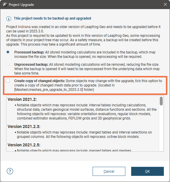

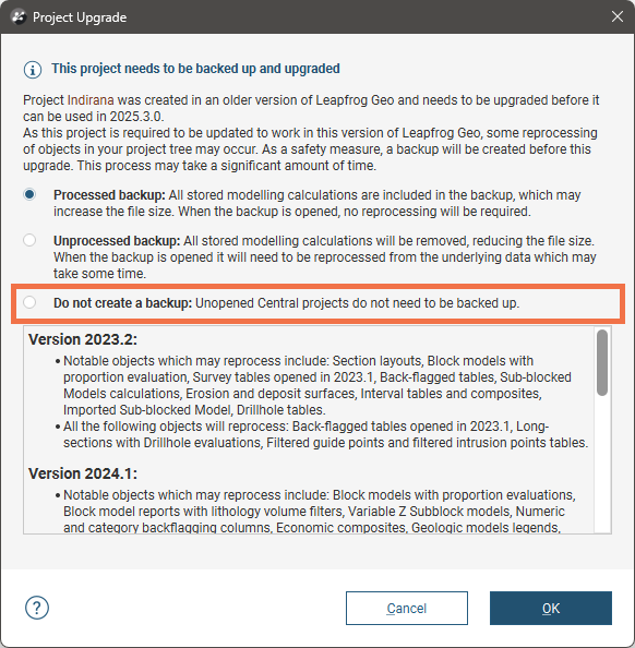

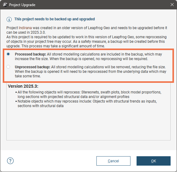

When you open a project that was last saved in an earlier version of Leapfrog Works, you will be prompted to upgrade the project and a list of affected objects will be displayed. As part of this process, you will also be prompted to create a backup:
Backing up before upgrade is compulsory for local projects and local copies of Central projects; you cannot open the project without first creating the backup. You can choose between a processed or an unprocessed backup:
- A Processed backup includes all stored modelling calculations. This can result in large file sizes, but when the backup is opened, no reprocessing will be required.
- An Unprocessed backup removes all stored modelling calculations. This can reduce the size of the backup, but if the backup is needed, all of the modelling calculations will need to be reprocessed from the underlying data.
The tradeoff is that when an unprocessed backup is selected, the backup can be completed quickly and the resulting file size will be smaller, but when the backup is needed, reprocessing might take some time, especially with large, complex projects.
Select the option required, then click OK. You will be prompted to select where the backup should be saved. Once the backup is complete, the project will be opened and upgraded.
If the project has been downloaded from Central and has not been changed, there will be a third option, to upgrade the project without creating a backup:
If the project being upgraded contains objects that could change as the result of the upgrade, there will also be a Create copy of changed objects option in the Project Upgrade window:
This option is described further in Changed Objects Warning below.

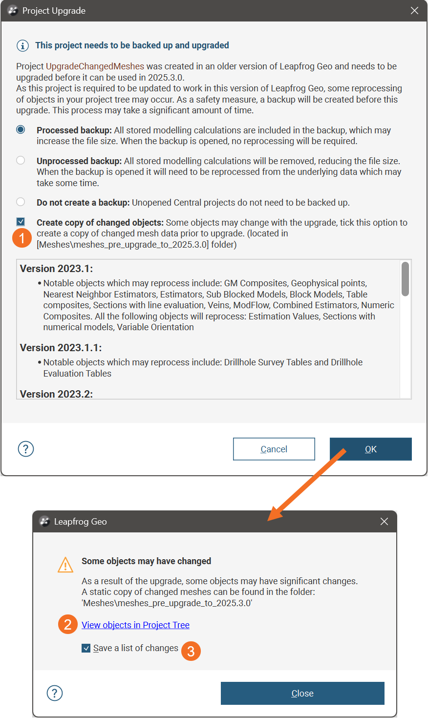

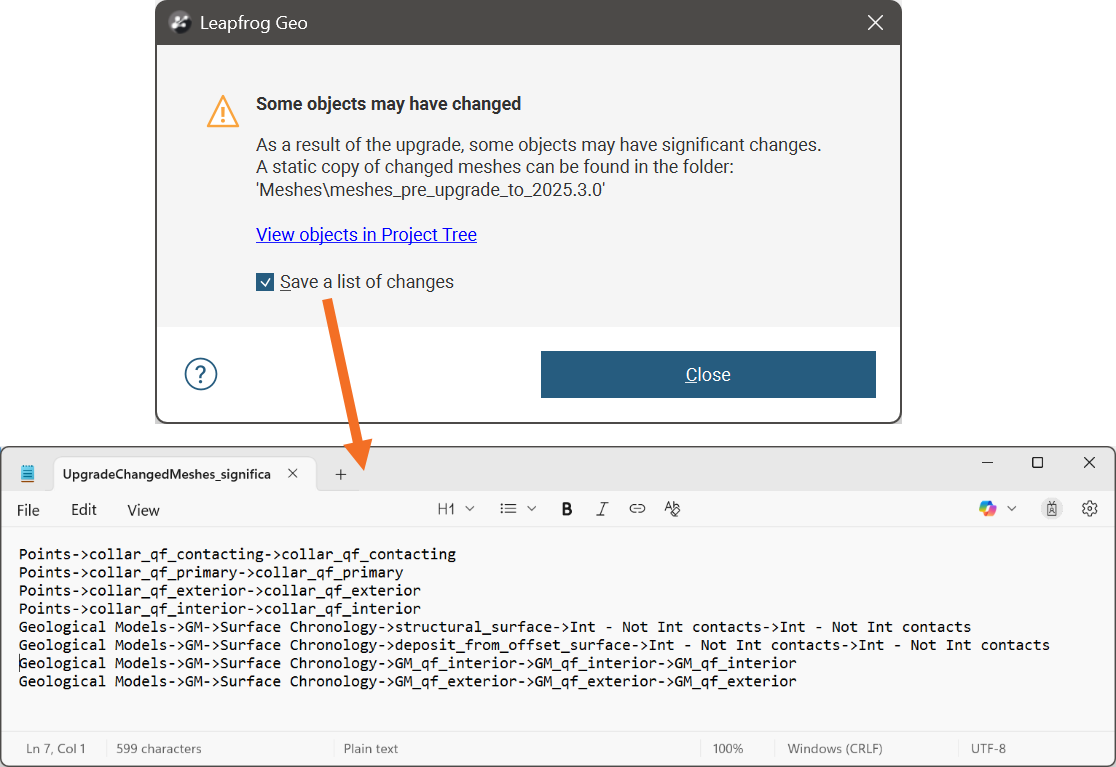

Upgrades can sometimes result in changes to objects. If a project you are upgrading contains objects that may change as a result of the upgrade, there is a Create copy of changed objects option in the Project Upgrade window:
Save a copy of changed surfaces in the Meshes folder. This prompt is shown in the Project Upgrade window. |
After you click OK in the Project Upgrade window, a warning window will provide a link to highlight the changed objects in the project tree. Once the project has been upgraded and opened, this link will highlight all changed objects in the project tree. |
You will also be able to save a text file with a list of changed objects. |
If the Save a list of changes option is ticked, you will be prompted for a location to save the file. Opening the file will reveal a list of objects that were affected by the upgrade process:
Each of the highlighted project tree objects will have a corresponding entry in the text file of changes.

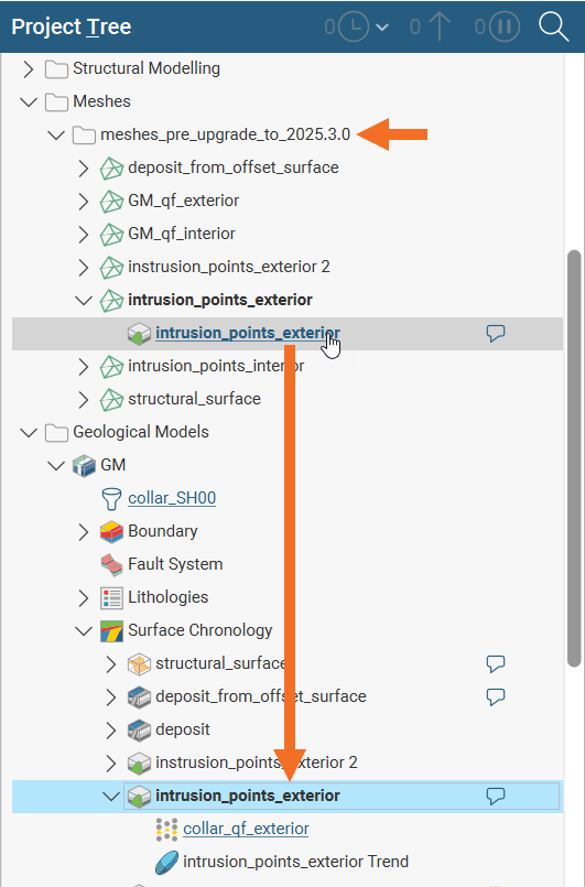

If you enable the Create copy of changed objects option in the Project Upgrade window, a folder will be created in the Meshes folder containing non-editable meshes that are copies of the pre-upgrade surfaces that were affected.
Each of these mesh copies has a link to the object that has been upgraded. Click the link to locate the affected object. For example, here the pre-upgrade mesh (
) in the Meshes folder is linked to the upgraded surface that is part of a geological model (

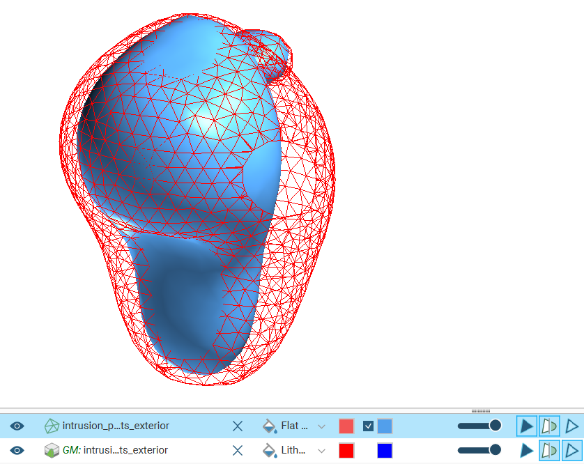

The text file and any pre-upgrade meshes can be used in investigating changes to surfaces. For example, here we can see that the non-editable copy of the pre-upgrade mesh (
) (shown in blue) does not match the upgraded geological model surface (
) (shown in triangles):

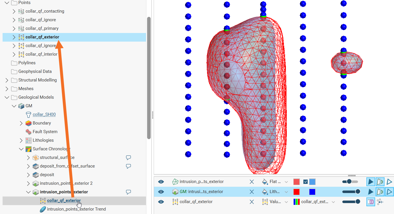

Expanding the geological model intrusion, we see a link to a points object, which was one of the upgraded objects that was flagged. We can add that points object to the scene and inspect the points used to created the surface to investigate the nature of the change and make project decisions about how we want to proceed.
Some objects, such as intrusions built from drilling data instead of points, will not have a hyperlink to the object modified in the upgrade process. However you can still locate the object using the name. If a text file was saved to list the affected objects, it can assist in locating the relevant object.

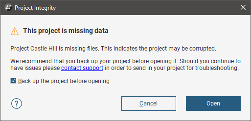

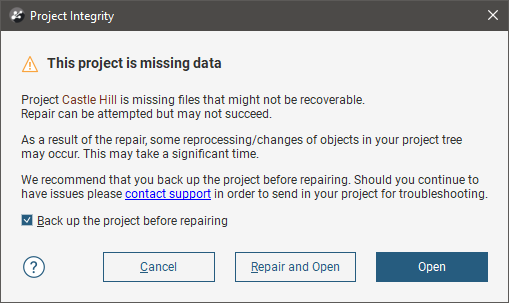

When a project is opened, Leapfrog Works checks the integrity of the project, looking for missing data. In some cases, Leapfrog Works can try to open the project and you may be able to continue working in it.
In other cases, Leapfrog Works can attempt to generate the missing files from data in the project, in which case you will be asked whether or not you wish to repair the project.
Whatever the case, read the information in the dialog and decide whether you wish Leapfrog Works to open the project or attempt a repair.
It is strongly recommended that you allow Leapfrog Works to back up a project that has files missing before attempting to open or repair it.
This message may be displayed if:
- You have copied a project to a different folder and the copying process is not yet complete
- You are unzipping a project and the process is not yet complete.
If this is the case, click Cancel and try opening the project again once the copying/unzipping is complete.

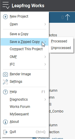

You can also save a copy of a project, save a zipped copy of a project and compress a project. These options are available from the Leapfrog Works menu:
- Save A Copy. This option is only available for local projects. Save a backup copy of your project to a location on your hard drive. You will be prompted to choose a new name and location for the saved project. Click OK to create the new project file. Leapfrog Works will save a copy of the project in the location selected. Once the backup copy is saved, you can open and use it from the Projects tab. Otherwise, you can keep working in the original copy of the project.
- Save A Zipped Copy > Processed. Saves a zipped copy of a project that includes all stored modelling calculations. This can result in large file sizes, but when the backup is opened, no reprocessing will be required. You will be prompted to choose a name and location for the zipped project. Click Save to create the zip file.
- Save A Zipped Copy > Unprocessed. Saves a zipped copy of a project without stored modelling calculations. This can reduce the size of the backup, but if the backup is needed, all of the modelling calculations will need to be reprocessed from the underlying data. You will be prompted to choose a name and location for the zipped project. Click Save to create the zip file.
- Compact This Project. When you delete objects from a project file, Leapfrog Works retains those objects but notes that they are no longer used. Over time, the project file will grow in size and data stored in the database may become fragmented. Compacting a project removes these unused objects and any unused space from the database. When you compact a project, Leapfrog Works will close the project and back it up before compacting it. Depending on the size of the project, compacting it may take several minutes. Leapfrog Works will then reopen the project. When you select this option, you will be asked to confirm your choice.

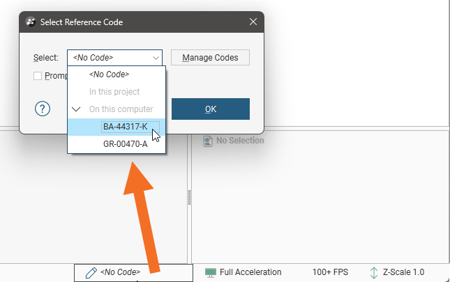

To enter a code, click the button in the status bar on the bottom edge of the Leapfrog Works main window:
Select from the codes defined and click OK. The code entered will be displayed in the status bar:
To define new reference codes or delete old ones, click on the Manage Codes button. See Usage Policy Settings.
To work without a code, click on the button, select <No Code>, then click OK. Note that whether it’s possible to use Leapfrog Works without first entering a reference code depends on a setting in the Settings > Usage Policy window.

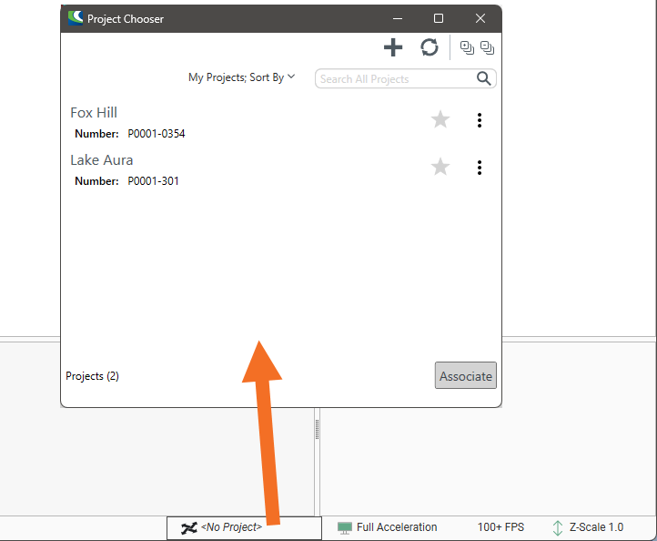

Associating Projects (Signed in via a Bentley Account)
If you are using Leapfrog Works with a Bentley account, you can associate a Leapfrog Works project with a ProjectWise project. There are two ways to start this:
- Select Associate Project from the user ID menu:
- Click the button in the status bar on the bottom edge of the Leapfrog Works main window:
Select from the projects that have been assigned to you and click Associate. The code entered will be displayed in the status bar:
If at some point you wish to work in Leapfrog Works without associating the Leapfrog Works project with a ProjectWise project, click on the user ID menu and select Disassociate Project:
