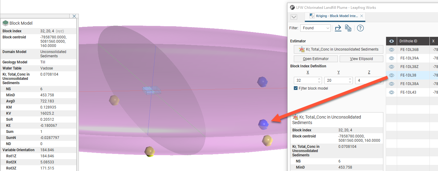

It is good practise to check the estimates produced for blocks, inspecting the data used to create the estimate. The block estimate interrogator exposes the data used to produce an estimate. Right-click on a block model in the project tree and select Interrogate Estimator.

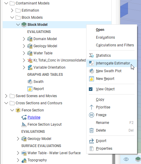

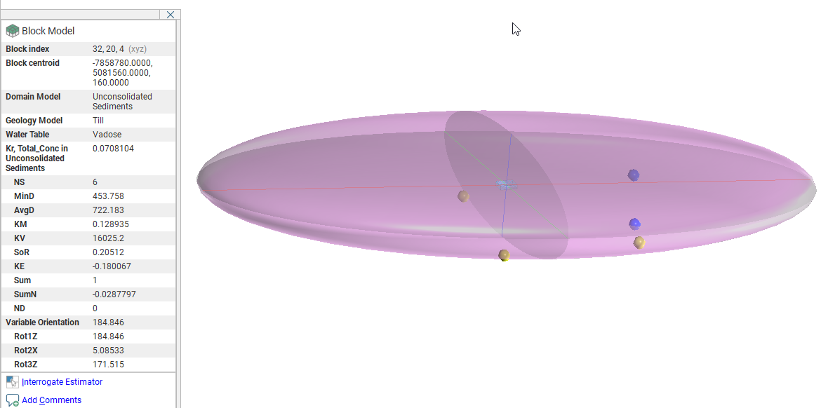

The Block Model Interrogation window will open as a dockable tab, showing the input data used in producing the estimates and other results. Additionally, in the scene view, the block details window will display inside the scene, containing properties for the currently selected block. These are primarily result properties.
Use the filter selector () to see all the Found data points in the block estimate interrogator table, or only the data points Included in the estimate, or only the data points that are Clamped. The Clamped option will only be present if Outlier Restrictions are being used by the estimator.
You can change the Estimator to select between the inverse distance and Kriging estimators evaluated on the block model. Other estimators are not supported by the block model interrogation feature.
Click the Open Estimator button to inspect the estimator used in the estimate. This will open in a new window.
View Ellipsoid will display the search ellipsoid in the scene. The axial planes of the ellipsoid are shaded, which helps to visualise the 3-dimensional shape of the ellipsoid as well as it’s orientation.

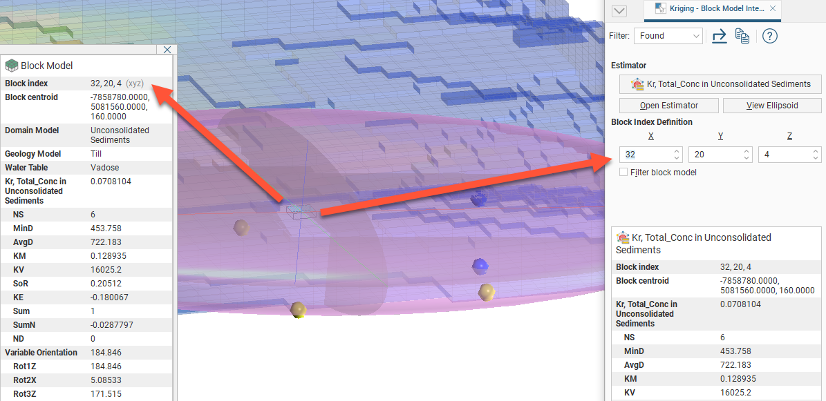

Click a block in the scene or set the Block Index Definition X, Y and Z coordinates to select a specific block.
Enable Filter block model to see only the selected block in the scene, which will reduce the visual noise of all the other blocks. This will help you see the associated data points and the search ellipsoid in relation to the selected block:

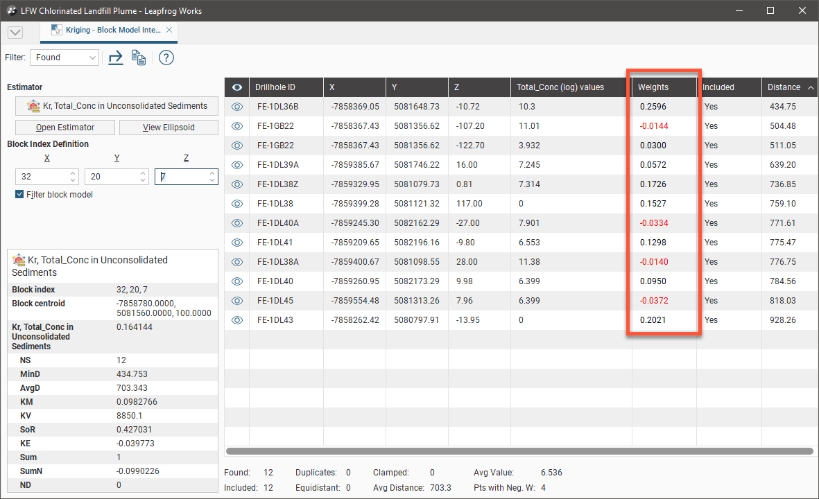

In the block estimate table, you will see all the input data columns for each data point. Data points can been hidden or made visible in the scene using the visibility button ().
Block information is shown in the bottom left corner of the Block Model Interrogation window, so it is not necessary to refer back to the scene and select the block information for the appropriate block.
In the Weights column, negative values are highlighted in red to make them easier to see.

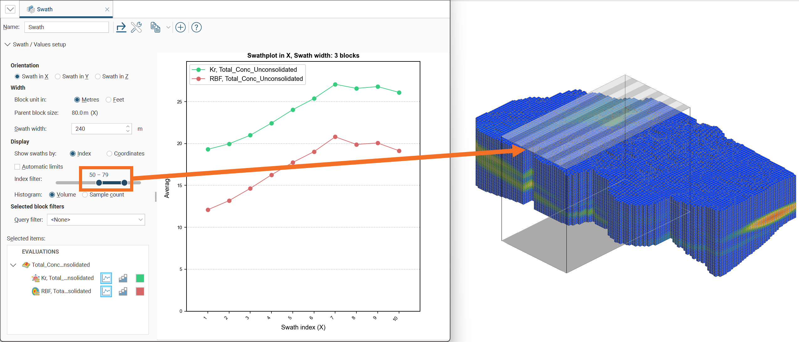

Swath plots are an important validation tool for providing comparisons between sample points (composited or uncomposited) and estimated values to identify any bias towards under-estimation or over-estimation or any smoothing in the results. The effect of different estimation methods and parameters can also be compared.

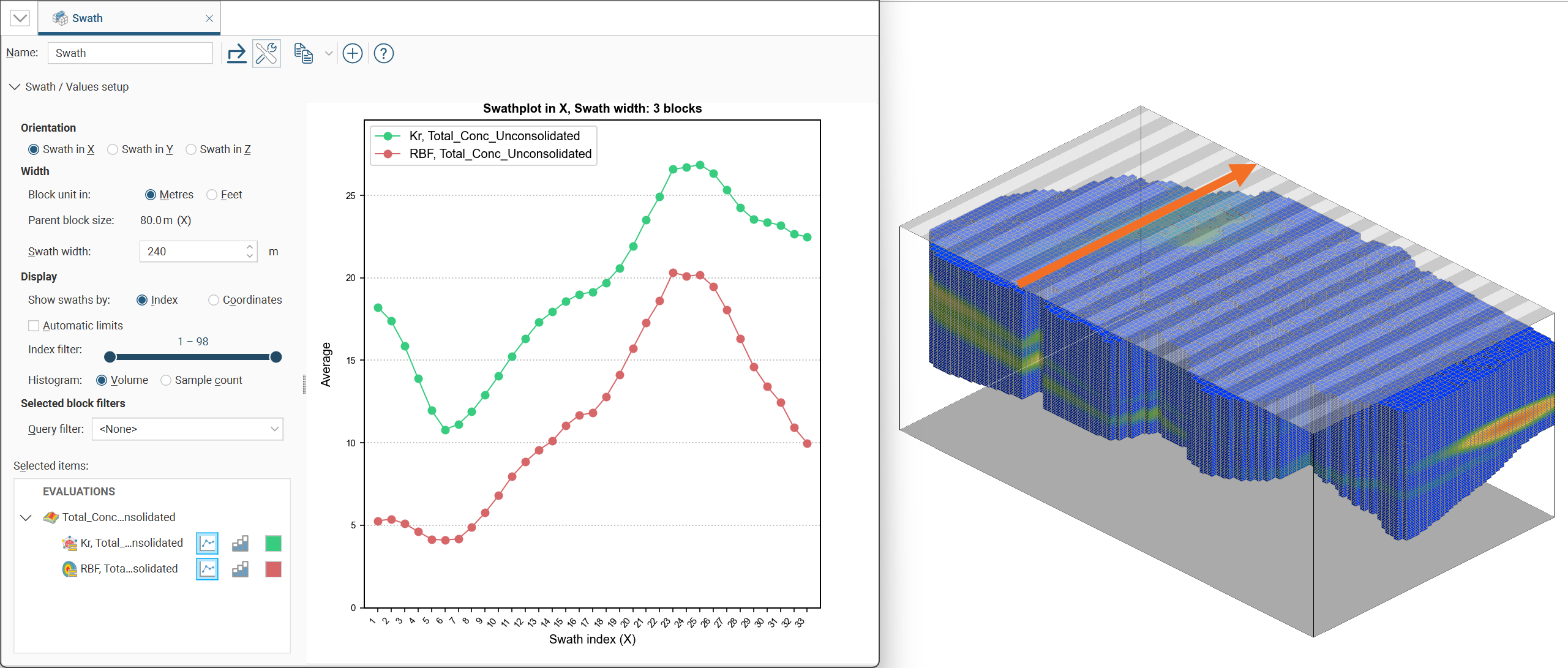

The swath plot is a one-dimensional graph in a specific direction of interest. A swath is a sectional slice through the block model with a specified thickness. The swath plot shows the average values for the blocks in the swath. You can also view the volume and the averaged sample values in the swath.

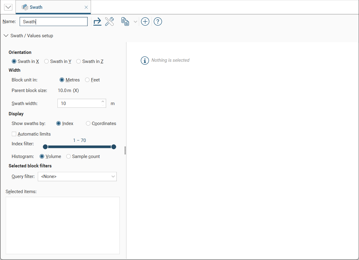

To create a swath plot, right-click on a block model and select New Swath Plot:
A new Swath window will open:

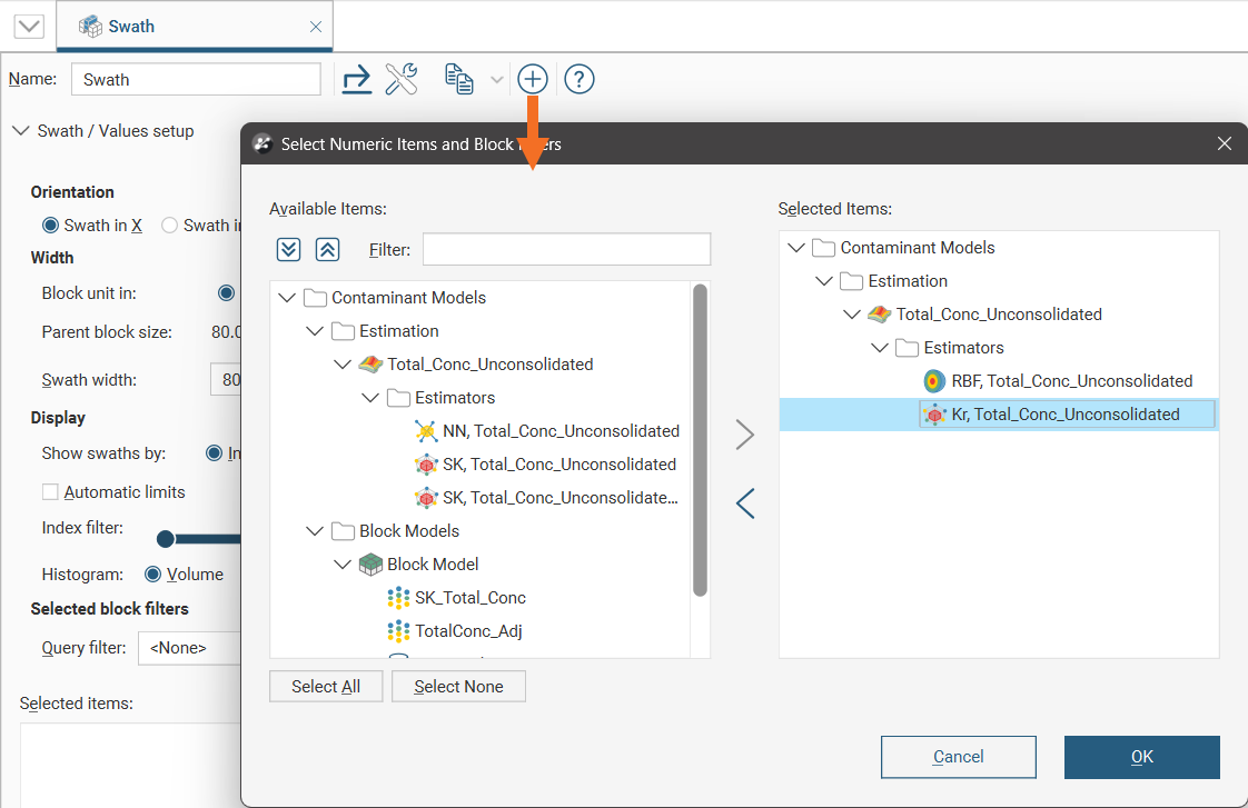

Click the add button () to add datasets to the plot. You can select individual items from the list of Available Items or you can select a parent object to select all the child items within it. Click the right arrow button to move the selected items into the Selected Items list:

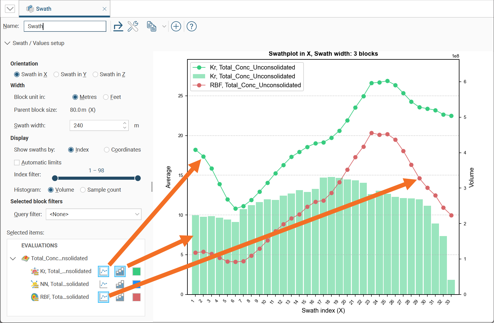

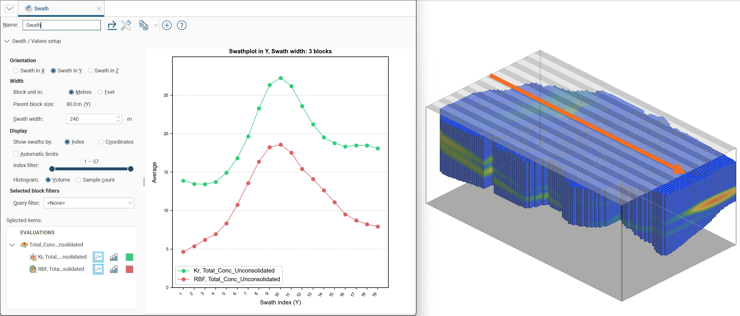

The graph plots the averaged block values for a series of swaths slicing through the block model in a selected direction. The block size can be displayed as Metres or Feet, and the Swath width can be altered for finer or coarser slices. The Scene view overlays a bounding cuboid that shows the Swath width and direction:
Changing the swath direction to Swath in Y is reflected in the scene.
In Swath/Values setup, the Parent block size will change to suit the block dimensions in the newly selected direction.
The Index filter uses a range slider that can be used for graphing a reduced set of the swaths. Either the minimum or maximum threshold for the Index filter can be dragged to change the width of the filter, and the selected portion can be changed by sliding the inner bar. The swath indicator widget in the Scene is updated to show what the Swath plot is depicting:

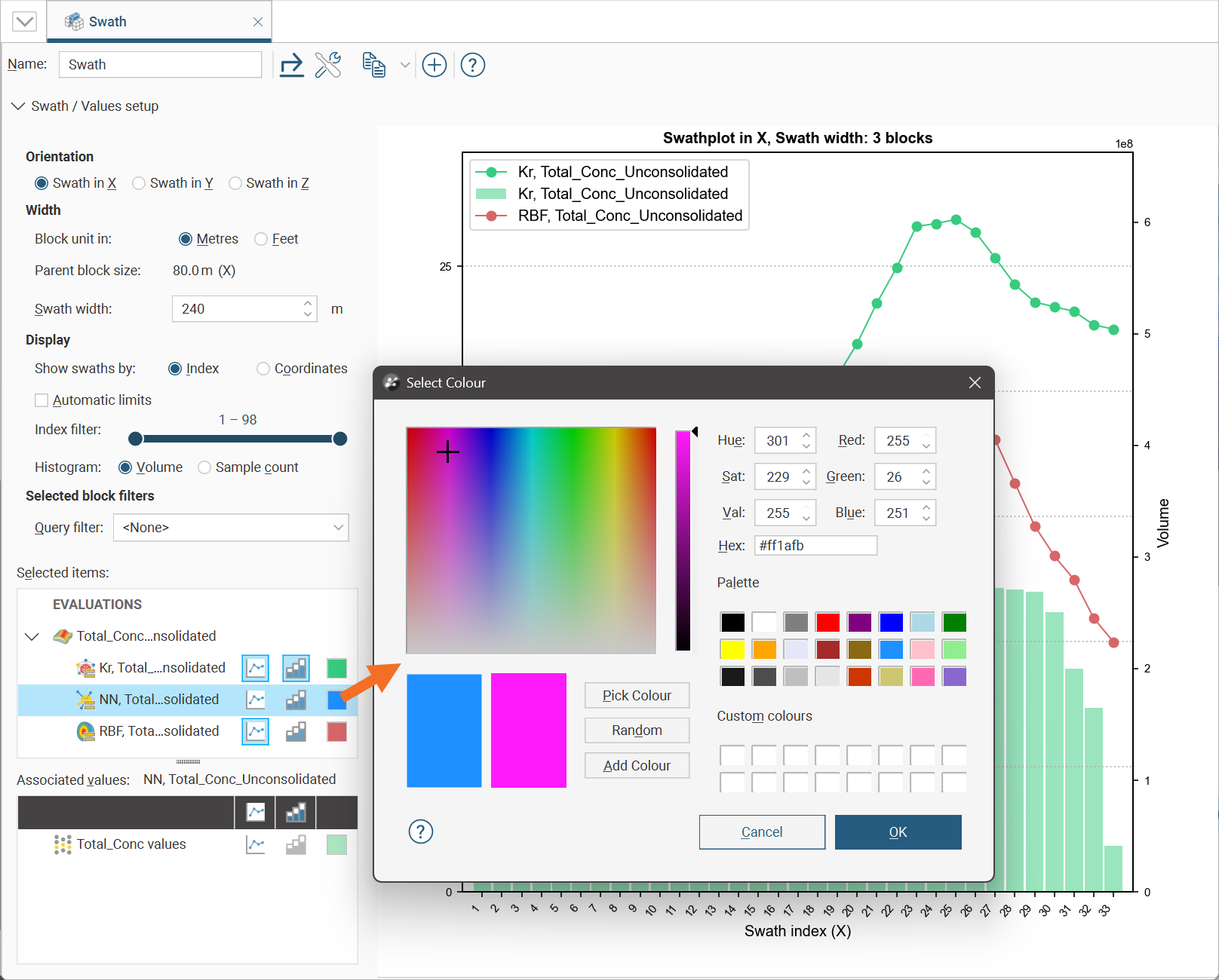

Selected datasets in the chart can be hidden or revealed by clicking the line segment visibility button () next to the dataset. The histogram visibility button () will reveal or hide a histogram showing the volume of blocks used in the swath calculation. The block volume may not be identical for all estimators.
The colour for the line segment plots and histograms can be changed for each dataset by clicking the colour chip and selecting a new colour from the colour picker:

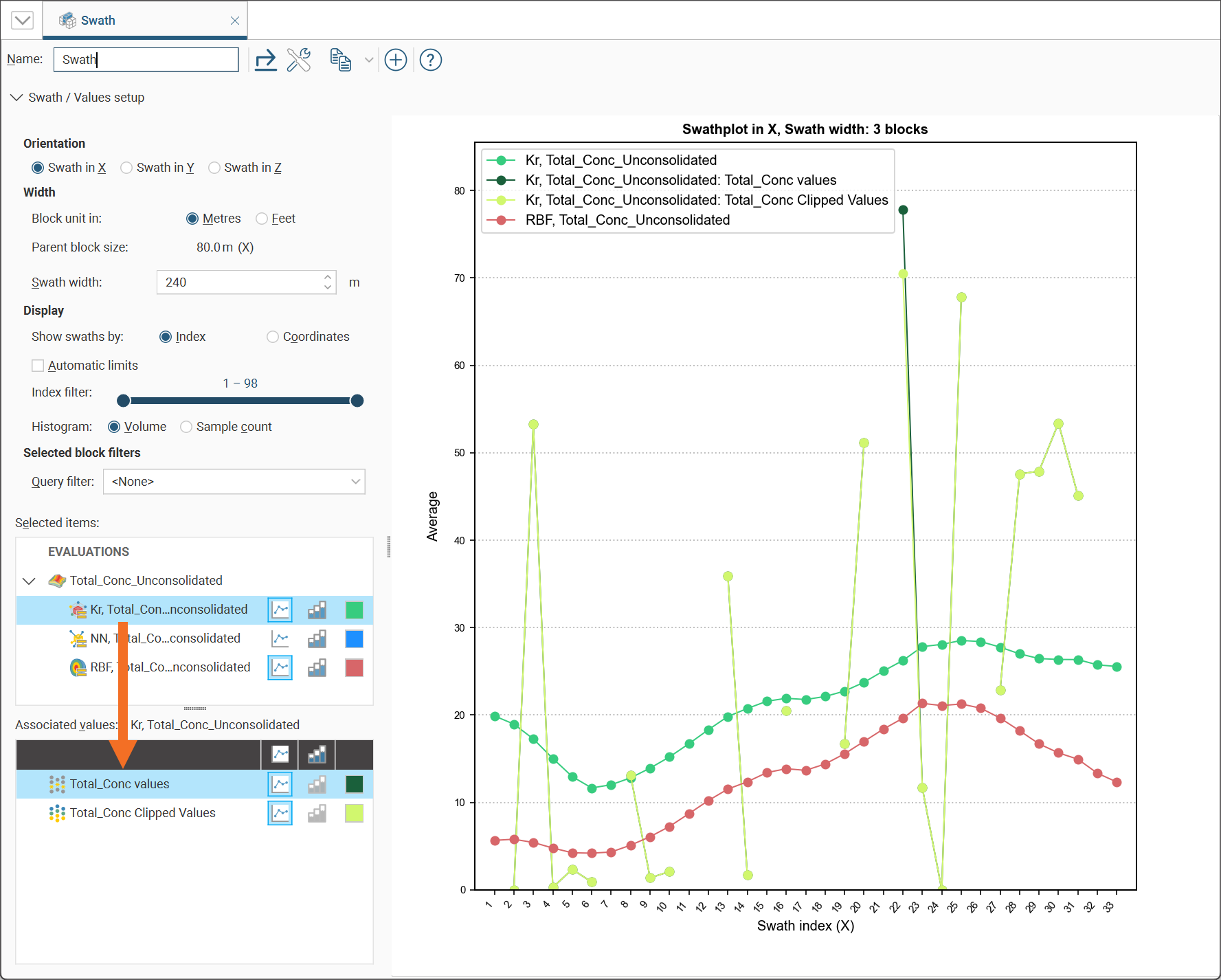

Selecting an evaluation will show an Associated Values panel. This provides options to set the visibility and colour preference for the evaluation’s raw data values. Line graphs of associated values will appear in the swath plot with dashed lines.
Depending on the evaluation selected, you may be able to select associated values from source data values and clipped values.

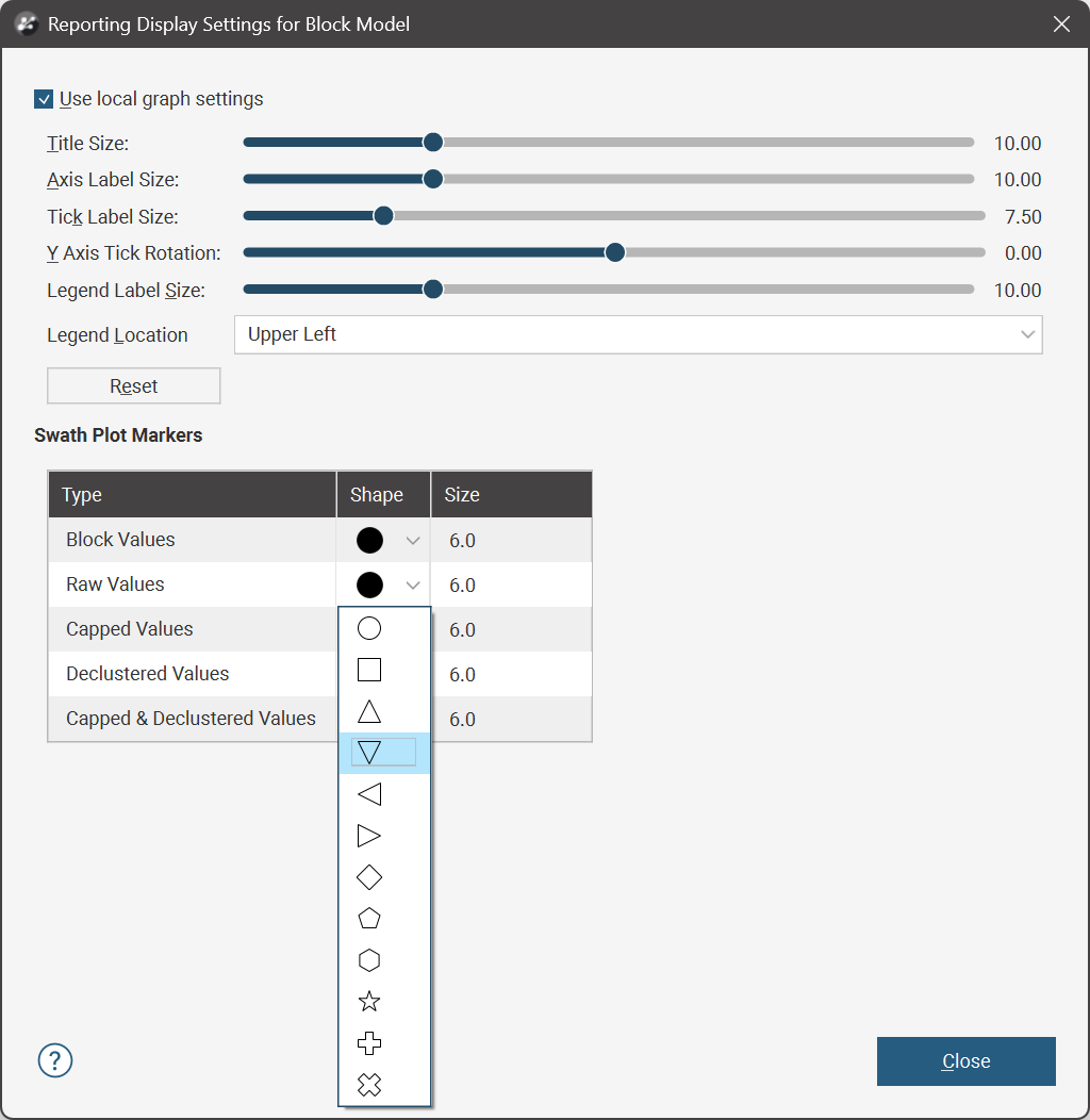

To change the plot symbols used for different categories of data types, click the Edit reporting display settings button ():
Only Block Values will be able to be set to solid swath plot markers. Raw Values and Capped Values can be set to different marker shapes, but will be hollow markers. The Size of the markers can also be adjusted, as well as other graph settings.

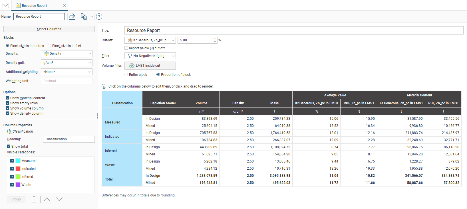

To create or view a contaminant report, right-click on a block model in the project tree and select Report. In the window that appears, click the Select Columns button to choose from the Category columns and Value columns evaluated onto the block model. If you wish to set a Cut-off value, select from any numeric column evaluated on the block model and set the cut-off value. The column selected for the Cut-off does not need to be a column included in the resource report. You can also apply a Filter to the report.
Select between Block size is in metres and Block size is in feet to ensure units are correctly converted. Select Constant value from the list of Density options and specify a numeric constant, or select a density data measurement from the numeric columns listed. Specify the appropriate Density unit to match the Density selection.
Select an option from Additional weighting when you want the selected columns scaled by the value in another column. This is especially useful when you have a proportion column you wish to use to weight the report data, such as a volumetric proportion. You may need to use the Weighting unit to specify if the column selected is a decimal value or a percentage if Leapfrog Works cannot determine this automatically.
It is not advisable to use a stored proportion Additional weighting along with a Proportion of block volume filter. This is because the report would be calculating a proportion of a proportion. To make this calculation assumes these proportions can be simultaneously applied, which may not be the case, resulting in incorrect results. See Proportions of Proportions Not Advised for more details.
You can also choose to Show material content columns, Show empty rows, Show volume column and Show density column.

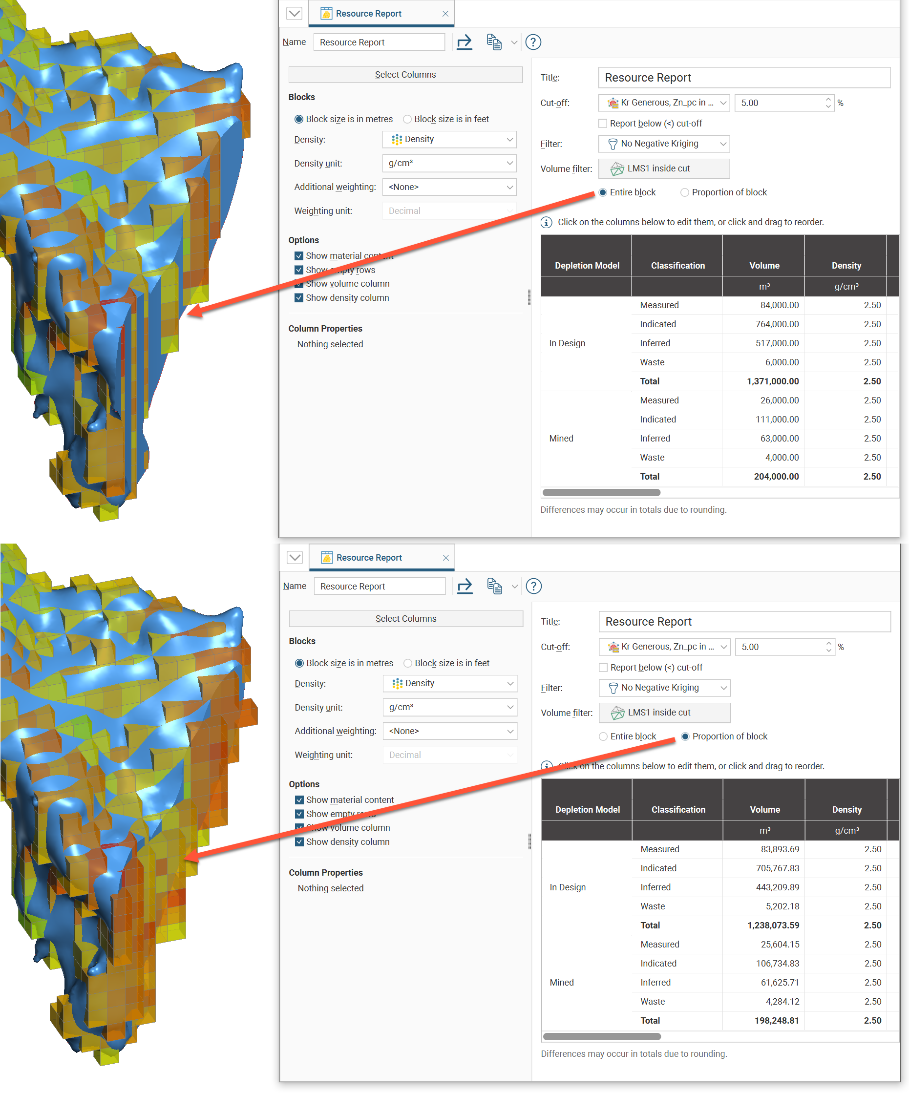

If you select one of the options in the Volume filter dropdown, only blocks within the selected volume will be reported on in the report.
  • If Entire block is selected, an entire block will be included in the report as long as the block centroid is within the volume being used as a filter.
  • If Proportion of block is selected, only the proportion of a block that is within the selected volume will contribute to the report.

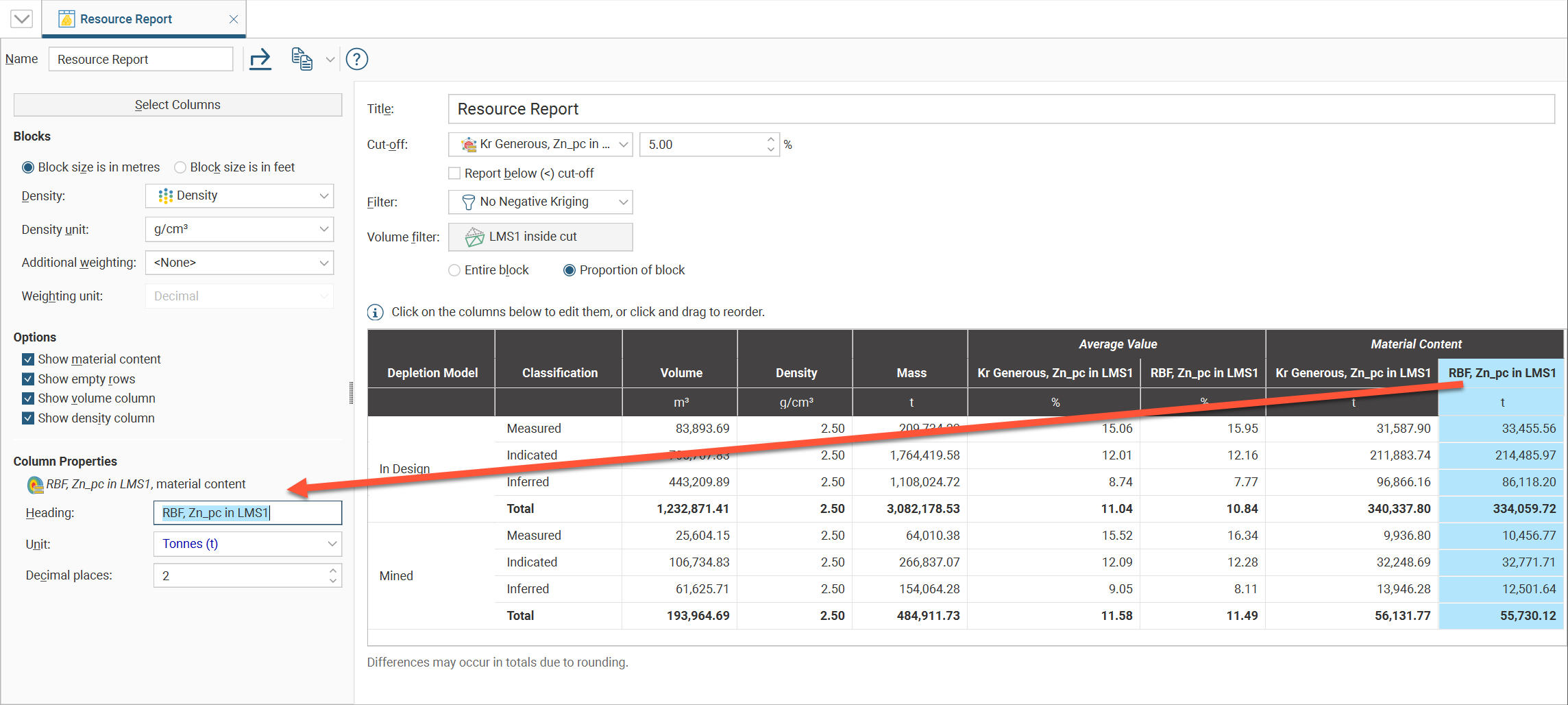

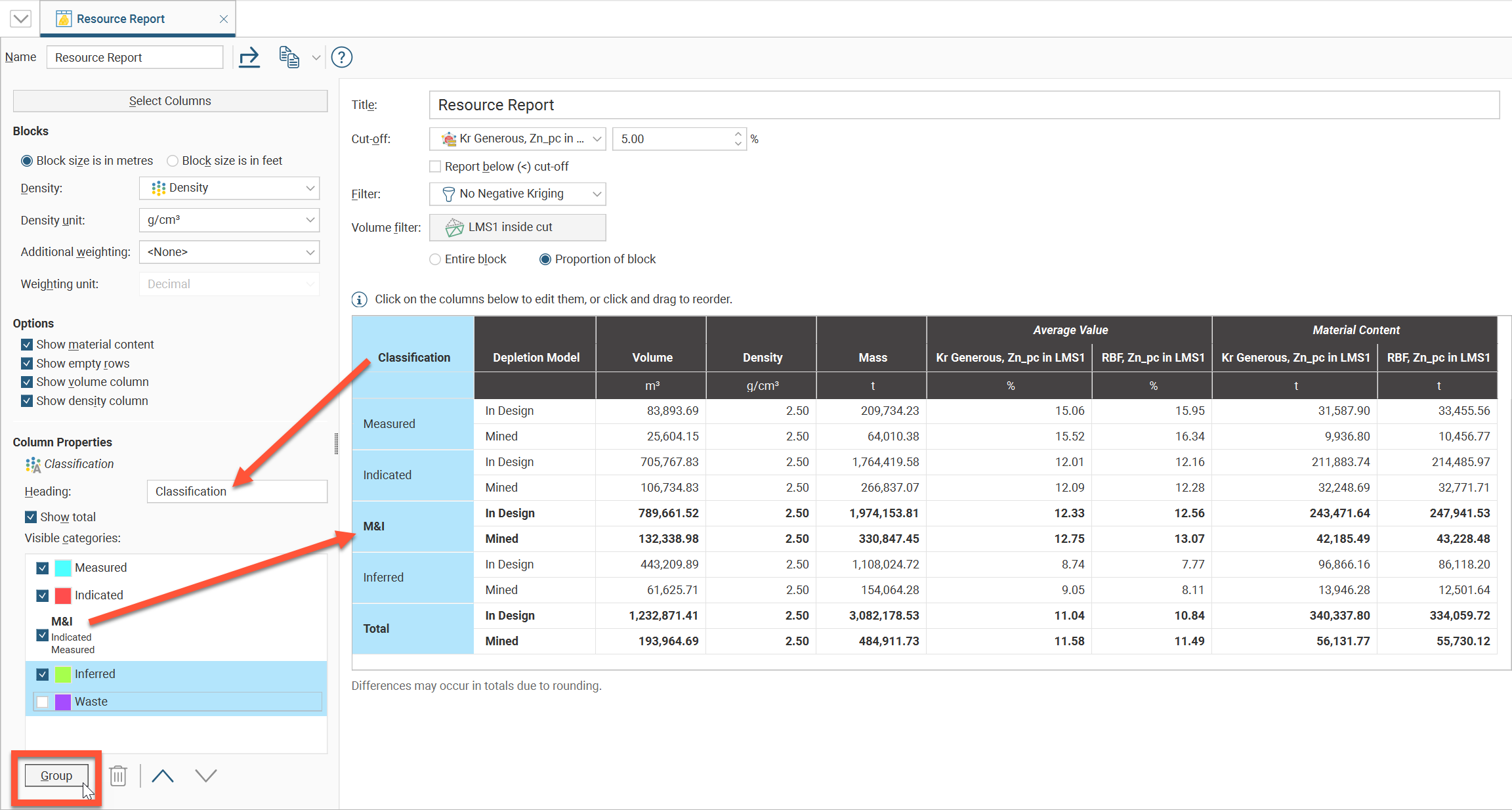

Click on a column to customise how the information is displayed. You can change the column title by editing the Heading field.

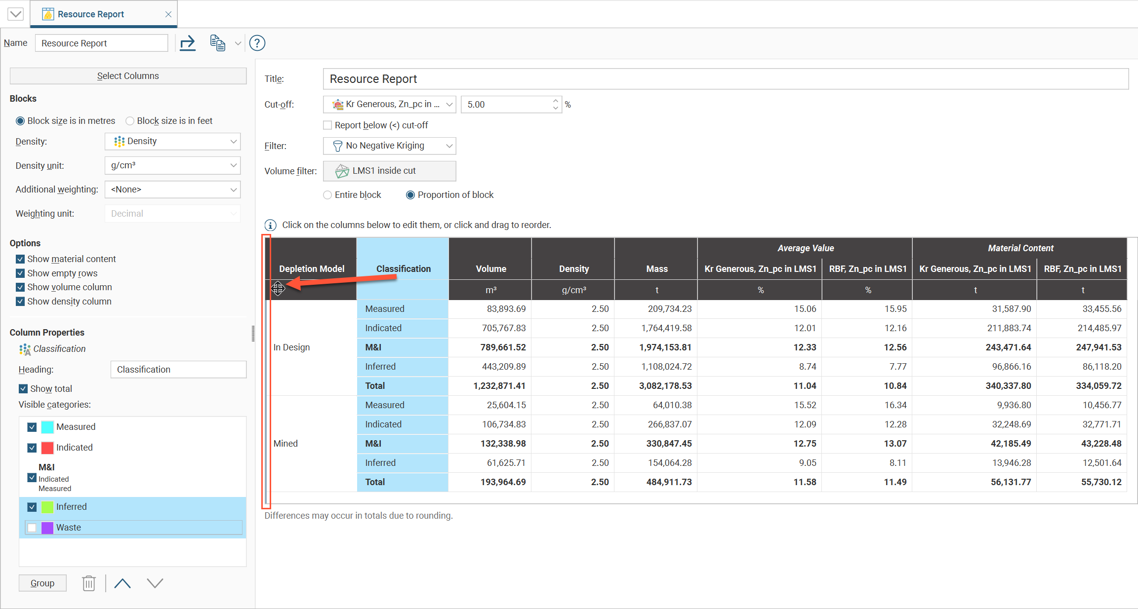

Enabling Show total will add a category row called Total with a summation for the categories. Any row that is a summation of categories will appear in bold in the table. It is possible to get a sub-total of some of the categories by grouping them, and these will also be shown in bold. To group categories, select multiple items in the Visible categories list by holding down the Ctrl key as you click the mouse. Click the Group button to add the new category.

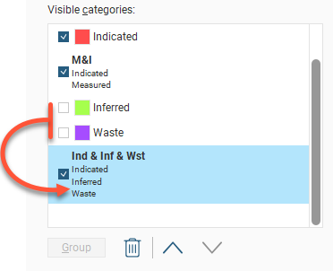

Note that some of the Visible categories can be unticked to hide them; these hidden categories can still be included in a grouped category:
Select a category and click the up or down buttons to reorder them in the list. Delete a grouped category by selecting it and clicking the Delete button ().
If there are multiple category columns, these can be reordered to select one as the primary categorisation, with the others shown as sub-categories. Click anywhere in a category column and drag it to a new location. While you hold down the mouse button, a vertical bar will appear where the column will be inserted:

Material Content columns can have the Heading changed, as well as the column’s Unit and Decimal places.

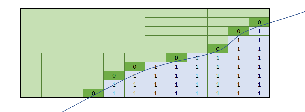

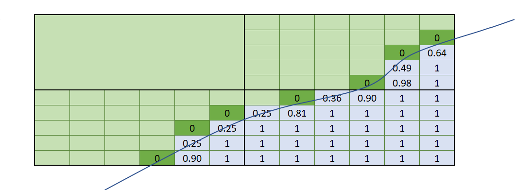

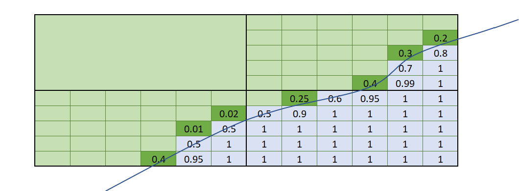

This matrix shows the results of the combinations of the volume filter’s Entire block and Proportion of block options against Additional weighting being selected as none or the volume of interest. The line crossing through the boxes shows part of a closed mesh volume. Blocks shaded grey have their block centroids within the mesh volume. Note that even though the same volume of interest is used in all cases, when both Proportion of block and Additional weighting are applied at the same time, the values in the blocks are undervalued because the proportion has been applied twice.
  Entire block (where centroid is inside mesh volume) Proportion of block inside volume filter determined by mesh
Additional weighting = <None>
Additional weighting of proportion inside mesh
Note that the combinations:
  • Additional weighting = <None> plus Proportion of block volume filter
  • Additional weighting = proportion of block inside volume plus Entire block volume filter
do not result in precisely matching data. Take note of the dark green boxes that depict blocks with the block centroids outside the volume of interest. The Entire block volume filter selects only blocks that have the block centroid within the volume, so these dark green blocks get 0 values. When Proportion of block is used, even though the block centroid is outside the volume, the amount of the block within the volume is assigned as a value. Each approach is valid, and which you choose depends on the result you want to achieve.
