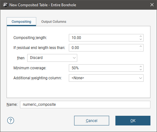

Compositing in the Entire Borehole
When compositing is carried out using the Entire Borehole option, the boreholes are divided into intervals wherever numeric data occurs and the parameters set in the Compositing tab are applied to all values down the length of boreholes.
The order of the operations in numeric compositing is as follows:
- A compositing length is selected. This may or may not end up being the exact length of composited intervals, which will depend on subsequent parameters and the actual data.
- Determine how to handle short sections at the end of boreholes that are shorter than the compositing length.
- If Distribute equally throughout borehole is selected, all the composited intervals will grow longer than the compositing length.
- If Add to previous interval is selected, the last interval will be longer than the compositing length.
- Compare the total length of data in each composited interval to the Minimum coverage parameter. If the available data does not meet the threshold for an interval, that interval will not get a composited value.
- Determine how to weight the input data, if required.
- Derive a value for each of the composited intervals that passes the minimum coverage test.
Compositing Length
The Compositing length you set will depend on factors including the deposit style, the sampling method and raw sample length. You can view statistics on the drilling data table to get an idea of the distribution of interval lengths. Right-click on the drilling data table and select Statistics. In the window that appears, select the Interval Length Statistics option:
Another consideration in selecting the composite length is choosing a length that will not split units. For example, if most intervals are 2m long, choosing a length of 1m or 5m will split some intervals so that an interval with a single value will be represented more than once in the composite intervals. If intervals are mostly 2.5m long, then a composite length that is 2.5m or a multiple of 2.5m would ensure that units are not split.
Note that the actual length of intervals in the composited table may be longer than that set by the Compositing length. This arises from residual segments at the ends of boreholes and where there is data missing down a borehole; the length of these residual segments will, in certain conditions, be added to the composite intervals further up the borehole. See Residual End Length Handling below for more information.

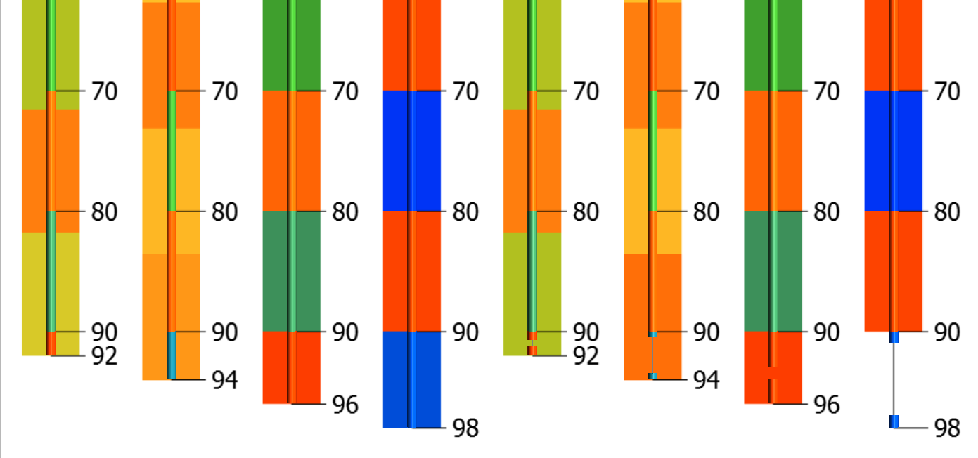

In the illustration below, a series of adjacent boreholes have varying lengths of small data intervals that will not make up a full composited interval. The Residual end length is 5, the option to Distribute equally throughout borehole has been selected and the Minimum coverage is 32%. The borehole data is shown in the centre, with the composited data shown around the boreholes.
The left four boreholes have extra residual segments of 2m, 4m, 6m and 8m. The two boreholes with short lengths less than 5m show the extra length has been distributed across the borehole intervals for compositing, as seen by the borehole interval transitions not lining up with the 10m depth markers. The boreholes with extra lengths of 6m and 8m have had the lengths added as short composite intervals, as they exceeded the residual end length.
The right four boreholes have missing data of varying lengths. Again, the two boreholes on the left have had the residual segment length distributed across the borehole intervals for compositing, as seen by the interval transitions not lining up with the 10m depth markers. Even though the 4m residual end segment has only 25% data coverage, the selected action is applied because the residual segment is shorter than the residual end length. The 6m residual end segment has 83% data coverage, so the additional segment is added as a short composited interval. The 8m residual end segment on the very right has only 25% data coverage, so the data is discarded.

In the image below, several adjacent boreholes have various sized gaps in the drilling data, shown using the inner solid line. The outer translucent line represents the composited intervals, and as the Minimum coverage value was set at 32%, only the largest data gap resulted in a missing composited interval.
Intervals that have no data can have a significant effect when compositing data as they are ignored by the compositing algorithm. The effect of these missing intervals can be managed using the Minimum coverage parameter, but it’s best to assign special values where intervals have no data. For example, intervals that are missing data can be assigned a value of 0 or that of the background mineralisation. See Handling Special Values for more information.

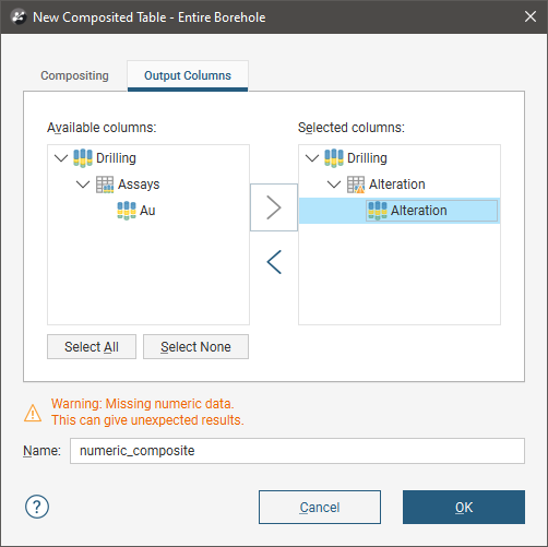

Output Columns
In the Output Columns tab, select the columns to be added to the numeric composite table. Move selected items from the Available columns list to the Selected columns list by clicking an item then clicking the
button. You can select multiple items by holding down Ctrl while clicking.

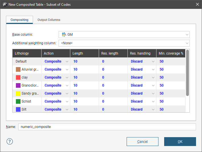

Compositing in a Subset of Codes
When compositing is carried out using the Subset of Codes option, some codes can be excluded from the composited table or the raw data from the Base column can be used. When compositing is applied to a code, the same parameters apply as for the Entire Borehole option, but different codes can use different Compositing length and Minimum coverage parameters.
For the Action column, select from:
- Composite. Numeric data that falls within the selected code will be composited according to the parameters set.
- No compositing. Numeric data is not composited within the selected code. The raw data will be used in creating the new data table.
- Filter out. Numeric data within the selected code will excluded from the new data table.
See Compositing in the Entire Borehole above for an explanation of the Length, Min. coverage, Res. length, Res. handling and Additional weighting column parameters.

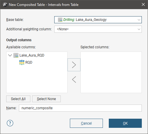

Using Intervals From Another Table
When compositing is carried out using the Intervals from other Table option, first select the Base table. This is the table that will that will be used to determine the interval lengths in the composited table.
The value assigned to each interval will be the length-weighted average value, and you can use an Additional weighting column. This column must contain valid (positive) values for all of the composite’s output intervals. If this is not the case, you will receive a message saying the table cannot be created. If the column selected as the weighting column is also in the list of output columns, that output column will be composited using length-weighted averaging only.
There are no further compositing parameters to set. Click OK to create the table.

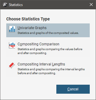

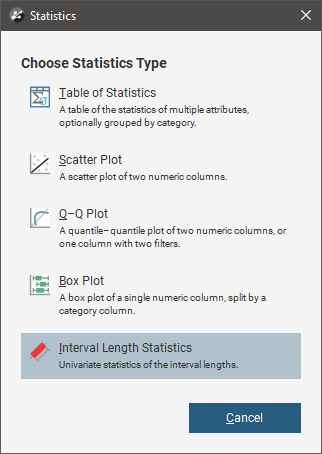

Viewing Numeric Composite Statistics
Once you have created a composited table, you can view statistics on the table or for each individual column in the table.
To view statistics for the table, right-click on it and select Statistics.
See the Saved Statistics topic for an introduction to statistics in Leapfrog Works.
The Interval Length Statistics graph is a univariate graph, so for more information on the options available, see the Univariate Graphs topic.
Right-click on the table columns and select Statistics to view information about the composited values.
Univariate Graphs displays statistics on the composited values. The other two compositing options display statistics comparing data before and after compositing.

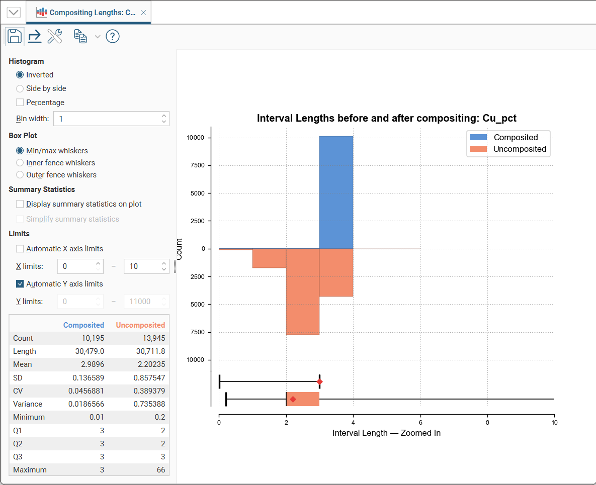

Compositing Interval Lengths
This graph shows a double histogram of distributions of the interval lengths before and after compositing.
In the Histogram settings, Bin width changes the size of the histogram bins used in the plot.Percentage is used to change the Y-axis scale from a length-weighted scale to a percentage scale.
Enabling Display summary statistics on plot will replicate the summary statistics for the dataset as a legend on the plot.
If a more concise legend is preferred with only the key statistics, enable Simplify summary statistics:

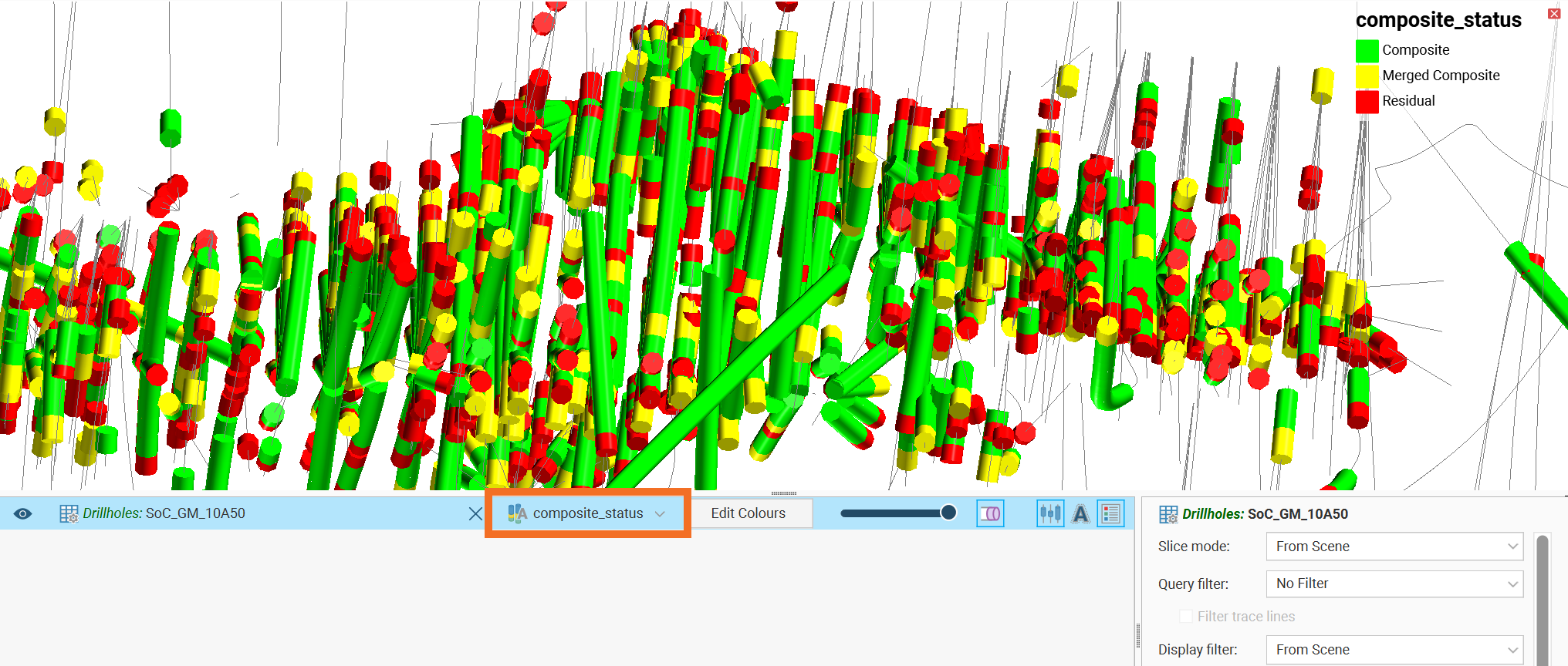

Viewing Numeric Composite Status
The behaviour of the numeric compositing can be observed in the scene by adding the boreholes to the scene and selecting composite_status as the colouring in the shape list.
