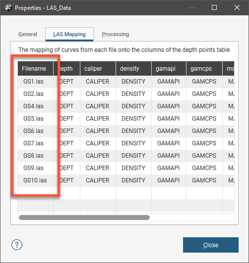

The Properties window for LAS Boreholes includes a LAS Mapping tab that shows what data files have been used for the selected borehole:
This is useful when data for a borehole originates in different files.

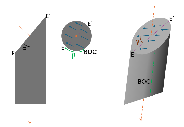

Leapfrog Works expects columns describing the borehole identifier, the depth and the structural orientation. Structural orientation can be specified using either dip and dip azimuth or alpha and beta. Alpha/beta values will be converted to dip/dip azimuth for use in Leapfrog Works.
Alpha is the minimum acute angle measured between the core axis and the geological plane
Beta is the angle of rotation clockwise (looking towards the end-of-hole) from the bottom-of-core line to the apical trace, the long axis E-E’ of the ellipse formed by the geological plane when alpha < 90 degrees

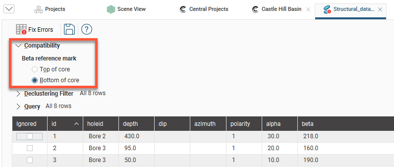

If the structural orientation is specified using alpha and beta, the reference line from which the beta is measured can be the bottom or top of the borehole. When the table is imported, the default setting is Bottom of core. To change this, double-click on the structural data table in the project tree. Next, click on Compatibility to change the Beta reference mark setting to Top of core:

Leapfrog Works expects columns describing the borehole identifier, the depth and the lineation measurements. Both plunge/trend and alpha/beta/gamma measurements are supported. If the source data contains alpha, beta and gamma columns, Leapfrog Works will convert these to trend and plunge values, assuming the conventions used by Holcombe, Blenkinsop et al. and Bernhard et al.:
Alpha (α) is the minimum acute angle measured between the core axis and the geological plane
Beta (β) is the angle of rotation clockwise (looking towards the end-of-hole) from the bottom-of-core line to the apical trace, the long axis E-E’ of the ellipse formed by the geological plane when alpha < 90 degrees
Gamma (γ) is the angle of clockwise rotation between the beta plane (the long axis E-E’) and the lineation plunge direction, when measured on the geological plane defined by alpha and the long axis E-E’ of the ellipse when alpha < 90 degrees
This convention is different to the Marjoribanks convention. If your data uses Marjoribanks’ convention, you will need to pre-convert the data before importing into Leapfrog Works
