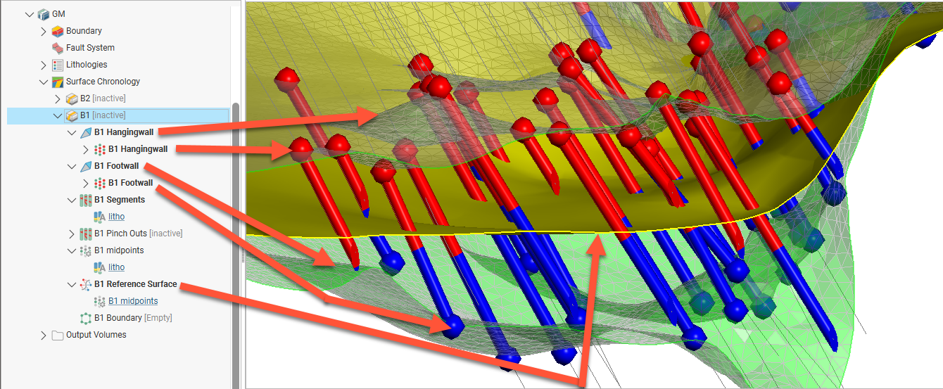

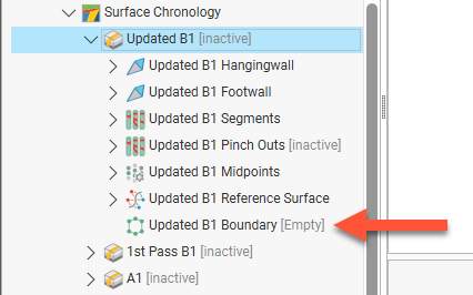

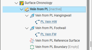

This vein (
) is made up of:
- Hangingwall and footwall surfaces (
). When expanded, you can see the hangingwall and footwall data objects used to create the surfaces. In this example, the vein has been created from drilling contacts and so the hangingwall and footwall have been created from points (
). - Vein segments (
), pinch out segments (
) and midpoints (
) extracted from drilling data. Veins created from data other than drilling data will not have vein segments, pinch out segments or midpoints.- Vein segments are categorised into hangingwall segments, footwall segments or excluded segments. Excluded segments are those that are completely enclosed within the vein lithology and so do not have hangingwall or footwall contact points.
- Pinch outs are only included when the Pinch out option has been enabled.

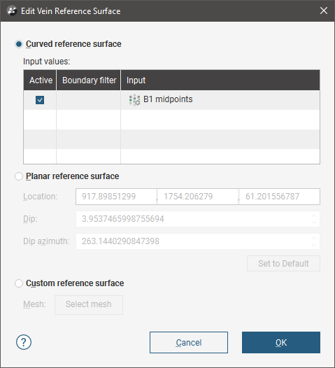

- Midpoints are used to create a first-pass reference surface.

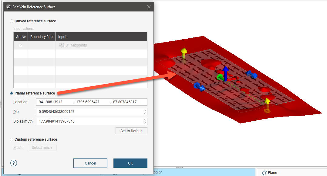

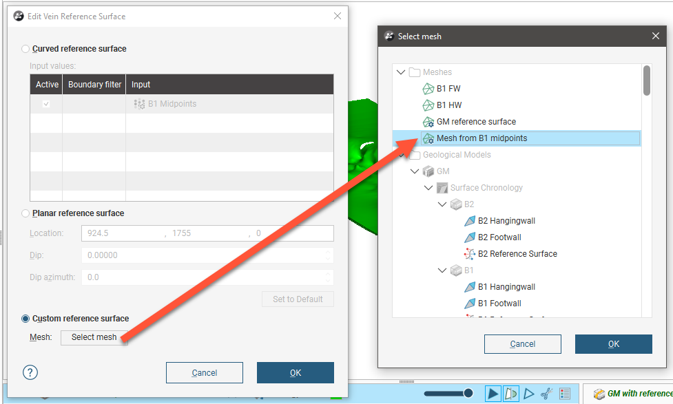

- A reference surface (
) representing the trend or form of the vein. When a vein is created from drilling data, the initial reference surface is calculated as the best fit surface using the midpoints and the hangingwall and footwall surfaces. For veins created from data other than drilling data, the initial reference surface is a planar reference surface. - A boundary object (
). This is empty when the vein is first created.
If the vein is created from data other than drilling data, that data will be linked to from the hangingwall and footwall surfaces. For example, this vein was created from polylines. Note that there are no vein segments, pinch out segments or midpoints to work with.

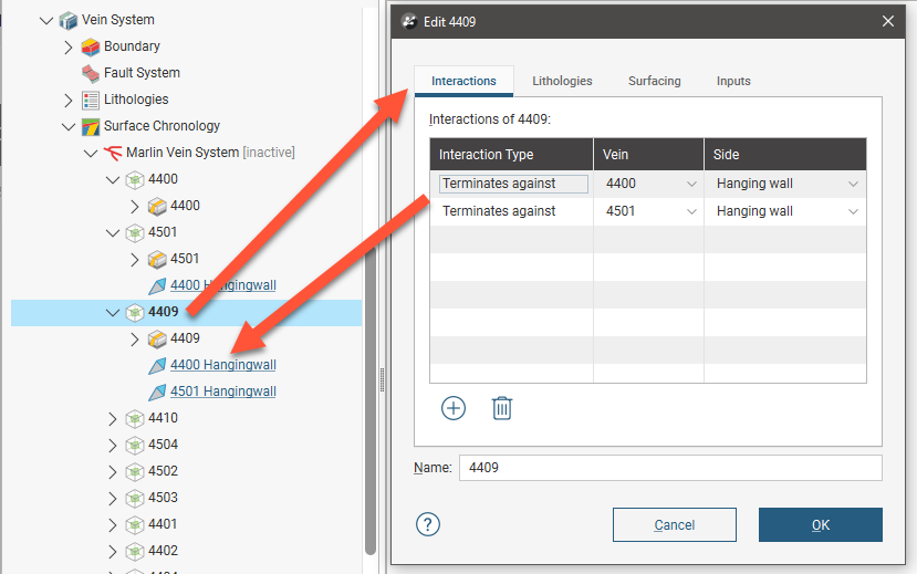

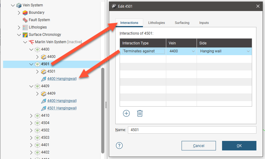

Vein contact surfaces can also be created as part of a vein system (
), in which case, each vein (
) is linked to the vein system via a “terminated vein” (
) that takes into account the vein’s relationship to other veins in the vein system. For example, in this vein system, a series of terminated veins make up the system. Expanding a terminated vein shows the vein surface (

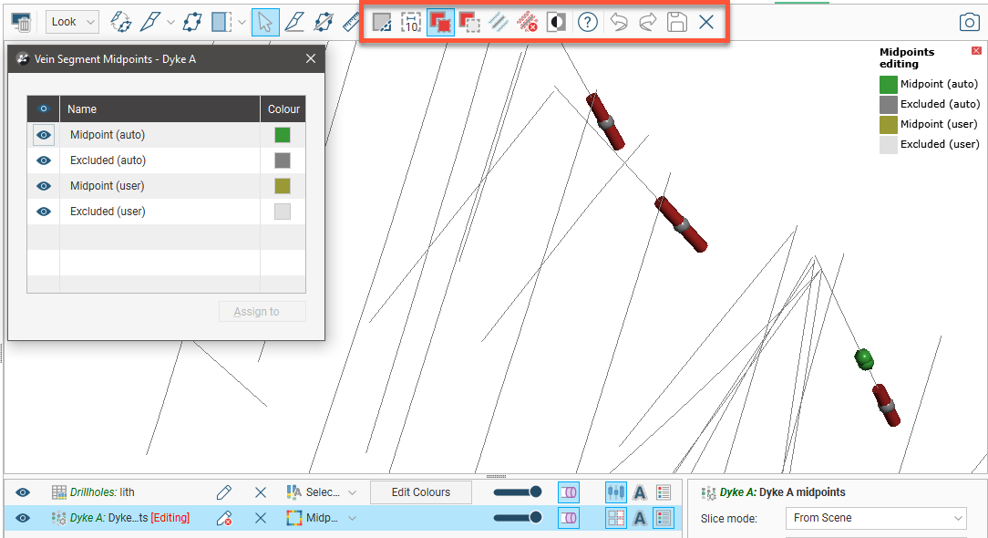

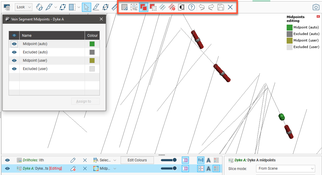

- Editing Vein Midpoints

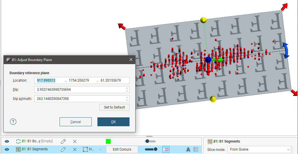

- Editing the Vein Boundary

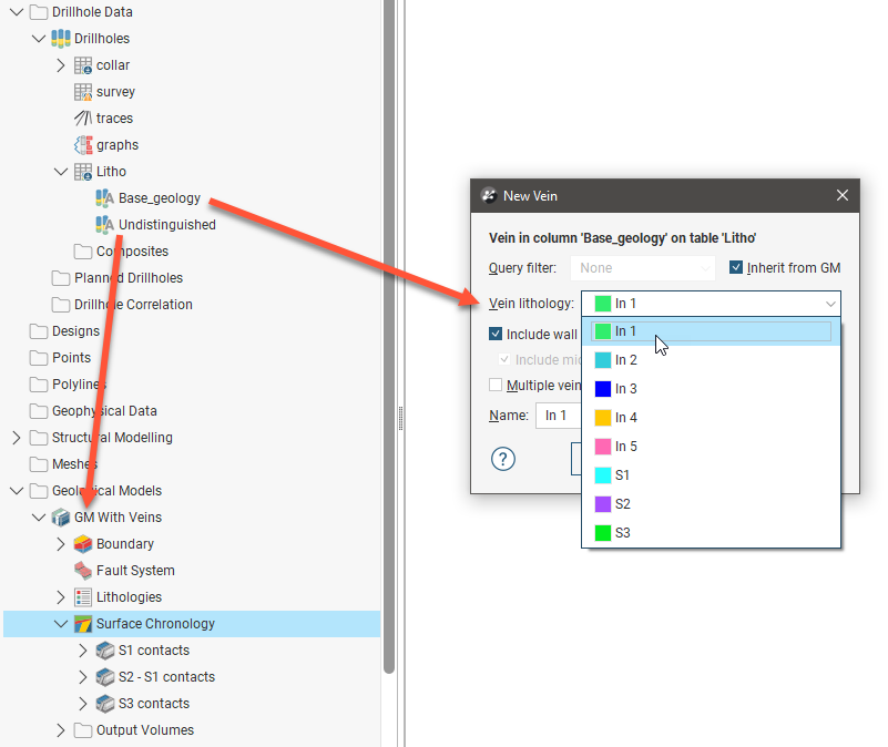

New Vein From Base Lithology

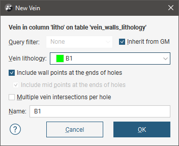

To create a new vein from base lithology contacts, right-click on the Surface Chronology object and select New Vein > From Base Lithology. In the New Vein window, select the Vein lithology.
The options available are only those lithology codes in the base lithology column; codes manually added to Lithologies in the geological model are not available.
You can choose to use the query filtering already selected for the geological model by ticking the Inherit from GM box, or untick it and select from the available options in Query filter.
Click OK to create the vein, which will be added to the project tree as part of the Surface Chronology object.
The Include wall points at the ends of holes, Include mid points at the ends of holes and Multiple vein intersections per hole settings are discussed later in this topic, in Vein Segment Settings. To change the settings in this window for an existing vein, expand the vein in the project tree and double-click on the vein segments (

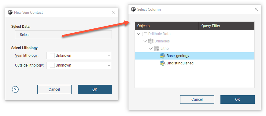

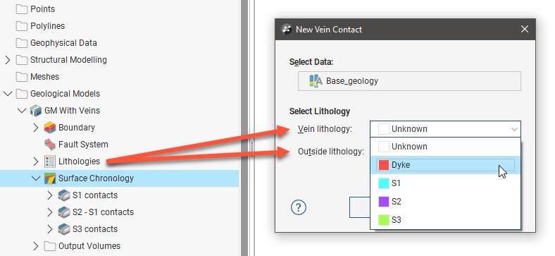

When a vein is to be created using a lithology column other than the geological model’s base lithology column, right-click on the Surface Chronology object and select New Vein > From Other Contacts.
In the New Vein Contact window under Select Data, click the Select button and choose the column containing the needed lithology information.
Once a data column has been selected, the rest of the New Vein Contact window can be completed. Note that both the Vein lithology and Outside lithology fields draw their options from the geological model’s Lithologies codes, not the codes from the column just selected. Selection of the lithology data to be used in construction of the vein happens in the next step. Here the Vein lithology field is asking which of the Lithologies in the geological model will be used to represent the data being introduced from the other contacts. If no code in Lithologies is appropriate, manually add a new code, as described in Geological Model Lithologies.
If the vein contacts only one lithology, set the Outside lithology. Otherwise, leave Outside lithology set to Unknown.

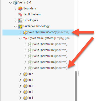

Copying Veins
As described in Copying Contact Surfaces in the Building Surfaces Using the Surface Chronology topic, you can copy veins and vein systems, which is useful in experimenting with the effects of different settings and in ensuring the consistency of settings across surfaces.

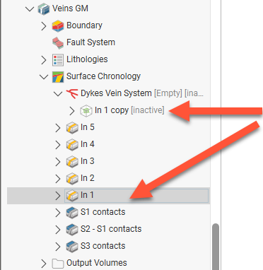

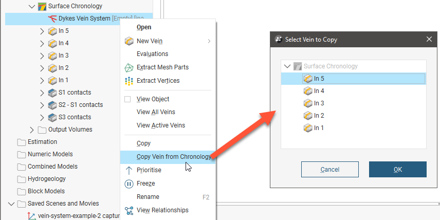

It is also possible to copy individual veins into and out of vein systems.

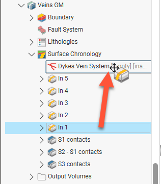

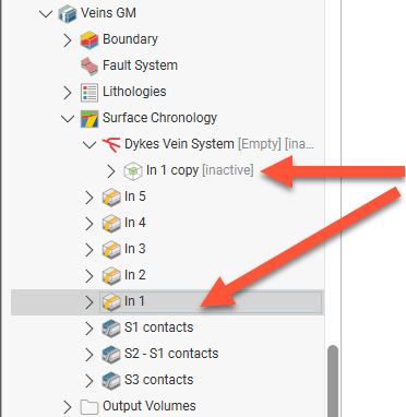

To copy a single vein into a vein system, right-click on a vein system and select Copy Vein from Chronology. Select from the available veins:
You can also drag a vein into a vein system. Here the vein In1 is being dragged into to the Dykes Vein System:
When you drop a vein into a vein system, a duplicate copy of the vein will be made and added to the vein system, while the original single vein remains:

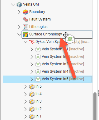

To move a vein out of a vein system, drag it onto the surface chronology:
A copy will be made in the top level of the surface chronology, while the original vein remains in the vein system:

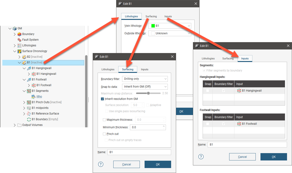

Double-click on a vein in the project tree to edit its lithologies and various surfacing settings.
- The only settings you can change in the Lithologies tab are the Vein lithology and the Outside lithology.
- The options in the Surfacing tab are discussed below.
- The Inputs tab contains additional settings related to the boundary filtering and snap settings in the Surfacing tab.

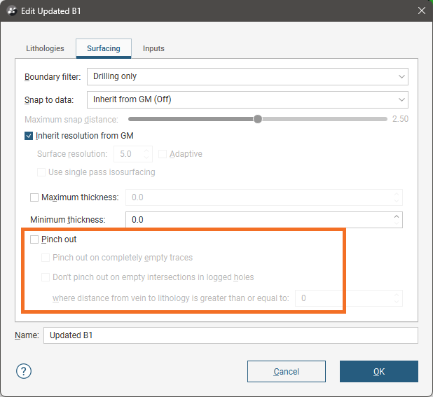

Pinch Outs
Vein walls can be set to pinch out where drilling data does not include the designated vein lithology. Pinch outs are achieved by creating ‘outside’ intervals on boreholes that do not have an interior vein segment. These intervals are then flipped with respect to interior vein intervals, which, in effect means the footwall and hangingwall orientation has the opposite sense to the nearest interior intervals. This forces the hangingwall and footwall surfaces to cross, thereby pinching out.
The Pinch out option is disabled when a vein is first created. To enable it, double-click on the vein in the project tree and click on the Surfacing tab. Tick the box for Pinch out:

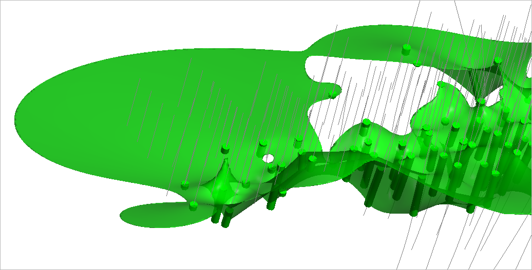

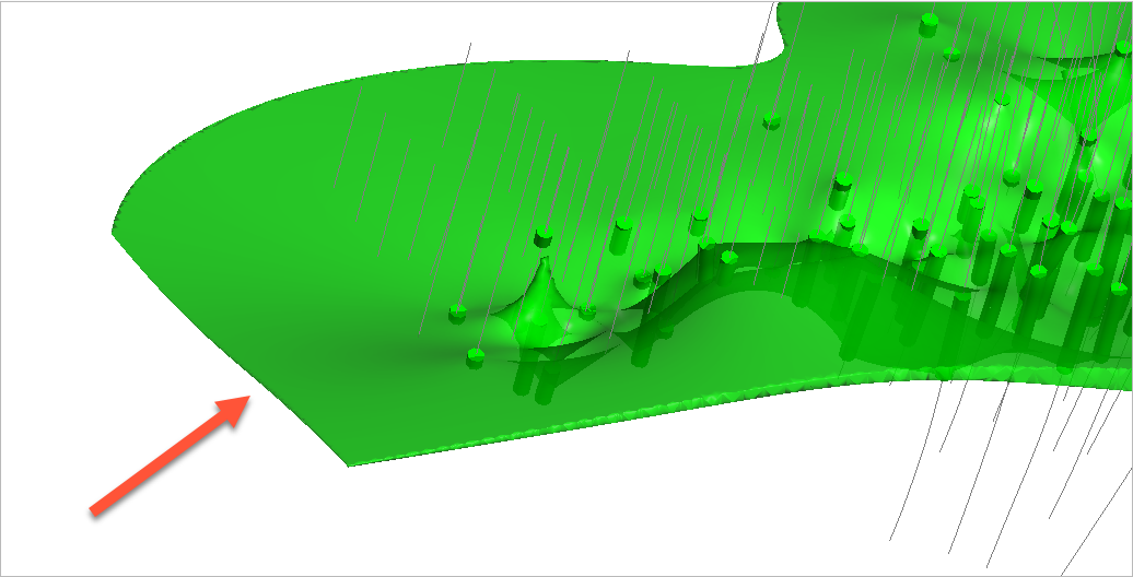

For this vein, the green cylinders indicate vein lithology intervals. The surface continues to the boundary even where there are no boreholes that have vein lithology intervals:
When the vein is set to pinch out, it tapers out where there is no vein lithology data:
There are two further settings that relate to whether or not a borehole trace has data logged:
- The Pinch out on completely empty traces setting relates to whether or not pinch outs are created for boreholes where no lithology data has been logged, neither vein nor background lithology.
- The Don’t pinch out on empty intersections in logged holes setting relates to whether or not pinch outs are created for boreholes that have data logged that intersects the vein’s hangingwall and/or footwall surfaces.
There is also the option to manually exclude some pinch out segments. Each of these is discussed in detail below:

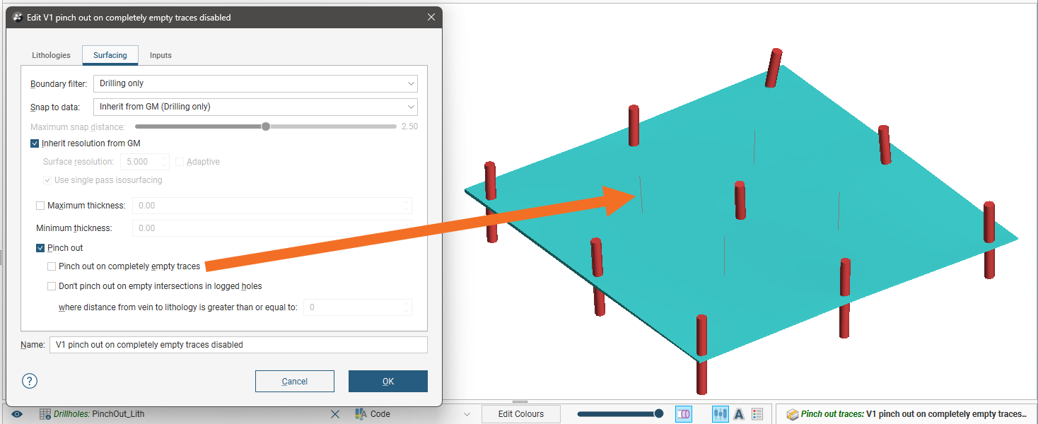

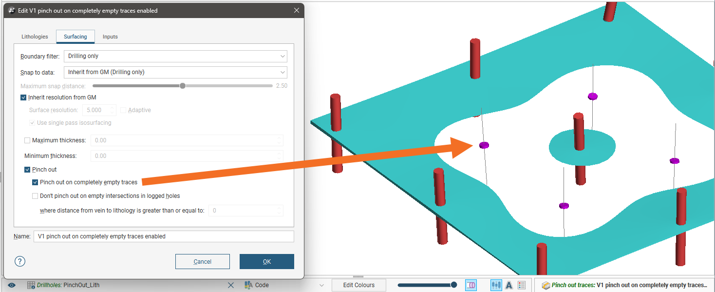

Pinch Out on Completely Empty Traces
The Pinch out on completely empty traces setting relates to whether or not pinch outs are created for boreholes where no lithology data has been logged, neither vein nor background lithology. Enabling the setting results in pinch outs being created where such traces intersect the vein footwall and/or hangingwall surfaces, resulting in a final vein that is empty around those pinch outs.
To illustrate the effect of this setting, we have an artificial dataset that has four traces with no logged data. When Pinch out on completely empty traces is disabled, the vein does not pinch out where it there are no actual vein segments:
When the option is enabled, however, pinch outs (pink) are created around the empty traces and the vein pinches out around them:

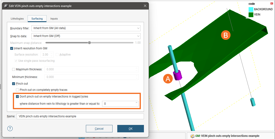

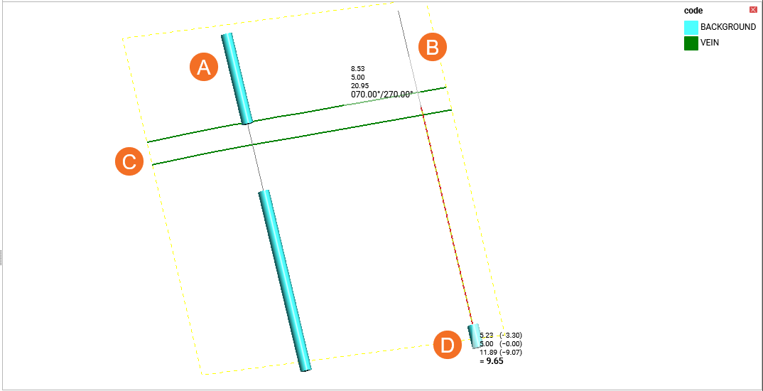

Don’t Pinch Out on Empty Intersections in Logged Holes

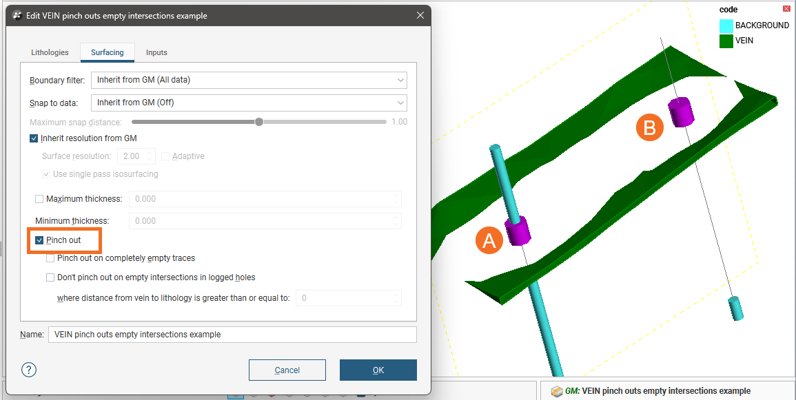

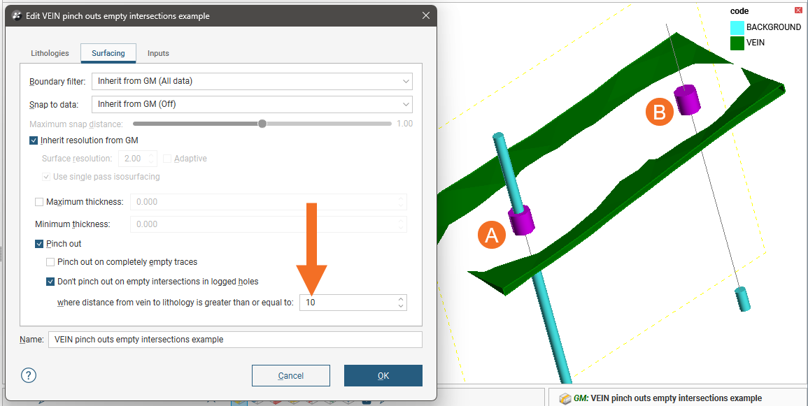

The Don’t pinch out on empty intersections in logged holes setting relates to whether or not pinch outs are created for boreholes that have data logged that intersects the vein’s hangingwall and/or footwall surfaces. Whether or not the logged lithology ‘intersects’ the hangingwall and/or footwall surfaces is determined by a distance parameter; if there is logged data but it fall outside the distance specified, the intersection is regarded as ‘empty’ and no pinch out will be created.
Again, we have an artificial dataset to illustrate the effect of this setting. Here there are two boreholes (A and B) that do not contain the vein lithology; they do, however, contain other lithologies and so are regarded as logged. The scene is sliced and so the lines (C) show where the vein’s hangingwall and footwall surfaces intersect each borehole. We can see that A has a logged interval that directly contacts the hangingwall surface, whereas the logged interval (D) in borehole B is quite distant from the footwall surface:
Enabling only the Pinch out setting creates pinch outs where both boreholes intersect the vein, which is as expected:
Enabling Don’t pinch out on empty intersections in logged holes results in the vein pinching out where it intersects borehole A, but it does not pinch out for borehole B:
This is because the interval in borehole B is outside the distance specified and so the intersection between the vein and borehole B is regarded as empty.
Increasing the distance value results in the vein also pinching out where it intersects borehole B:
The distance value can be used to indicate how far away logged data can be while still informing the vein surface. If, however, it does not seem geologically reasonable to adjust vein pinch out behaviour in this way, an alternative is to manually exclude some pinch out segments.

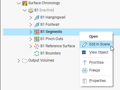

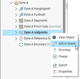

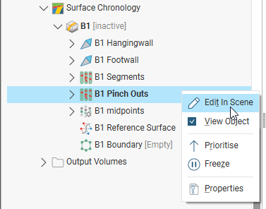

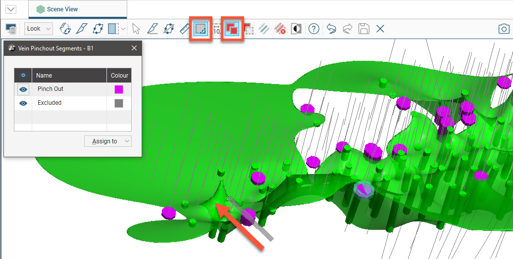

You can change how much a vein pinches out by manually excluding some pinch out segments. To do this, right-click on the pinch out segments (
) in the project tree and select Edit in Scene:

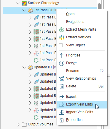

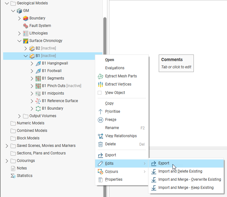

If you manually edit pinch outs, you can export the edits for use in other veins and models in the current project or in other projects. The edits are exported in a text file. See Exporting and Importing Pinch Out, Segment and Midpoint Edits for more information.

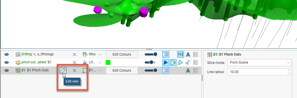

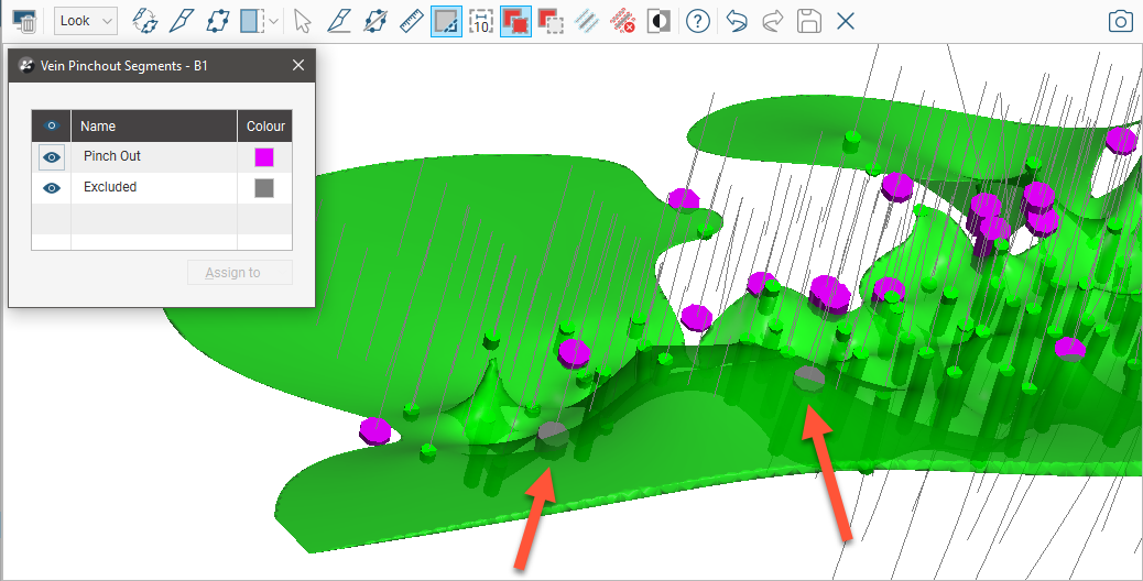

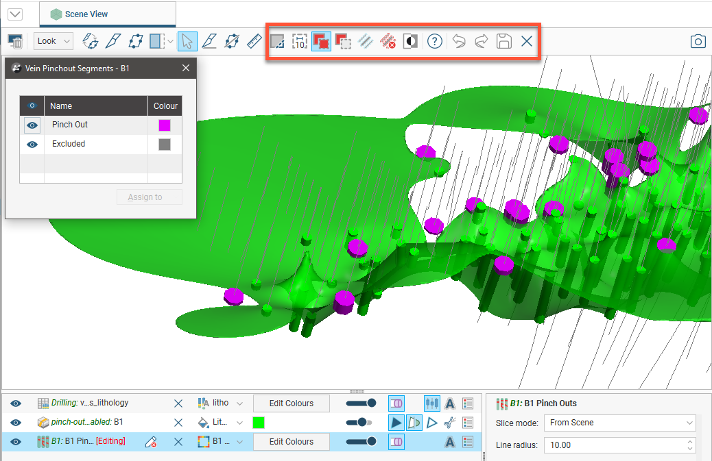

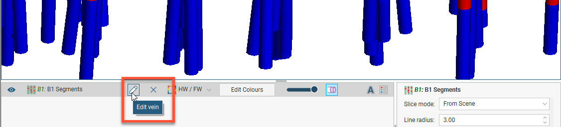

You can also add the pinch out segments to the scene and click the Edit button (
) in the shape list:

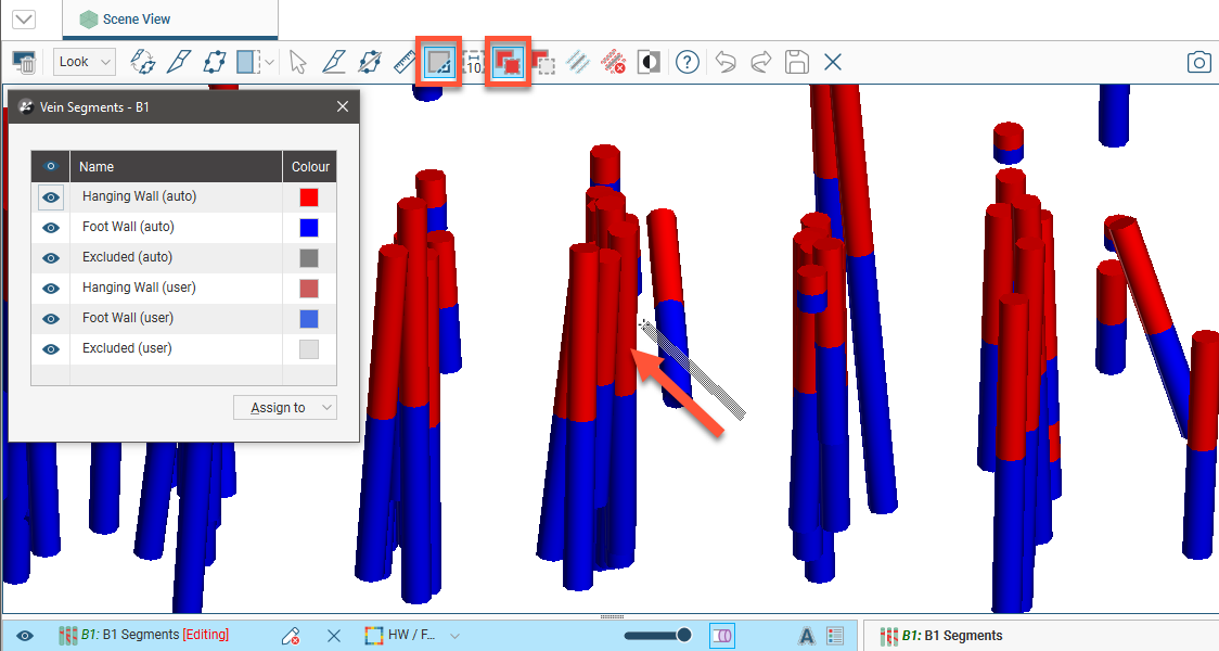

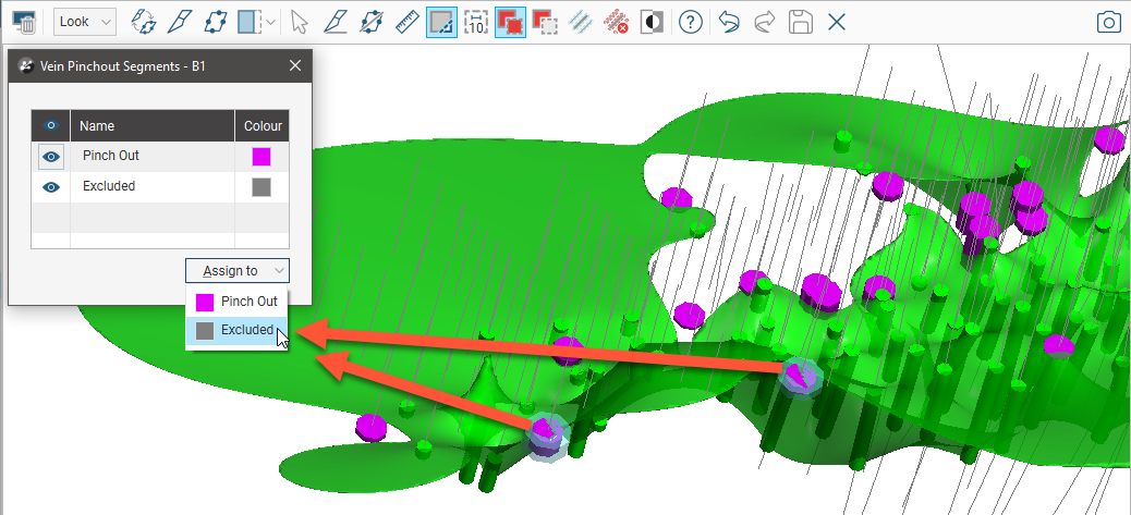

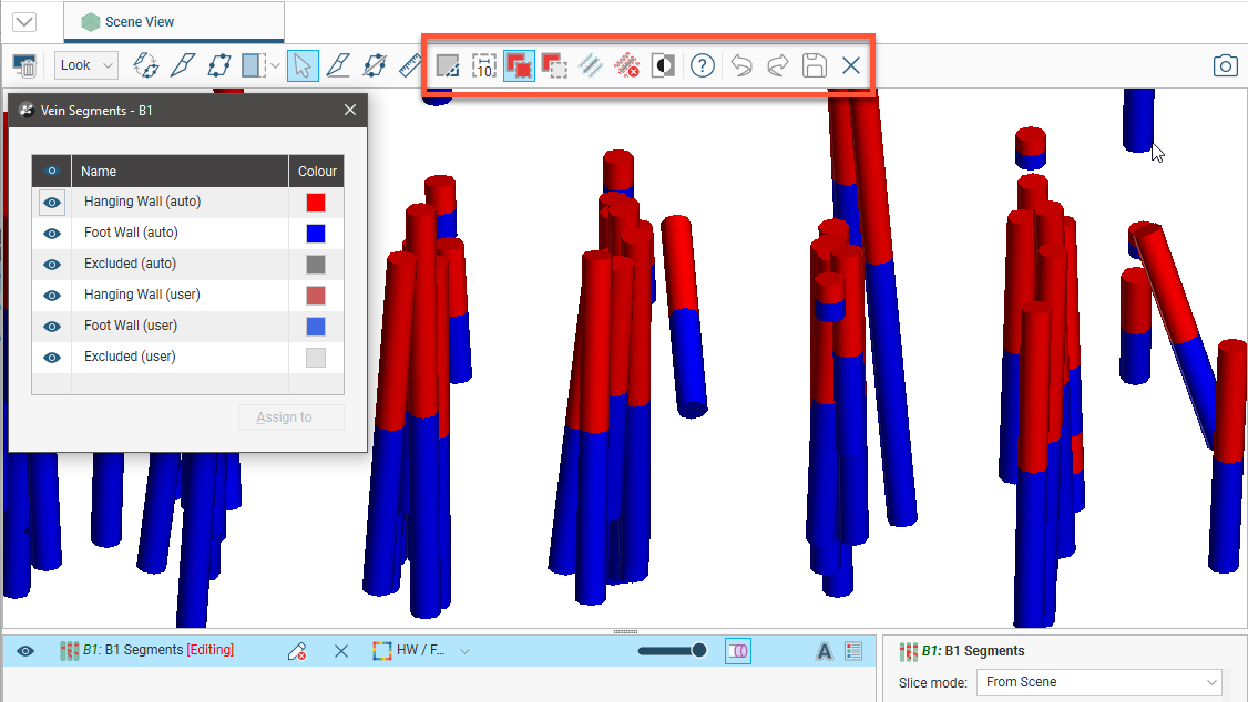

The Vein Pinchout Segments will appear, along with a set of tools for selecting segments in the scene:
To select segments, click on the Select segments button (
) and click the Add segments button (
). In the scene, draw a line across each segment you wish to select:
Note that the segments displayed in the scene below are the pinch out segments rather than the borehole segments shown in earlier scenes. The grey segments are excluded and the currently selected segment is highlighted in the scene.
Selected segments are highlighted in the scene. If you accidentally select the wrong segment, either:
- Click the Remove segments tool (
) and draw across the point once again. - Hold the Ctrl key while drawing across the point.
You can also:
- Select all visible segments by clicking on the Select all tool (
) or by pressing Ctrl+A. - Clear all selected segments by clicking on the Clear selection tool (
) or by pressing Ctrl+Shift+A. - Swap the selected segments for the unselected segments by clicking on the Invert selection tool (
) or by pressing Ctrl+I.

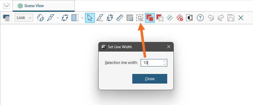

To change the width of the line used to select segments, click on the Change line width button (
) and enter a new value. You can keep the Set Line Width window open while you select intervals so you can change the line width as required:
Note that the current line width is indicated by the Change line width button.

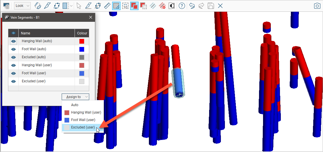

When you have selected at least one segment, click on the Assign to button, then select the category you want to assign the selected segments to:

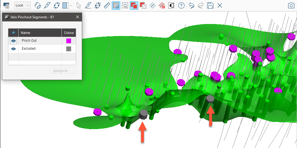

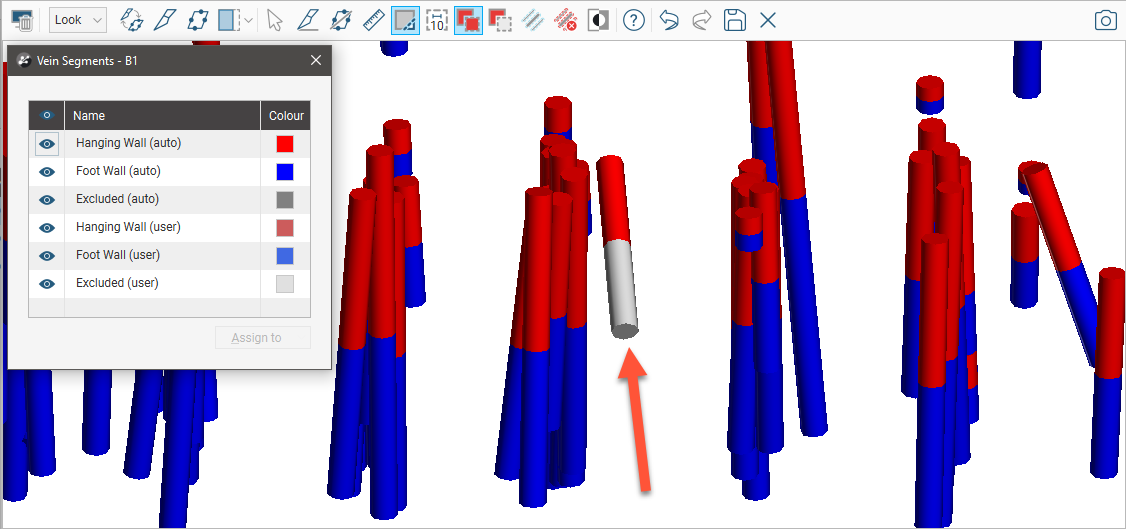

The selected segments will be updated to reflect the change:
Click the Save button (
) to view the effect of the excluded pinch out segments on the vein. In this example, excluding the two segments results in the vein terminating at the boundary of the geological model:

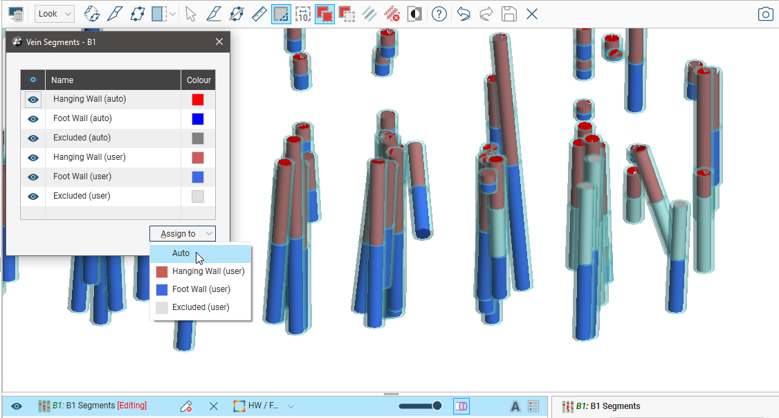

When a vein has been created from contact points, you can change the vein segment settings by double-clicking on the vein segments object (
) in the project tree. This opens the Edit Vein window:
Settings in this window that change how contact points are generated from lithology data are:

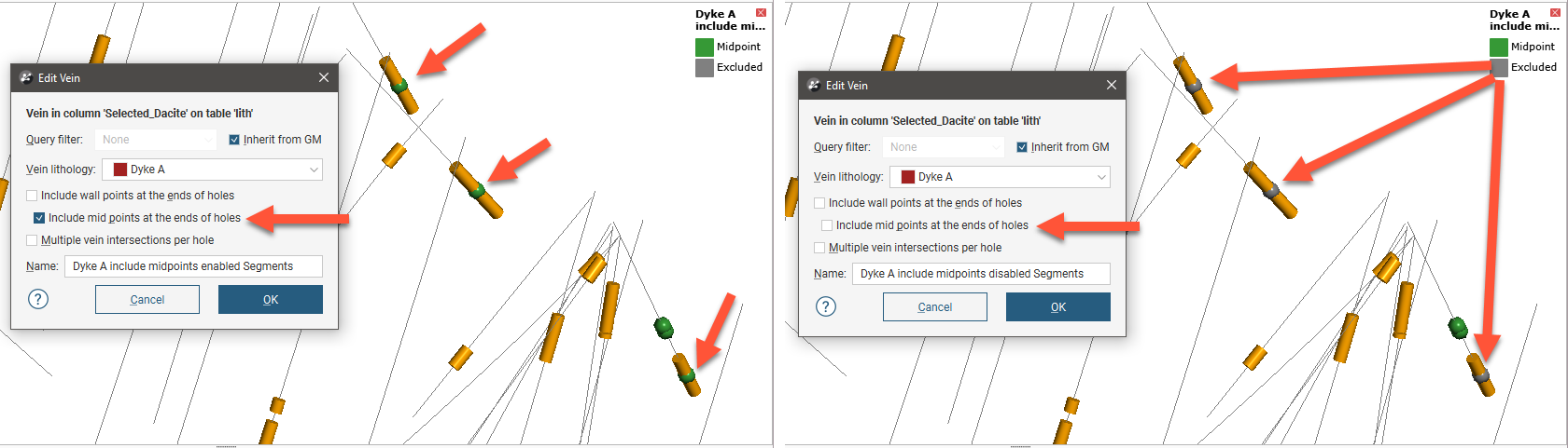

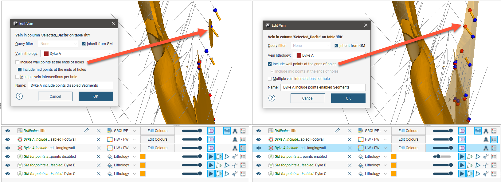

Include Wall Points/Midpoints at Ends of Holes

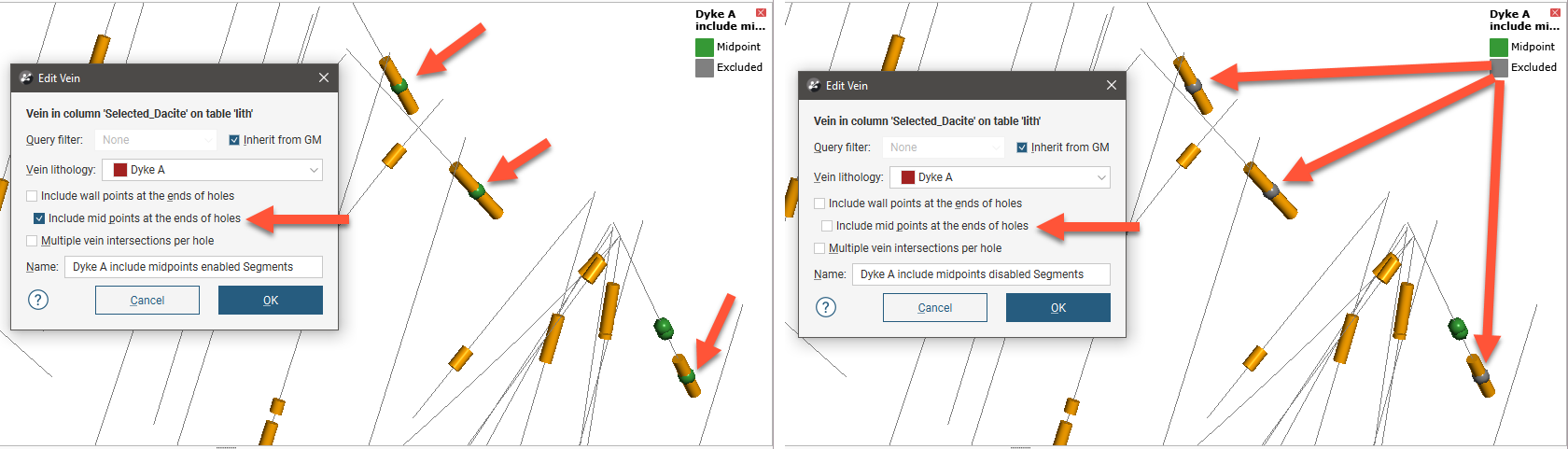

The Include wall points at the ends of holes setting determines whether or not hangingwall and footwall contact points are generated for segments at the ends of boreholes. If this setting is disabled, a contact point will not be created when a borehole ends in the vein lithology. The related setting, Include mid points at the ends of holes, determines whether or not midpoints are generated for segments at the ends of boreholes. Such midpoints could be distant from the centre of the vein structure and would, therefore, result in localised distortion of the reference plane.
You can see the effects of the Include wall points at the ends of holes setting here where the hangingwall (red) and footwall (blue) points are displayed alongside the vein lithology intervals (in yellow), the borehole traces and the resulting vein surface. In the first example, Include wall points at the ends of holes is disabled. Hangingwall points are not generated at the ends of the boreholes where indicated and so there isn’t enough data to build the vein surface:
In the second example, Include wall points at the ends of holes is enabled, hangingwall contact points are created and the vein surface that results is much more realistic.
Whether to enable or disable Include wall points at the ends of holes depends on your data. Consider disabling Include wall points at the ends of holes if:
- A vein is being prematurely truncated
- A vein is blowing out unrealistically
The Include mid points at the ends of holes affects how the midpoints are generated when vein lithology segments occur at the start or end of boreholes. When Include mid points at the ends of holes is disabled, the midpoints are still generated but are automatically excluded. In these examples, there are three segments where boreholes end with the vein lithology. On the left, Include mid points at the ends of holes is enabled and there are no excluded midpoints; all the midpoints are shown in green.
On the right, midpoints at the ends of holes are not included and so are shown in grey (Excluded).

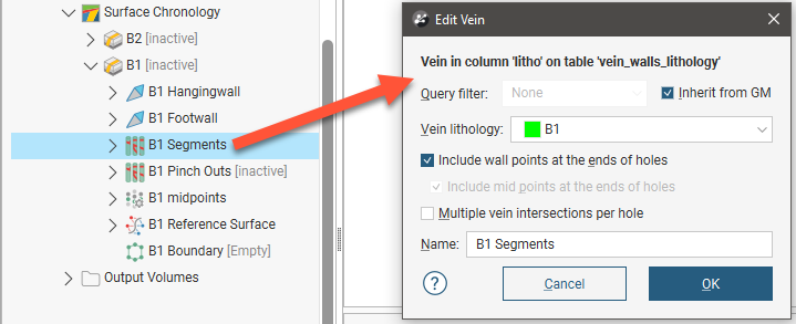

Consider disabling the Include mid points at the ends of holes setting if your reference surface is “wiggly” or otherwise showing unexpected distortions.

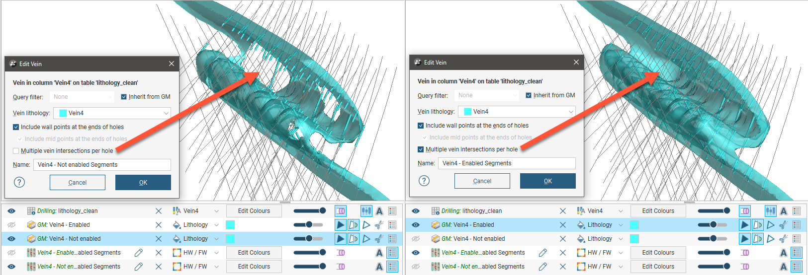

Multiple Vein Intersections Per Hole
The Multiple vein intersections per hole setting is useful situations where boreholes might pass in and out of the same vein unit multiple times. Here a folded vein is shown with Multiple vein intersections per hole disabled (left) and enabled (right):
Note that you may also need to edit the vein’s reference surface and the vein segments to achieve a realistic surface. See Editing the Reference Surface and Editing Vein Segment Orientations below.
If you need to change the orientation of individual vein segments, e.g. for curved veins, you can do this by right-clicking on the vein segments object (
) in the project tree and selecting Edit In Scene.
If you manually edit vein segments, you can export the edits for use in other veins and models in the current project or in other projects. The edits are exported in a text file. See Exporting and Importing Pinch Out, Segment and Midpoint Edits for more information.
If the vein segments object is already in the scene, you can edit it by clicking the Edit button (
The Vein Segments window will appear, along with a set of tools for selecting segments in the scene:
You can also:
The categories shown for vein segments are:
- Hanging Wall (auto), Foot Wall (auto) and Excluded (auto). These are the categories Leapfrog Works assigned segments to when the vein was created.
- Hanging Wall (user), Foot Wall (user) and Excluded (user). Segments assigned to these categories have been manually assigned to these categories. These are the categories you can assign selected segments to.
Assigning a segment to the Auto category sets it to the category Leapfrog Works automatically assigned it to when the vein was created, which has the effect of undoing any edits made previously.
You can change the colours if you wish, but note that when the segments are displayed in the scene, the default colours make it easy to differentiate between automatically-categorised segments and those that have been edited.
) to view the effect of the changes.
To revert to the categories assigned by Leapfrog Works when the vein was created, select some segments and then assign them to the Auto category:

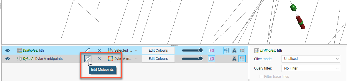

You can manually select vein midpoints and set them to excluded from processing. To do this, right-click on the vein midpoints object (
If you manually edit midpoints, you can export the edits for use in other veins and models in the current project or in other projects. The edits are exported in a text file. See Exporting and Importing Pinch Out, Segment and Midpoint Edits for more information.
If the vein midpoints object is already in the scene, you can edit it by clicking the Edit button (
The Vein Segment Midpoints window will appear, along with a set of tools for selecting midpoints in the scene:
The process is similar to editing vein segments, as described in Editing Vein Segment Orientations above. The categories shown for midpoints are:
- Midpoint (auto) and Excluded (auto). These are the categories Leapfrog Works assigned midpoints to when the vein was created. If Include mid points at the ends of holes is disabled, some midpoints may be automatically categorised as Excluded (auto), which is the case for three of the midpoints shown above.
- Midpoint (user) and Excluded (user). Midpoints assigned to these categories have been manually assigned to these categories. These are the categories you can assign selected points to.
Assigning a midpoint to the Auto category sets it to the category Leapfrog Works automatically assigned it to when the vein was created, which has the effect of undoing any edits made previously.
A vein includes a reference surface (
) that represents the trend or form of the vein. When the vein is derived from drilling data, this is initially calculated as the best fit surface using the midpoints and the hangingwall and footwall surfaces. When derived from data other than drilling data, a planar reference surface is initially used. Whatever data source the vein is derived from, the reference surface setting can be changed to be a curved reference surface, a planar reference surface or another mesh in the project.
Double-click on the reference surface in the project tree; this opens the Edit Vein Reference Surface window and you can see what option is being used for the surface. In this example, the B1 vein has been created from lithology data and so it has a curved reference surface and the midpoints for the vein lithology are used as Input values:
Each option is described below:
There is a great deal of flexibility in Leapfrog Works for refining the reference surface, including the ability to created a surface in the Meshes folder from vein midpoints. A possible workflow is to:

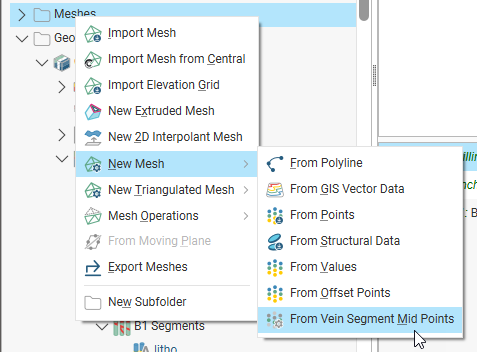

- Create an initial vein in the geological model.
- Use the midpoints from this initial vein to create a mesh in the Meshes folder:
- Refine the mesh using the Meshes folder tools.
See the Interpolated Meshes topic for information on creating and refining and interpolated meshes.
- Use the mesh as a custom reference surface.

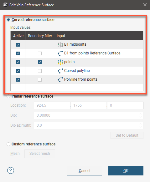

Curved Reference Surface
The Curved reference surface option is the default for veins created from lithology data and the objects used to build the reference surface are shown in the Input values part of the Edit Vein Reference Surface window:
You can enable or disable the different data objects to see their effects on the vein by ticking and unticking the Active box, then clicking OK to reprocess the vein.
The Boundary filter setting for each object determines whether or not the data that lies outside the reference surface’s boundary is filtered.
- Tick Boundary filter so that the surface is only influenced by the data that falls inside the reference surface’s boundary.
- Untick Boundary filter if you want the surface to be influenced by the data both inside and outside the reference surface’s boundary.
Boundary filtering for the midpoints used to create a curved reference is controlled by the setting for the vein itself. See Boundary Filtering earlier in this topic for more information.
The Curved reference surface option is the default for veins created from lithology data, whereas the Planar reference surface option is the default for veins created from other types of data. In order for a vein created from data other than lithology data to use a curved reference surface, other data must be added to it. To add data, right-click on the reference surface in the project tree and select Add or Edit.
Using the Add option, you can add points data, GIS data or polylines to the surface. Using the Edit option, you can add a polyline to the reference surface, but its editing options are limited in that you can not add tangents or normals to the polyline.
Planar Reference Surface
Veins created from objects other than lithology data use a planar reference surface by default. To edit a planar reference surface, double-click on the reference surface in the project tree. This will open the Edit Vein Reference Surface window and display controls in the scene for adjusting the plane.
These handles work in the same manner as the moving plane controls, as described in The Moving Plane.
To use a planar reference surface for a vein created from lithology data, double-click on the reference surface to open the Edit Vein Reference Surface window, then select the Planar reference surface option. Adjust the plane in the scene, then click OK to reprocess the vein.
Custom Reference Surface
If you wish to use another surface in the project as a reference surface, double-click on the reference surface to open the Edit Vein Reference Surface window. Enable the Custom reference surface option, then select the mesh from those available in the project:
This option is useful if you wish to use an existing surface, such as the foot- or hanging-wall surface of an adjacent vein, as your vein’s custom reference surface, or if you need to use a fault surface to influence the trend of the vein. You can create and use your own custom vein surface, if needed.
Here, a thin folded layer has been modelled using a vein, created from a base lithology using sparse drilling data. The vein does not conform to known geology, crossing other modelled surfaces.
When the reference surface is edited to use a Custom reference surface with one of the existing surfaces in the model selected, the vein is modelled in a way that is more geologically reasonable:

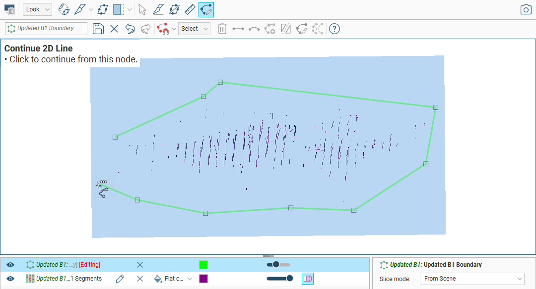

Editing the Boundary with a Polyline
To edit the boundary using a polyline, right-click on it in the project tree and select Edit With Polyline. The current vein boundary will appear in the scene and the polyline editor will open. Begin drawing the new boundary, as described in Using the Polyline Editor, ensuring that the polyline drawn closes and does not intersect itself.
When you save the boundary, the vein will be updated to reflect the changes made. If you want to revert to the original boundary, right-click on the boundary object (
) and select Delete Polyline.

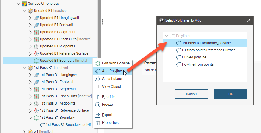

Adding a Polyline to the Boundary
You can also add an existing polyline to the vein boundary. To do this, right-click on the vein’s boundary in the project tree and select Add Polyline. In the window that appears, select the polyline you wish to use:
If you have edited a vein’s boundary with a polyline, you can use that polyline for other vein boundaries. To do this, right-click on the vein that has been edited and share the polyline; a copy will be saved to the Polylines folder which will be linked to from the vein. You can then use the polyline for other vein boundaries using the Add Polyline option.
If you have made edits to vein pinch outs, segments, and midpoints, you can export them for use in other veins and models in the current project or in other projects. The edits are exported in a text file.
To export a list of vein edits, right-click on the vein in the project tree and select Edits > Export:
If the vein has no manual edits, a message will be displayed saying so. Otherwise, you will be prompted to save the file on your local hard drive.
To import the vein edits to a different vein, right-click on that vein in the project tree and select Edit. Each of the Import options handles vein edits in the file and vein edits in the project in different ways.
- Import and Delete Existing. This option discards any edits made in the project and uses those in the file, even if the file does not contain edits that match those in the project. If you do not wish to keep any of your existing vein edits and will rely solely on those made in the file, choose this option.
- Import and Merge - Overwrite Existing. This option prioritises edits in the file over those in the project. Edits that are in the project but not in the file will be retained.
- Import and Merge - Keep Existing. This option prioritises edits in the project over those in the file. Edits that are in the file but not in the project will be added to the project.
For each option, if there are edits in the file that do not match the vein in the project, a message will be displayed. A text file listing the errors will be saved on your local hard drive.
