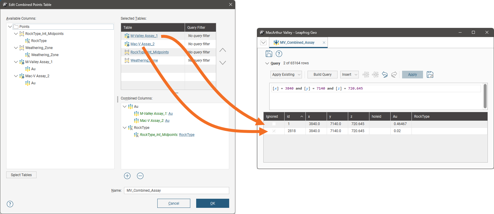

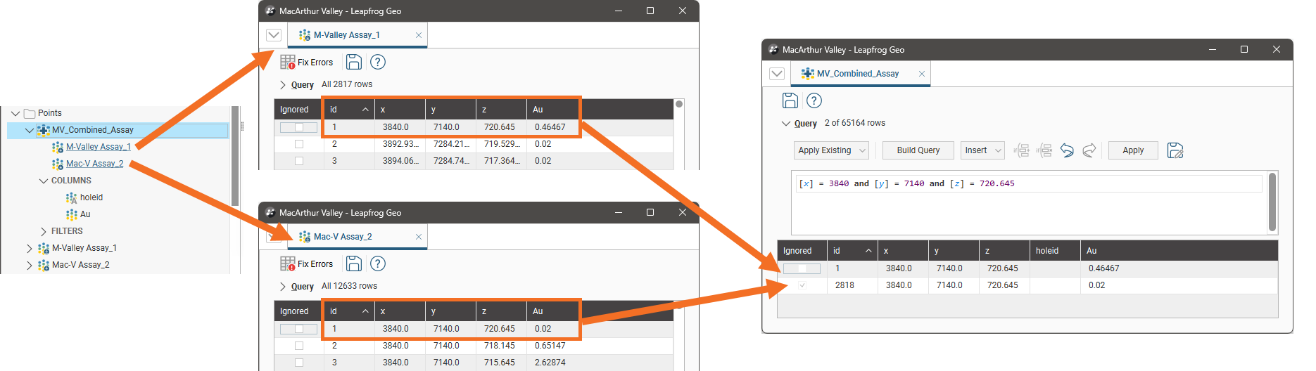

This example shows how the data from two points tables is used in a combined points table. The XYZ coordinates for both assays are the same for row id 1, but have different Au assay values.
The information from each source table is used to build the combined points table, with data rows in lower priority tables marked as ignored when conflicted. For example, the two rows shown here in the combined points table MV_Combined_Assay have the same XYZ coordinates. The row with the Au value of 0.464672 is from the table M-Valley Assay_1, whereas the row with the Au value of 0.02 is from the table Mac-V Assay_2:
The row with id 2818 is marked as ignored because it is from the assay table that was given a lower priority when combining the two tables. If the table M-Valley_Assay_2 was given the higher priority, the row with id 1 would be ignored.

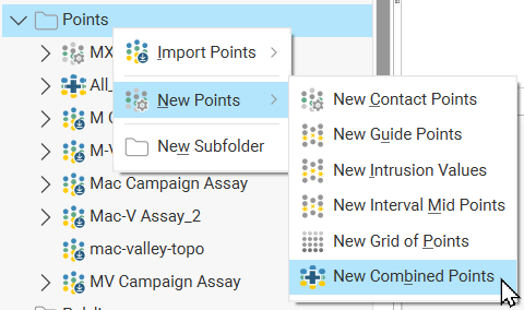

To create a combined points table, right-click on the Points folder and select New Points > New Combined Points:

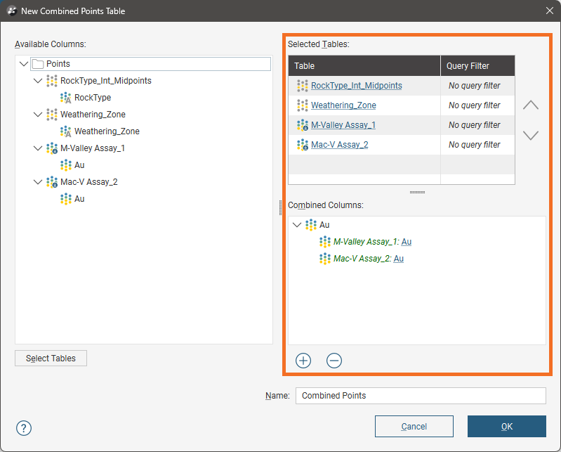

In the window that appears, all tables with suitable data columns are displayed in the Available tables list. Select those you wish to use in the combined points table and move them into the Selected tables list:
Click OK.
In the New Combined Points Table window, the selected tables are displayed, along with the data columns available for use in the combined points table. The Combined Columns list shows the columns that will result:
Depending on what columns are in the source tables, some columns from the selected tables list may be automatically added to the Combined Columns list. If you wish to add another column to the Combined Columns list, either:
- Drag it from the Available Columns list into the Combined Columns list or
- Click the Add button (
) to move columns into the Combined Columns list.

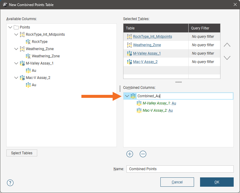

) to open the Select Columns window. - Rename a combined column. Double-click on it and enter the new name:
Once you have added the data columns you wish to include, set a Name for the new combined points table, then click OK. The new combined points table will be created and added to the project tree.

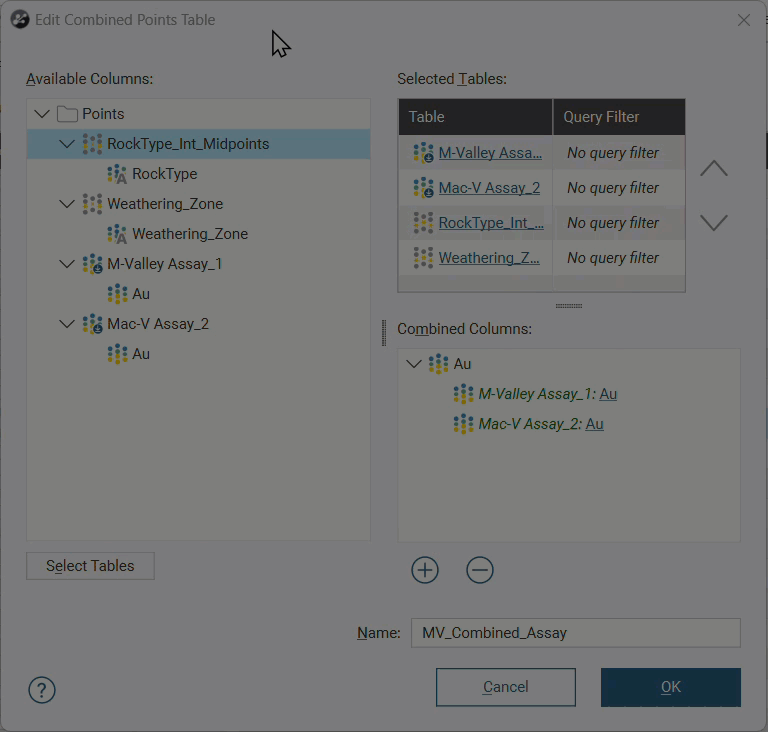

To edit a combined points table, right-click on the table in the project tree and select Edit Combined Points. This opens the Edit Combined Points Table window, which is similar to the New Combined Points Table window. In this window, you can:
- Use the arrows in the Selected Tables list to change the priority of the tables.
- Add more tables to the Selected Tables list. To do this, click the Select Tables button, then choose from those in the project.
- Add more columns to the combined points table. Drag a column from the Available columns list into the Combined Columns list or click the Add button (
) to open the Select Columns window. - Rename a combined column. Double-click on it and enter the new name.
