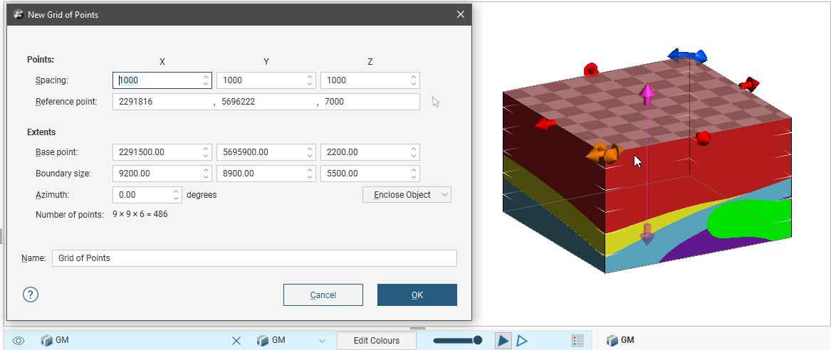

To create a grid of points, right-click on the Points folder and select New Grid of Points. The New Grid of Points window will appear, together with controls in the scene that will help in setting the grid’s boundary:
Set the Spacing and Reference Point, which will control the number of points in the grid. You can set the Reference Point by clicking in the scene. To do this, first click on the Select button (
) for the Reference Point, then click in the scene. The coordinates in the scene will be copied to the New Grid of Points window.
For the Extents, you can select an object from the Enclose Object list to use the extents of another object in setting the grid’s extents. You can also change the size and position of the grid using the controls in the scene:
- The orange handle adjusts the Base Point.
- The red and pink handles adjust the Boundary Size.
- The blue handles adjust the Azimuth.
If you have set the extents from another object and then rotated the grid, you will need to reset the extents by selecting the object again from the Enclose Object list.
The Number of Points in the grid will be updated as you change settings in the New Grid of Points window. If the number of points will be very large, rendering of the grid in the scene will be disabled.
You will be able to change the settings in this window once the grid has been created.
Click OK to create the grid, which will appear in the Points folder. Double-click on the grid to change its settings.

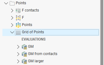

Once you have created the grid, you will be able to evaluate it against geological models, interpolants and distance functions in the project. Right-click on the grid and select Evaluations, then select from the models available. The evaluations will be shown in the project tree as part of the grid:
Evaluations will be exported with the grid. See Exporting a Grid of Points below.
