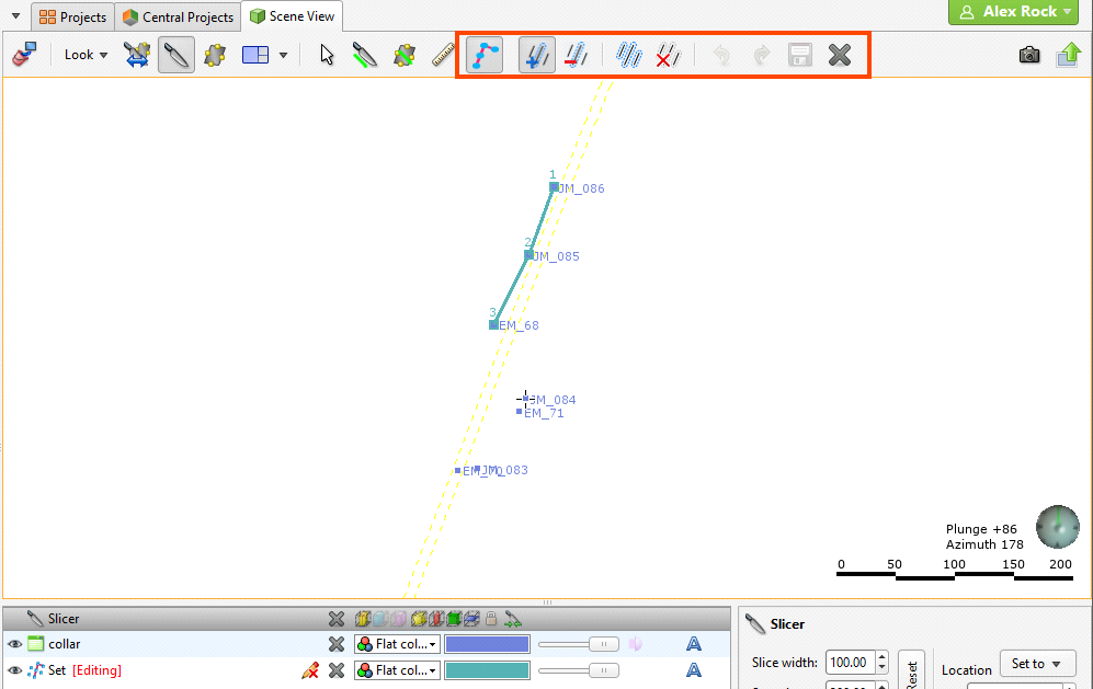

Next, right-click on the Borehole Correlation folder and select New Borehole Set. The new set will be created and opened, but is empty until you select collars. Click the Select Collars button (
) to switch to the scene and begin selecting collars:
The line in the scene indicates the order in which collars will appear in the set.
- To select collars one-by-one, click on the Select collar button (
), then on the Add collar button (
). Click on a collar to add it to the nearest end of the set. Hold down the Ctrl key while clicking to remove a collar from the set. - To temporarily switch to the Select button (
), hold down the Shift key while clicking. - To select all collars visible in the scene, click on the Select all collars button (
). This will select collars using the best fit line. - To remove a collar from the selection, click on the Remove collar button (
), then click on the collar you wish to remove from the set. - To clear the selection, click on the Clear collar selection button (

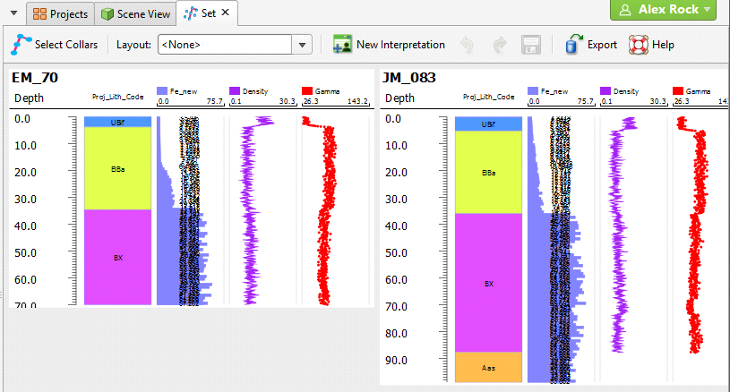

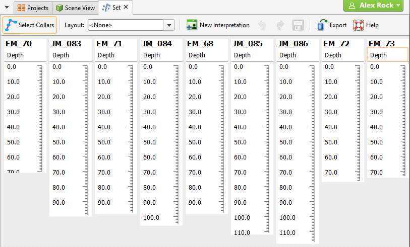

Once you have selected the required collars, click the Save button (
). The selected collars will be added to the set window:

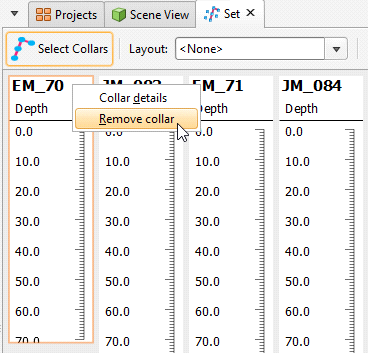

Remove collars from the correlation set by either editing the set in the scene, as described in Selecting Collars above, or right-click on a column and select Remove collar:

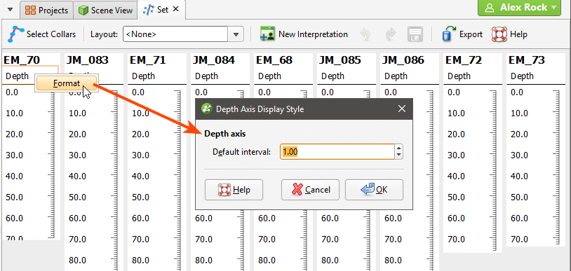

You can change how data is displayed by clicking on the column header, then selecting Format:
The options available depend on the type of column being formatted.

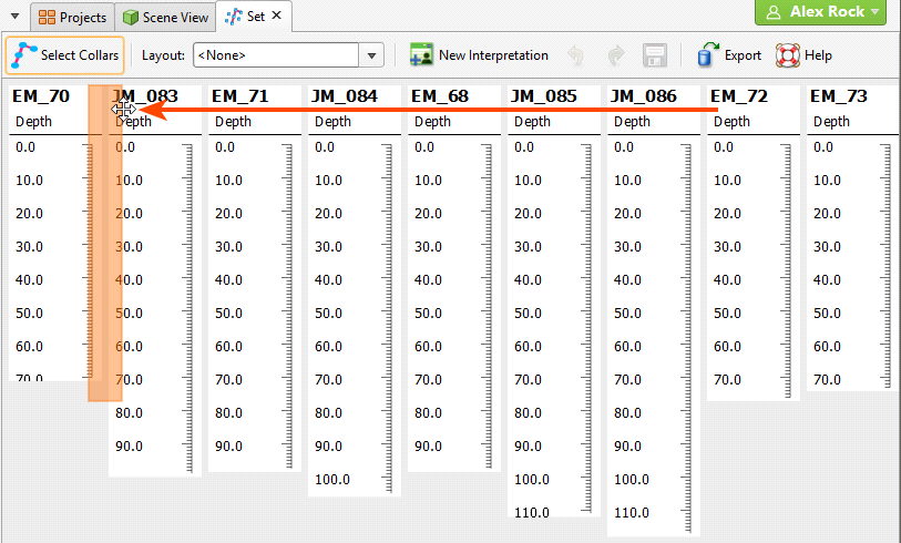

Click on boreholes and drag them in the correlation set window to change the order in which they appear:

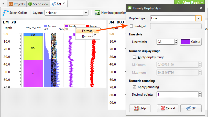

Add columns to the set by dragging them from the project tree into the set window. Here, four columns have been added to the set. From right to left they are a lithology column, an assay data column, a points data column formatted as a line and a points data column formatted as points:
You can then format the columns to get a better view of relationships between them. Format columns by right-clicking on their headers and selecting Format:

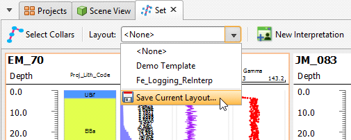

Once you have organised data columns and how they are displayed, you can save this information as a column layout that can be applied to other correlation sets. To do this, click the Layout button in the toolbar and select Save Current Layout from the list:
You will be prompted for a name. Click OK to save the layout, which can then be applied to other correlation sets by selecting the layout from the list.

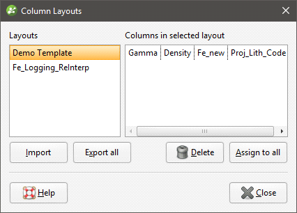

To view the layouts available in the project, right-click on the Borehole Correlation folder in the project tree and select Layout Manager. In the window that appears, you can easily see what columns are used for each layout and apply a layout to all correlation sets in a project:
You can also export column layouts for use in other projects and import layouts from other projects. Clicking Export all exports layouts as a text file.

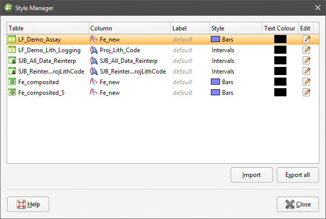

Managing Styles
The styles used to display data columns can also be exported to other projects. To view the styles used in the project, right-click on the Borehole Correlation folder in the project tree and select Style Manager:
Click Edit to change a style, which will update objects that use the selected style throughout the project.
Click Export all to export the styles in the project as a text file that can be imported into other projects.

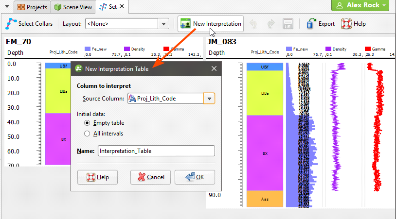

Interpretation Tables
- Create the table without using a base table. Each borehole will have an empty legend and a single empty interval from 0 to its maximum depth. Select <None> for the Source Column.

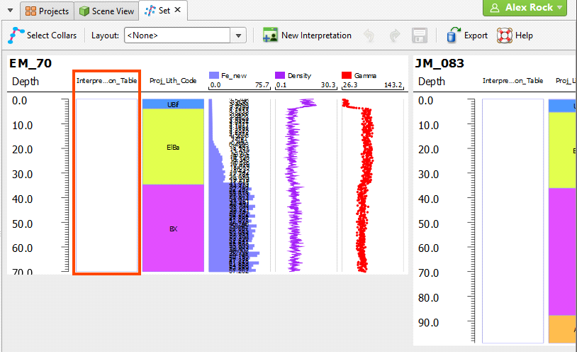

Click OK to create the table. A new interpretation table will be added to the project tree under the Boreholes object and the column will be added to the correlation set window:

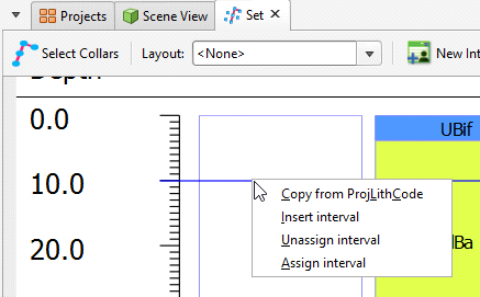

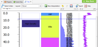

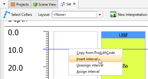

In the correlation set window, the blue line is used to create intervals. Position the blue line then right-click on it and select one of the options:

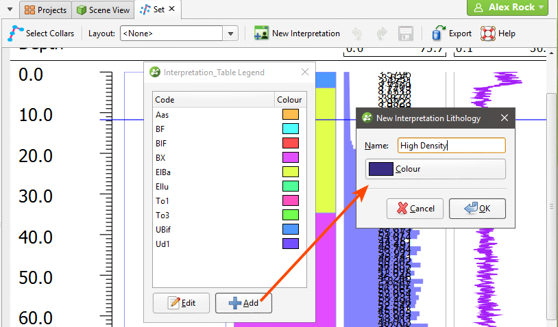

For example, to create an interval at the top of the table called “High Density”, move the blue line near to where you wish to create the interval. You do not need to be precise as you can adjust the interval once you have added it. Right-click and select Insert interval:
In the legend window, click the Add button and add a lithology called “High Density”:
Click OK, then select the new lithology to close the legend window. The new lithology has been assigned to the interval:

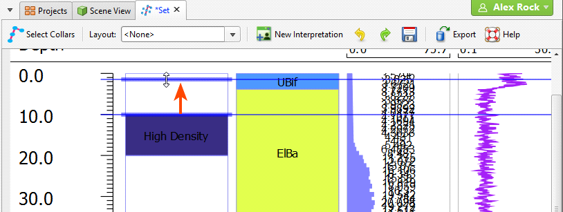

To resize the interval, click and drag the interval end points:
1. Click on the interval end point and drag it into position without releasing the mouse button.
2. Move the mouse across to the data point you wish to snap to.
3. Release the mouse.
