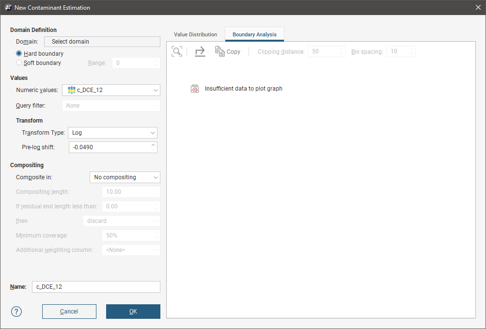

To create a contaminant estimation, right-click on the Estimation folder and select New Contaminant Estimation. The New Contaminant Estimation window will be displayed:
This window is divided into three parts:
- The domain definition
- The values used in the estimation and how they are composited
- The value distribution and boundary validation chart
Tools in the window allow you to validate the domain and select whether the boundary should be a hard or soft boundary.

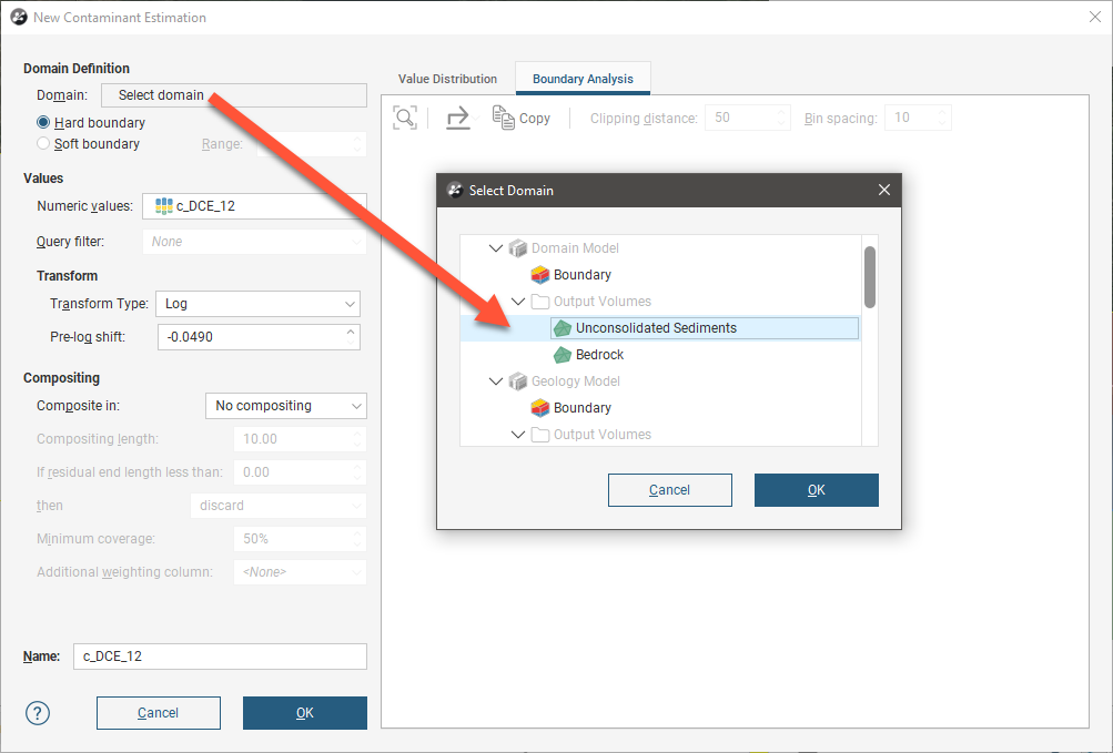

Click on the Select domain button to select from the suitable objects available in the project:
Any closed mesh can be selected to be used as the domain, including boundary objects and model volumes.
The selected domain can be used with a Hard boundary or Soft boundary. It is essential to the integrity of an estimate to select the type of boundary according to the real nature of the geology. This is discussed in more detail in Boundary Validation below.

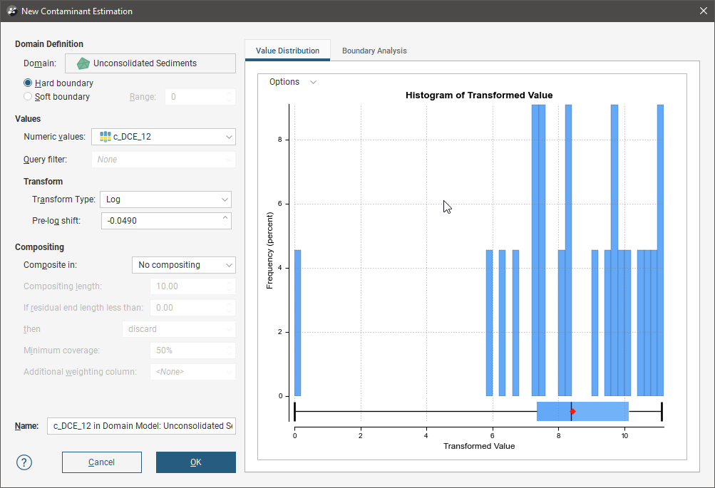

A histogram of the sample count for each bin is included, so you can ignore things like an anomalous spike in mean value associated with a very small sample count. Adjust the size of the horizontal axis bins using the Bin spacing setting.
The pale blue bars show the sample count for each bin, and the red dotted line segment plot shows the mean value for the bin. The position of the Hard boundary is marked with a solid black vertical line. When a Soft boundary is selected, a vertical dotted blue line appears to show what values will be included, based on the Range setting. You can click on the soft boundary line and drag it to adjust the range.
When the mean value line segment plot shows a sharp change at the boundary, a hard boundary may be appropriate. Click on points in the line segment plot to see statistics relating to the selected point.

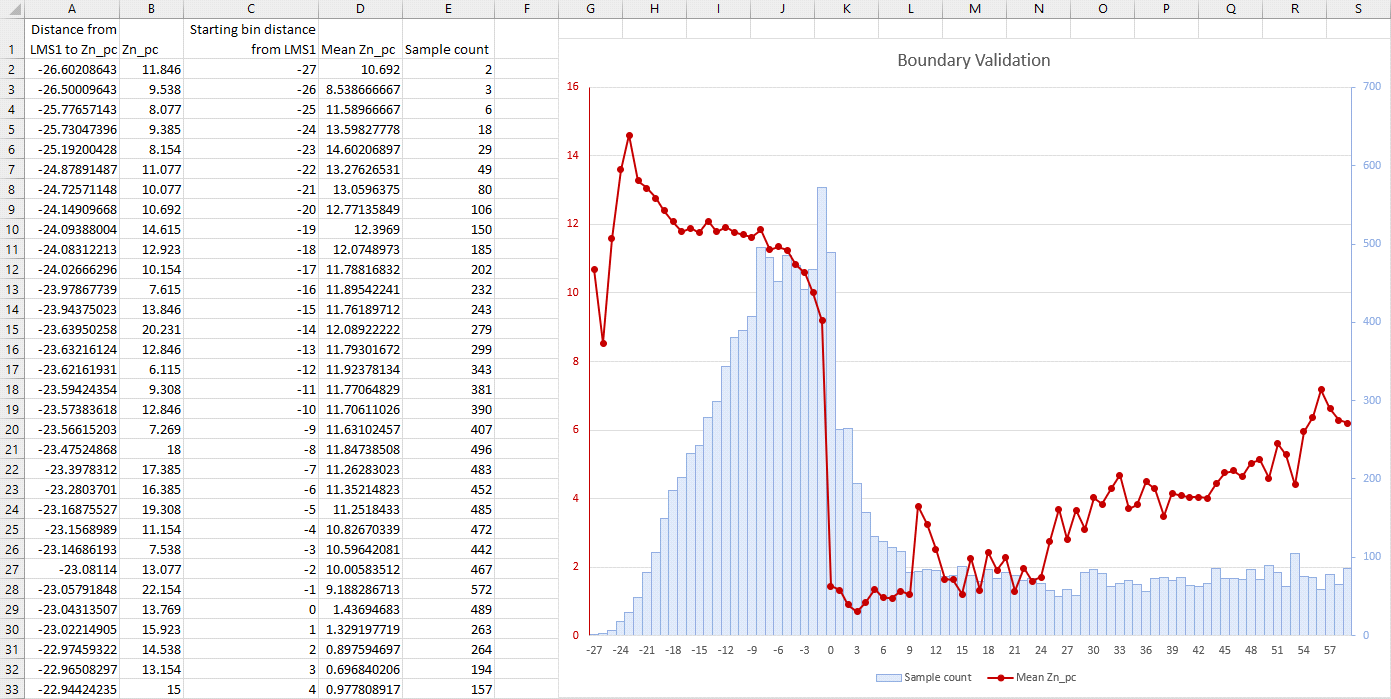

You can export the graph for use in external reports and other documents. Select the export button (
) to see two options:
- The Export graph image option saves a PDF, SVG or PNG file of the chart.
- The Export data option saves a CSV file containing the data so it can be reproduced and reformatted in a spreadsheet application.
Alternatively, you can choose the Copy option to save a copy of the graph image to the Windows clipboard for pasting into another application.
Note that when the Export data option is used, it is the last three columns (Starting bin distance from domain, Mean value and Sample count) that are required to reproduce the chart. The first two columns, Distance from domain to value column and the values column contain all the data points required to create a new chart with different bin spacing.

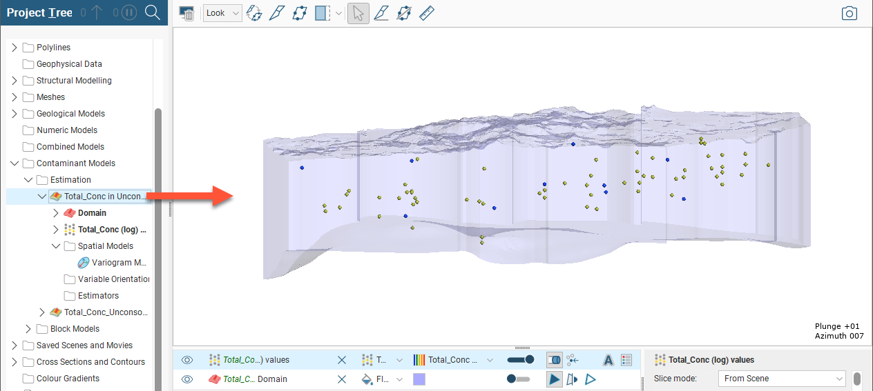

You can view a contaminant estimation by dragging it into the scene; this adds the Domain and Values objects to the scene.

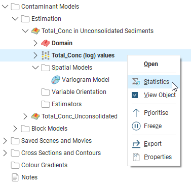

You can view statistics for the values used in the contaminant estimation by right-clicking on the numeric data object and selecting Statistics:
What happens when Statistics is selected depends on whether or not the data values were composited.
- If the values were composited, a popup window will offer the choice between:
- Univariate Graphs
- Compositing Comparison
- Compositing Interval Lengths
- If the values were not composited, a dockable tab window opens displaying the Univariate histogram of the point values.
