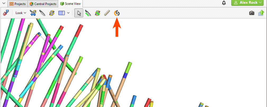

Before you can view core photos, you must first set up the Coreshed interface. To do this, right-click on the Boreholes object and select Add Core Photo Link. In the window that appears, select Coreshed and click OK. The Coreshed Photo Settings window will appear. Enter the information required and select whether each core photo will be opened in a separate browser Window or Tab.
Click OK to save the information. The Coreshed Photo Link button () will appear in the toolbar:

To view core photos, click on a borehole in the scene, then click on the Coreshed Photo Link button in the window that appears:

The Coreshed Photo Link button () in the toolbar allows you to view core photos in your browser in rapid succession. To do this, first make sure you are already logged into the database. Then click on the Coreshed Photo Link button () to enable the rapid viewing mode. Each time you click on an interval in the scene, the core photo link will open in your browser.
