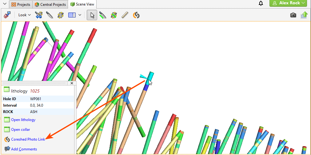

To view core photos, click on a borehole in the scene, then click on the Imago Link button in the window that appears:
Your browser will be launched and you will be prompted to log in to the Imago database. Remember to allow the browser to save the details so that you will not be prompted to log in each time you wish to view a photo.

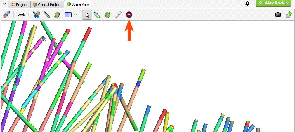

The Imago Link button (
) in the toolbar allows you to view core photos in your browser in rapid succession. To do this, first make sure you are already logged into the database. Then click on the Imago Link button (
) to enable the rapid viewing mode. Each time you click on an interval in the scene, the core photo link will open in your browser.
