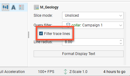

To apply a query filter to the scene, select the object in the shape list, then select the filter from the Query filter list in the shape properties panel:
For a borehole data table, this displays only the data selected by the filter. The trace lines remain displayed in the scene. To filter out the trace lines so they are not displayed in the scene, tick the Filter trace lines box:

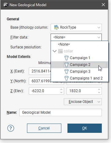

When creating or editing a model, you can use a query filter to filter the data used. For example, here you can use one of the query filters defined for the borehole data to create a new geological model from the borehole data for a specific drilling campaign:

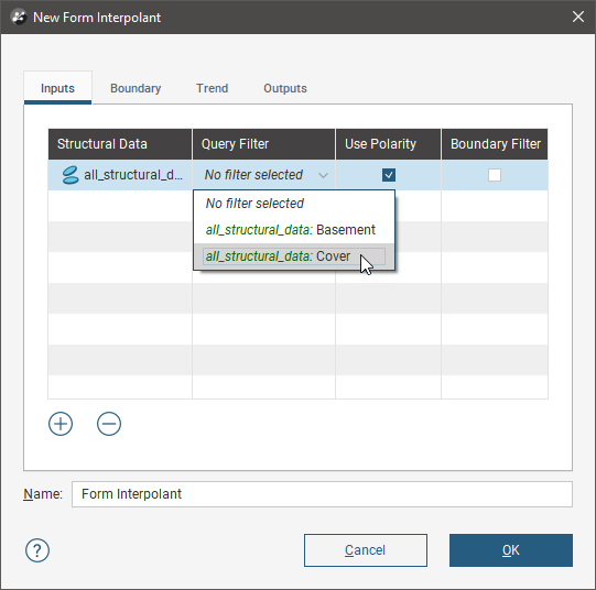

Here a structural data table is used to create a form interpolant. The query filters on the structural data table can be used to filter the data used in the interpolant:
It is also possible to change the filter used for a model after the model has been created. In a geological model, for example, you cannot change the data column used for the model, but you can edit the model and apply a new query filter to the data:
