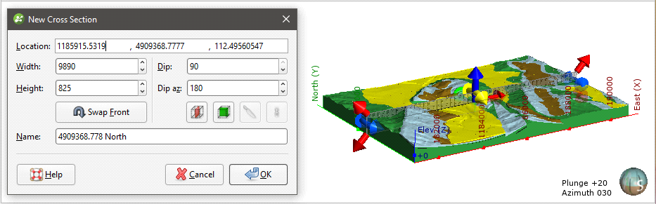

To create a cross section in the scene, add a model to the scene. Next, right-click on the Cross Sections and Contours folder and select New Cross Section. The New Cross Section window will appear, together with a section plane and controls in the scene that let you adjust the position of the section plane:
If the slicer is already in the scene when you select New Cross Section, the position of the slicer will be used to define the initial orientation of the section. This is an effective way of creating a section from the slicer: add the model to the scene, draw a slice and then create a cross section.
The front (F) and back (B) of the section plane is indicated in the scene. To swap the front and back, click the Swap Front button.
Use the handles in the scene to position the section plane. The handles work in the same manner as the moving plane controls, as described in The Moving Plane.

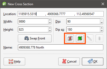

Two buttons in the New Cross Section window let you create a cross section that is aligned north-to-south () or east-to-west ():
The other two buttons are active when the slicer is in the scene. Clicking the Set section to slicer button () creates a cross section from the position of the slicer in the scene. When the Lock section to slicer button () is enabled, moving the position of the slicer will update the position of the cross section in the New Cross Section window.
