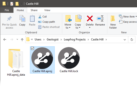

In both cases, the project files use the extension .aproj:
A project also has a project folder that contains information used by the project. This is named using the project name and the suffix .aproj_data.
Do not change the name of your .aproj_data folder or alter its contents. Doing so could render your project file unusable.
A .lock file is created when a project is opened. The .lock file protects the project from being moved while the project is open and from being opened by another instance of Leapfrog Energy, which can happen when projects are saved on shared network drives.

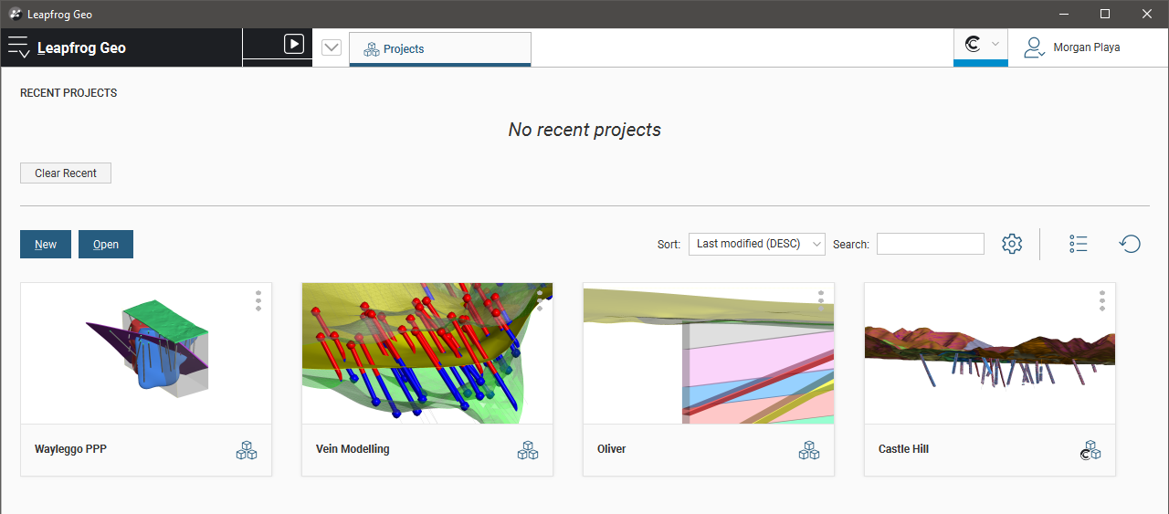

After you have signed in to Leapfrog Energy, the Leapfrog Energy main window will appear with the Projects tab displayed.

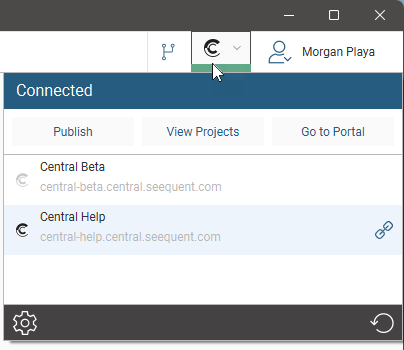

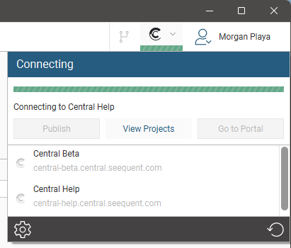

The Central servers you have access to via your Seequent ID are shown in the Central dropdown menu:
If a server you expect to see does not appear in the list, click the refresh button ().
The stripe under the Central menu shows your connection status. For example, the blue stripe above indicates Leapfrog Energy is not connected to a Central server. Here the stripe is green, indicating that Leapfrog Energy is connected to a Central server. Clicking on the menu displays more information, including an option to disconnect from the server ():
The stripe will be red when there is a connection error. Click on the menu to view more information.
The stripe will be orange if you are connected to a Central server as part of a trial programme.
More information is shown in the Central dropdown when Leapfrog Energy is connecting to a server or publishing an update to the server. In this example, Leapfrog Energy is in the process of connecting to a server:
When you first start Leapfrog Energy, the Projects tab lists all projects you have access to without connecting to a Central server. Here Morgan Playa has access to three local projects () and a local copy of a Central project (
You can view the list of projects as thumbnails, as shown above, or as a list. The list view shows more information about each project, such as the date the project was last modified, the file location for local projects and the Central server for local copies of Central projects.

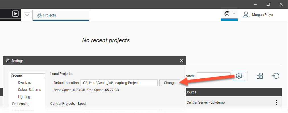

The folder the Projects tab searches for local projects can be changed by clicking on the Settings button:

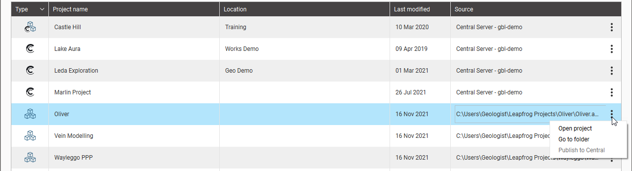

In both the thumbnail and the list views, click on the overflow menu () for more project-related options:

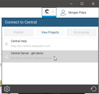

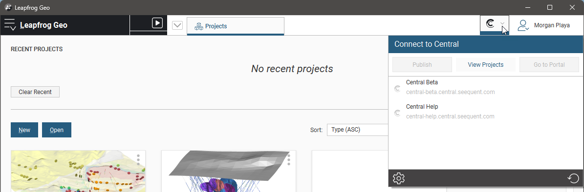

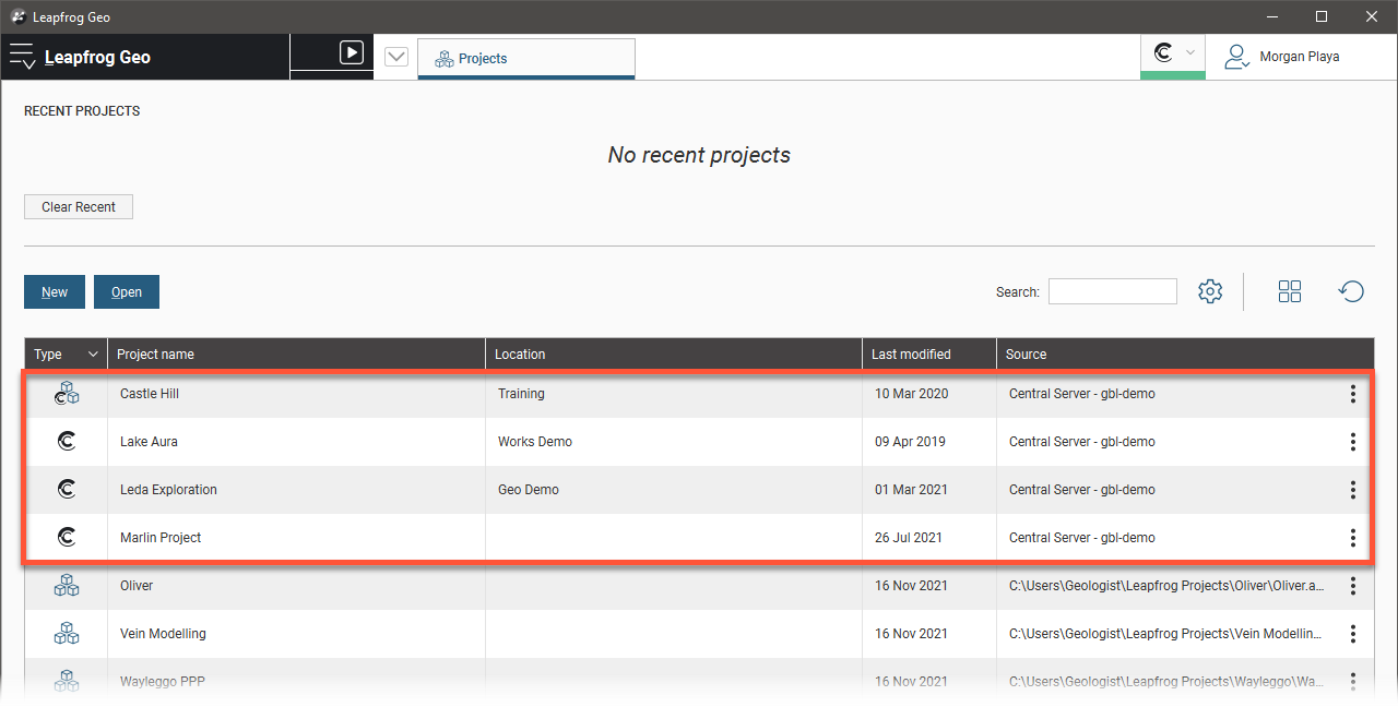

Connect to a Central server by clicking on the server button and selecting from those in the list:
Once connected, the list will be updated to show the Central projects available on that server, along with local projects:
Use the Search box to filter the list of projects.

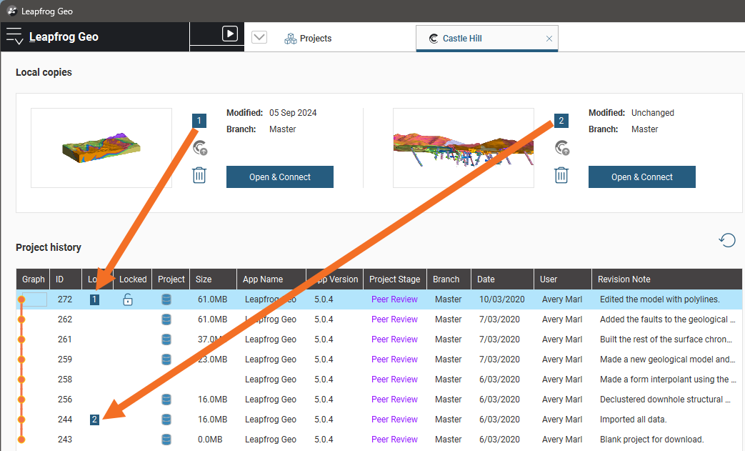

When not connected to a Central server, the list may show local copies of Central projects from multiple Central servers. Once connected to a server, only Central projects from that server are listed.
As with the local copies of the Central projects, clicking on the Central project will open its history.
A Central project is the history of a Leapfrog Energy project tracked through time, organised into revisions. In Leapfrog Energy, you can view the history of a Central project, and you can download local copies of these revisions and work on them in Leapfrog Energy. Here, the history of a Central project called “Castle Hill” is shown, and there are two local copies of that project, one that was modified on the 5th of September 2024 and one that has not been modified since it was downloaded (Unchanged):
Click on a thumbnail to open a project, which will automatically connect you to the project’s Central server.

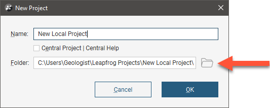

Creating New Projects
There are two ways to create a new Leapfrog Energy project. You can:
- Click the New button in the Projects tab
- Select New Project from the Leapfrog Energy menu

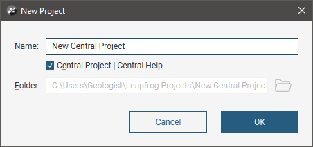

In the New Project window, enter a name for the new project and, if you want it to be a Central project, enable the Central Project option:
The Central Project option is only available when you are connected to a Central server. If you want to create a Central project on another server, you need to connect to that server first.
When you create a new Central project, a new project will be created on the Central server and a local copy will be created and saved in the location specified in the Settings window (Projects > Central Projects - Local). Leapfrog Energy will open that local copy and you can start working in it right away, and when you are ready to publish the first revision, initiate the process as described in Initiating a Publish Event.
To create a local project, disable the Central Project option. The project will be saved in the location specified, but if you want to change it, you can do so by clicking on the folder button and navigating to a different folder.
Leapfrog Energy will open the project and you can start working in it right away.

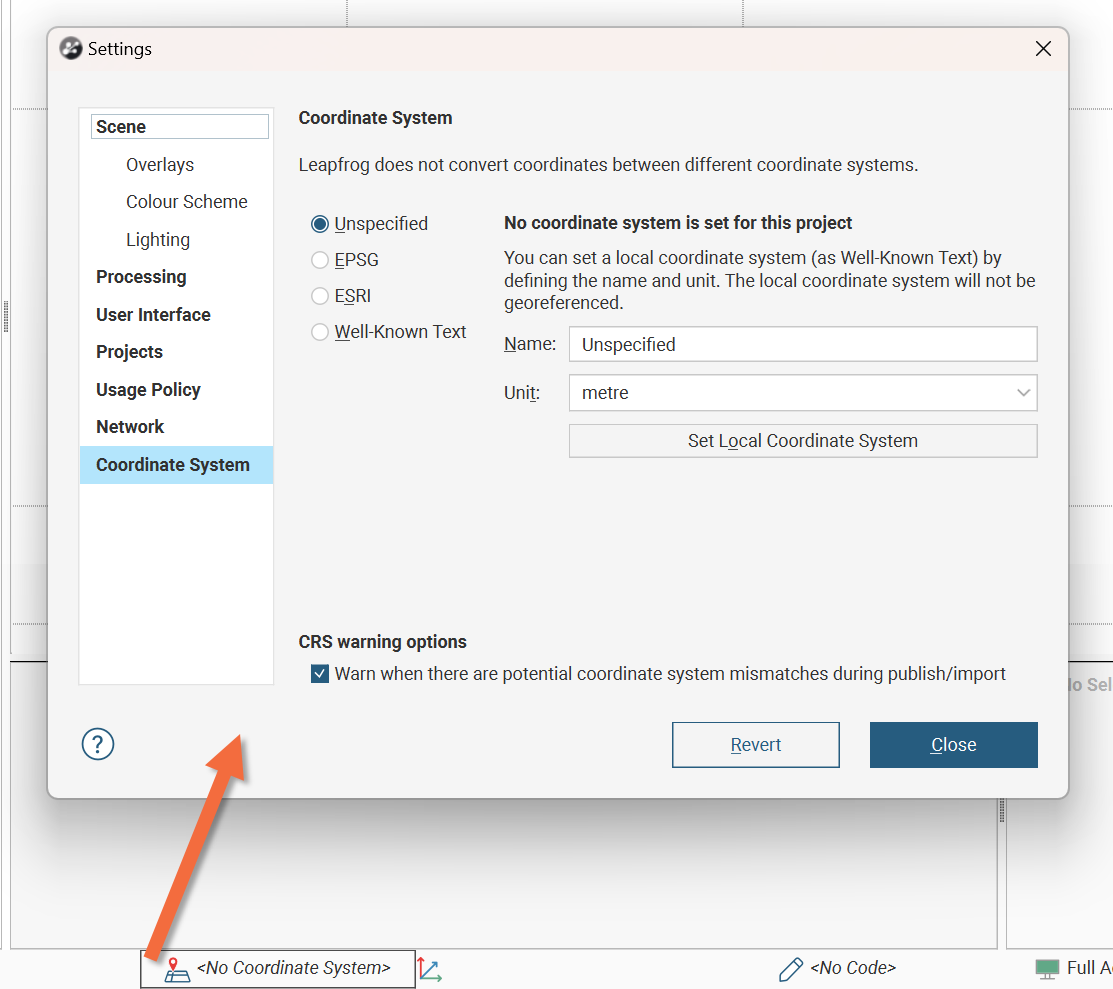

Recording a Coordinate System
Leapfrog Energy is unit-less and adopts the units used in the data you import. For example, if your imported data is in metres, the units displayed will be metres, and figures such as resolution, measured distances and slicer thickness will be in metres. It is important, therefore, to be consistent in the units used in the data you import. If you are importing data that uses different coordinate systems, you will need to pre-process the data so that it is using the same coordinate system.

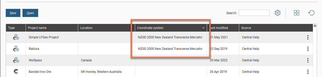

In order to communicate to the wider team, you can record in each Leapfrog Energy project the coordinate system that should be used, which will then be displayed at the bottom of the Leapfrog Energy window:
The Coordinate System setting is primarily an informational field. The project coordinate system should be set when the project is created and all the data imported into Leapfrog Energy should use the coordinate system that has been decided on for the project. Leapfrog Energy will not convert any data that is imported with references using a different coordinate system into the project coordinate system, nor does changing the project coordinate system perform a conversion of the data within Leapfrog Energy from the previous coordinate system to the new coordinate system.
The Projects tab will show the project coordinate system metadata setting in the Coordinate system column when the projects are displayed in the List view:
To record and display the coordinate system team members should be using in a project, click on the button at the bottom of the Leapfrog Energy window:
The Settings window will open with the Coordinate System tab displayed.
See Coordinate System Settings for information about the settings in this tab.

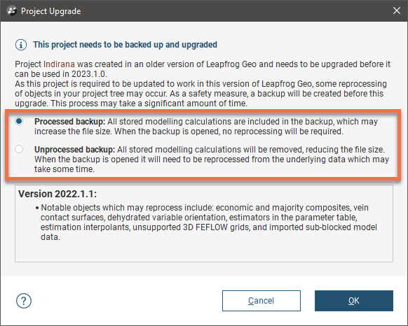

When you open a project that was last saved in an earlier version of Leapfrog Energy, you will be prompted to upgrade the project and a list of affected objects will be displayed. As part of this process, you will also be prompted to create a backup:
Backing up before upgrade is compulsory for local projects and local copies of Central projects; you cannot open the project without first creating the backup. You can choose between a processed or an unprocessed backup:
- A Processed backup includes all stored modelling calculations. This can result in large file sizes, but when the backup is opened, no reprocessing will be required.
- An Unprocessed backup removes all stored modelling calculations. This can reduce the size of the backup, but if the backup is needed, all of the modelling calculations will need to be reprocessed from the underlying data.
The tradeoff is that when an unprocessed backup is selected, the backup can be completed quickly and the resulting file size will be smaller, but when the backup is needed, reprocessing might take some time, especially with large, complex projects.
Select the option required, then click OK. You will be prompted to select where the backup should be saved. Once the backup is complete, the project will be opened and upgraded.
If the project has been downloaded from Central and has not been changed, there will be a third option, to upgrade the project without creating a backup:

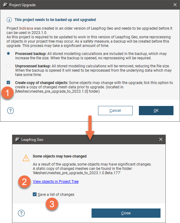

If the project being upgraded contains objects that could change as the result of the upgrade, there will also be a Create copy of changed objects option in the Project Upgrade window:
This option is described further in Changed Objects Warning below.

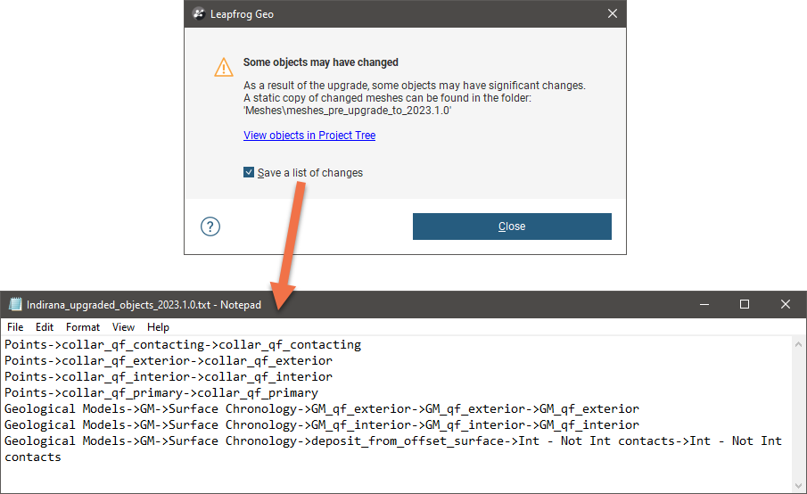

Upgrades can sometimes result in changes to objects, and for this reason, Leapfrog Energy gives you options for saving copies of pre-upgrade surfaces, along with information about which objects in the project have changed due to the upgrade. When you upgrade a project, Leapfrog Energy will prompt you to:

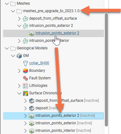

Save a copy of changed surfaces in the Meshes folder. This prompt is shown in the Project Upgrade window. |
Highlight the changed objects in the project tree. Once the project has been upgraded and opened, a link is displayed that allows you to highlight all changed objects in the project tree. |
Save a text file with a list of changed objects. This prompt is included in the window that contains the link to changed objects. |
When the Create copy of changed objects option in the Project Upgrade window is enabled, the folder created in the Meshes folder will contain non-editable copies of the pre-upgrade surfaces that link to the upgraded surfaces. For example, here the pre-upgrade mesh () in the Meshes folder is linked to the upgraded surface that is part of a geological model (
Whether or not you enable Create copy of changed objects in the Project Upgrade window, once the project has been opened, a message will be displayed that includes a link to the changed objects and gives you the option of saving a file containing the list of changes:

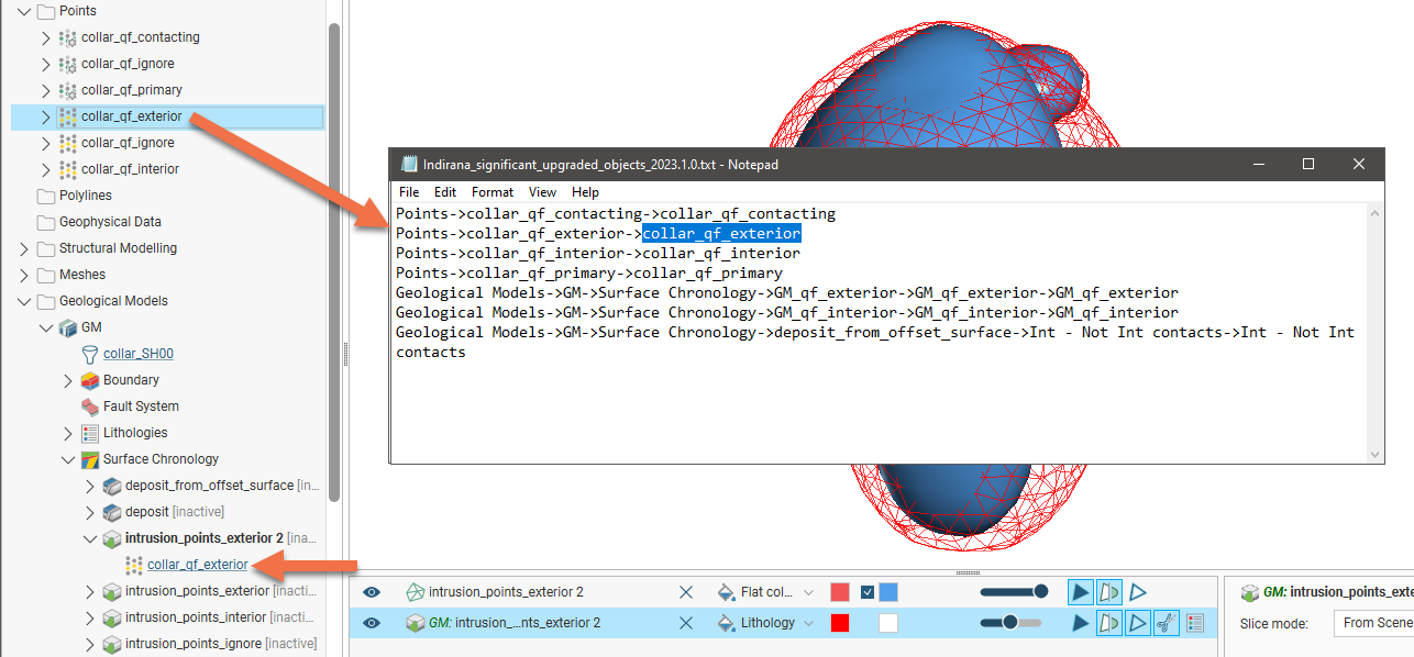

The text file and any pre-upgrade meshes can be used in investigating changes to surfaces. For example, here we can see that the non-editable copy of the pre-upgrade mesh () (shown in blue) does not match the upgraded geological model surface (
) (shown in triangles):
Looking in the text file, we can see that the points used to create the surface have been upgraded and so we can check what has changed about those points:

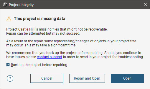

When a project is opened, Leapfrog Energy checks the integrity of the project, looking for missing data. In some cases, Leapfrog Energy can try to open the project and you may be able to continue working in it.
In other cases, Leapfrog Energy can attempt to generate the missing files from data in the project, in which case you will be asked whether or not you wish to repair the project.
Whatever the case, read the information in the dialog and decide whether you wish Leapfrog Energy to open the project or attempt a repair.
It is strongly recommended that you allow Leapfrog Energy to back up a project that has files missing before attempting to open or repair it.
This message may be displayed if:
- You have copied a project to a different folder and the copying process is not yet complete
- You are unzipping a project and the process is not yet complete.
If this is the case, click Cancel and try opening the project again once the copying/unzipping is complete.

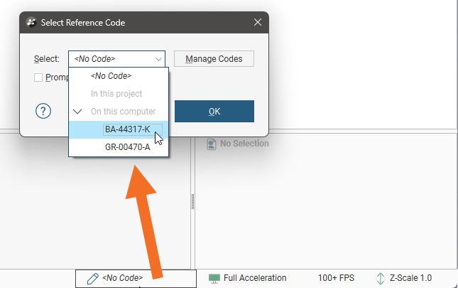

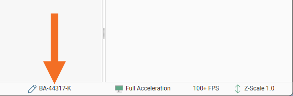

Tracking Project Work Using Reference Codes
To enter a code, click the button in the status bar on the bottom edge of the Leapfrog Energy main window:
Select from the codes defined and click OK. The code entered will be displayed in the status bar:
To define new reference codes or delete old ones, click on the Manage Codes button. See Usage Policy Settings.
To work without a code, click on the button, select <No Code>, then click OK. Note that whether it’s possible to use Leapfrog Energy without first entering a reference code depends on a setting in the Settings > Usage Policy window.
