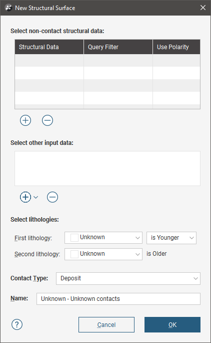

To create a new structural surface, right-click on the Surface Chronology and select New Structural Surface. The New Structural Surface window will appear:
Use the Add buttons to add non-contact structural data and on-surface contacts, then set the First lithology and Second lithology. Other settings are:
- Query Filter. Select from the query filters defined for the selected structural data object.
- Use Polarity. Untick the box to use tangents only.
- Contact Type. Structural surfaces can be deposit, erosion or intrusion contacts. The same algorithm is used for each setting; the only difference is in how the surface interacts with other surfaces.

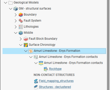

The Structural Surface in the Project Tree
The name Leapfrog Energy automatically assigns to a structural surface is the lithologies assigned to each side of the surface. In the project tree, expand the surface to see how it was made:
As further refinements are made to the surface, that information will also be added to the project tree. See Refining a Structural Surface below for more information.

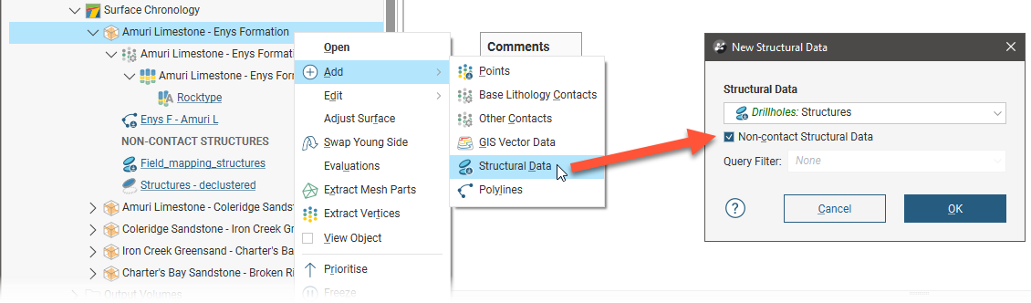

To add more non-contact structural data to the surface, right-click on it in the project tree and select Add > Structural Data. In the window that appears, tick the box for Non-contact Structural Data:
