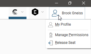

Once you have signed in to Leapfrog Energy using your Seequent ID, the user ID menu in the upper right-hand corner of the main window is used to manage your MySeequent profile and your permissions:
If you are offline, options that require an internet connection will be greyed out. You can continue working in Leapfrog Energy while you are offline until your session expires. To see when this is, click on the user ID menu and select Manage Permissions. The window that appears will display the time and date when your session will expire.
If your organisation shares Leapfrog Energy seats between users, you can release your seat for other Leapfrog Energy users in your organisation when you have finished working with Leapfrog Energy. To release your seat, you can either:
  • Select the Release Seat option from the user ID menu.
  • Close Leapfrog Energy and choose the Release Seat option when you are prompted.
When you close Leapfrog Energy, the Quit option retains your seat and the next time you launch Leapfrog Energy, you will not have to sign in, nor will you have to select your entitlements.

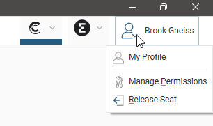

Once you have signed in using your Bentley account, you can change your permissions via the user ID menu in the upper right-hand corner of the main window:

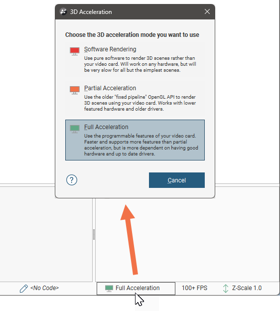

Leapfrog Energy can run in one of three acceleration modes. These modes are selected by clicking on the button at the bottom of the main window:
See 3D Acceleration Mode in Scene Settings for more information on these settings.

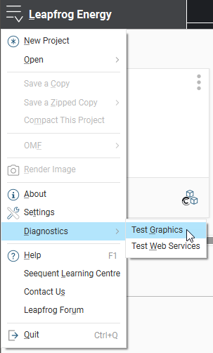

To start the test, open Leapfrog Energy and select Test Graphics from the Leapfrog Energy > Diagnostics menu:

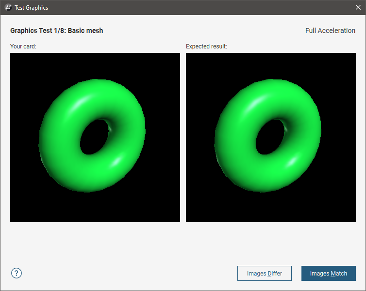

The graphics test displays a series of image pairs that test your computer’s capabilities for the currently selected acceleration mode. For each pair, compare the images:
Even if the differences are slight, click the Images Differ button. If the images match, click the Images Match button. The next test will be displayed.
At the conclusion of the test, the result is displayed. If one or more tests have failed, information about solving problems will be displayed.
If you click on Save Report, you will be prompted to save the file on your computer.
If the test has failed, try switching to a different acceleration mode and running the test again. If possible, avoid using Software Rendering as it can be very slow.
