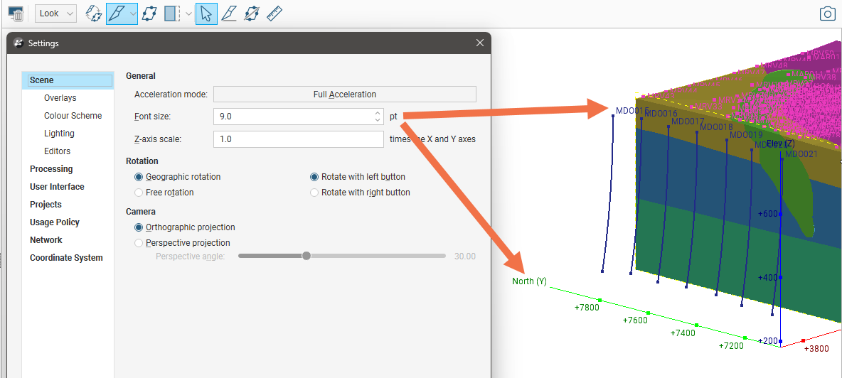

This setting is the size of text used to display information in the scene such as collar IDs and numeric and category data:
The Font size is also used for the screen grid and axes, if displayed.

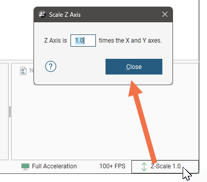

The z-axis setting can also be changed by clicking the Z-Scale button at the bottom of the Leapfrog Energy main window. The Scale Z Axis window will appear:
Note that each project saves the z-axis scaling setting when the project is closed. In addition, when saving scenes (see Saved Scenes), the z-axis scale is saved as part of the scene.
