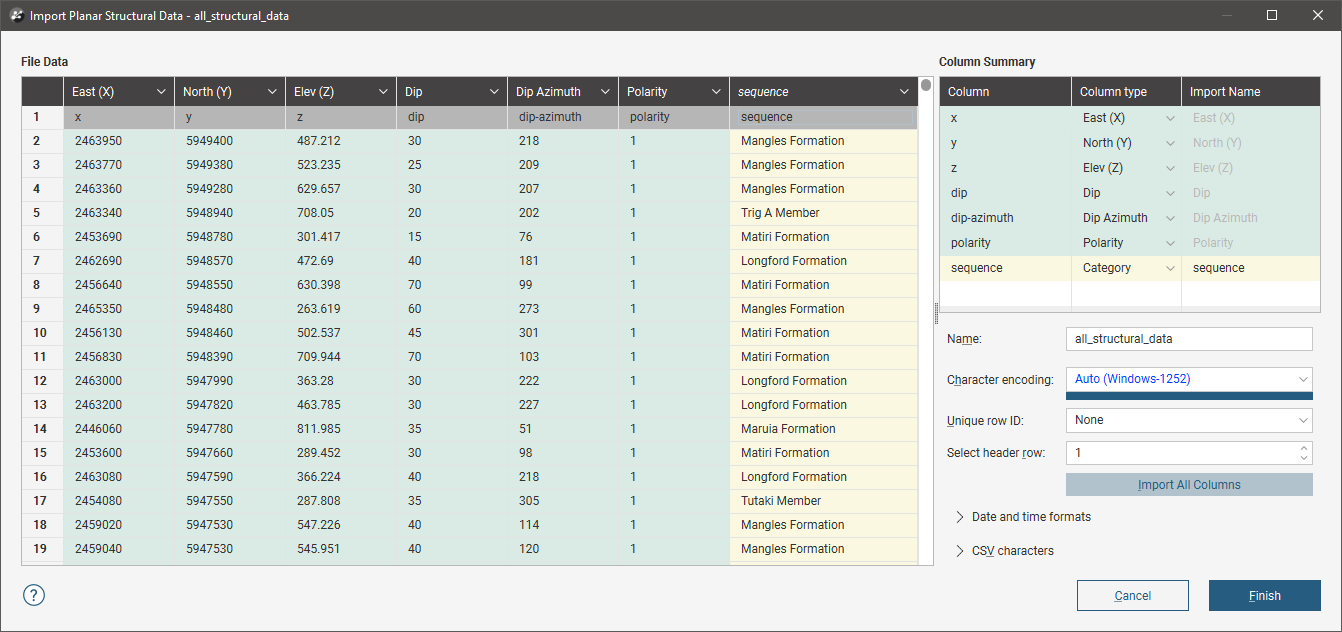

For each of these options, once the data source is selected, the process of importing the data is the same. Leapfrog Energy will display the data and you can select which columns to import:
Leapfrog Energy expects East (X), North (Y), Elev (Z), Dip and Dip Azimuth columns. The Polarity column is optional. The Base Category column can be used for filtering data once it has been imported.
Click Finish to import the data.
