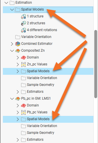

The Estimation folder contains a common Spatial Models folder, as does each domained estimation defined in a project:

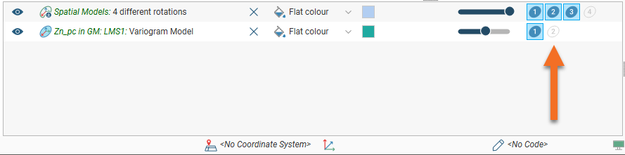

All variogram models in Leapfrog Energy can be visualised in the scene, as described in The Ellipsoid Widget. When a variogram model with more than one structure is displayed in the scene, you can switch between the structures using the buttons in the shape list:

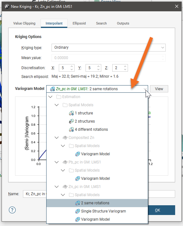

Using Variogram Models in Estimators
For Kriging and RBF estimators, you can select from the variogram models available in the project in the estimator’s Interpolant tab. For example, for this Kriging estimator, you can use the imported variogram models in the Estimation > Spatial Models folder or any of the variogram models defined for the domained estimations in the project:

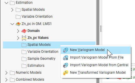

Creating Variogram Models
In Leapfrog Energy, you can create variogram models that have up to two structures, plus nugget. These variograms are created by right-clicking on the Spatial Models folder for a domained estimation and selecting New Variogram Model:

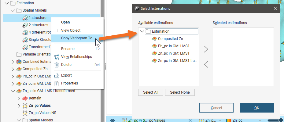

Variograms with up to two structures plus nugget can be edited in Leapfrog Energy when they have been saved to a domain-specific Spatial Models folder.
If you have a Leapfrog-editable variogram in the common Spatial Models folder you wish to edit, right-click on it in the project tree and copy it to the domain you wish to work in:
This makes a copy of the variogram model in the domained estimation, but note that this copy is not linked to the original in the common Spatial Models folder.
