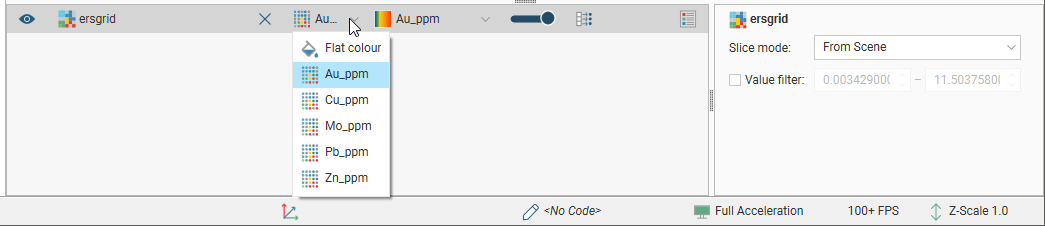

When you display the grid in the scene, select the imported bands from the shape list:
Grids can be displayed as points (
) or as cells and the values filtered, as described in Displaying Points.

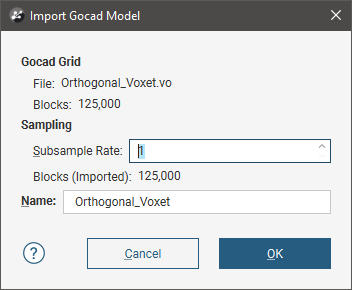

Leapfrog Energy imports GOCAD Voxet files in *.vo format. To do this, right-click on the Geophysical Data folder and select Import 3D Grid. In the window that appears, select the file you wish to import and click Open.
In the window that appears, the number of blocks in the file is displayed. If you wish to select only a subset of the blocks, increase the Subsample Rate.
Click OK to import the grid, which will appear in the Geophysical Data folder.

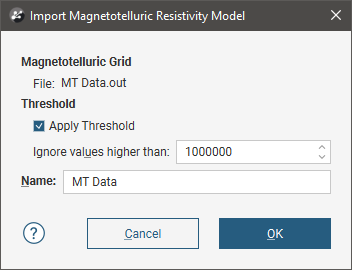

Leapfrog Energy imports magnetotelluric resistivity (OUT) files in *.out, *.out.gz and *.mod formats. To do this, right-click on the Geophysical Data folder and select Import 3D Grid. In the window that appears, select the file you wish to import and click Open.
In the window that appears, choose whether or not you will apply a threshold.

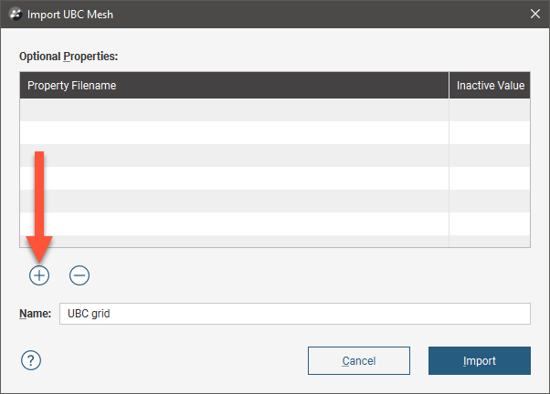

Leapfrog Energy imports UBC grids in *.msh format, together with numeric values in properties files in *.gra, *.sus, *.mag and *.den formats. To do this, right-click on the Geophysical Data folder and select Import 3D Grid. In the window that appears, select the file you wish to import and click Open.
Next, a window will appear in which you can add any property files you also wish to import, although these are not required. Click on the (
) button and select the files you wish to import:
You can add more properties files to the grid once it has been imported.
Click Import. The grid will be added to the Geophysical Data folder.

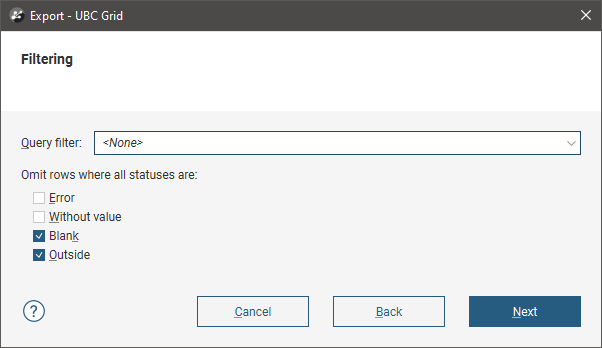

Choose which evaluations, calculations and filters will be included in the exported file. Items added to the Selected items list will appear in the exported file as columns, and the order of columns in the file will match the order shown in the project tree.
There are two options for filtering out rows:
- Use a Query filter to filter rows out of the data exported. Note that this is different from exporting filters as columns in the Select Items step.
- The Omit rows... options are useful when all block results are consistently the same non-Normal status. Select from Error, Without value, Blank or Outside; all rows that consistently show the selected statuses will not be included in the exported file.

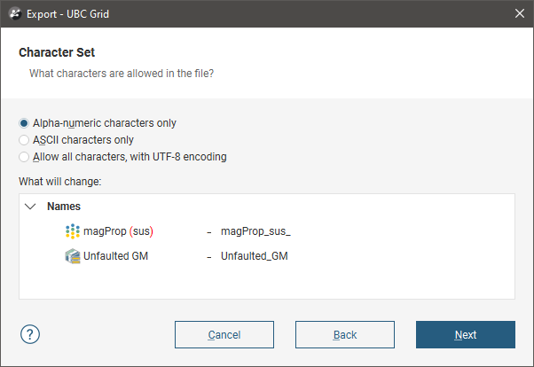

There are three encoding options:

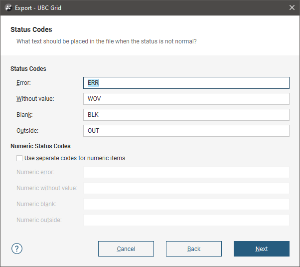

When a 3D grid is exported, non-Normal status codes can be represented in the exported file using custom text sequences.
The Status Codes sequences are used for category status codes and filter status codes exported as columns. For filter status codes, Boolean value results will show FALSE and TRUE for Normal values or the defined Status Codes for non-Normal values.
The selection you make will depend on the target for your exported file. You can choose a character set and see what changes will be made:
Once you have made any Character Set changes, click Next to view a summary of the selected options.

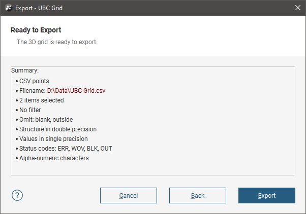

If you need to make any changes, you can work back through the steps.
Once you’re satisfied with the settings chosen, click Export to save the file.
The selections you make when you export a 3D grid will be saved. This streamlines the process of subsequent exports of the grid.

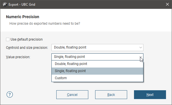

Exporting 3D Grids in UBC Format
3D grids can be exported in UBC format. To do this, right-click on the grid in the project tree and select Export as UBC Grid.

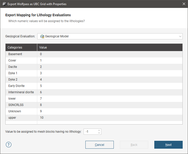

When a 3D grid is exported in UBC format with a category evaluation, category data is mapped to an editable numeric value. If the grid has any category evaluations, you will first be prompted to check the numeric values used for each category:
Double-click on a value to edit it. You can also change the value assigned to blocks that have no lithology.

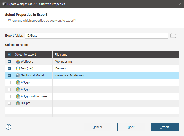

Click Next to select the properties you wish to export and edit the file names used, if required.
If the grid has no category evaluations, this is the first window that will appear when you select the Export as UBC Grid option.
Click Export to save the files.

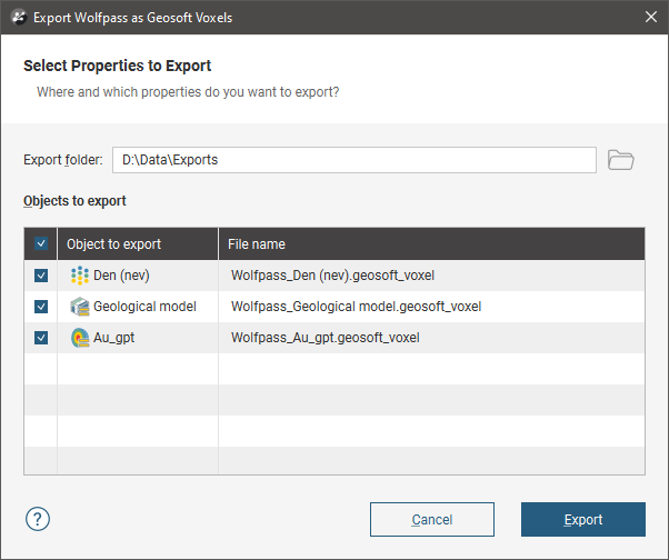

Exporting 3D Grids in Geosoft Voxel Format
3D grids can be exported in Geosoft Voxel format. To do this, right-click on the grid in the project tree and select Export as Geosoft Voxels. In the window that appears, select the properties you wish to export and edit the file names used, if required.

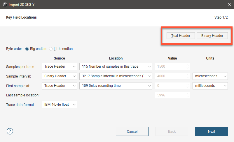

There are two steps to work through. First, set up the Key Field Locations. There are buttons at the top of the window for displaying the Text Header and Binary Header, which may be useful in deciding what import settings to use.
You can keep the Text Header and Binary Header windows open while you work through the steps in the Import 2D SEG-Y window.
Settings for the Key Field Locations are:
- Byte order. This will be Big endian or Little endian and must be correct in order for the other data in the file to be read correctly.
- Samples per trace. This is the number of samples in each trace. If the correct value cannot be read from the file, you can set it manually by selecting User from the Source dropdown list.
- Sample interval. This is the vertical sample spacing for the trace data and is almost always stored in thousandths of true units. If the correct value cannot be read from the file, you can set it manually by selecting User from the Source dropdown list.
- First sample at. This is the delay recording time for the first sample. If the correct value cannot be read from the file, you can set it manually by selecting User from the Source dropdown list.
- Last sample location. This is read-only and is the calculated location from the last sample in the trace.
- Trace data format. This should be defined in the binary header.

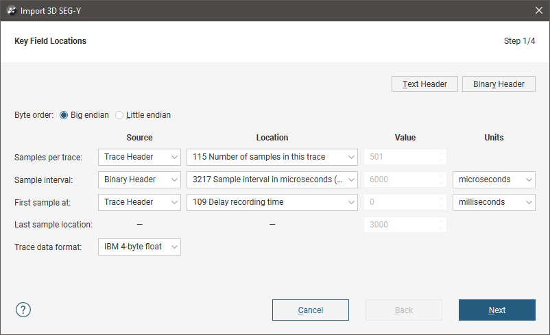

There are four steps to work through. In the last step, you can choose how many slices to import. First, set up the Key Field Locations. There are buttons at the top of the window for displaying the Text Header and Binary Header, which may be useful in deciding what import settings to use.
You can keep the Text Header and Binary Header windows open while you work through the steps in the Import 3D SEG-Y window.

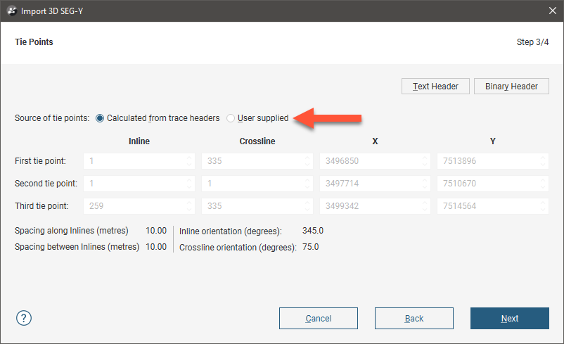

Click Next to move on to setting the Tie Points. By default, these are calculated from the trace headers, but if they are not in the trace headers or if you have more precise values from the text header or from another source, click User supplied and entering these values manually.
The Spacing along Inlines and Spacing between Inlines fields are calculated from the specified tie points.

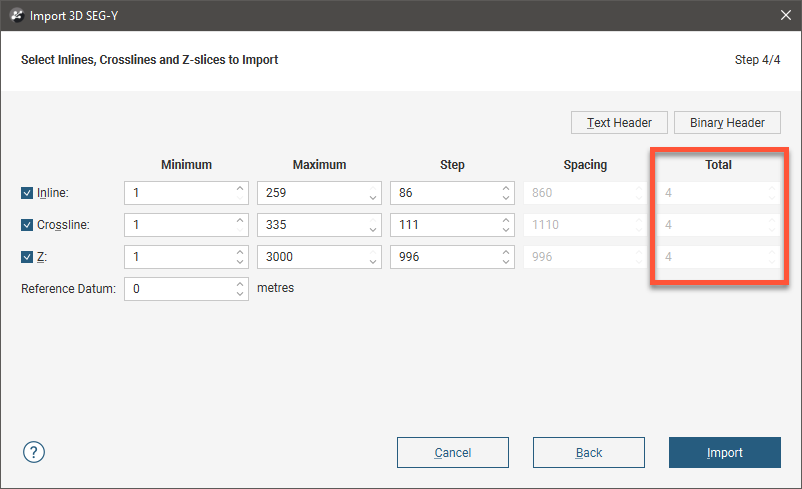

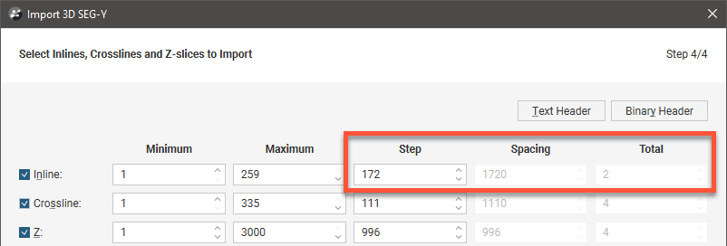

Click Next to move on to selecting the slices you will import. The Total column tells you the number of in-lines, cross-lines and z-slices that will be imported.
If you wish to import fewer or more slices, adjust the Minimum, Maximum or Step values, and the Total number of slices will be updated:

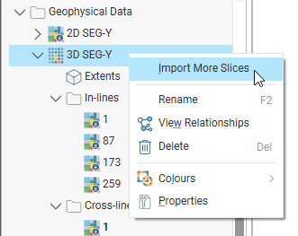

You can drag slices into the scene one-by-one or display, say, all z-slices by dragging the Z-slices folder into the scene.
To delete slices, right-click on them and click Delete.
If you wish to add more slices, right-click on the data object and select Import More Slices:
This launches the Import 3D SEG-Y window once again and you can select additional slices by changing the Minimum, Maximum or Step values in the last step.
