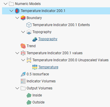

The new interpolant will be created and added to the Numeric Models folder. The new interpolant contains other objects that represent different parts of the interpolant:
- The Trend object describes the trend applied in the interpolant. See Changing the Trend for an Indicator RBF Interpolant.
- The sample grouping object (
) is the inside/outside sample grouping, which is generated by backflagging the indicator calculations on the values used. See Adjusting the Values Used for information on changing settings relating to how the sample points are grouped. - The isosurface is set to the specified Iso value.
- The Indicator Volumes legend defines the colours used to display the volumes.
- The Output Volumes folder contains the Inside and Outside volumes.

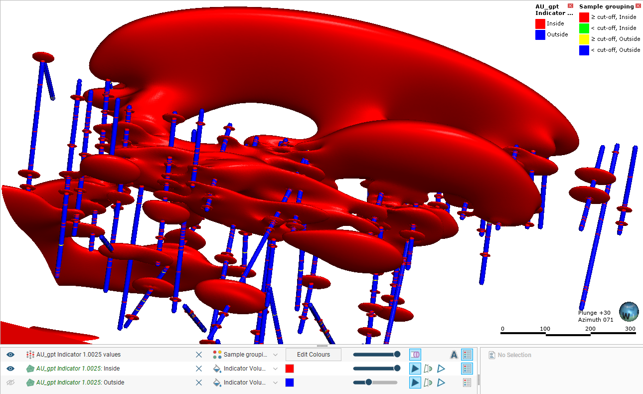

Indicator RBF Interpolant Display
Display the interpolant by:
- Dragging the interpolant into the scene
- Right-clicking on the interpolant and selecting View Output Volumes
- Right-clicking on the interpolant and selecting View Isosurfaces
You can also display the sample grouping (
) generated as part of the interpolant, which is useful in making decisions about the Cut-off value and the Iso value:

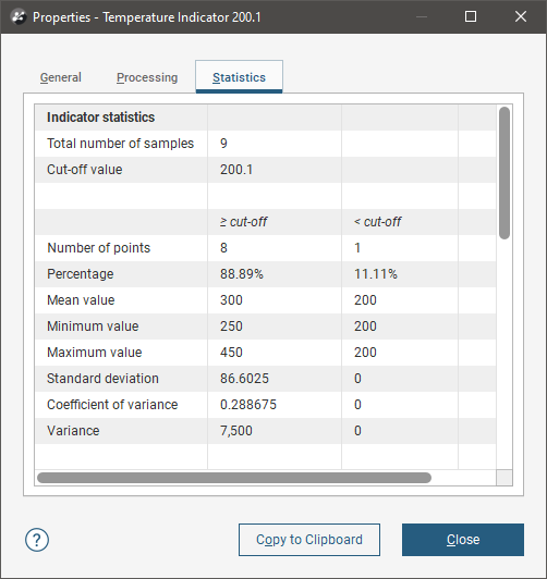

Indicator RBF Interpolant Statistics
You can view the statistics for the indicator RBF interpolant by right-clicking on the interpolant and selecting Statistics. Use the information available to adjust the cut-off value and other interpolant properties:

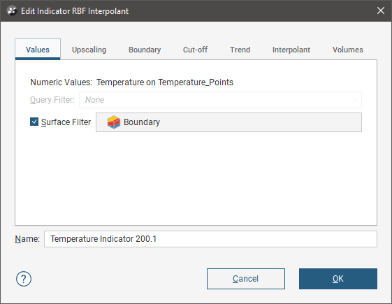

To edit an indicator RBF interpolant, you can either double-click on the interpolant in the Numeric Models folder or right-click and select Open. The window that appears is divided into tabs that let you change the different objects that make up the interpolant. Many of the options are the same as those for RBF and multi-domained RBF interpolants.
When creating an indicator RBF interpolant, only a basic set of parameters is used. The Edit Indicator RBF Interpolant windows provide finer controls over these basic parameters so you can refine the interpolant to factor in real-world observations and account for limitations in the data.
- Adjusting the Values Used
- Compositing Parameters for an Indicator RBF Interpolant
- Adjusting the Interpolant Boundary
- The Cut-Off Value
- Changing the Trend for an Indicator RBF Interpolant
- Adjusting Interpolation Parameters
- Indicator RBF Interpolant Surfacing and Volume Options

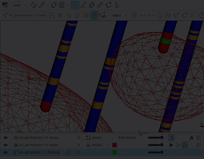

Adding a Contour Polyline

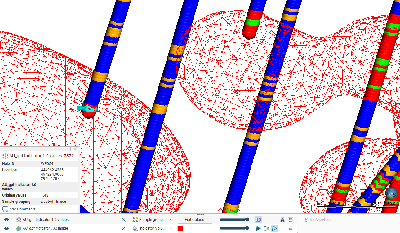

You can adjust the values using contour polylines set to inside (1), outside (0) or to the iso-value. Adding a contour polyline does not affect the indicator’s statistics.

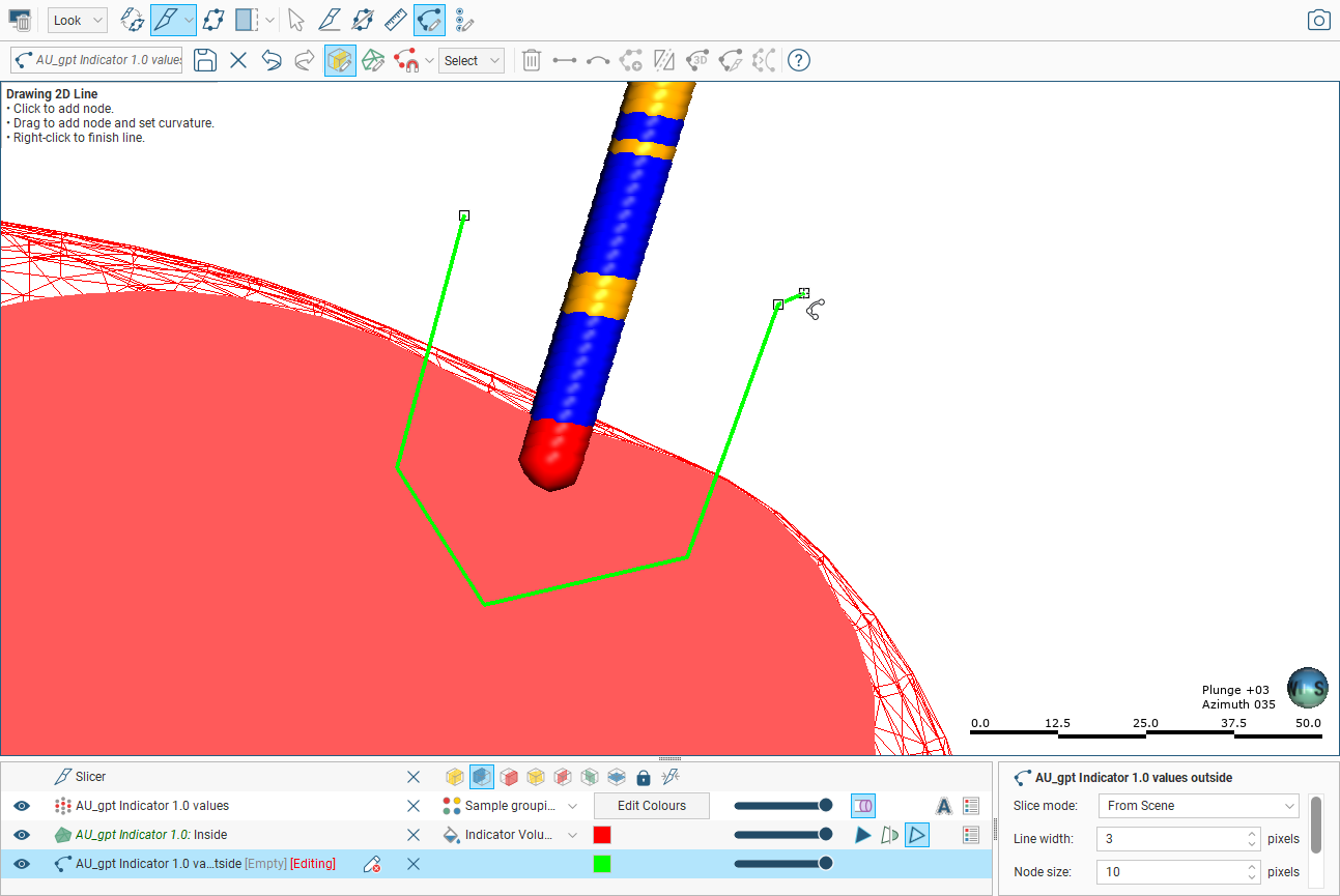

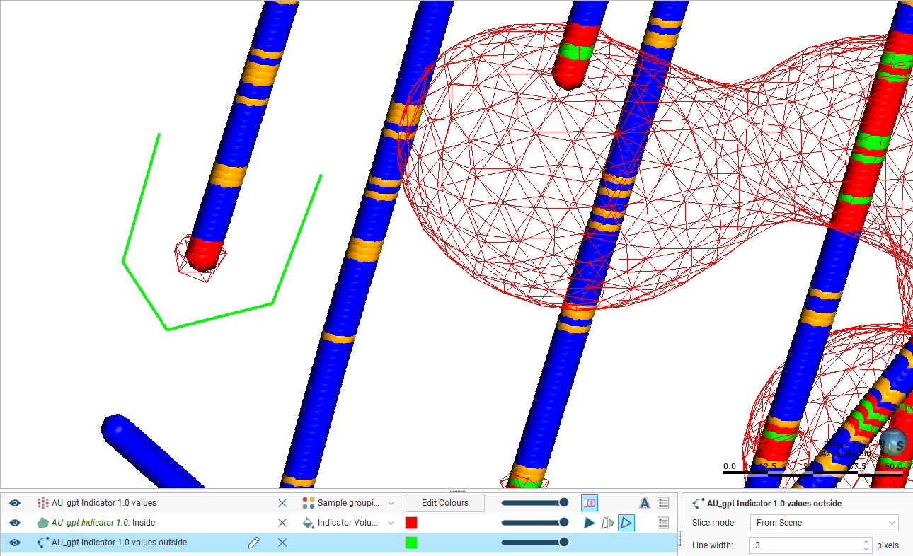

Setting a contour to inside or outside is a useful way of controlling blow-outs. Here, the inside volume occurs in the corner of the model because of the high-value points at the bottom of the well:
This can be adjusted by drawing a contour polyline below the bottom of the wells and setting it to the outside value. For example, adding a polyline (in green) below the bottom of well shown above removes the blow-out (the part of the mesh with only the edges shown):
Polylines must be drawn either on the slicer or on an object. Here a slicer has been drawn across the well and the scene repositioned to draw around the end of the well:
Drawing a contour polyline precisely on the well gives Leapfrog Energy conflicting data at the same location, which is why the polyline should be drawn below the well. To draw a polyline below a well without using the slicer, first draw the polyline on the well, then move its nodes so the polyline lies below the well.

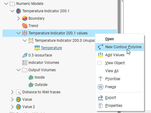

To add a contour polyline, expand the interpolant in the project tree. Right-click on the values object and select New Contour Polyline:

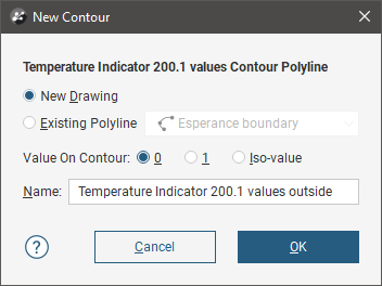

Next, choose whether you will draw a new polyline or use one already in the project, then select the contour value:
Click OK. If you have chosen the New Drawing option, the new object will be created in the project tree and drawing tools will appear in the scene. Start drawing in the scene as described in Drawing in the Scene. When you have finished drawing, click the Save button (
). The new contour will automatically be added to the interpolant and will appear in the project tree as part of the interpolant’s values object.
To edit the polyline, right-click on it and select Edit Polyline or add it to the scene and click the Edit button (
) in the shape list. If you wish to remove a contour polyline from the interpolant, right-click on it in the project tree and select Delete or Remove.
You cannot change the value on the contour once it has been created. You can, however, share the polyline and use it to create a new contour polyline. To do this, right-click on it in the project tree and select Share. The polyline will then be added to the Polylines folder and can be used elsewhere in the project.

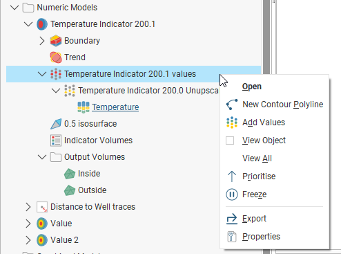

To add points to an indicator RBF interpolant, right-click on the values object in the project tree and select Add Values. Leapfrog Energy will display a list of all suitable points objects in the project. Select an object and click OK.

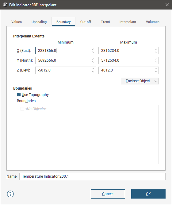

To change an indicator RBF interpolant’s boundary, double-click on the interpolant in the project tree, then click on the Boundary tab:
Techniques for creating lateral extents for indicator RBF interpolants are the same as those for RBF interpolants. See Modifying an RBF Interpolant’s Boundary With Lateral Extents for more information.

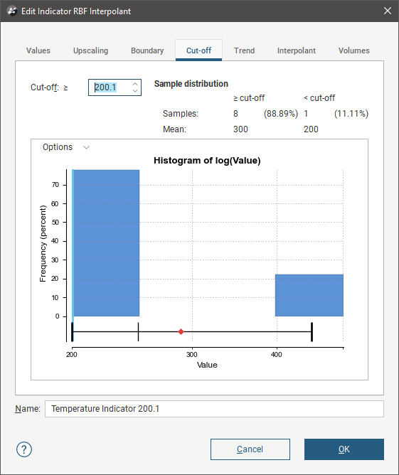

The Cut-Off Value
The Cut-off value is the value you would like to model. If you would like to visualise a shell representing values greater than 2.5, you would enter a value of 2.5 as the Cut-off value. This will be used to determine whether input values are treated as 0 or 1, waste or mineral. Another important consideration in visualising an indicator interpolant surface is the Iso value, which sets the probability you would like to maintain for the indicator interpolant isosurface. See Indicator RBF Interpolant Surfacing and Volume Options for more information.
To change the Cut-off value for an indicator RBF interpolant, double-click on the interpolant in the project tree, then click on the Cut-off tab. The tab also shows the distribution of the data used to create an indicator interpolant:
Adjust the Cut-off value, if required, and click OK to process the changes.

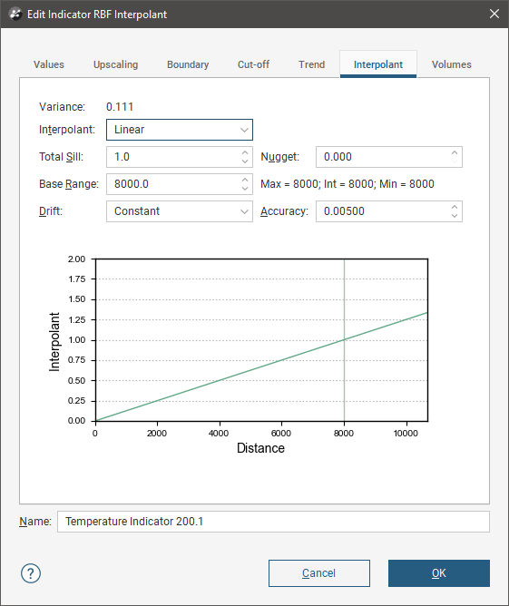

To adjust interpolation parameters for an indicator RBF interpolant, double-click on the interpolant in the project tree, then click on the Interpolant tab:

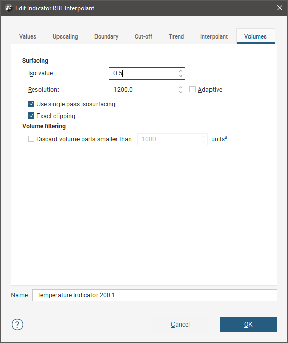

To change the properties of the isosurface for an indicator RBF interpolant, double-click on the interpolant in the project tree, then click on the Volumes tab:
An alternative to double-clicking on the interpolant is to double-click on one of the output volumes, which opens the Edit Indicator RBF Interpolant window with the Volumes tab displayed.
The Iso value can be set to values from 0.1 to 0.9. Clicking the arrows changes the Iso value in steps of 0.1. To use a different value, enter it from the keyboard. The indicator interpolant is a probabilistic numeric model, and the Iso value is the confidence you want to use, the probability that the indicator interpolant shell contains the Cut-off value. A value of 0.1 means there is a 10% confidence, and this will result in a surface that definitely contains the mineralisation, but also will include a lot of waste. Choosing a value of 0.9 means a confidence of 90%, meaning that you almost definitely have just mineralisation inside the isosurface, depicted as a much smaller enclosing volume. However a lot of mineralisation will not be captured and will be treated as being on the ‘outside’, or waste; to achieve a confidence level of 90%, intervals are excluded that are lower probability due to high-grade material being blocked by lower grade material. Mid-range values for Iso value should therefore be preferred in most cases, rather than values at the extreme limits.
Setting a lower value for Resolution will produce more detail, but calculations can take longer. See Surface Resolution in Leapfrog Energy for more information.
Use Volume filtering to discard smaller parts of the volumes in which you do not wish to carry out further processing. For example, this interpolant has numerous small volumes:
Enabling Volume filtering removes the smaller parts:
