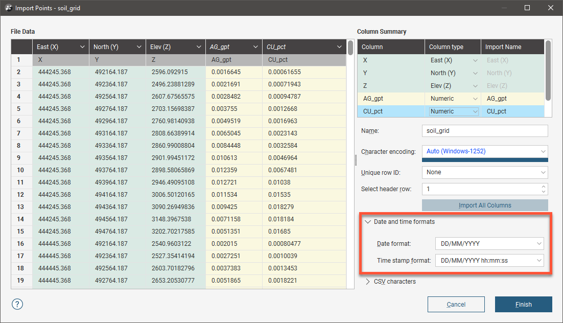

If the data contains date and time information and the date and time format is not detected, click on Date and Time Formats to reveal more information:
If the date and time format you wish to use is not among the options, you can create a custom format.

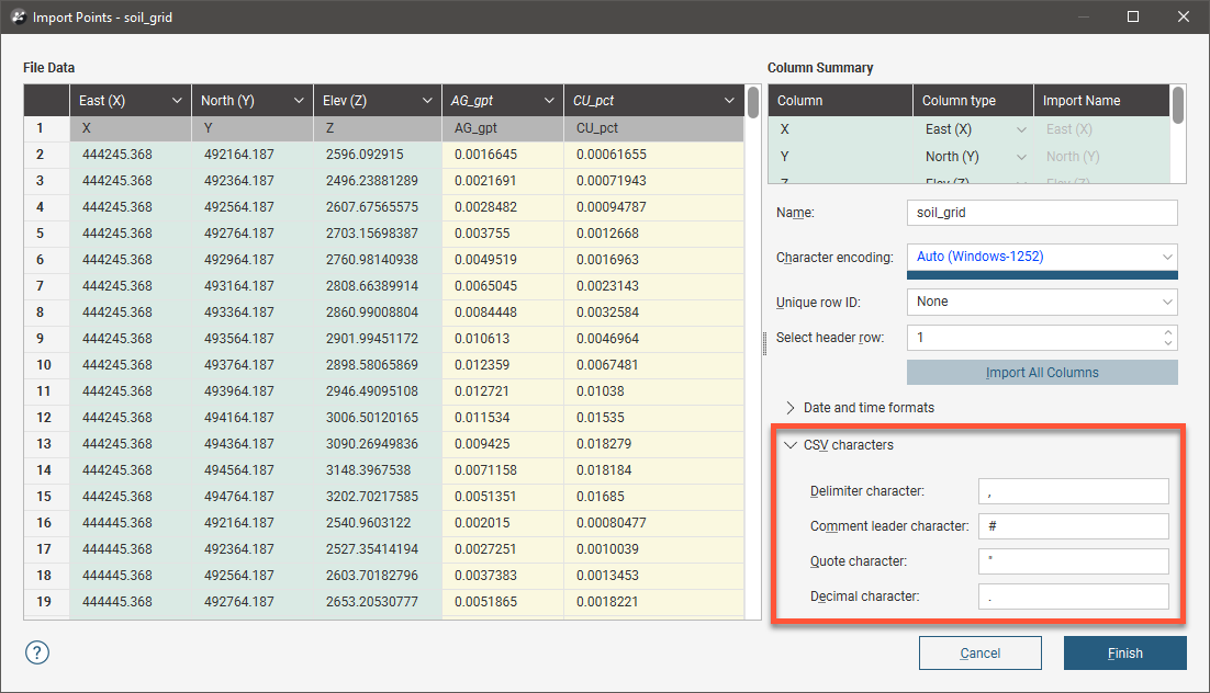

For *.csv files that use characters other than the comma as the separator, you can specify the delimiter, comment leader, quote and decimal characters in the Import window. Click on CSV characters to enter the characters used in the data files:
