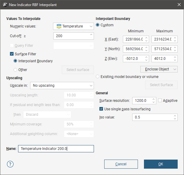

To create an indicator RBF interpolant, right-click on the Numeric Models folder and select New Indicator RBF Interpolant. The New Indicator RBF Interpolant window will be displayed:
The New Indicator RBF Interpolant window is a simpler version of the Edit Indicator RBF Interpolant window. While the Numeric values object selected when the interpolant is created cannot be changed later, all the other settings, and more, can be modified. The edit window also has features to assist value selection, such as a histogram to aid selecting a cut off value. If you are unsure of any setting, accepting the default value Leapfrog Energy proposes is a good option for creating a first-pass indicator interpolant. You can then modify the values in the edit window as you iterate to improve the model.
This window is divided into four parts in which you select the values used to create the interpolant, the interpolant boundary, any compositing options and general interpolant properties.

In the Values To Interpolate part of the New Indicator RBF Interpolant window, select the values that will be used and choose whether or not to filter the data and use a subset of those values in the interpolant.
You can build an indicator RBF interpolant from either:
- Numeric data contained in imported drilling data.
You cannot change the Values To Interpolate setting once the interpolant has been created.
Setting the Cut Off
The Cut-off value will be used to generate sample points and create two output volumes:
- An Inside volume that encloses all values likely to be above or equal to the Cut-off value.
- An Outside volume that enclose all values likely to be below the Cut-off value.
The probability that the enclosing volume encloses values above the cut-off is set by the Iso value.
If you are unsure of what Cut-off value to use, you can view statistics on the distribution of the data and change the Cut-off value once the interpolant has been created. Double-click on the indicator RBF interpolant in the Numeric Models folder to open the Edit Indicator RBF Interpolant window and switch to the Cut-off tab.
You can also change the names of the Inside and Outside volumes once the interpolant has been created.

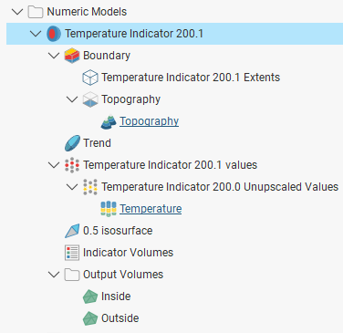

The new interpolant will be created and added to the Numeric Models folder. The new interpolant contains other objects that represent different parts of the interpolant:
- The Trend object describes the trend applied in the interpolant. See Changing the Trend for an Indicator RBF Interpolant.
- The sample grouping object (
) is the inside/outside sample grouping, which is generated by backflagging the indicator calculations on the values used. See Adjusting the Values Used for information on changing settings relating to how the sample points are grouped. - The isosurface is set to the specified Iso value.
- The Indicator Volumes legend defines the colours used to display the volumes.
- The Output Volumes folder contains the Inside and Outside volumes.

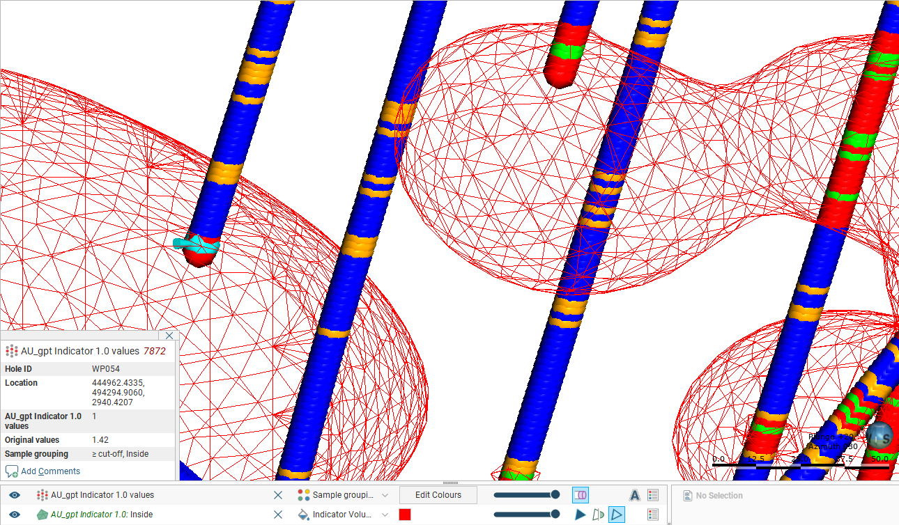

Indicator RBF Interpolant Display
Display the interpolant by:
- Dragging the interpolant into the scene
- Right-clicking on the interpolant and selecting View Output Volumes
- Right-clicking on the interpolant and selecting View Isosurfaces

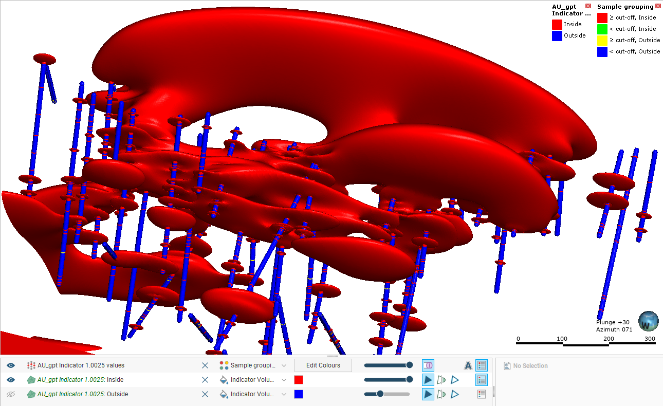

You can also display the sample grouping (
) generated as part of the interpolant, which is useful in making decisions about the Cut-off value and the Iso value:

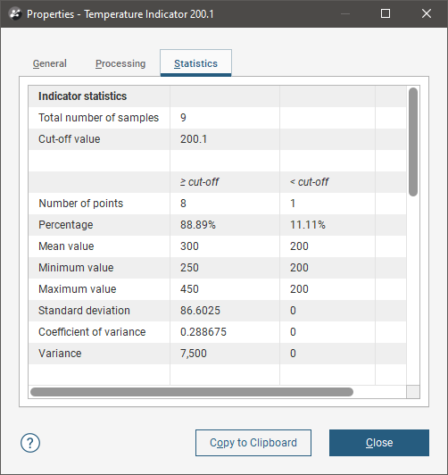

You can view the statistics for the indicator RBF interpolant by right-clicking on the interpolant and selecting Statistics. Use the information available to adjust the cut-off value and other interpolant properties:

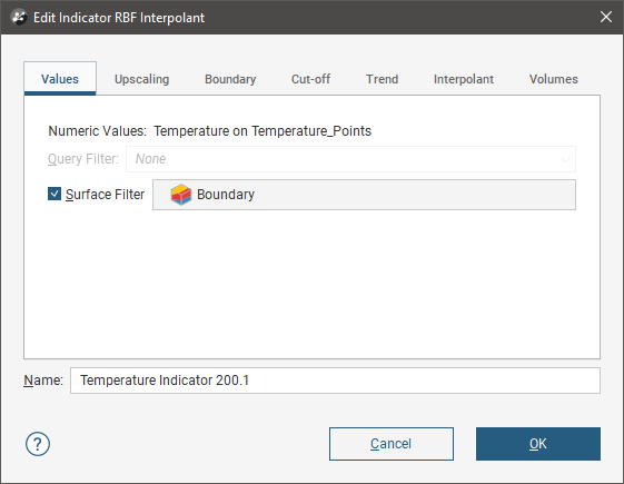

To edit an indicator RBF interpolant, you can either double-click on the interpolant in the Numeric Models folder or right-click and select Open. The window that appears is divided into tabs that let you change the different objects that make up the interpolant. Many of the options are the same as those for RBF and multi-domained RBF interpolants.
When creating an indicator RBF interpolant, only a basic set of parameters is used. The Edit Indicator RBF Interpolant windows provide finer controls over these basic parameters so you can refine the interpolant to factor in real-world observations and account for limitations in the data.

The Values tab in the Edit Indicator RBF Interpolant window shows the values used in creating the interpolant and provides options for filtering the data. You cannot change the values used, but you can filter the values using the Query filter and Surface filter options.

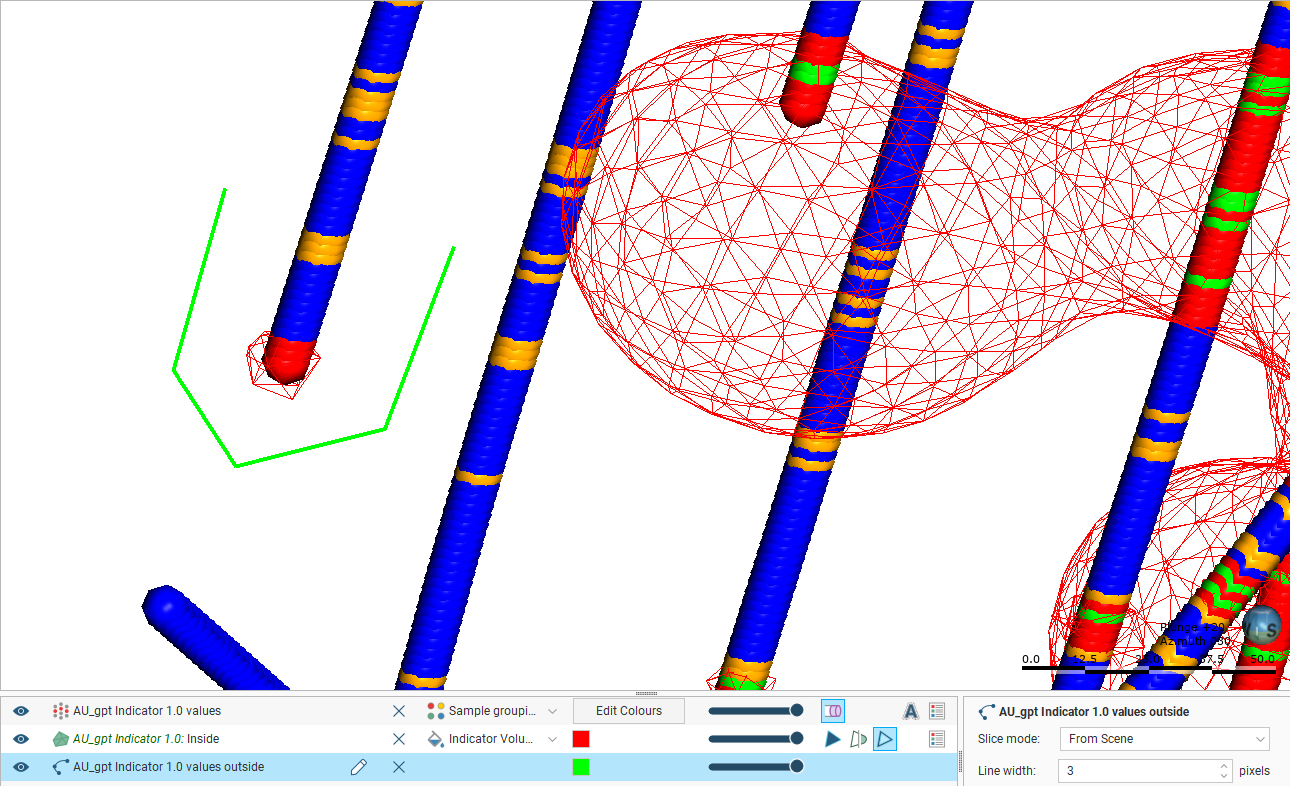

Adding a Contour Polyline

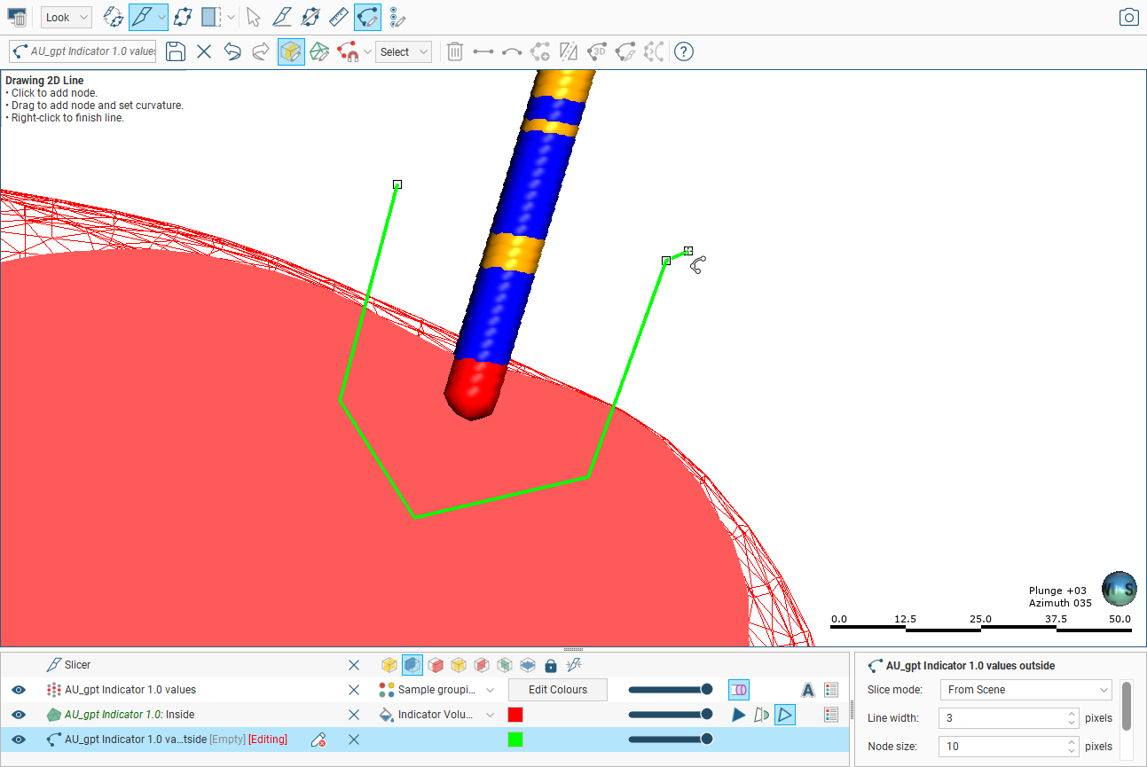

You can adjust the values using contour polylines set to inside (1), outside (0) or to the iso-value. Adding a contour polyline does not affect the indicator’s statistics.

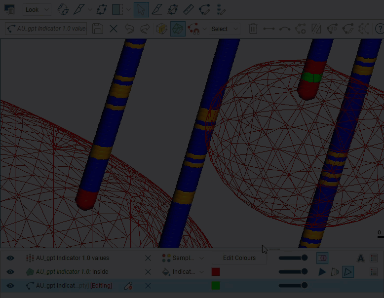

Setting a contour to inside or outside is a useful way of controlling blow-outs. Here, the inside volume occurs in the corner of the model because of the high-value points at the bottom of the well:
This can be adjusted by drawing a contour polyline below the bottom of the wells and setting it to the outside value. For example, adding a polyline (in green) below the bottom of well shown above removes the blow-out (the part of the mesh with only the edges shown):
Polylines must be drawn either on the slicer or on an object. Here a slicer has been drawn across the well and the scene repositioned to draw around the end of the well:
Drawing a contour polyline precisely on the well gives Leapfrog Energy conflicting data at the same location, which is why the polyline should be drawn below the well. To draw a polyline below a well without using the slicer, first draw the polyline on the well, then move its nodes so the polyline lies below the well.

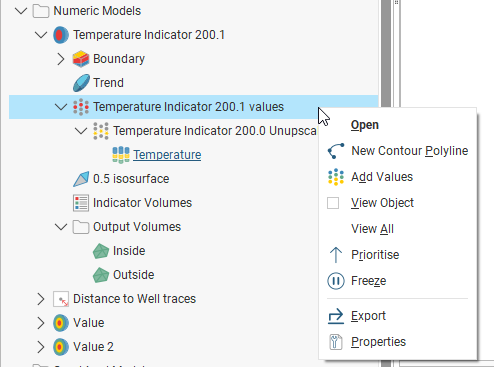

To add a contour polyline, expand the interpolant in the project tree. Right-click on the values object and select New Contour Polyline:
Next, choose whether you will draw a new polyline or use one already in the project, then select the contour value:
Click OK. If you have chosen the New Drawing option, the new object will be created in the project tree and drawing tools will appear in the scene. Start drawing in the scene as described in Using the Polyline Editor. When you have finished drawing, click the Save button (
). The new contour will automatically be added to the interpolant and will appear in the project tree as part of the interpolant’s values object.

Query and surface filters can be changed by double-clicking on the interpolant in the project tree, then clicking on the Values tab.
Available filters will be listed in the Query Filter dropdown, building the indicator RBF interpolant from a subset of the available values data.
The Surface filter is enabled by default, with the default selection being the indicator RBF interpolant boundary. You can disable the surface filter to use all the data available, or you can select a different volume from the dropdown list to constrain the data influencing the indicator RBF interpolant. To modify the interpolant’s own boundary, switch to the Boundary tab.

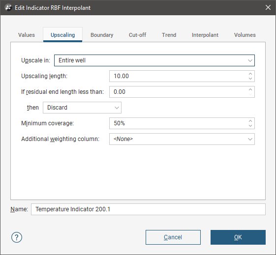

Compositing Parameters for an Indicator RBF Interpolant
When an indicator RBF interpolant has been created from values that have not been composited, compositing parameters can be changed by double-clicking on the interpolant in the project tree, then clicking on the Compositing tab.
The Compositing tab will only appear for interpolants created from drilling data that has not been composited.
You can composite in the entire well or only where the data falls inside the interpolant boundary. See Numeric Composites for more information on the effects of the Compositing length, For end lengths less than and Minimum coverage settings.

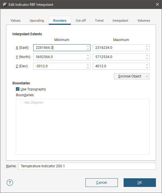

To change an indicator RBF interpolant’s boundary, double-click on the interpolant in the project tree, then click on the Boundary tab:
Techniques for creating lateral extents for indicator RBF interpolants are the same as those for RBF interpolants. See Modifying an RBF Interpolant’s Boundary With Lateral Extents for more information.

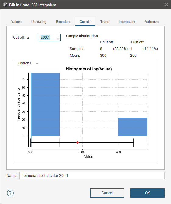

The Cut-Off Value
The Cut-off value is the value you would like to model. If you would like to visualise a shell representing values greater than 2.5, you would enter a value of 2.5 as the Cut-off value. This will be used to determine whether input values are treated as 0 or 1, waste or mineral. Another important consideration in visualising an indicator interpolant surface is the Iso value, which sets the probability you would like to maintain for the indicator interpolant isosurface. See Indicator RBF Interpolant Surfacing and Volume Options for more information.
To change the Cut-off value for an indicator RBF interpolant, double-click on the interpolant in the project tree, then click on the Cut-off tab. The tab also shows the distribution of the data used to create an indicator interpolant:
Adjust the Cut-off value, if required, and click OK to process the changes.

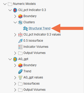

You can also set the trend for an indicator RBF interpolant from a structural trend. First, you must create or import the required mesh and create a structural trend.
Once the structural trend has been created, add it to the interpolant by double-clicking on the interpolant in the project tree, then clicking on the Trend tab. Select the Structural Trend option, then select the required trend from the list:
Outside value represents a baseline value, the expected ambient value of the surrounding region. The Outside value is factored into the interpolation algorithm and lowers the interpolated value in the areas away from the known data points. The blending with outside value is very steep. To increase the projection area outside of the area with data the Outside value can be increased to a value just below the cut-off value.
Once you have selected a structural trend, you can adjust the clustering settings. For more detailed information For more detailed information, see the Building a Structural Trend and Clustering Settings and Visualisation topics.
Click OK. The trend will be added to the interpolant and will appear as part of the interpolant, as shown:

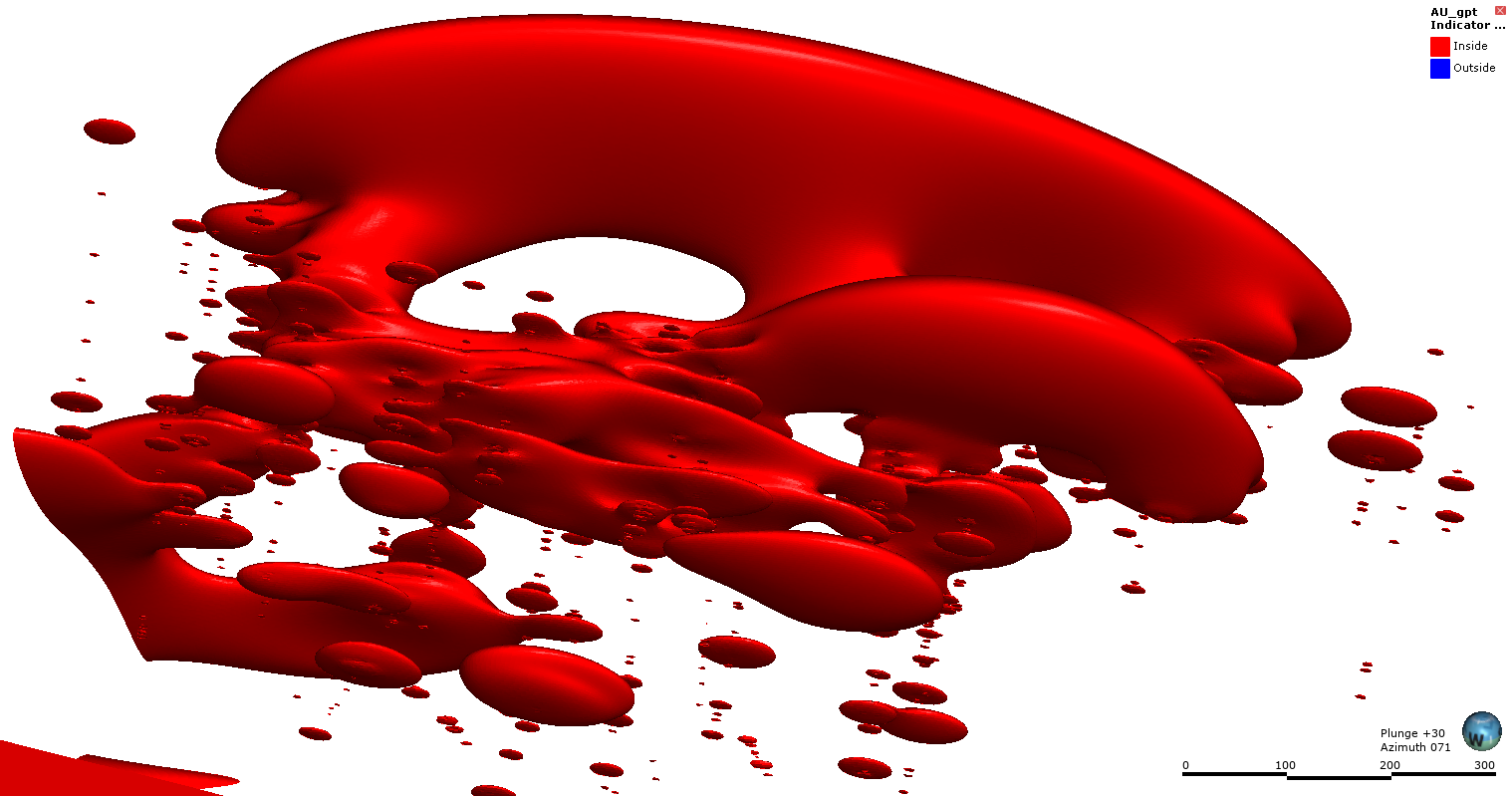

Use Volume filtering to discard smaller parts of the volumes in which you do not wish to carry out further processing. For example, this interpolant has numerous small volumes:
Enabling Volume filtering removes the smaller parts:
