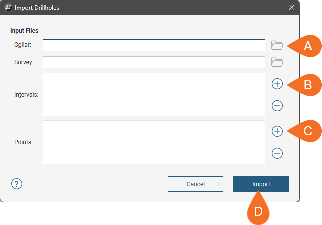

Right-click on the Well Data folder in the project tree and select Import Wells to see what options are available.
For each of these options, once the data source is selected, the process of importing drilling data is similar and starts with choosing the collar file for the drilling dataset. To do this, in the Import Wells window click the Collar button (A) to navigate to where the collar file has been stored.
Select the collar file to return to the Import Wells window, where you can then add interval tables (B) and downhole points tables (C) to the list of files to import. Once you have added all the files you wish to import, click Import (D) to start working through the files. See Importing Data Tables for an overview of how to map data columns in files to the format Leapfrog Energy expects.

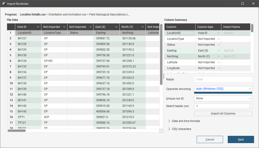

For data imported in CSV, ASCII, TXT, DAT and TSV formats, separate files are required for each type of table. For data imported in AGS format, a single file is imported that contains each type of table and a summary of the relevant data is presented at each stage of the importation process so you can select from the available groups of data. AGS format is described in AGS Format Drilling Data below.
The collar table should contain five columns:
- A well identifier
- The location of the well in X, Y and Z coordinates
- The maximum depth of the well
A collar table can also contain a trench column, and collars marked as trenches will be desurveyed in a manner different from other wells. See Desurveying Method for more information.
Leapfrog Energy expects a 0 for a normal hole and a 1 for a trench. If there is no trench column in the collar table, Leapfrog Energy will create one.
The well ID is used to associate data in different tables with a single well. The ID for a well must be identical in all tables in order for data to be associated with that well. Inconsistencies in the way wells are identified are common sources of errors.
The maximum depth column is optional. If it is present, is used to validate the data imported for the interval tables. The maximum depth specified is often a planned quantity, whereas the interval table records actual measurements. For this reason, Leapfrog Energy has an option for fixing the maximum depth value in the collar table to match the data in an interval table.
If maximum depth information is not included in a collar file, Leapfrog Energy will determine it from the maximum depth sampled as indicated by data in the interval tables.

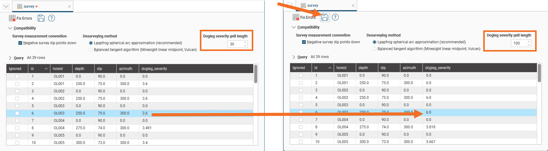

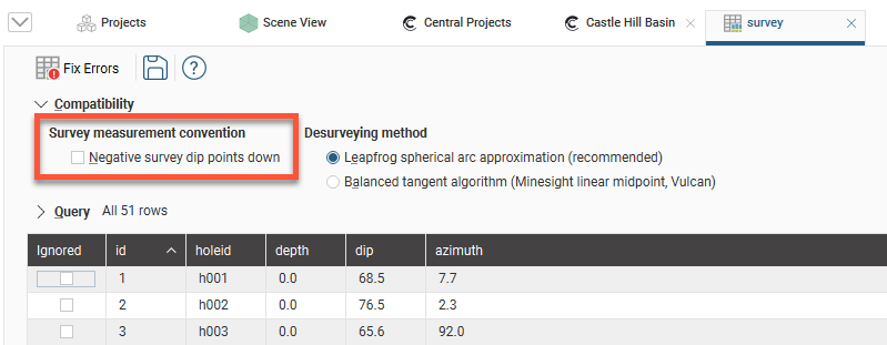

For the survey table, Leapfrog Energy expects a minimum of four columns:
- A well identifier
- Depth, dip and azimuth values
For the survey table, Leapfrog Energy expects a well identifier and depth, dip/inclination and azimuth values. You cannot have both an inclination column and a dip column so if a table contains both columns, you will need to choose between the two. When you import an inclination column, the survey table in the project tree will include a dip column, calculated from the inclination values.
Leapfrog Energy uses the negative-dip-values-point-up convention. If the data you are importing uses the negative-dip-points-down convention, tick the Negative survey dip points down option. This will convert the imported data to the convention used by Leapfrog Energy.
See Desurveying Method for more information on the well desurveying algorithms used in Leapfrog Energy.

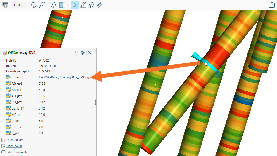

- URL columns. Use the prefix file:/// to link to local files.
- Hex colour columns containing RGB triplets.
When an interval table is displayed in the scene and an interval is selected, clicking on a link in the URL column will open the link. This is a useful way of linking to, for example, data files or core photo images from within Leapfrog Energy:

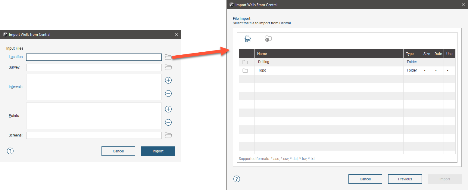

Importing Drilling Data from Central
Drilling data can only be imported from a project’s files. Although drilling data can be published to Central, that is for the purpose of visualising the data in the Central Portal. Published drilling data cannot be imported into other Leapfrog Energy projects.
To import drilling data from Central, first make sure you are connected to a Central server. Next, click on the Well Data folder and select Import Wells > Central. In the window that appears, select the project you wish to import data from. The Import Wells from Central window will be displayed. Click the button for Collar to navigate the project’s files to locate the collar file you wish to use.
Select the file and click Import. Work through the files as described in Importing Data Tables.

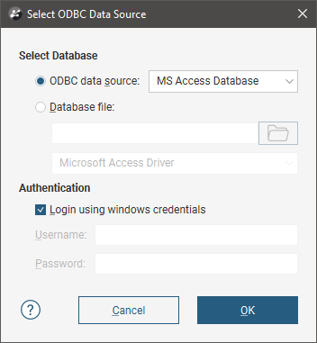

Connecting to an ODBC Data Source
Leapfrog Energy supports database files in Access Database (*.mdb, *.accdb) formats.
To import drilling data directly from any database that uses an ODBC interface, right-click on the Well Data folder and select Import Wells > ODBC. The Select ODBC Data Source window will appear:
Enter the information supplied by your database administrator and click OK.
If you are importing from a local database file, click the Database file option and then browse to locate the file.

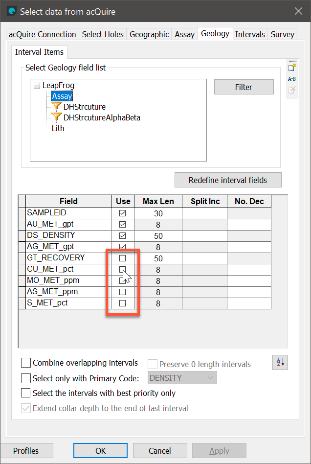

Once connected to the database, you will be able to select the required data using the Select data from acQuire window.
Optionally, click the Profiles button and choose a profile from those on the acQuire database. Profiles are created in acQuire; see your acQuire administrator for more information.
You can also use the other tabs on the acQuire component interface to make other data selections.

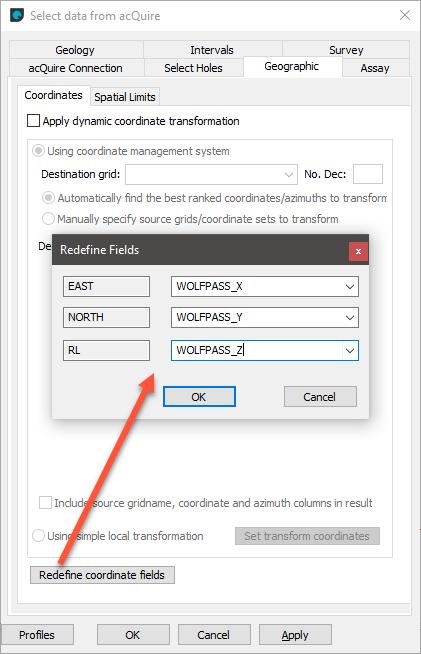

In the Select data from acQuire dialog provided by the acQuire component, both the Geology and Assay tabs can have additional pages added to select different sets of fields. To add a page, click the Create new page button. Each page will end up as a separate interval table under the Wells object in the project tree.
To successfully import data from some acQuire databases, it may be necessary to redefine the coordinate fields using the Refine coordinate table button on the Geographic tab.
For more information on using the third-party selection tools provided in the Select data from acQuire window, see your acQuire user documentation. When you have finished specifying the selection, click OK to import the data.

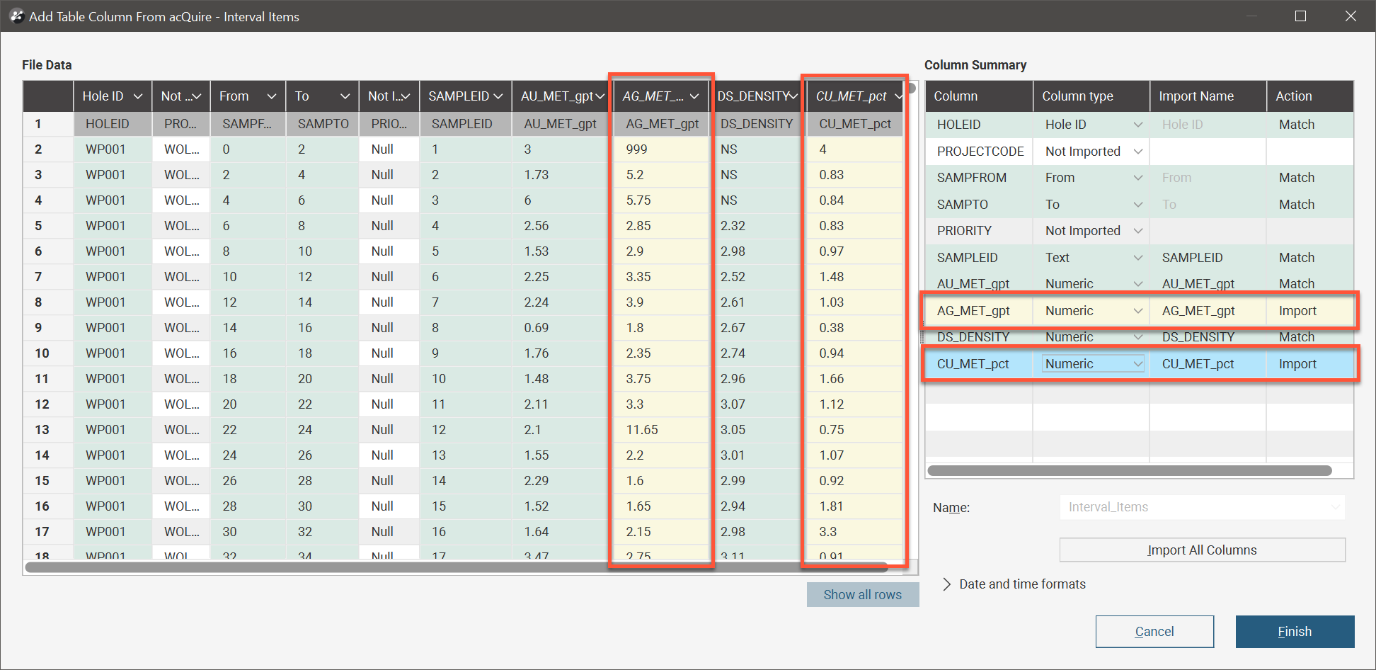

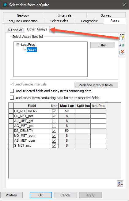

Adding Columns
To add a column for a collar or a survey table, right-click on the table in the project tree and click Import Column. To add a column for an interval table, right-click on the interval table in the project tree and click New Column > Import Column.
Having set up an acQuire database to provide drilling data, you can add columns that were not previously imported to tables without deleting a table and reimporting it. This is useful if a particular column was not available in acQuire at the time the database connection was established, or it was previously thought a particular column was not needed and was left unticked when the database import was configured.
In the acQuire import component’s window, select either the Assay or Geology tabs and tick Use next to any Field you want to appear as an available column that has not previously been selected for import, then click Apply and OK.
When the Add Table Column From acQuire window opens, select columns to import into Leapfrog Energy. Such columns may be ones that have only just been made available via the step above, or may have been ones already available for import from the acQuire database that were not previously selected for import in the Add Table Column From acQuire window.
Select the Column type for the data columns being imported and click Finish. The newly added columns will appear in the project tree under the selected table.

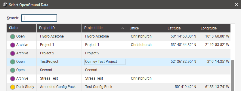

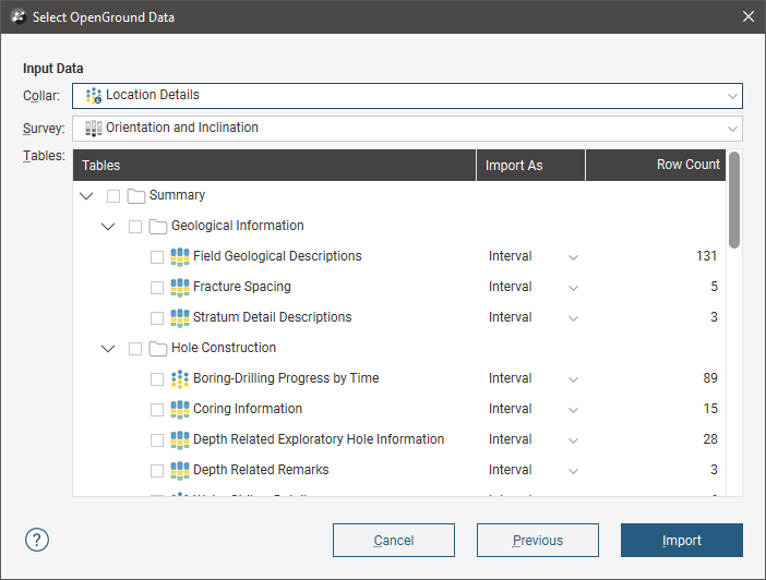

Connecting to an OpenGround Database
To import drilling data via OpenGround, right-click on the Well Data folder and select Import Wells > OpenGround. In the window that appears, enter your credentials for the database you wish to connect to, then select the instance you will use.
In the next window, you can filter the list of projects using the Search box. Select the project you wish to open, then click Next.

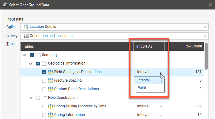

Once the project has been opened, select the data columns to map to the Collar, Survey and Tables lists.
You can only select one collar table and one survey table, but you can select as many interval and point tables as you need. Change how tables are mapped using the Import As dropdown list:
Select only as many columns as you need to work with. You can import additional data columns from the project later.
Once you have selected the columns you wish to import, click Import to work through the data tables and add the data to the project tree.

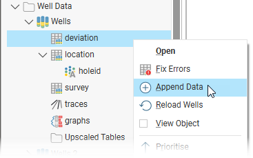

Appending Well Deviation Files
Appending the data adds new data to Leapfrog Energy without overwriting the existing data. If there are new wells available, i.e. additional *.dev files, and you do not wish to change the data already in the project, use the Append Data option to add the new wells to the drilling dataset. To do this, right-click on the deviation table and select Append Data:
In the window that appears, select the files you wish to add to the dataset, then click Open. Leapfrog Energy will process the files and add them to the existing dataset without changing any information already in the project. Note that if you have accidentally selected files for wells that are already in the project, data for those wells will remain unchanged in the project.

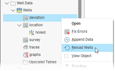

Reloading Well Deviation Files
If the data already in Leapfrog Energy has been changed outside the project and, perhaps, there are new wells, use the Reload Wells option to overwrite the data already in Leapfrog Energy and add wells defined in any new *.dev files. To do this, right-click on the deviation table and select Reload Wells:
In the window that appears, select the files you wish to include in the dataset.
Note that only the wells you select will appear in the reloaded dataset, so be sure to also select the files for the wells already in the project, if you wish to retain them.
Click Open. Leapfrog Energy will process the files selected and update the drilling dataset.

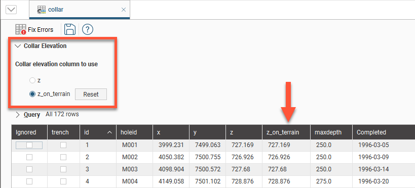

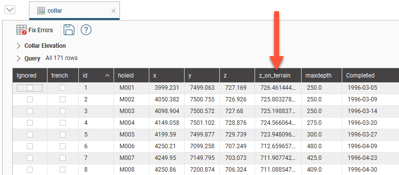

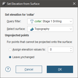

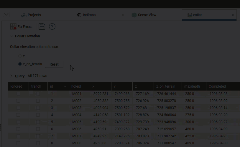

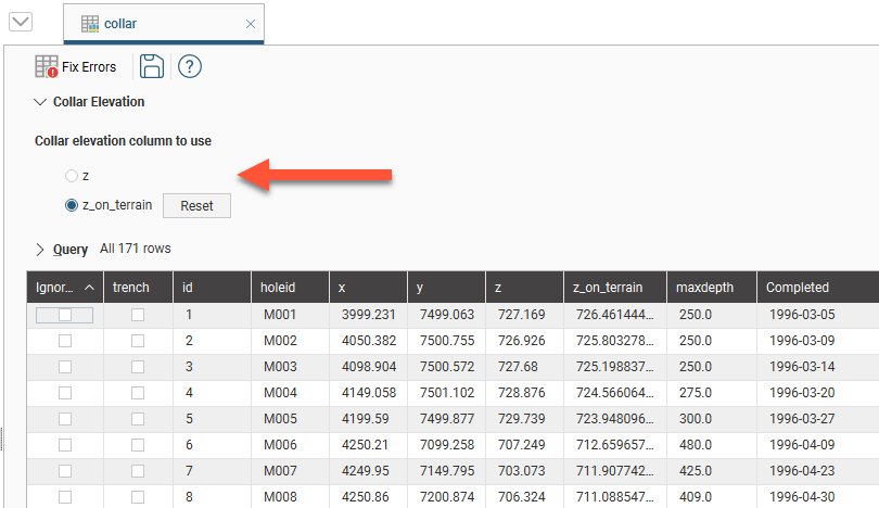

Setting Elevation for Collar Points

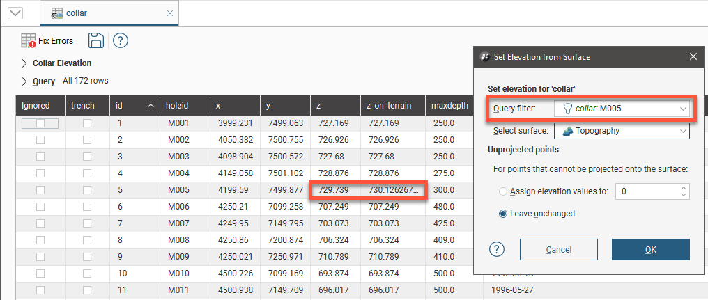

You can set the elevation for all collar points or for a subset of collar points by projecting them onto a surface. This creates a new column in the collar table called z_on_terrain, and you can switch between using the original values in the z column and the projected values in the z_on_terrain column:
To set the elevation for collar points from a surface, right-click on the collar table in the project tree and select Set Elevation. The Set Elevation from Surface window will appear:
Select from the surfaces available in the project and set a query filter, if you wish to limit the collars you will project onto the surface.
If the surface does not intersect vertically with some points, you can choose how the z_on_terrain values for those points will be determined. There are two options:
- Leave unchanged makes no changes to the z values for unprojected points; the original z column values will be used.
The collar table will be updated with an additional column, z_on_terrain:
The z_on_terrain column values are determined as follows:
- For selected points that can be projected onto the surface, the elevation values from that surface are used
- For points that cannot be projected onto the surface, either a fixed elevation value or the original values from the z column are used, depending on the chosen Unprojected points option.
- For points you have chosen not to project, i.e. if you have used a query filter, the original values from the z column are used.
The original z values are preserved in the z column. To switch back to the original z values, click on Collar Elevation, then select the original column:
The z_on_terrain column will remain in the collar table; switching to using the original z column does not delete the z_on_terrain column.
Applying a query filter is useful for limiting the collars projected onto a surface. Here, a query filter has been used to project a single collar, M005, onto the topography:
All other values in the z_on_terrain are from the z column.
Note that you can repeat this process for multiple subsets of collar points, if there are different surfaces you wish to use in setting the elevation for different subsets of points.
If the collar table is reloaded:
- For existing wells, z_on_terrain values are not overwritten on reload.
- For new wells added during the reload, the z_on_terrain value will be left blank.
- For an existing well that has a changed z value, the z_on_terrain will remain unchanged on reload.
You can also clear the projected values from the z_on_terrain column by clicking the Reset button, in which case the z_on_terrain column will be reset to the z column values:

Dip Direction
To correctly represent the orientation of wells in Leapfrog Energy it is essential to understand the convention used when the data was recorded. Leapfrog Energy uses the negative-dip-values-point-up convention internally. When the survey table is imported, Leapfrog Energy sets the Negative survey dip points down value according to the data in the imported table. When the majority of the dip data in the table is positive, Leapfrog Energy assumes all these wells will point down and leaves the field Negative survey dip points down disabled. When most of the values are negative, Leapfrog assumes the external data has used a negative-dip-values-point-down convention, as it is unlikely that most of the wells have been drilled upwards, and the field is enabled. This field can be changed by double-clicking on the survey table to open it and then clicking on Compatibility to show the table’s desurveying settings:
If you are going to change the automatically set value of Negative survey dip points down, consider carefully the implications if there is a mix of wells pointing down and up.

Dogleg Severity Unit Length
In the survey table the dogleg severity is expressed as degrees of deviation for a certain distance. The default distance is 30 distance units, however this can be changed.
Insert the Dogleg severity unit length and when the changes are saved, the dogleg_severity column is updated.
